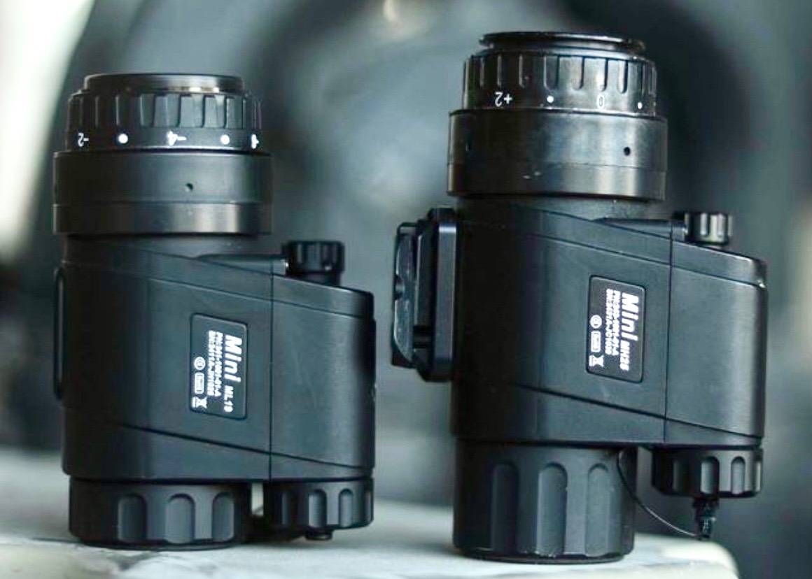

The ML19 is a good little unit. The picture quality is much better than my 384 Hogster when left at 1x. It degrades quickly when zoomed though. I would say at native mag, the 19 is 75%+ of the image quality of the 25. Personally there is not a need to zoom a helmet mounted thermal though. It is very usable, very light, and very compact.

Did you upgrade ML19 using PVS14 eye piece? I wonder if it's as simple as the MH25, or if there's a dimensional problem.
So, just to be clear, you have or had both?
Yes. My dad has a 19, I have a 25. The 19 doesnt have many hours on it yet.
I didnt put a PVS eyepiece on the 19, but it could use it. You can get it adjusted to where it is giving the full FOV, but it makes you want more eye relief. @TheHorta would probably know the does it fit answer. I imagine it would.

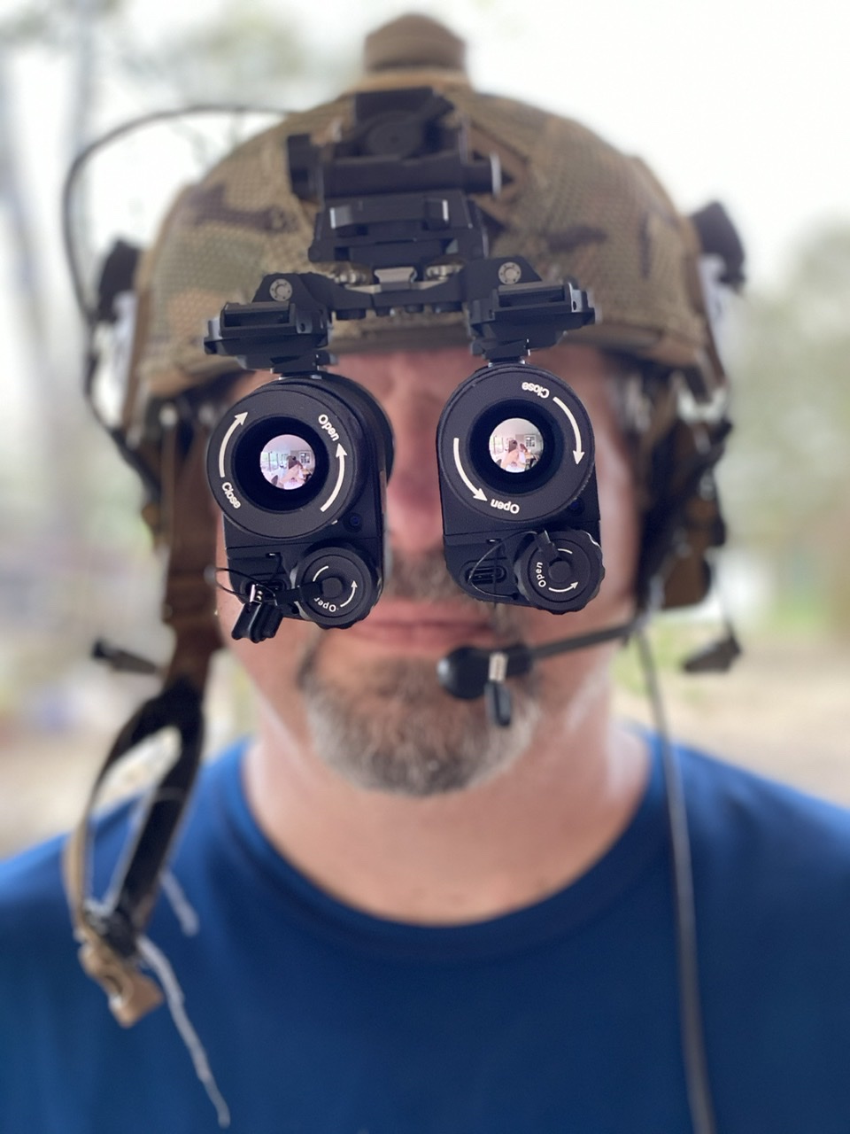

The 19 accepts the eyepiece just like the 25, not speaking from experience but just seeing photos with them on…
