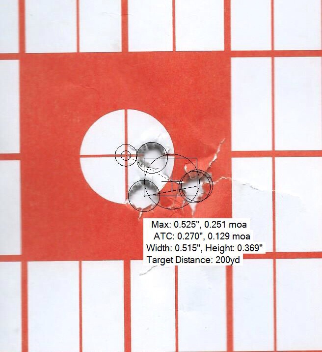

My buddies LRI 300 win mag is a hammer ImageUploadedByTapatalk1410303306.693920.jpg
