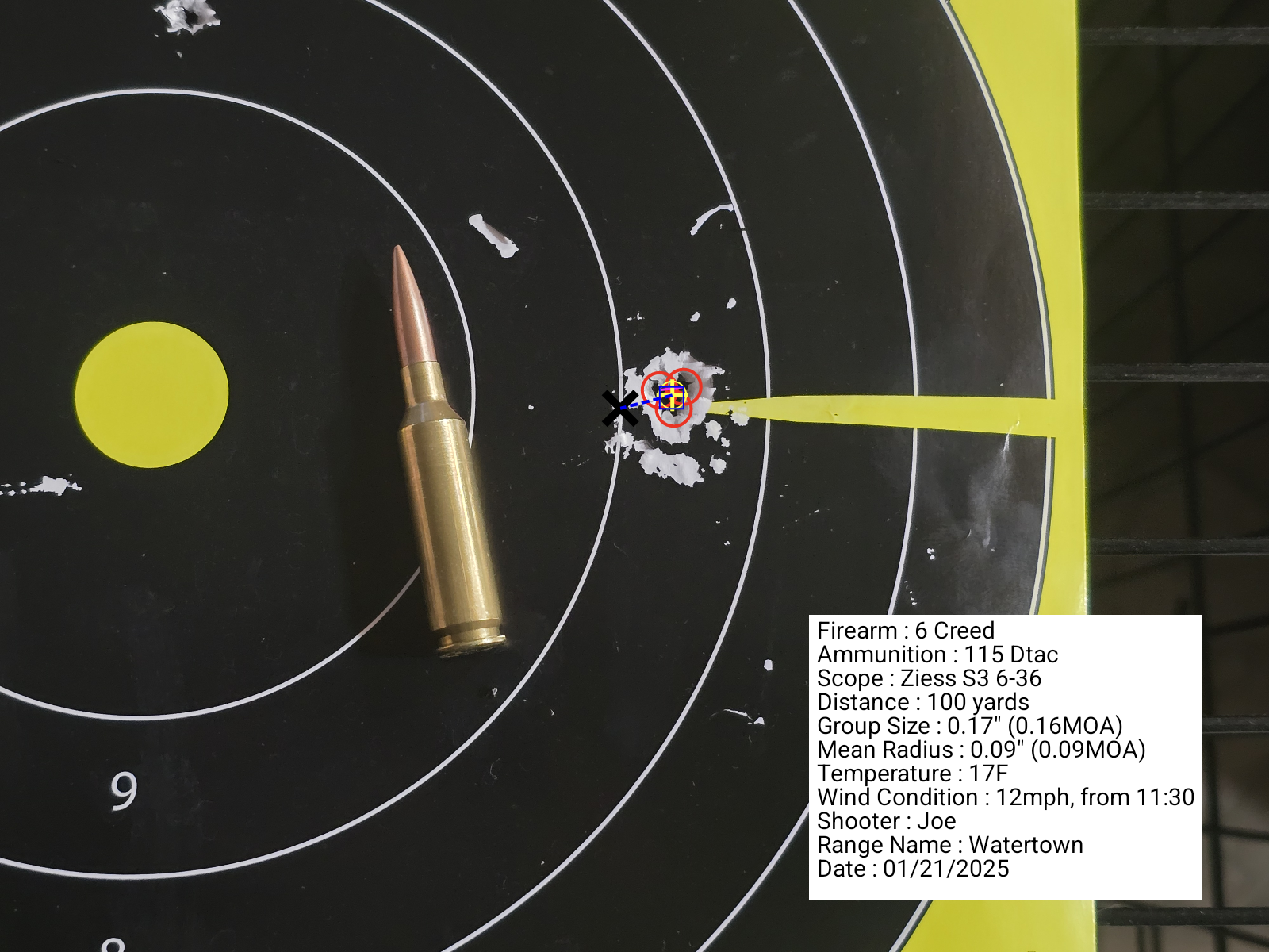

It was cold as balls the other day and I went out to double check ammo from last year, to see how my temp swings were.
Spit this 3 rounder out cold bore.

But what I’ve probably shot the most of in 6CM and tend to like the best are 115 DTACs… there’s something great about the heavier, high-BC bullets running “slow” at ~2850-2900fps… they’re relatively soft shooting and hammer out past 1200 yards while yielding a solid whack on plates.
