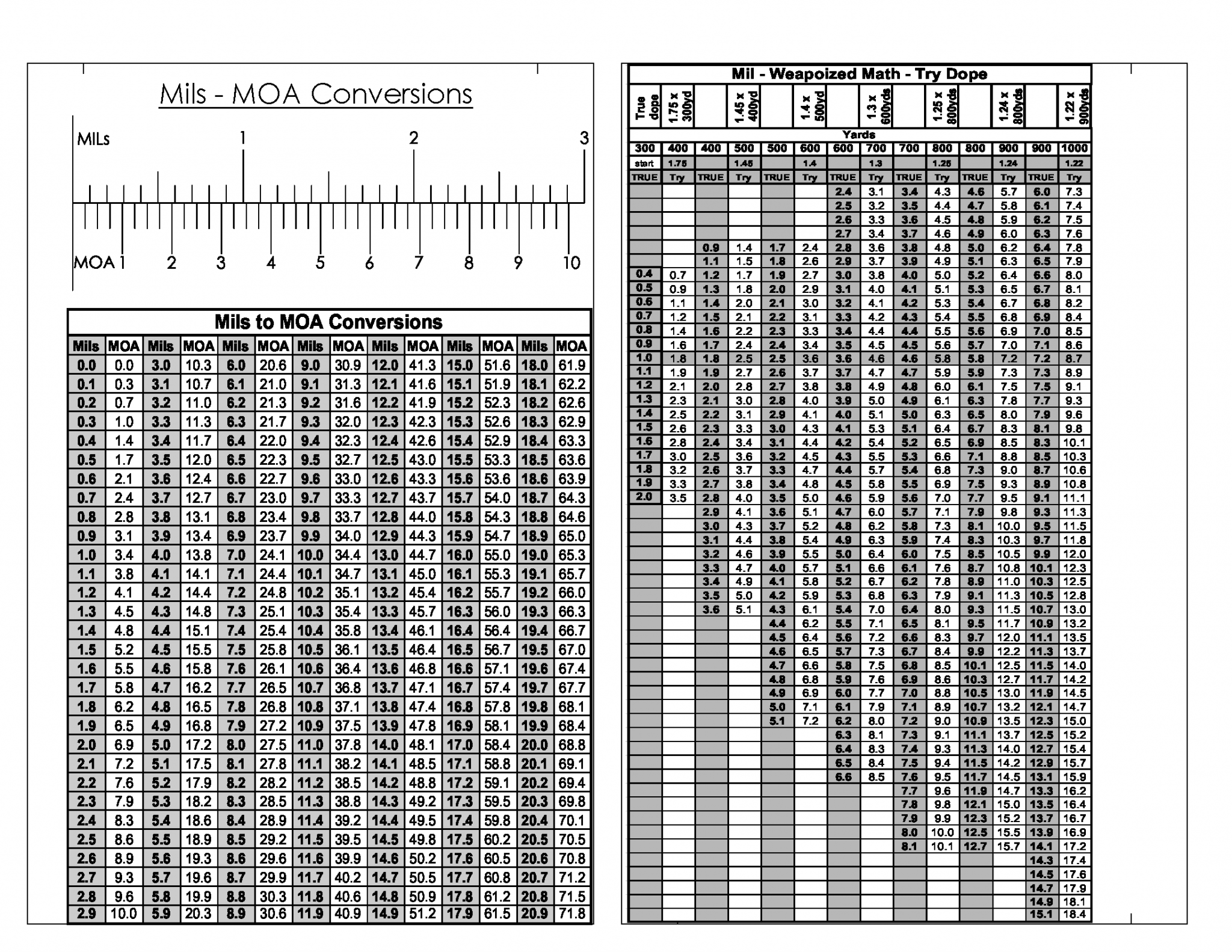

    If cost is a factor, just dope with Weaponized Math for free and run a data card
    This is an entire ballistic catalog for anything zeroed at 100 yards,
    It’s not a make or break factor. I will get the kestrel. Just $800 vs $100 comparison. Thank you for that as I do want to learn and understand as much of,I’ll call it, manual doping as I can.
