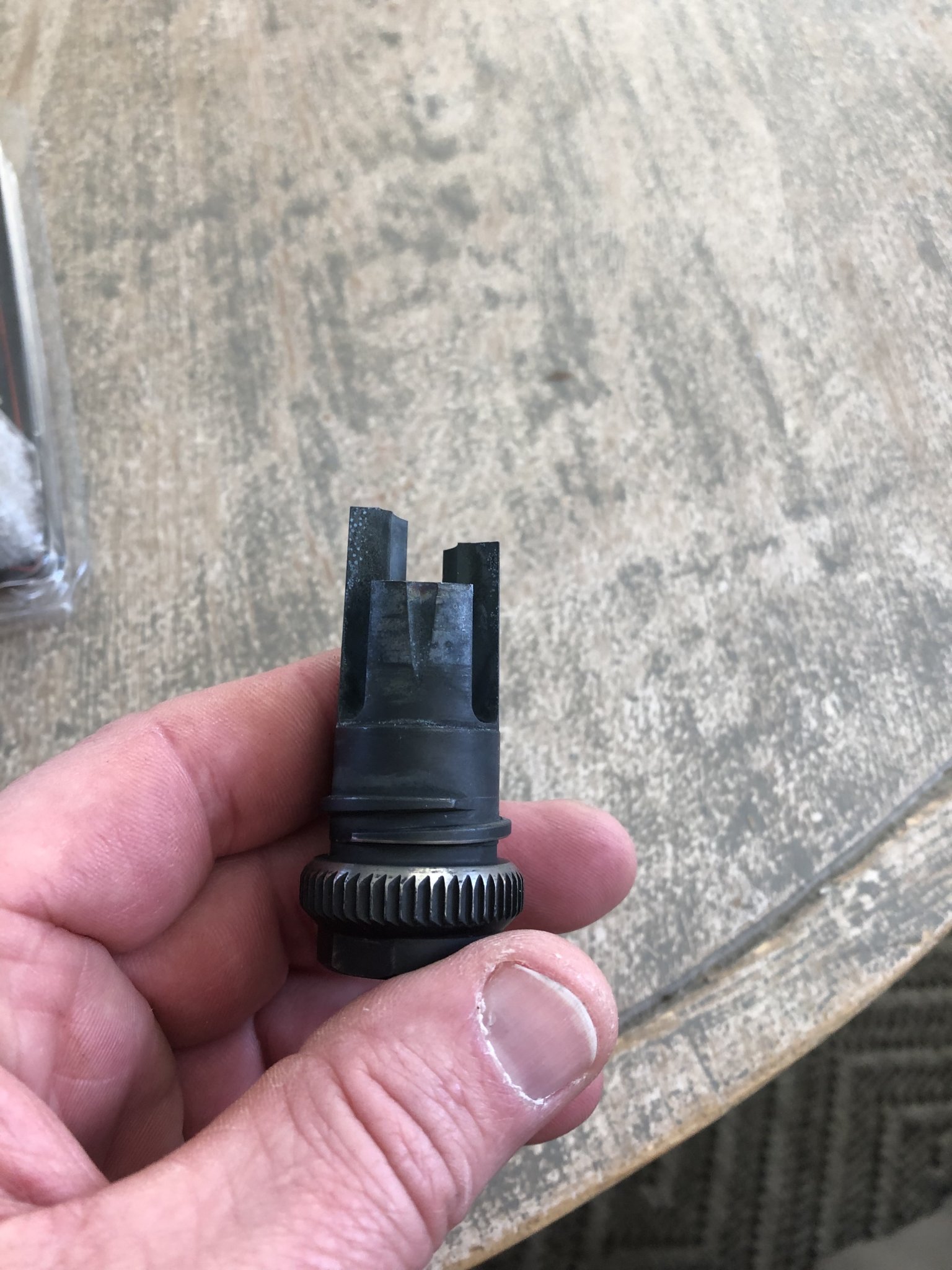

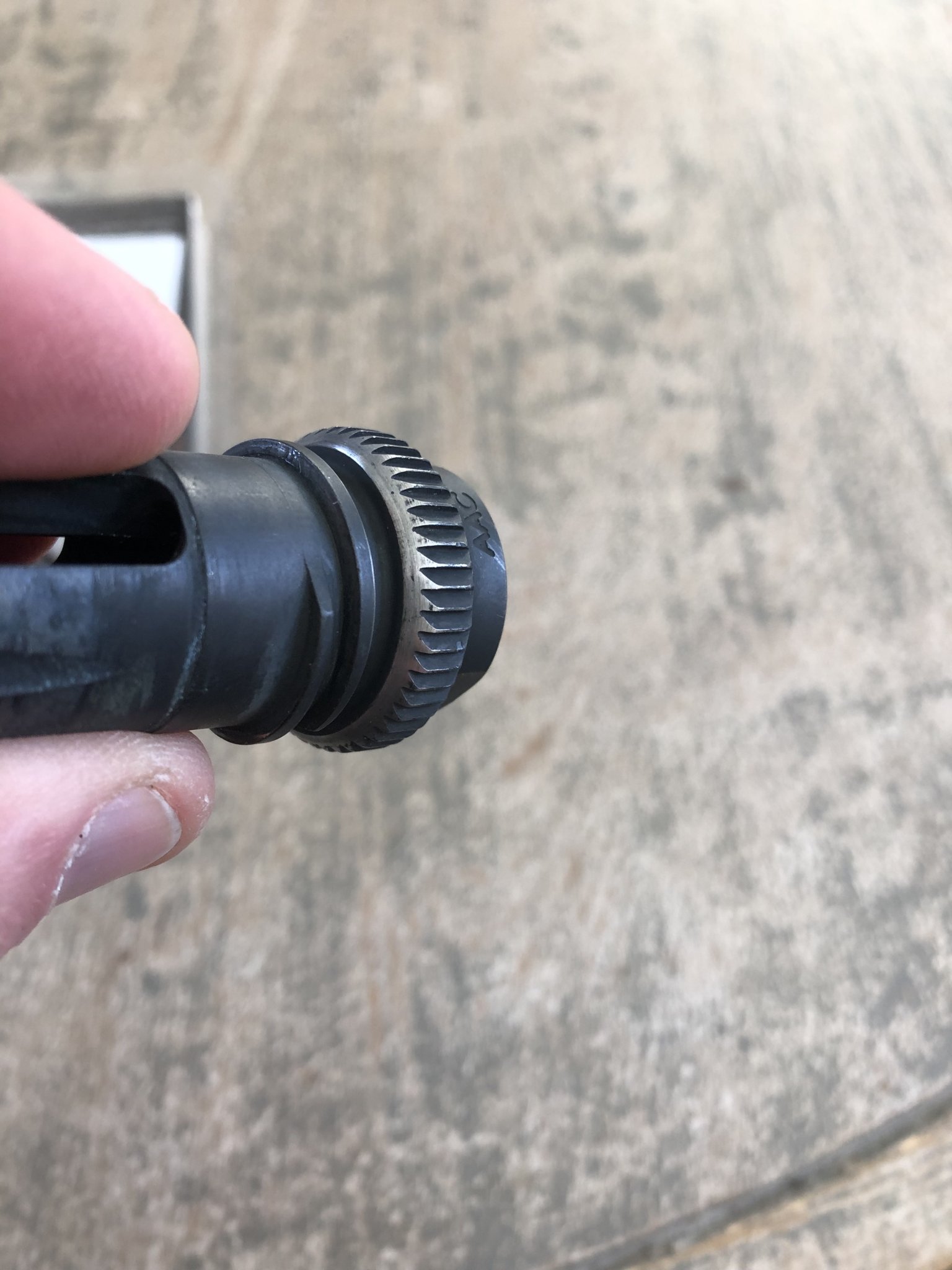

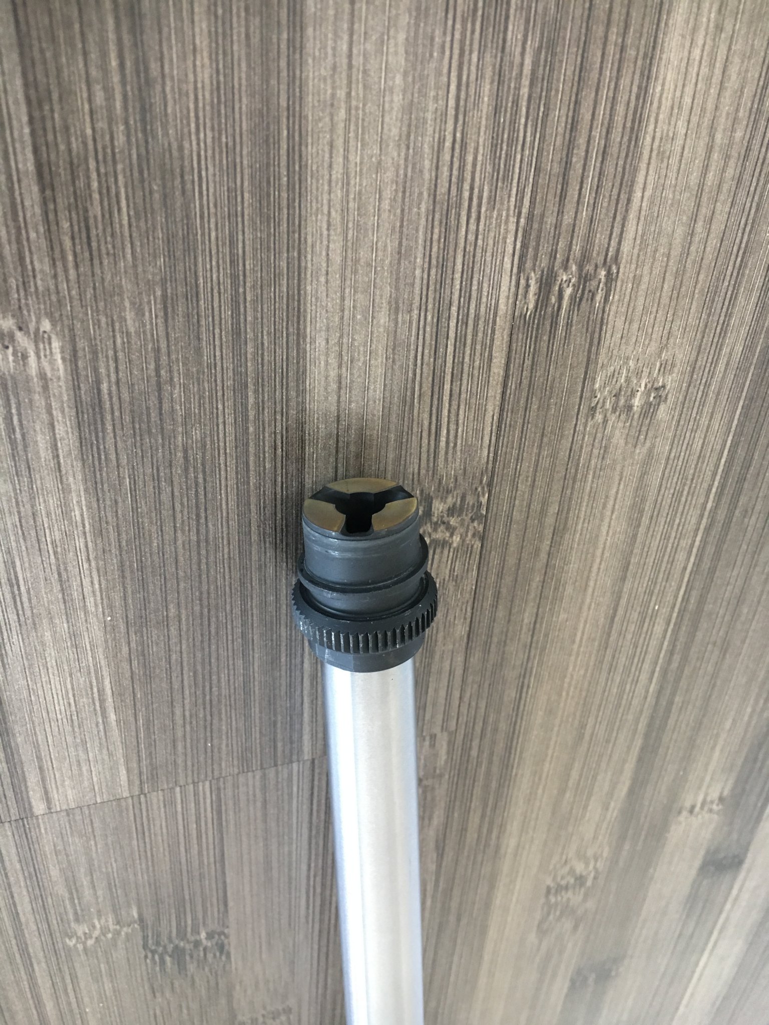

So back in the day when the 7.62sd was all of the rage (2010ish), I purchased one along with several flash hiders. I have always loved the sound of this suppressor but have absolutely hated the the mounting system. I don't like the pinging sound on fresh flash hiders and I don't like how the lockup isn't super solid.
I've modified a few of them by turning the 45 degree shoulder on the flash hider that mates up with the can. That has probably been the best thing that I've done with this system until now...
Since I don't use Night vision nor shoot at night time, I was thinking, why am I putting up with these prongs on the end of my quick detach system? So, I ended up taking a few of my mounts to the wire EDM and chopped them off.

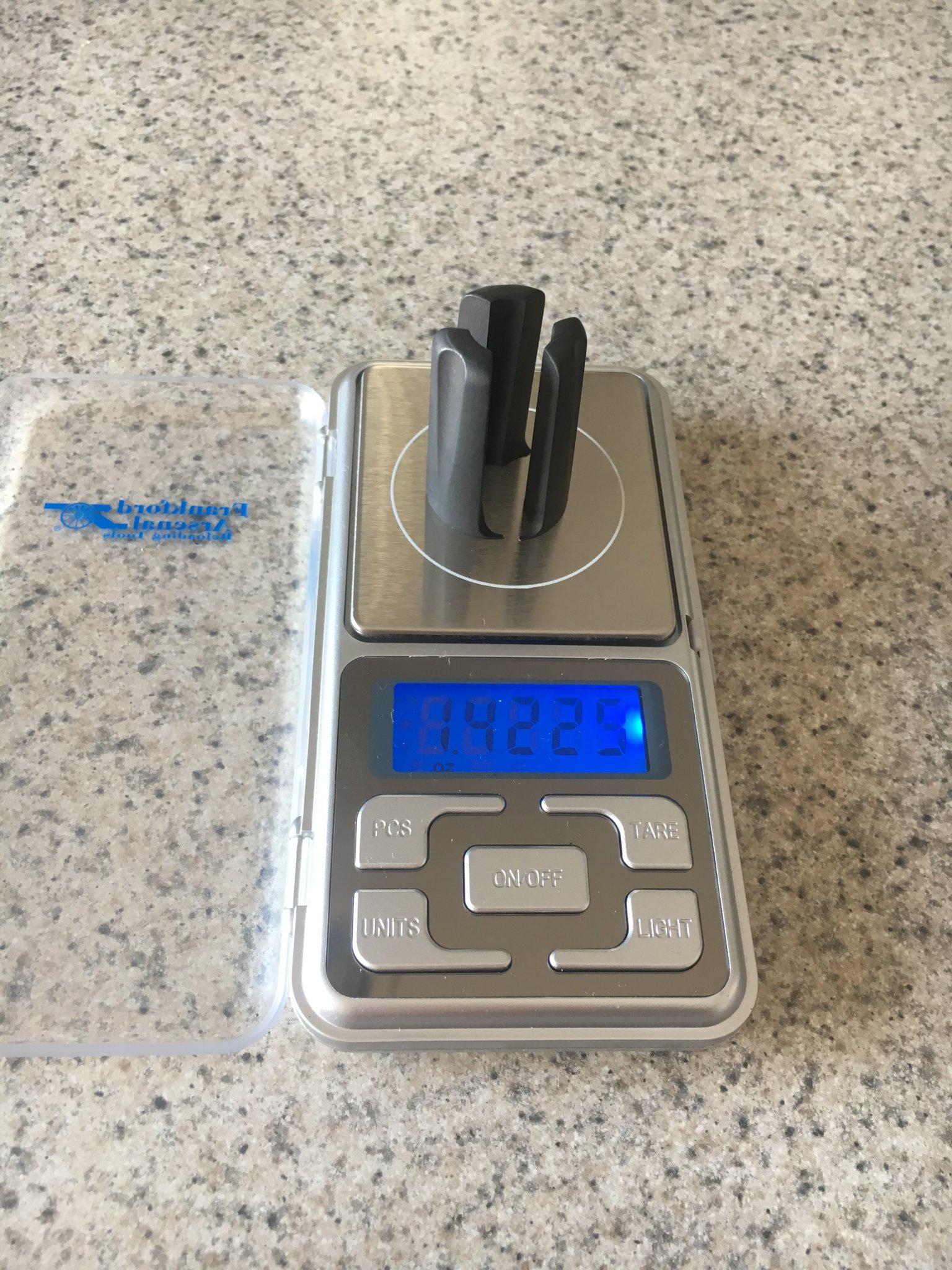

The savings are about 1.5 oz and I don't have to deal with the pinging anymore.

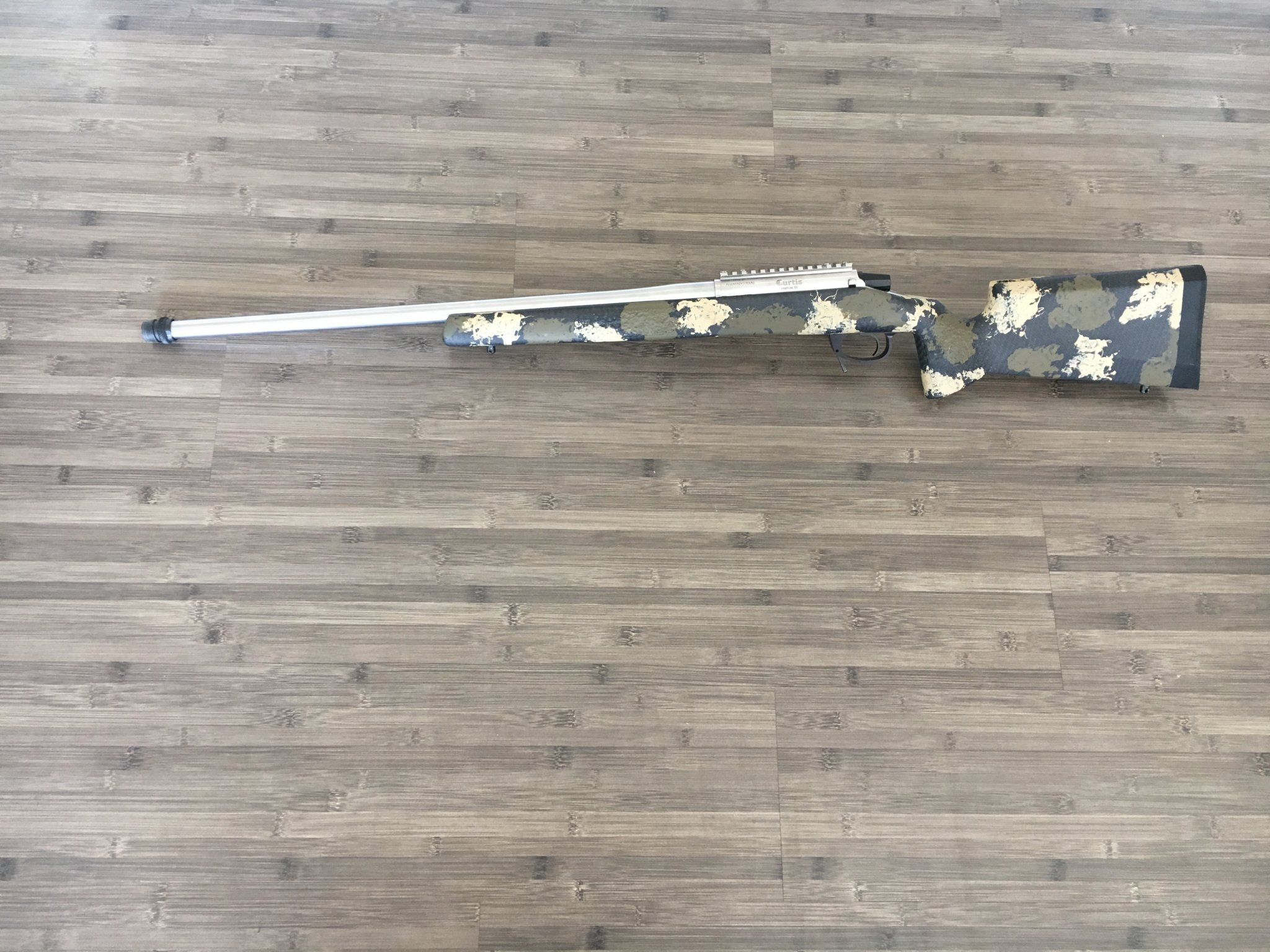

Interesting thought, I have one as well and it drives me nuts in my 5.56. I have acouple of aac brakes and the breakout, they don’t it. So if you ever ever upgrade. Another option is battle comp makes a 51T brake.
Your set up doesn’t look half bad. Any accuracy issues?
I've looked at the Battle Comp 51t mounts before. They are too pricey in my opinion.
I've often thought of designing my own 51t mount that would have indexable teeth. That way it would snug up tight with any 51t suppressor.
