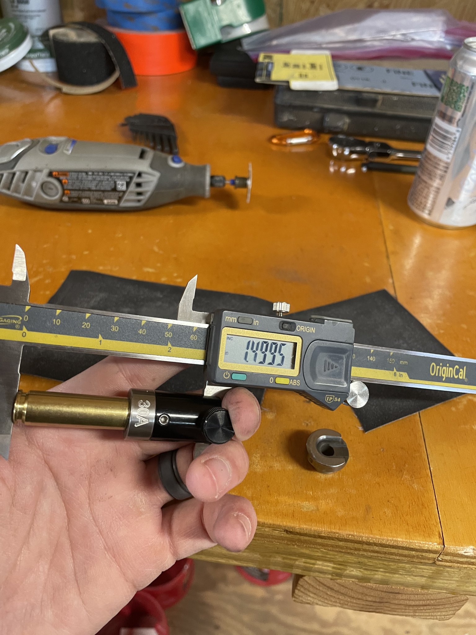

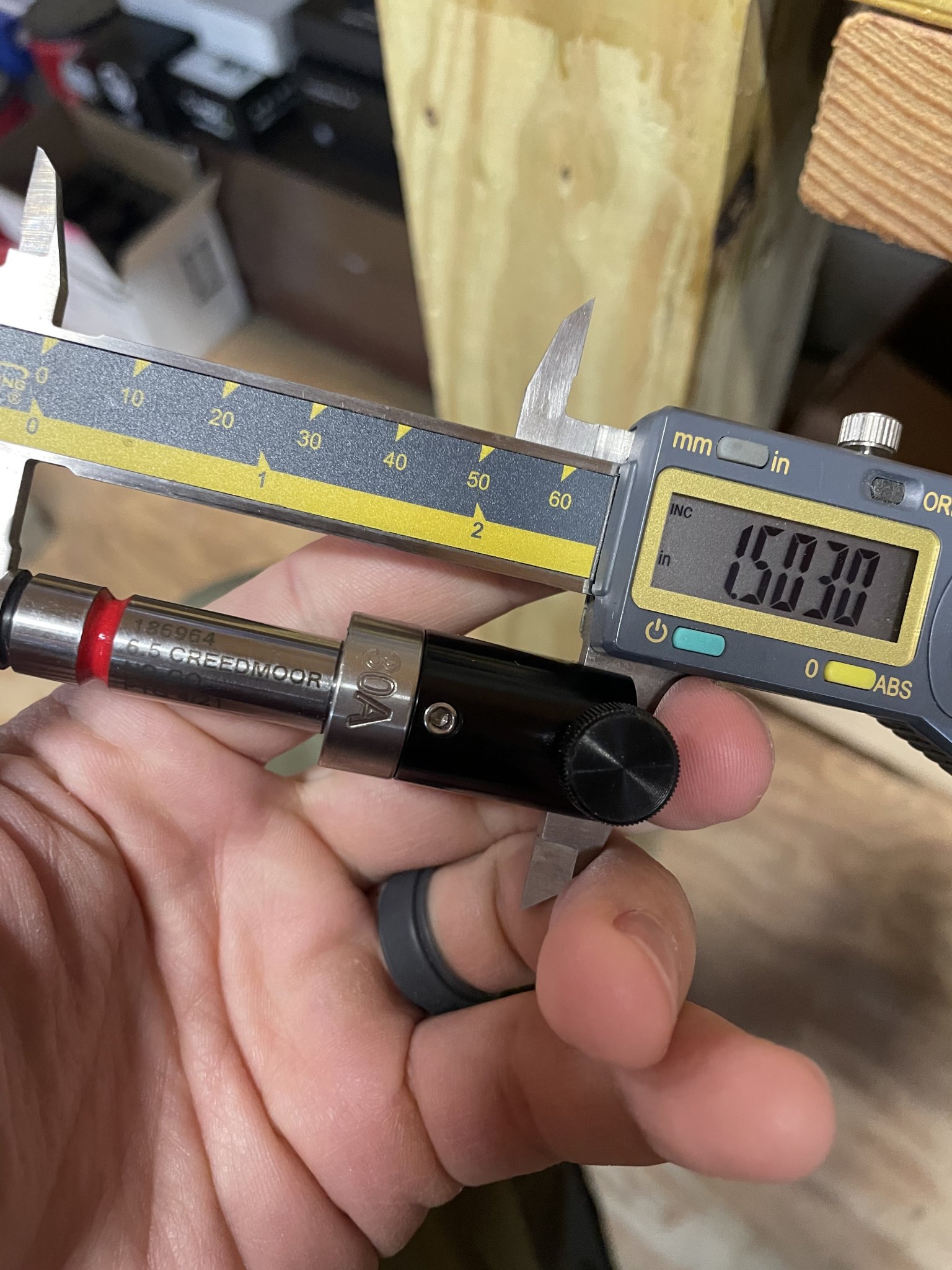

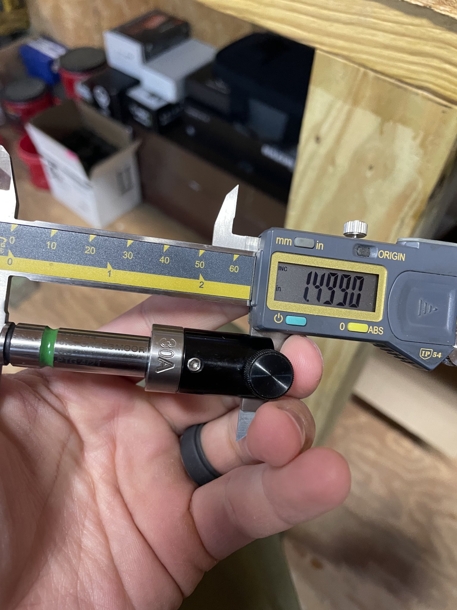

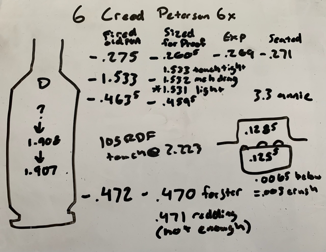

Okay so long story short I cannot get enough shoulder bump on my brass. I am using Redding type s 6.5cm dies and lapua brass. 400 pieces are on their 5th firing and 200 pieces on their second firing.
The issue started on the 4th firing as I was getting a tougher bolt close than I would like. So since it is a barrel nut barrel I assumed I pinched my head space a little tight so I opened it up so I got about 1/2 bolt close on no go instead of 1/4 bolt close. That worked for a firing but now I’m back in the same boat.
I got a tikka to build a hunter/beater rig and I sized a piece of the 2x fired brass and it won’t chamber. I am getting 1.502-1.503 shoulder measure prior to sizing and 1.501 after sizing. I can chamber it in my barrel nut barrel with light resistance but it’s way too tight for my tikka.
I have already tried light to really heavy can over on my press and it doesn’t change the outcome.
So I have a buddy that can turn my die down to shorten it up a bit so I can use the comp shell holder set to adjust back up in case I shorten the die too much.
My question is how much do I take off the die? Currently I am thinking around 6thou. And has anyone ran into this and is there anything I am missing?

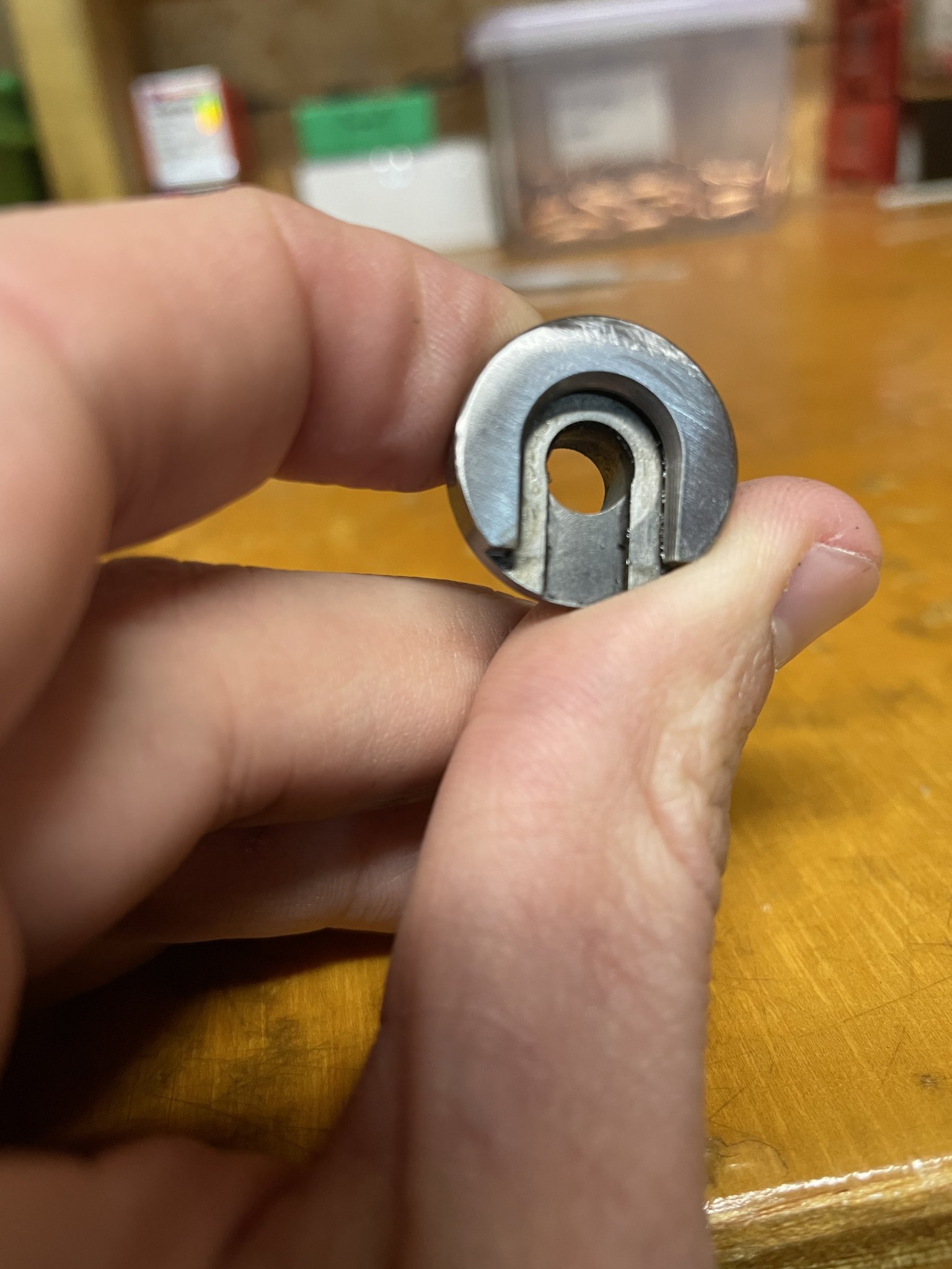

Are you annealing your brass, it sounds like your brass is getting hard and springing back too much when you resize it?
You can shorten the die a couple of thousands but as you have already seen in increasing the chamber length you will probably get the same problem back after a couple of firings.
It makes it more of a bump. When you compare the shell holders, you will see they are thinner than standard by the amount marked on the shell holder. This pushes your brass up into the die by that much more. So you set up your die with your standard shell holder first. Then if you want to increase the bump, you just put in that shell holder for that amount of bump. They go from .002" to 0.010" in .002" increments (5 holders in a box).
Redding Competition Shell holders are reducing your bump.
Most times when a sizer die is touching shell holder you are bumping shoulder close to 0.006". Competition shell holders allow you to touch shell holder with die but reduce how much you push shoulder back.
I guarantee you that competition shell holder reduces how much you can bump shoulder vs standard shell holder. If you measure a standard shell holder with a caliper depth gauge it will measure 0.125 from top of shell holder to bottom of cutout for shell. Competition shell holder with +2 marking will measure 0.127" for the same measurement.
Find a local machine shop with a precision grinder and have them grind down a couple shell holders taking off 0.002", 0.004", 0.006" and maybe 0.008".
Shell holders are cheaper then a die, modify the less expensive part.
Ideally redding comp she’ll holders allow you to maintain full contact between the shell holder and die body so it eliminates any potential case to case flex differences in the press.

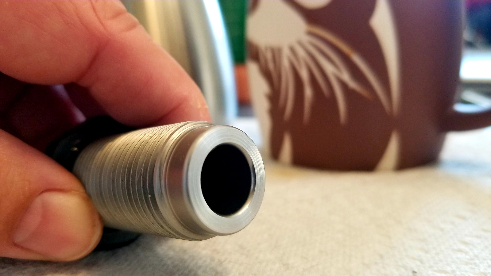

I've only had one die in all my years of handloading that had this issue. The die was adjusted down all the way and had a substantial amount of cam-over. It would only bump the shoulder 0.0015 after sizing. The die maker offered to replace it, but I ended up facing it off 0.008 and everything was fine. The shell holder will not make a difference if the die is already bottomed out.
Edit: The die was shortened after attempting to use the Redding comp shell holders.
Edit II: This was a poor choice of words. I removed 0.008 thousandths after researching the use of the Redding competition shell holders. Thanks to all that have commented on this mistake.
I would like to ask the question of why would you modify the shell holder instead of putting the die in a lathe and removing the desired amount? Every new shellholder will need this mod down the road if replaced.

I am not annealing. Maybe my thoughts on the die are out of line but if my chamber blows the brass out to ~1.503 and my die is capable of bumping to 1.501 if I reduce the die to be able to bump to 1.495 and use shell holders to achieve 1.499 I should be able to repeat this sequence. Although it will likely reduce brass life.
Check your diameters too.
Sand some off the top of the shell holder and see if that allows you to get close enough. Turn it over on some sandpaper on a piece of glass or something flat and in a figure eight motion.
I’ll check diameters when I get back this afternoon. I did try to sand down the standard shell holder but it just put a very pretty polish on the top without reducing thickness. I just assumed it was too hard to get any material removed.
I've done a few, you could be rocking in 5 minutes...
I was tempted to go this route yesterday but was worried about keeping the surface even. I’ll test my bubba dremal skills on my standard shell holder this afternoon and report back

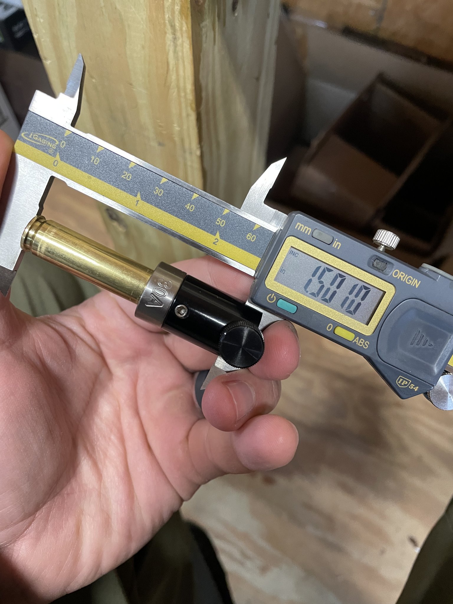

Update.
After some dremal work and some sand paper I was able to get the bump. So with “normal” cam over the brass sized down to 1.4965 then moved to just a slight cam over and got 1.4995-1.4990
Both cases cycle great through my barrel nut barrel but the 1.4995 is still on the tight side for this tikka chamber. The 1.4965 cycles easy so I gonna try to find tune and get it to 1.498 and see how that does.

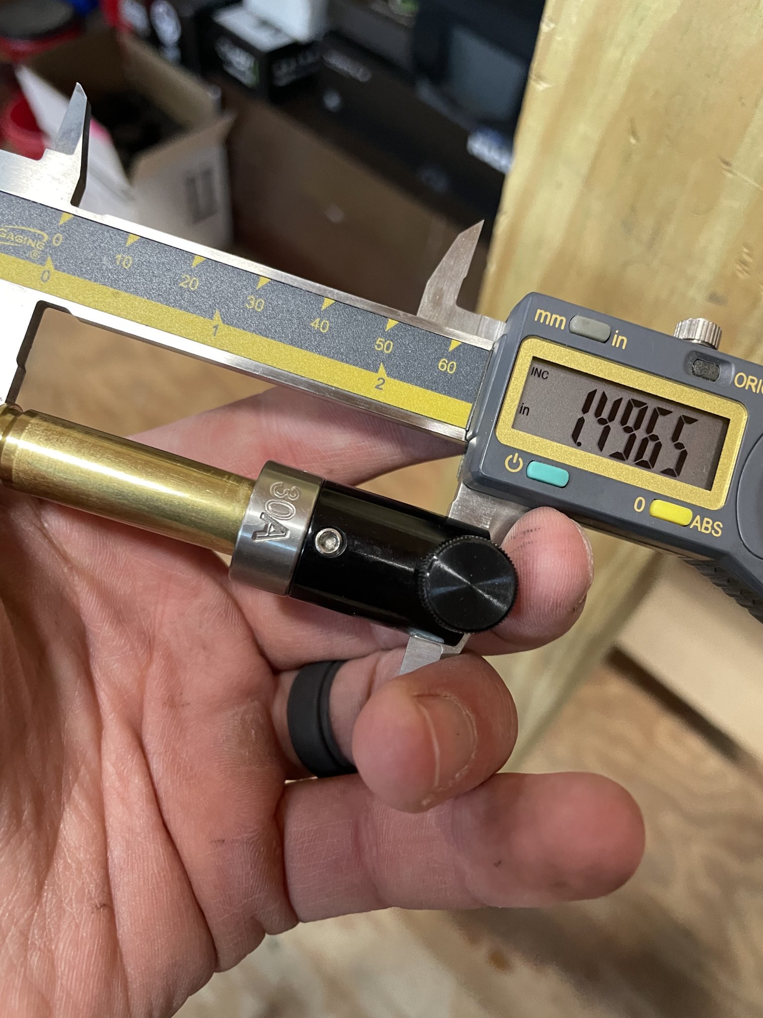

Well by the images of your brass you have a case head issue more than not enough bump. Anneal the cases and that will tell you if it is a case head expansion issue or just spring back from hard brass. You don't have to do all of them just a couple and then size them and see if they fit in both chambers.
