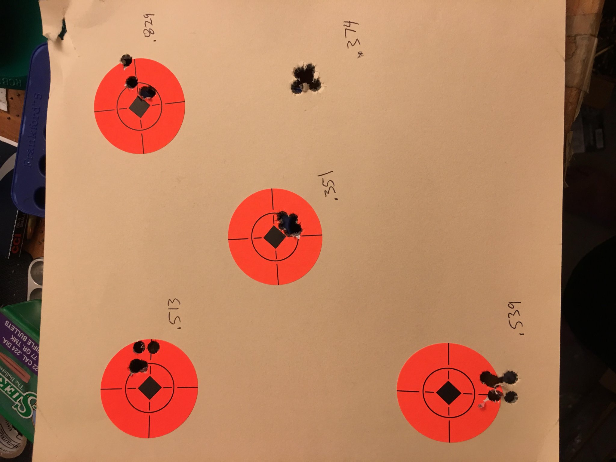

Found two loads last night, 45.5grs H4350, 123gr ELD Match, set 0.015" off the lands with a Velocity of approx 3000fps avg and ES of 8 (except the first round which was 50 - 100fps slower). 3/4moa group
The other load is 44grs RL-17, 123gr ELD match set 0.015" off the lands, avg velocity ~3050fps, ES 25 5/8moa group
So, not bad night last night, but now the first shot being slower question and still the flyer issue and high right then settle down with factory match ammo.

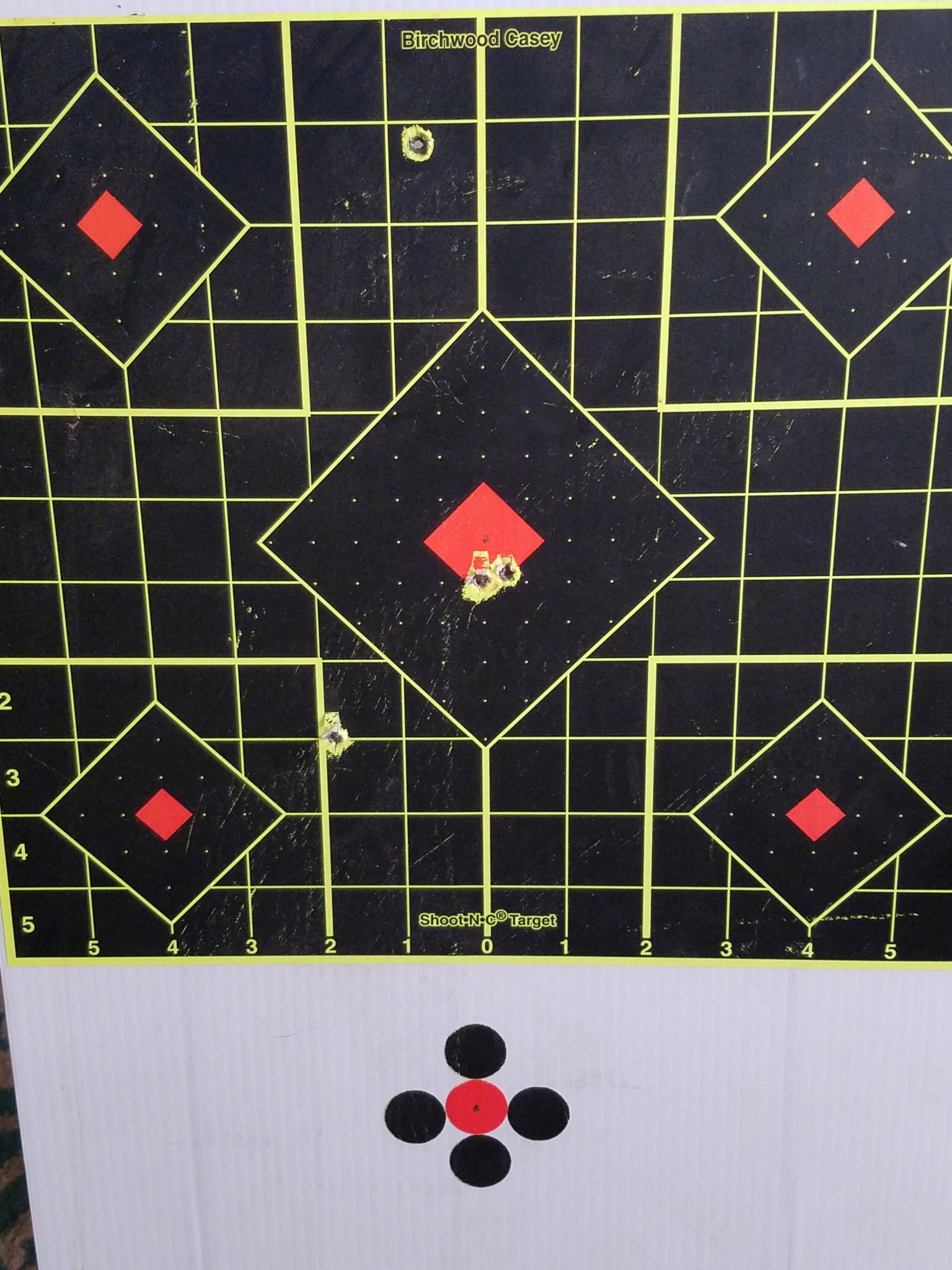

Here is my sight in target from my $1100.00 GEN II RPR IN 6.5 Creedmoor shooting Hornady American Whitetail 129 grain interlock ammo with Nikon P223 Scope cheap optics and ammo @100 yards out of a Bone stock rifle.

Here is my sight in target from my $1100.00 GEN II RPR IN 6.5 Creedmoor shooting Hornady American Whitetail 129 grain interlock ammo with Nikon P223 Scope cheap optics and ammo @100 yards out of a Bone stock rifle.View attachment 6902088

Went to the range to re sight in after installing new rings and trigger. I never really liked the flat trigger that came with it, and the Huber made a huge difference. Far fewer called bad shots. I think the relative light weight of the rifle was really working against it.
In any case, while I didn't do any crazy throat burner strings, it was still 90 degrees when shooting and the barrel got plenty hot. I allowed about 5 minutes between groups and it was too hot to touch by the end.
I'm thinking the OP got a dud barrel. Mine is also the 22" barrel length so it could be totally different harmonics as well.

Just an update...took the rifle to the range and only had to use HALF the elevation travel and 14 MOA to hit zero this time. ?
Groups at 100 were 1 MOA at best initially and got worse as the barrel heated up. Most inaccurate rifle i own. By contrast, i have a new 6.5 PRC custom build in a MPA Chassis that i sighted in and took out to 1400 yards all at 3/8 MOA or better the same day.Contacted Eurooptic and am hoping they will take it in on tra, issue me store credit or something.

That said, in post #29, you show a couple 5 shot groups that are stellar.
I get that your wanting more from this rifle, but IMO - drilling 5 shots into 1/2 MOA (or likely better from what I can tell) - the rifle is doing what it was built to do. I'm not sure any company is going to use a long, hot barrel shot string as the litmus test for accuracy.
