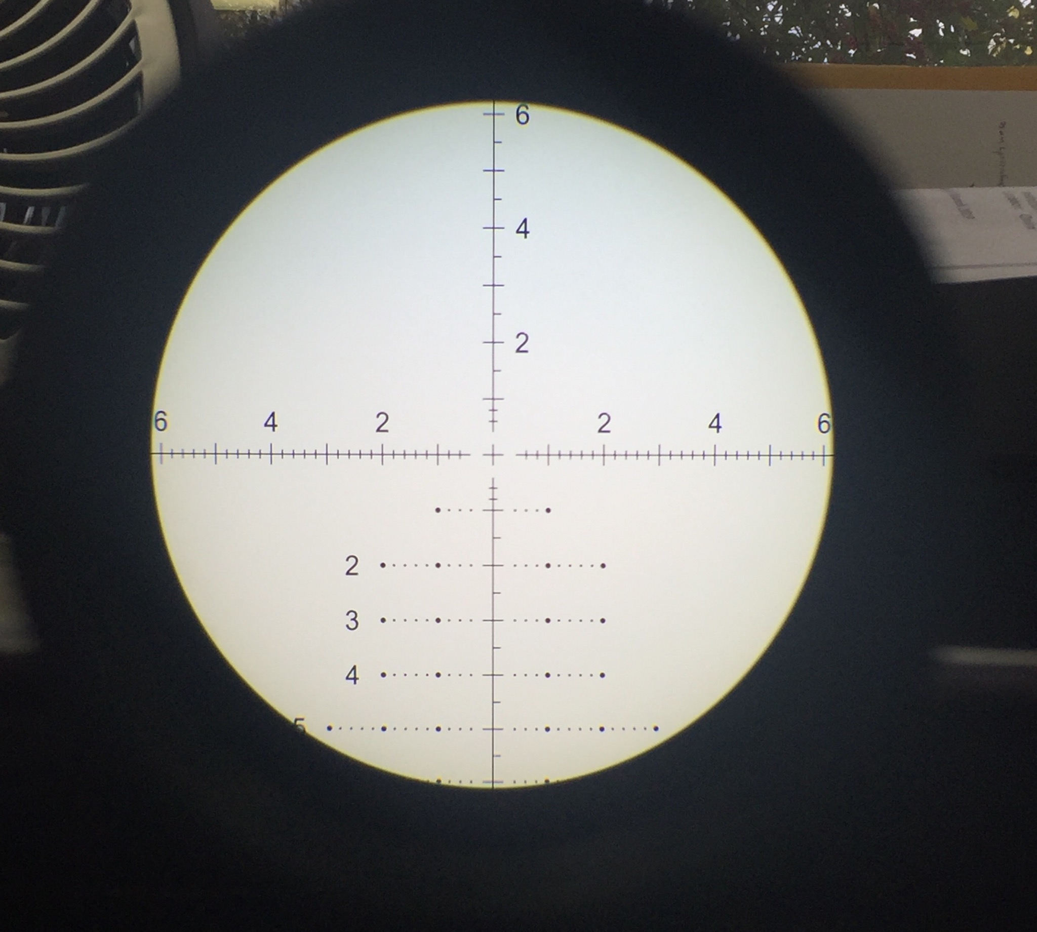

    H37 is your solution. It’s placed in the top half of the sight picture, unlike most other reticles, and will give you a lot more visible hold over at the higher powers.
    The H37 My SB 4-16x42 has 14.5 mils of hold over visible at 16x; it’s on my SR25, which only needs 9.7 mils to a grand, which is as far as I shoot it.
    Note: If you want to make little tiny groups or hit tennis balls at a thou, this isn’t the reticle for you. It’s designed to engage multiple “IPSC” sized targets (static or moving) at varying distances quickly.
    I haven’t touched my turrets since I mounted and zeroed it (2+ years, I think).

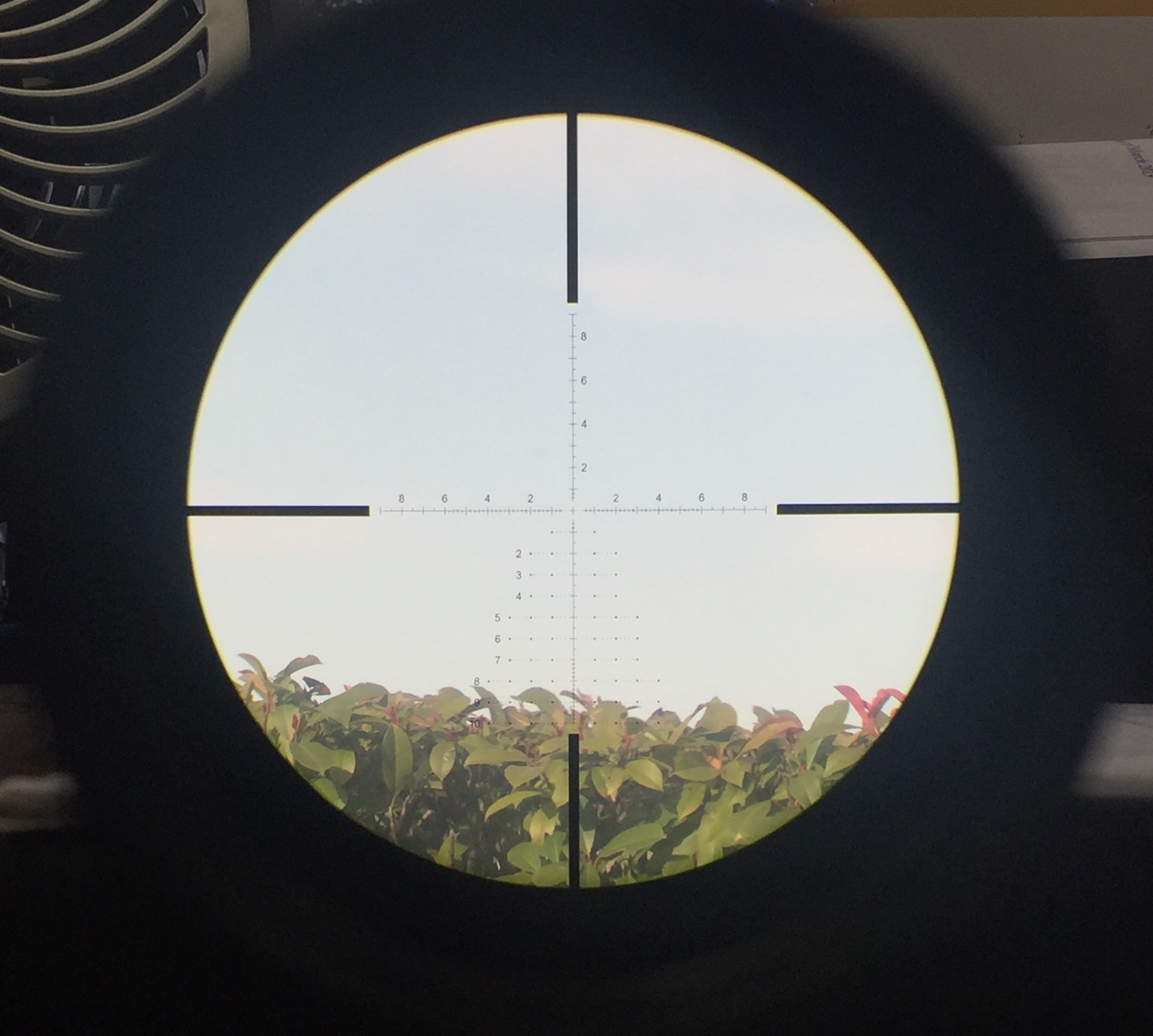

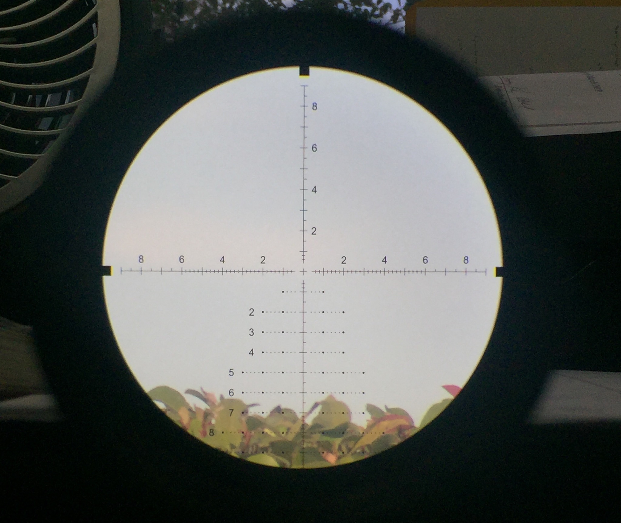

    In a FFP scope the reticle increases in size with magnification (the reticle is actually staying the same size as the target but as magnification increases so does the target and therefore the reticle as well). This is the main advantage of FFP, those marks for holds or wind are always the same regardless of magnification; whereas, SFP hash reticles must be calibrated to a specific magnification - there have been many shooters who have missed the shot by not having their SFP scope set on the right magnification when using some of those hold marks.
    As others have mentioned there is a myth that long range or ELR requires high magnification, in fact, just the opposite is typically the case and this is because at high magnifications atmospherics (like mirage) begin to play all kinds of tricks and most shooters have learned that backing down magnification decreases that warble effect allowing them to not overcompensate with a distorted target. A similar situation occurs at higher magnifications with wobble - let's take the 27x scope for example and set it to 27x and let's aim at a 1/2" dot at 100 yards, even on a bench you might notice your center crosshairs or center dot moving around slightly and if I ask you to place a shot dead center your brain is going to perceive this wobble and try to compensate so that you take the shot right when your eye sees that crosshair move to dead center, invariably many shooters try to compensate for this wobble and end up not getting the best group because they think they must have high magnification in order to get tight groups (myth), but if that same shooter backs down to say 15x they notice the wobble seems to almost disappear and they find their groups actually tighten up because they are no longer trying to overcompensate for that wobble but trusting the reticle is stable. Learning to stabilize your fundamentals will help greatly with this, but those will poor fundamentals often think magnification will help them when in fact quite the opposite tends to be true.
    So why then do we need a 4.5-27 scope if you're only ever going to use between 10-20x at the most? As others have mentioned some shooters like to have the magnification when they want it, let's say they are spotting for someone or they are trying to identify a target, there are some situations where the higher magnification is beneficial. Also, in the past many scopes have had a "sweet spot" which tends to be in the middle of the magnification range whereas the extremes have some optical compromises. Last year it appeared the NF 7-35x56 was the top scope used by top shooters in PRS, but ask any of them if they ever used 35x (heck I bet most never used above 20x) when shooting the course, and that's the key - "when shooting the course" and I doubt any used that high of magnification for long range shots. So why are shooters choosing the 7-35 over the 5-25 and my guess is they are mostly choosing the 7-35 not because of the higher magnification but because of other attributes of the scope.
    The reason why some of the tree reticle disappears out of view at high magnification is due to the limitation in FOV, again, others have already answered this question but the manufacturer is willing to allow this compromise because they know most shooters who will be using the far lines of the Christmas tree will not be shooting at max magnification (again due to atmospherics at longer ranges causing you to back down on magnification).

    I hate to drag an expert into such a discussion, but here goes anyway. Hey @koshkin, what would a FFP scope look like that could maintain visibility of the lowest hold overs of a EBR-7c (for example) reticle at 25x magnification? Maybe this is like asking "how long is a piece of string?" But, maybe there is a layman-understandable formula that approximates scope form factor- given a feature set...
    There isn't a simple formula, really.
    Generally, this has sort of been addressed. To see more of the reticle you have to have wider FOV. To be able to use those extended holds even when there is enough FOV, the optical system has to be really well corrected. Better than most scopes currently are. That is really why reticles where you see the tree/grid extend down 30 mrad away from optical center are a demonstrably bad idea (unless your application is area fire with a machine gun or something like that).
    For conventional scopes, in order to have more FOV at a given magnification, assuming the rest of the optical system can support it, you need a larger diameter eyepiece and/or shorter eye relief.
    I have talked to a few companies in an attempt to push a couple of designs toward maximizing FOV. I think there is a niche there to exploit, but I do not know if they will go for it and the best application there would be for guns with very moderate recoil.
    Of the current high end riflescopes, the one with the widest FOV is probably the new March 5-42x56 that should be hitting the market quite soon.
    Previous generation Kahles K624i also had rather wide FOV, though not as wide as the new March and not as good optically.
    In the high end tactical review I was working on last year, the widest FOV on the same magnification was with Tangent Theta and Minox. ZCO and S&B were just behind them.
