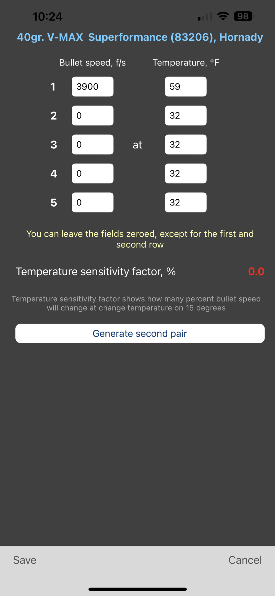

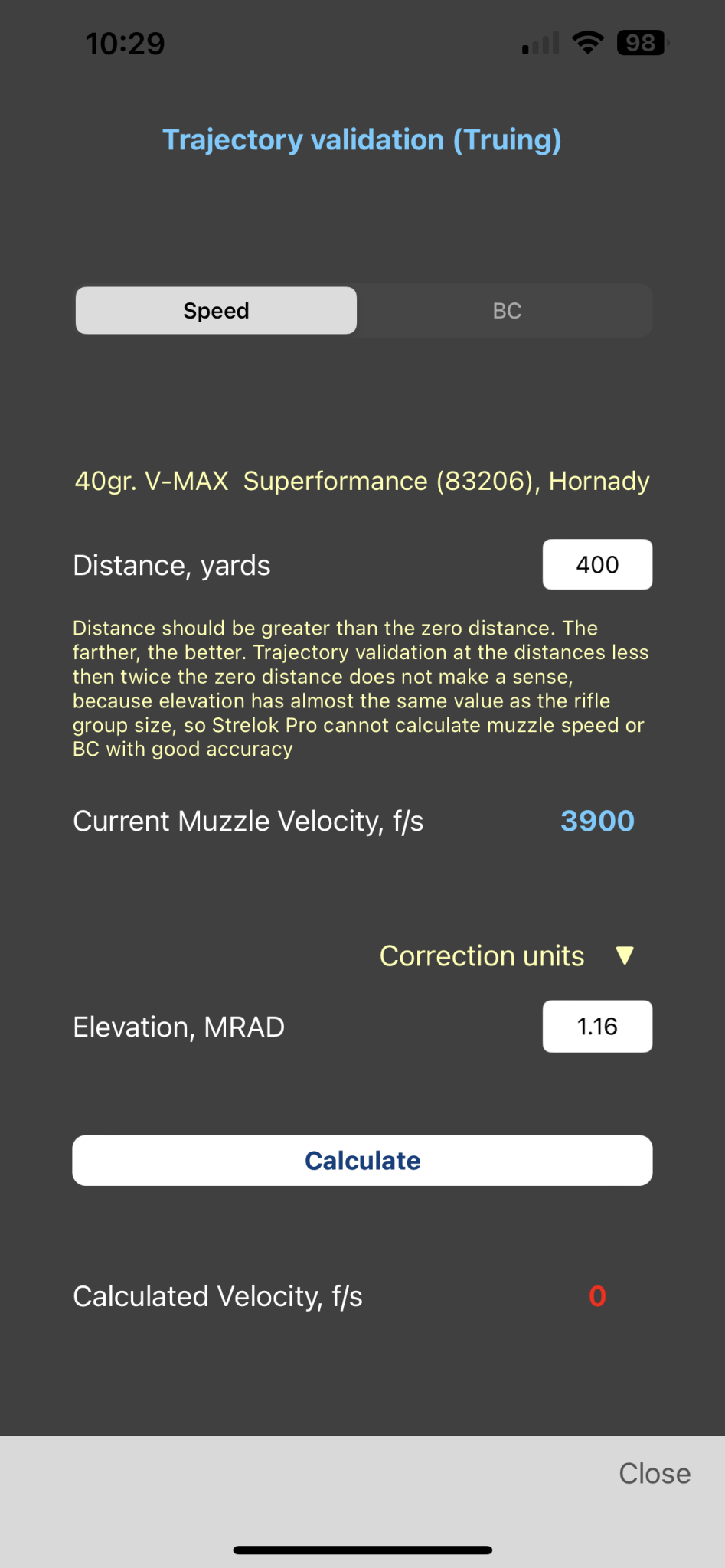

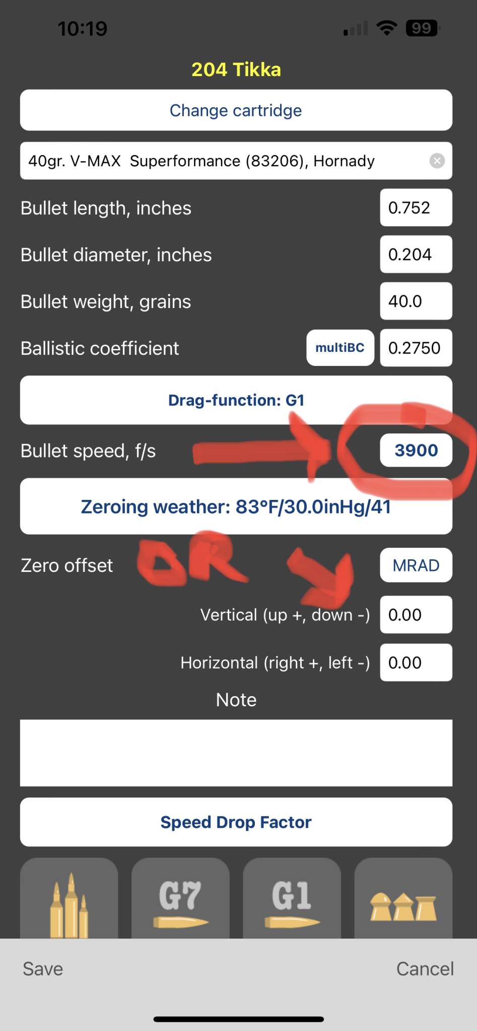

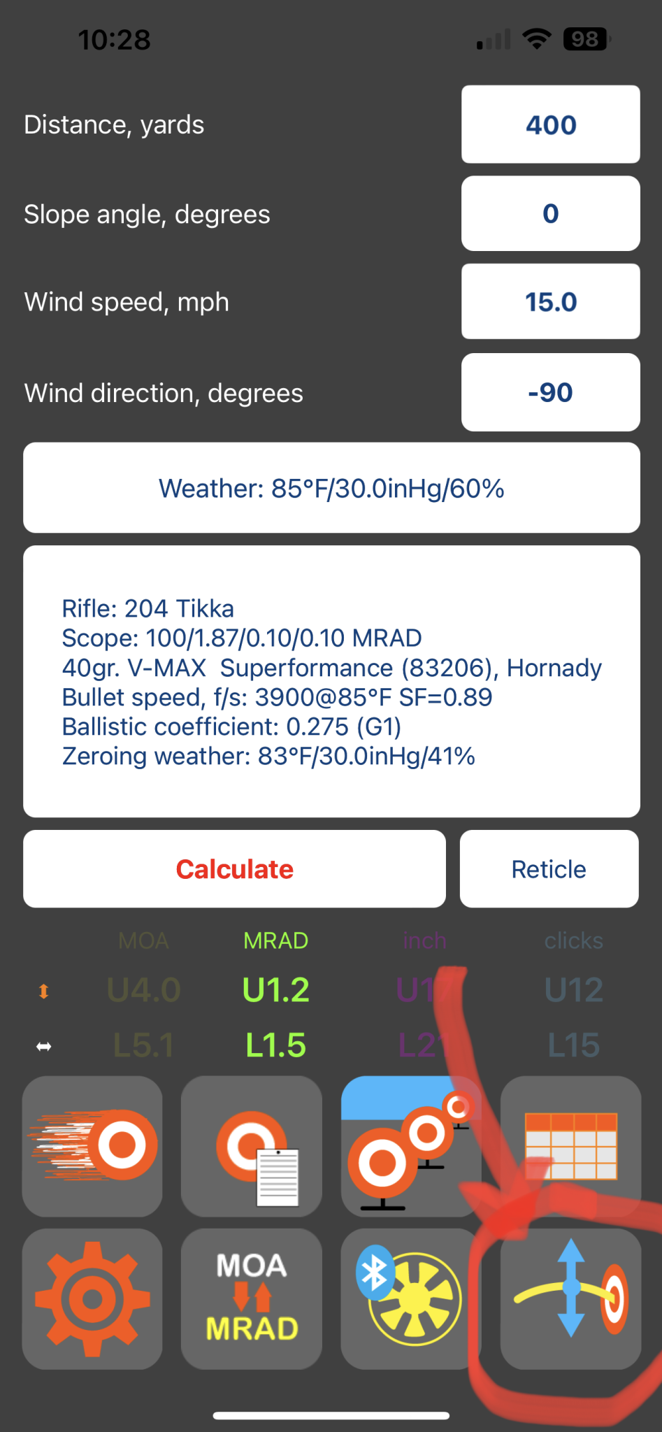

After truing your ballistic solver / calculator. Kestrel, Strelok, Shooter, AB, Hornady DOF, etc.
It's highly unlikely that any variable in velocity from MV at 6" to 10' or 12' away from the muzzle will affect your solution, or data.
To check, enter what you are getting for velocity at 10' away, say 3000fps, then figure out what you hold is at 600 yards.
Now change your MV to 3002fps and see what the solution is for 600 yards.
Probably not a number you can shoot.
Whatever that MV number is, while precisely accurate or not, is often adjusted when truing your calculator at distance.
There are several videos on youtube on truing a kestrel or other calculators. Probably a good place to start to get your head around the topic.

The MV you’re getting from the optical chronograph is fine, enter it into Strelok (along with the temperature), and then move onto truing. If you find yourself in colder/hotter temperatures later, by +/- 10 degrees, chronograph again and enter those numbers too and Strelok will start tracking your powder’s temperature stability for you (helpful for having dope that lines up all-day when matches can start in the 50s in the morning and heat up to the 90s in the afternoon).
Don’t true shit at only 100 yards. You should have zeroed your gun before starting any chrono shit. 🙄
You need more like 400+, with 500-600 yards being ideal for truing MV. Using the truing section in Strelok, true your MV first (it’s as easy as: it initially spits out 3.5mils, but you find it takes 3.7, that’s it).
Next, shoot out to 1000 yards or more and true it again, this time make sure to switch truing to BC instead of MV at the top of the screen (again, the BC number will change, if it initially spit out 8mils and it really takes 8.2, tell it so). Now you’ll have a legit BC (which may or may not be different from what it said on the box of bullets).
Basically, true using MV out to ~600 yards, true your BC at as far as you can go, the closer to when you go transonic the better. Somewhere around 750-800 BC starts to have more of a profound effect than MV alone, so be careful of truing/adjusting MV at those distances if 600 is hitting where it should… it just might mean your BC is a little off, as the further we shoot, the more human error and our reloading SDs affect our vertical, so sometimes it takes a few tries to find one’s actual BC.
Voila.
