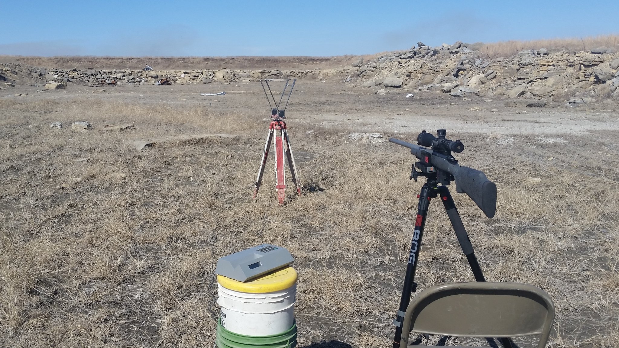

I was able to get out Friday for a quick chronograph test on my wife's 6.5 PRC. Factory Hornady 147 ELD-M out on her 24" Krieger barrel Averaged 2869.5 fps with an ES of 23.6 fps and SD of 9.9 fps. A little slower than the 2910 fps on the box. The weather was great,I only wish that I had had more time to test more loads.
