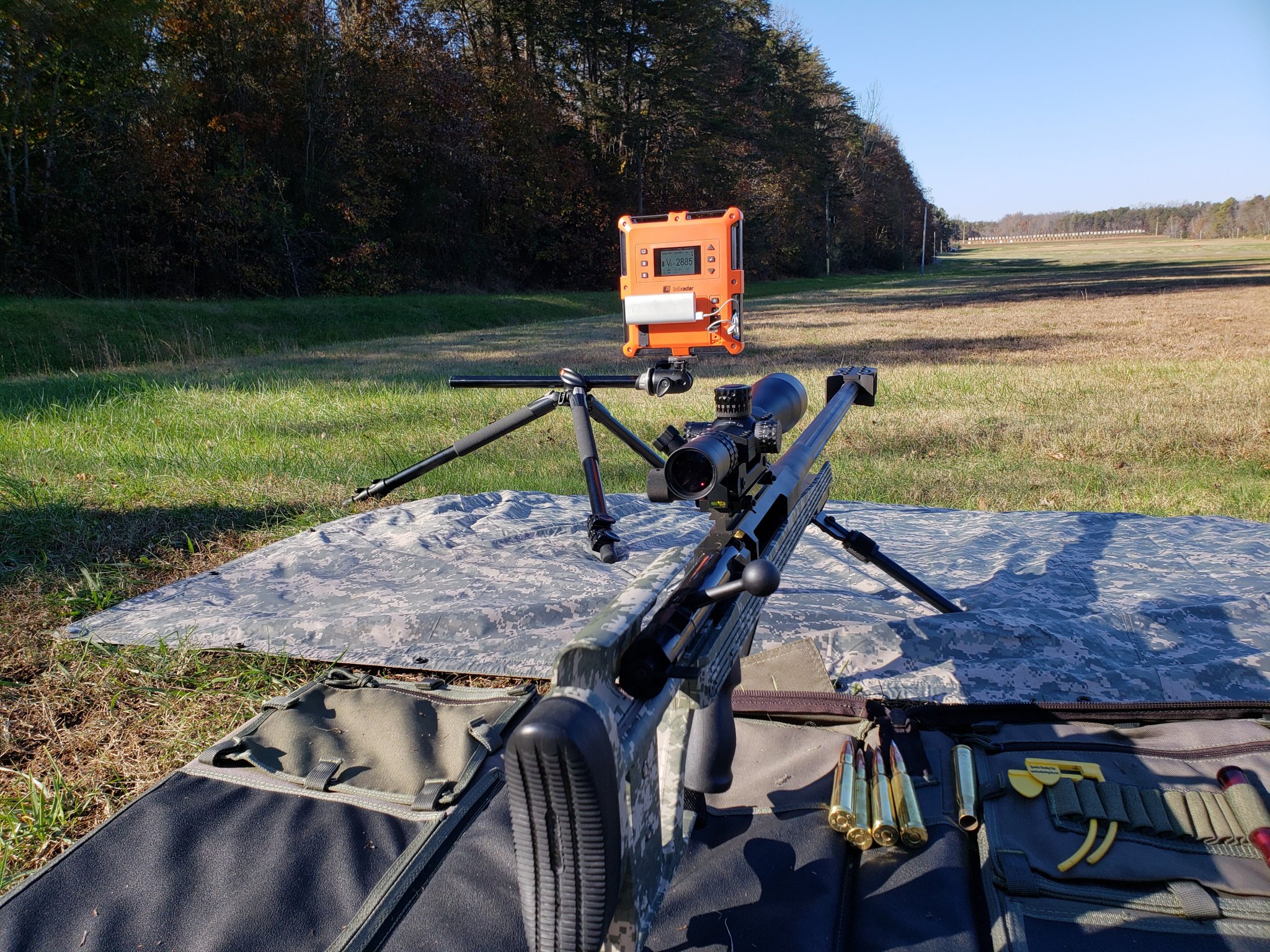

    I bought the Labradar, sold my MagnetoSpeed and gave away my Oehler 35P. Placement is the key, I have found that getting the Labradar above large brakes and in front of and closer to suppressed rifles works well and if using an external battery make sure that it is not low on charge.

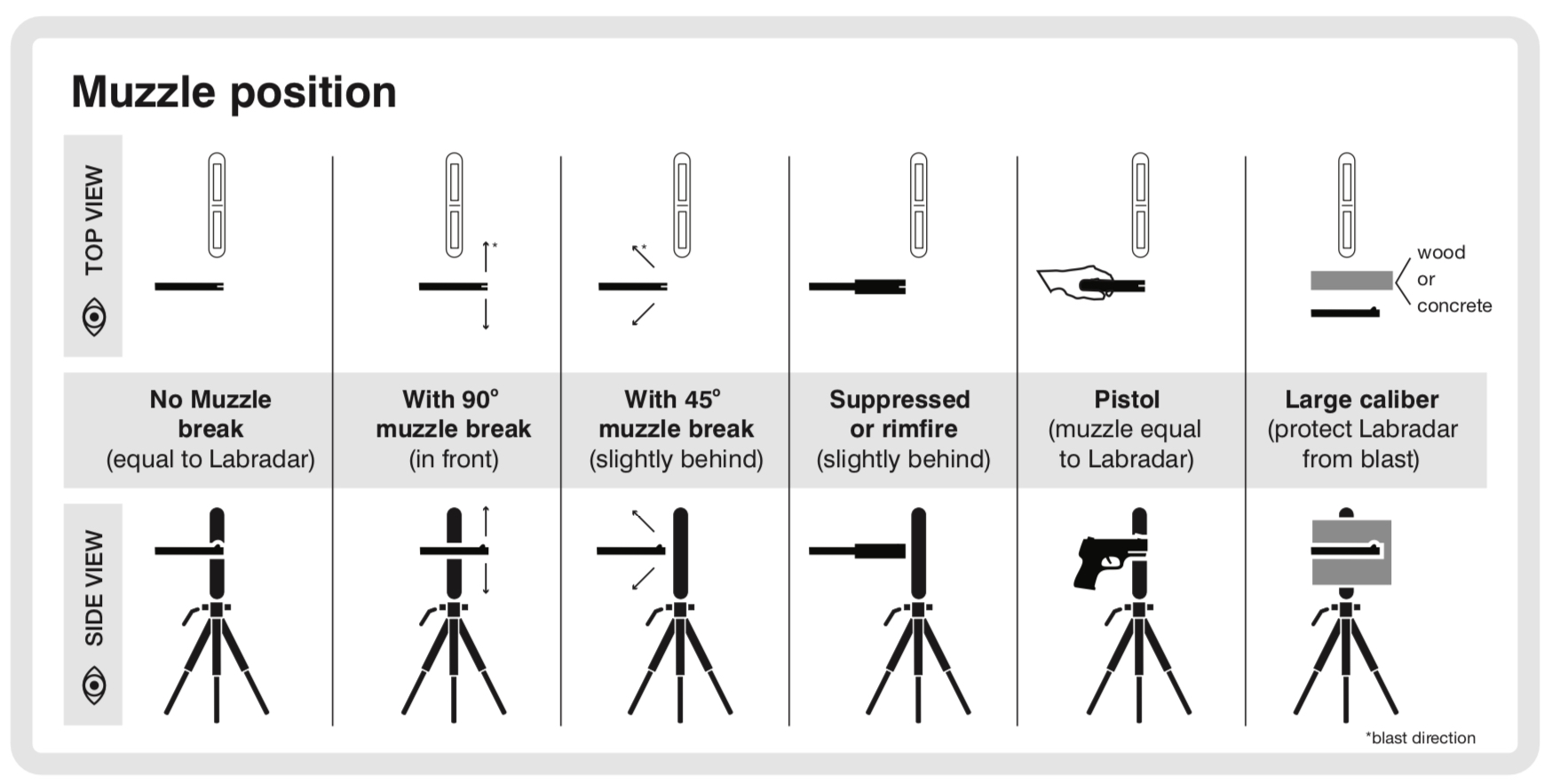

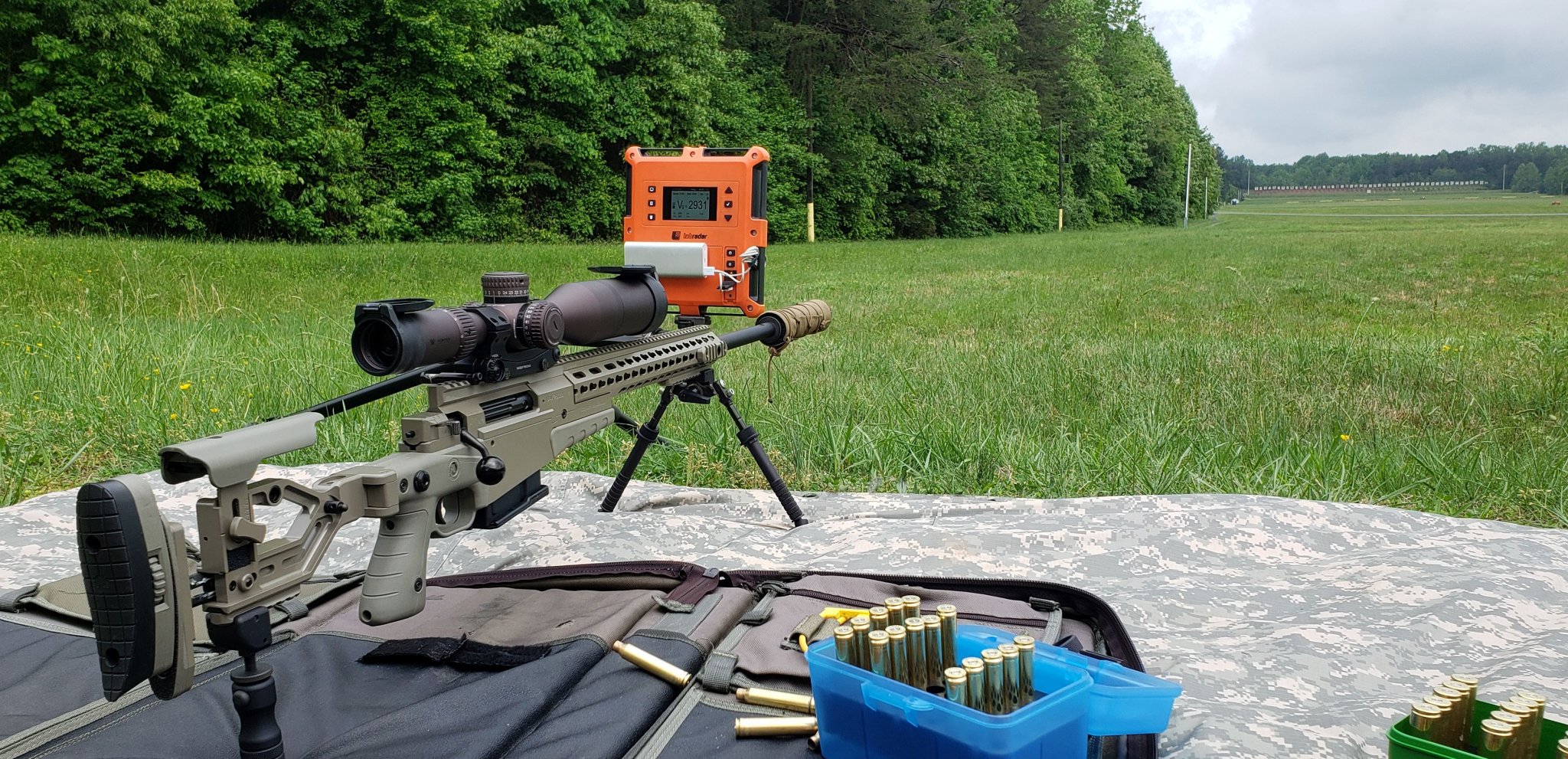

    Labradar was probably too close. Large magnums are supposed to be 12-18 inches away, as I recall, and you will likely need to adjust the sensitivity.
    Also, it should be placed behind the end of the barrel, not out front. Muzzle blast concussion will potentially damage the unit.

    Yes, mine won't pick up anything with the muzzle in front of the Labradar. I think the guy above who suggested a bad microphone may be right because the behavior of mine is really not consistent with what other people describe.
    The unit should be placed in front of the barrel with a brake with ports that direct any gas backwards, which he says he has a brake in the first post don’t know which direction the ports face. I actually think this is the biggest reason people are having issues with the labradar, improper setup. If you look at Fixr’s post with the pictures he has the unit setup correctly. Unless the unit is broke, it works and if it isn’t broke then it is user error not an issue with the labradar.
    I’m just going by the instructions provided by the people who designed and manufactured the device - here is the diagram from their documentation:
