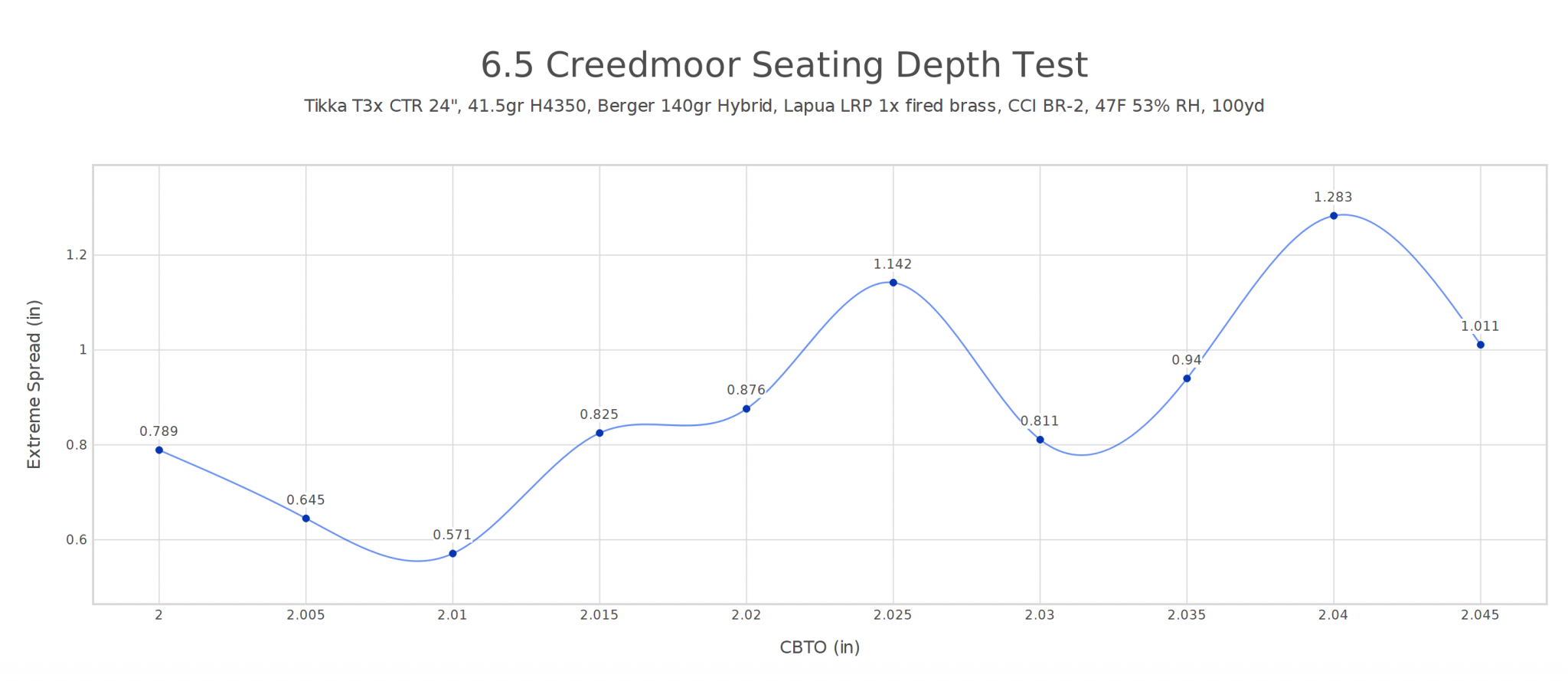

  • Added support for graphing seating depth data

This release introduces a major new feature... creating graphs for seating depth testing! By using this feature, shooters can plot cartridge length vs. group size and more easily identify seating depth nodes.
For example:
I'm exploring ways to further automate the process of inputting group size data, including using image processing and integrating with other ballistics apps. Let me know if you have any suggestions to improve this feature, or any further feature requests.

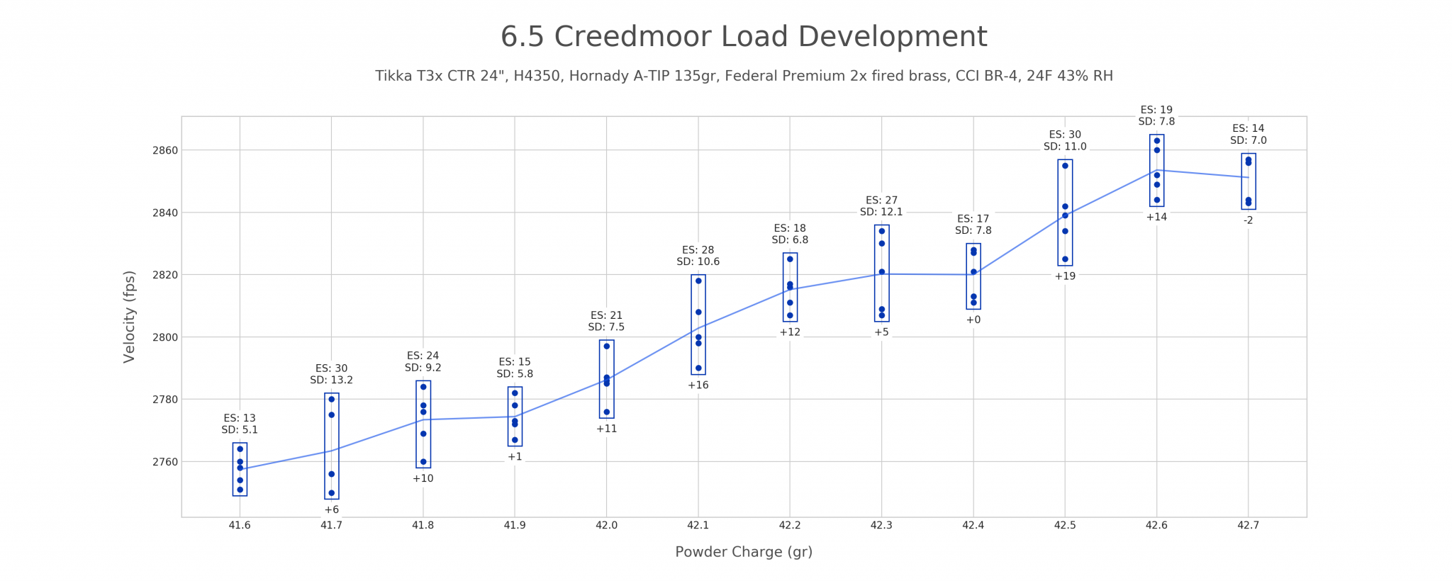

Hi everyone, new to the forum. I recently released a software tool I wrote to easily generate charge weight vs. velocity graphs without any manual data entry necessary. It currently supports LabRadar and MagnetoSpeed with SD card.
Full instructions are here, but basically point ChronoPlotter at your SD card or any directory with series data, auto-fill in the charge weights (if they're at constant intervals), then click Show graph and that's it. No manually typing in velocities, no screwing around in Excel.
These chronos store velocity data in CSV format, but the task of actually extracting and using that data from the SD card can be tedious. Some folks report handwriting their chrono data in a notebook to avoid it altogether. After experiencing this with my own LabRadar, I wrote ChronoPlotter to solve it.
ChronoPlotter is open source which means anyone's free to use it and look at how it works. The project is written in Python, but if you don't have Python installed you can instead simply download the prebuilt program for your OS:
Please note it will take a few moments for the program to start. Details here for those who are curious why.
The program also supports creating line chart + SD bar-style graphs, and has other features like handling round-robin (OCW) data where each chrono series contains one shot from every charge weight. You can also configure the graph in a number of ways, like annotating each series with its stats.
You can view the project in its entirety here: https://github.com/mncoppola/ChronoPlotter
Please let me know if you have any feedback, feature requests, or bug reports. Thanks!

I appreciate the kind words! I wrote the program since I found the Excel route extremely tedious as well (despite being an engineer), so I'm happy others are finding it useful too.
If anyone decides they'd like to donate to the project, I recently set up a page at https://chronoplotter.com/donate/. I'll look into maybe setting up a Patreon. :)

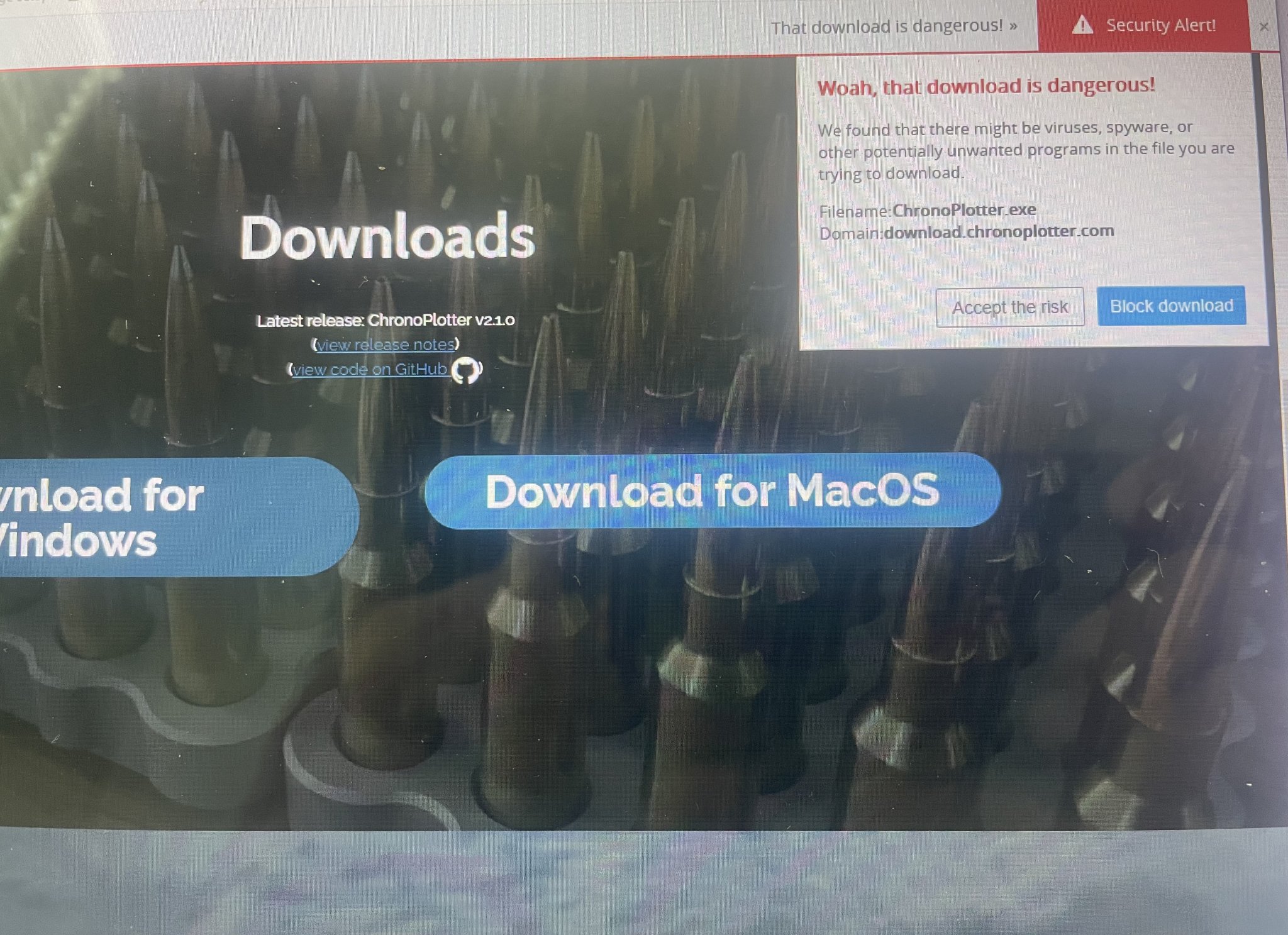

Anyone else getting this notice from their virus scanner?
That's super strange.... Which antivirus do you have installed? Many antiviruses will warn on downloading new .exe files that ones that haven't been downloaded thousands of times before.
VirusTotal (which scans against every antivirus) detects zero issues when it scans the URL: https://www.virustotal.com/gui/url/...1398c412f28b9d4b5b8b66e939539e57b43?nocache=1
The source code to the program is available here and anyone can inspect it https://github.com/mncoppola/ChronoPlotter
McAfee is what I use. Never had an issue with downloading anything and I download a lot of stuff regularly
I've submitted a false positive report to McAfee, hopefully they reply quickly!
