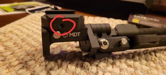

    Is this the pan adjustment screw? Loosened it, can't pan. Removed it, still can't pan. Also what is the silver fastener right under it?
