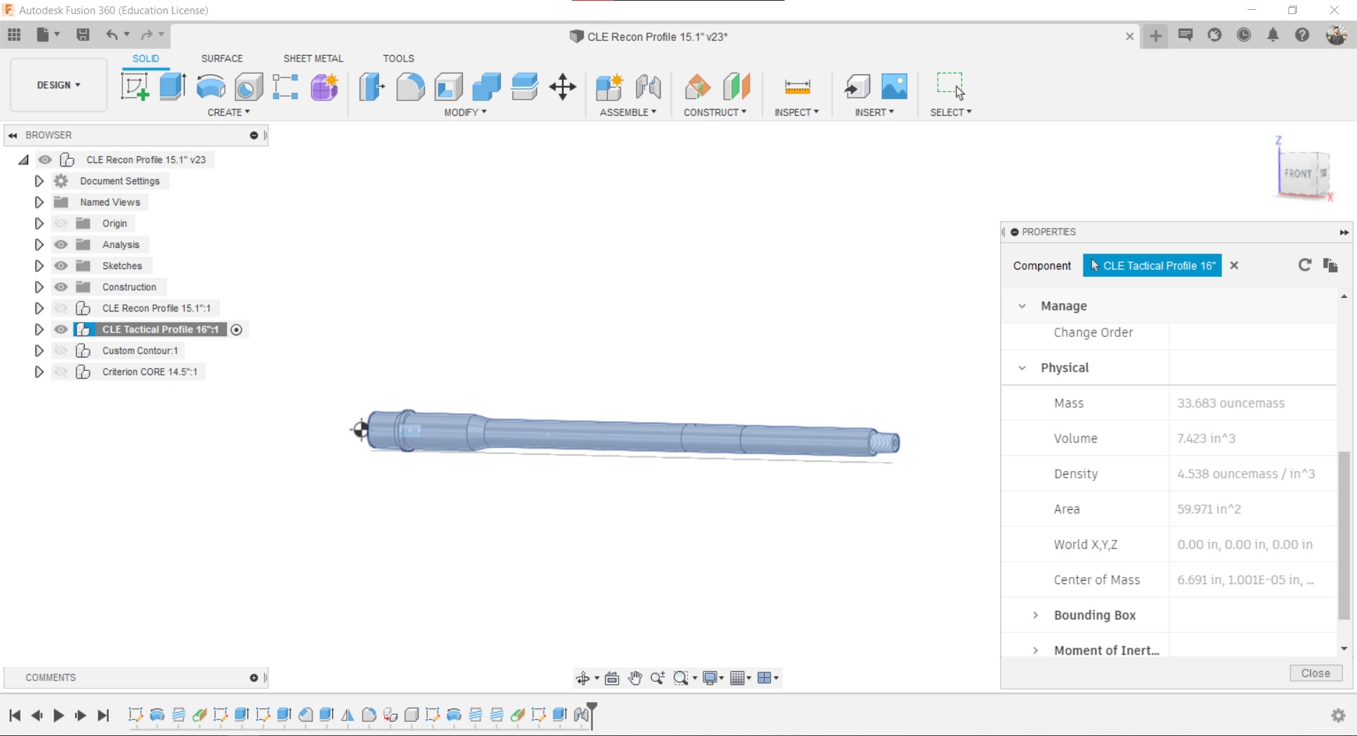

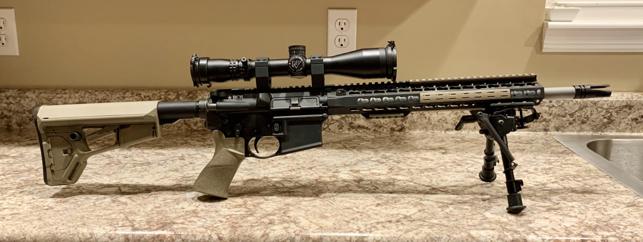

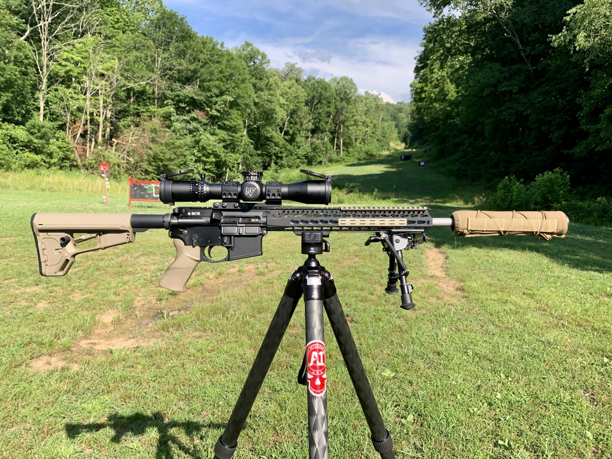

So I'm looking at exactly the same thing. Really, I don't mind the rifle being heavy overall, I'm more concerned about balance so the rifle feels like it points better. I'm looking at the 15.1" Recon profile, which is almost exactly the same as the Tactical profile.
This is roughly the Tactical Profile you describe. 0.750" to the gas block, a touch smaller to the muzzle. With the barrel extension, 2.1 lbs (don't mind that COM mark, it's got some approximate weights added to give an overall rifle COM).

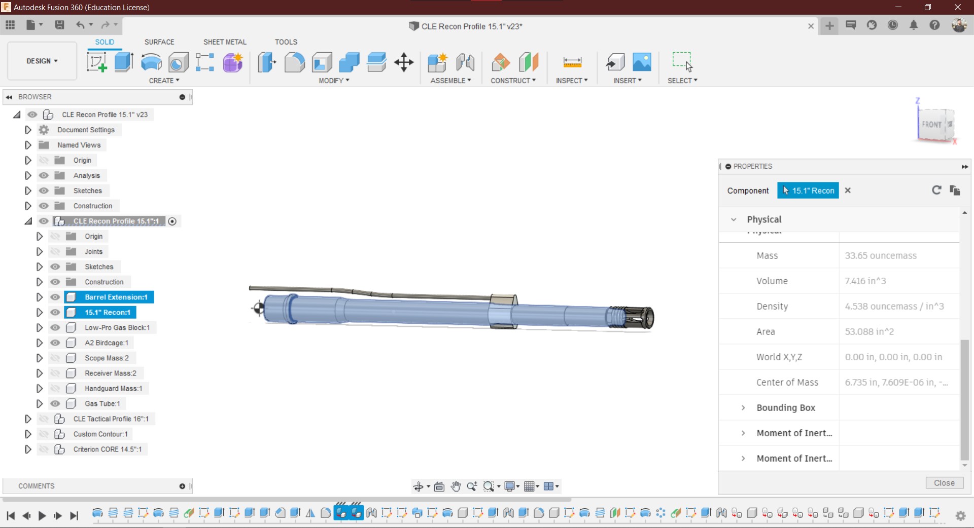

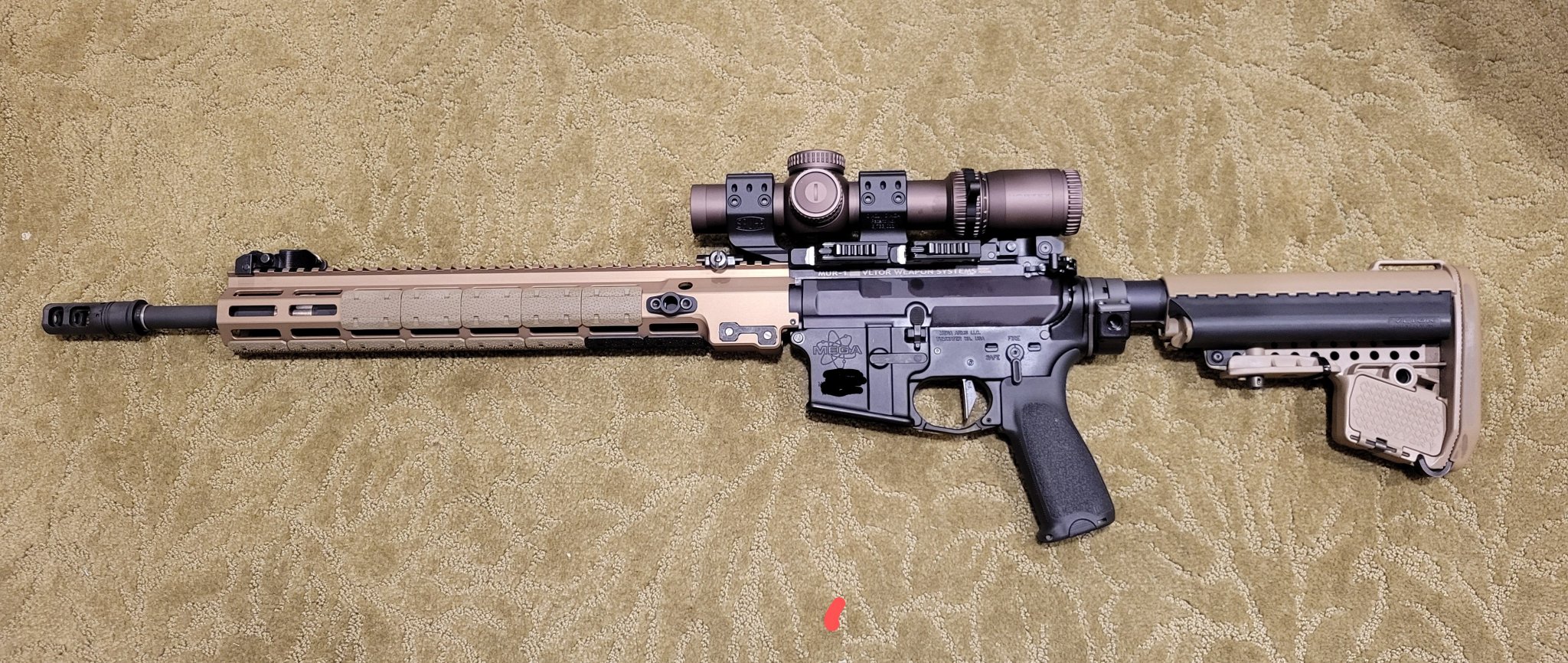

In comparison:
This is the 15.1" Recon barrel at roughly the same weight. As near as I can figure, the rifle is going to balance about 1" behind the front of the magazine unloaded and with no optic. I'd estimate that the modified tactical profile you are considering would move the balance another inch toward the buttstock.
In comparison:
In comparison:
Wow, what a phenomenal reply!
That looks pretty darn good. I think the extra touch of balance towards the buttstock on the (light)tactical contour would be beneficial since I’ll be running a k can on the end as well.
I had considered that recon barrel also, just not sure I want to deal with a pin and weld job on a 500$ barrel and CLE said they are turning to many barrels to mess with pin jobs right now.
Thank you for your help, this has been super beneficial. One thing I will note is while I should have clarified I’m not totally positive if there is any thickness increase before the gas block journal to provide a shoulder. I may have to clarify that before I order.

So I've been evaluating the CORE 18" from Criterion. And now that its mostly broken in I'm comfortable with its accuracy @ .72 on a 5 shot group using BH 77TMK factory ammo. Haven't ran it through the Magneto Speed yet. Its not stringing any more after 125 rnds. As far as the balance goes , its REALLY GOOD - feels like a shorter barrel. That being said, if the 18" CORE is this good, the 16 should be a no brainer.

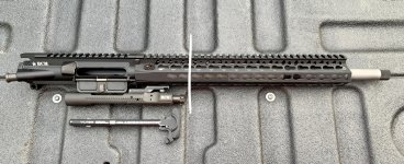

I have a CLE/Douglas 16.1" tactical upper, and it is actually for sale.
It weighed in at 9.6 lbs in the configuration in the photo (minus can and tripod). NF 4-16 is 30 oz. Spuhr 4026 is 8 oz. Harris bipod is 13 oz. That leaves 6.4 lbs for the upper, lower, Larue grip and Magpul ACS-L stock. That isn't bad for an all around rifle less optics.
I also had a NF 2.5-10x42 on it prior to the 4-16. The smaller optic saved 10 ounces, and it acted like a heavier carbine rather than a precision rifle.
I could weigh the upper, BCG, and CH this evening. I could find the balance point on the upper as well.
