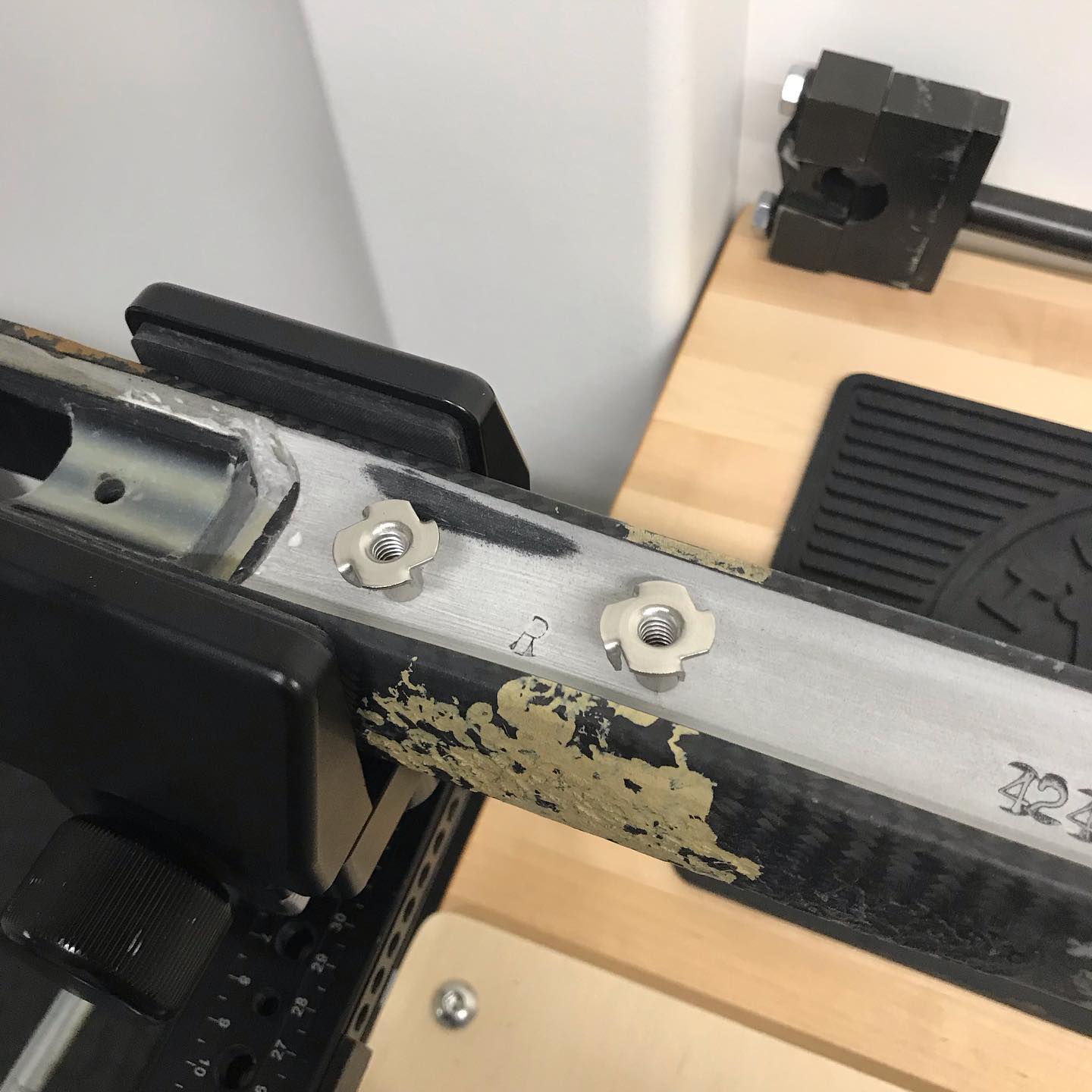

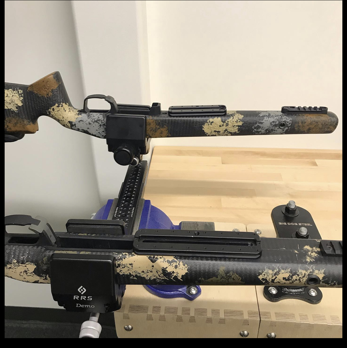

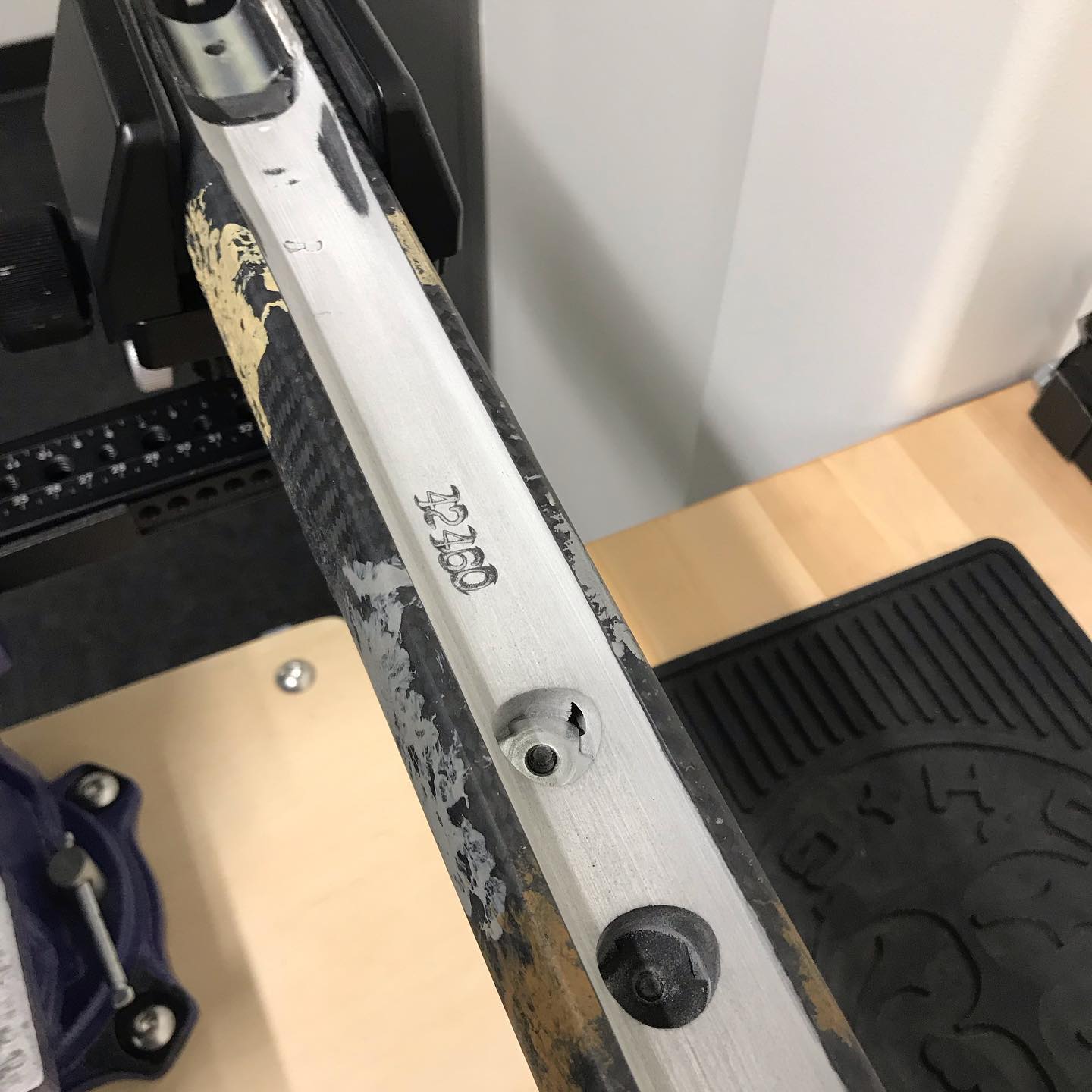

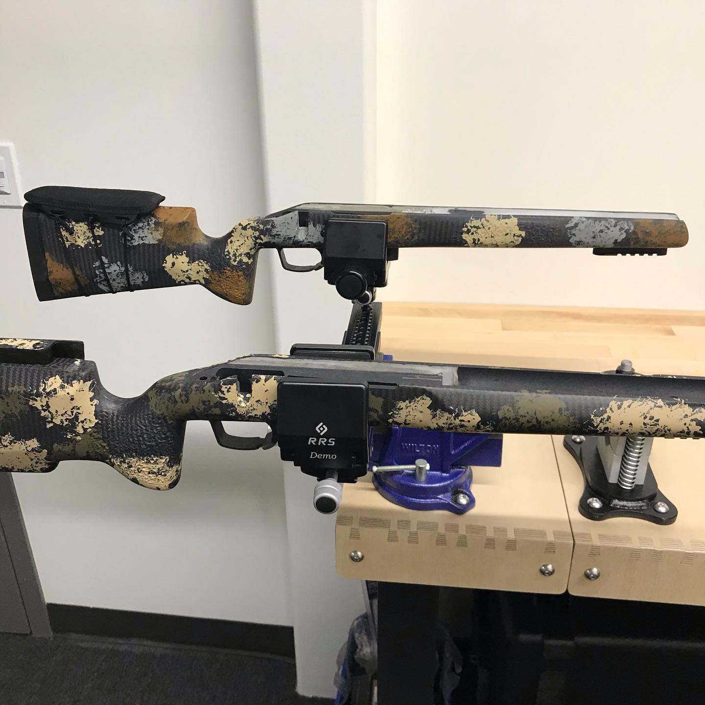

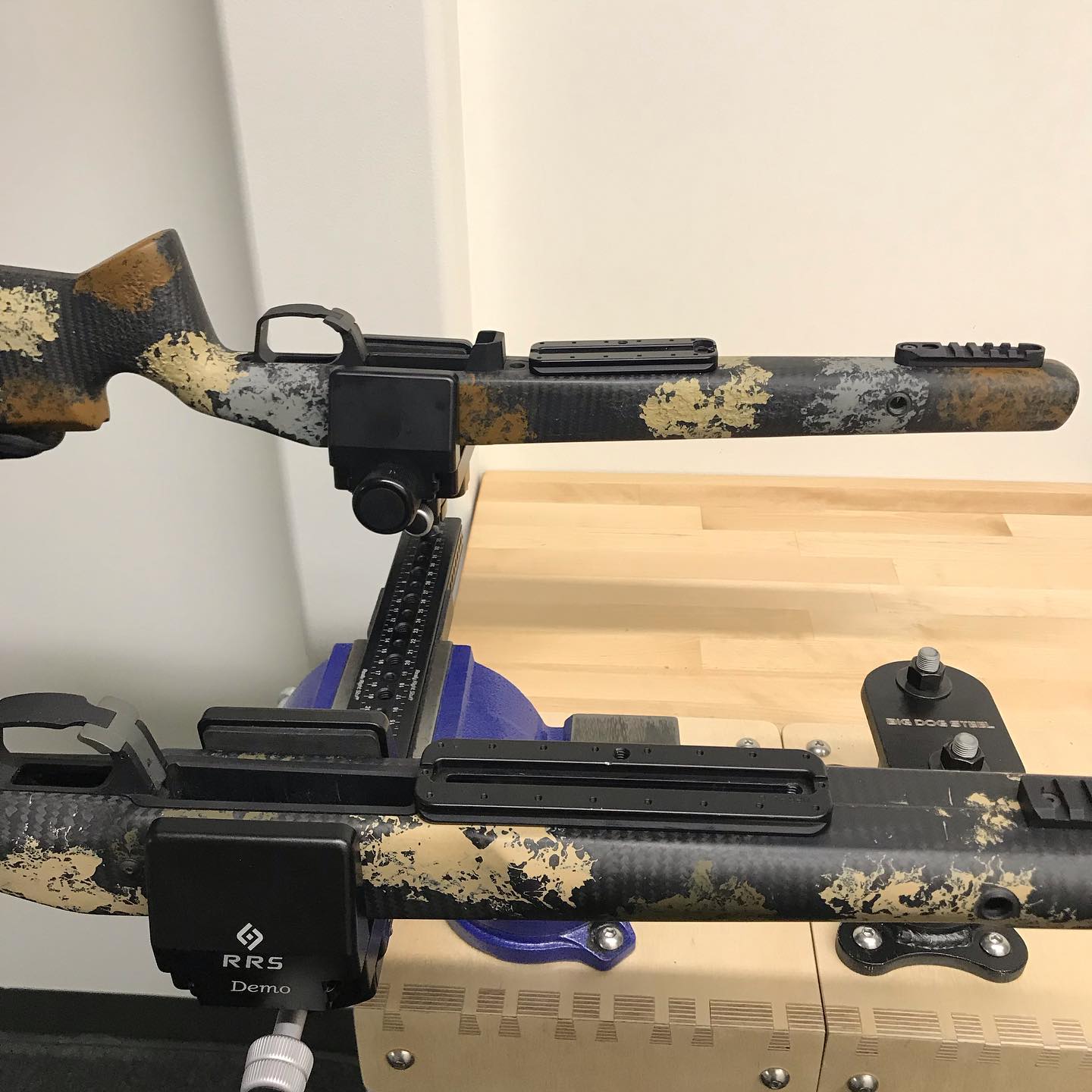

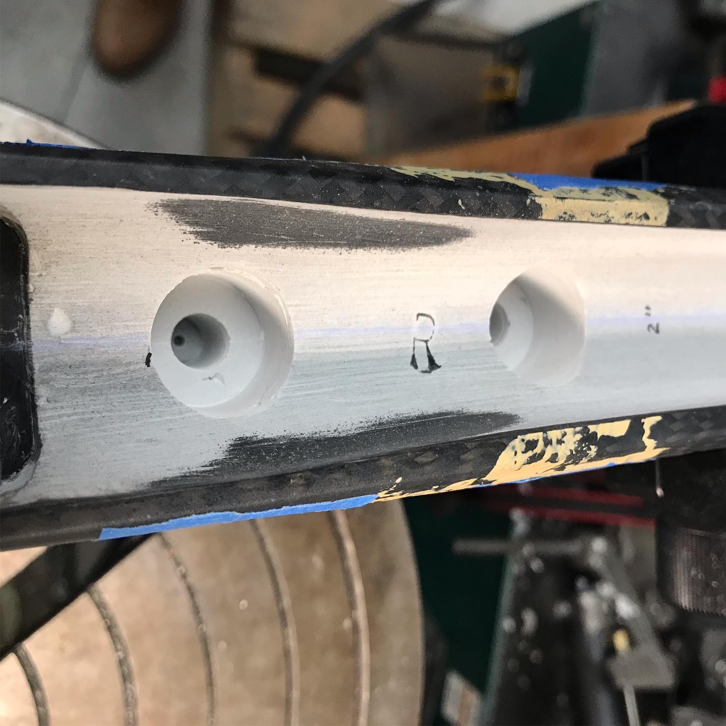

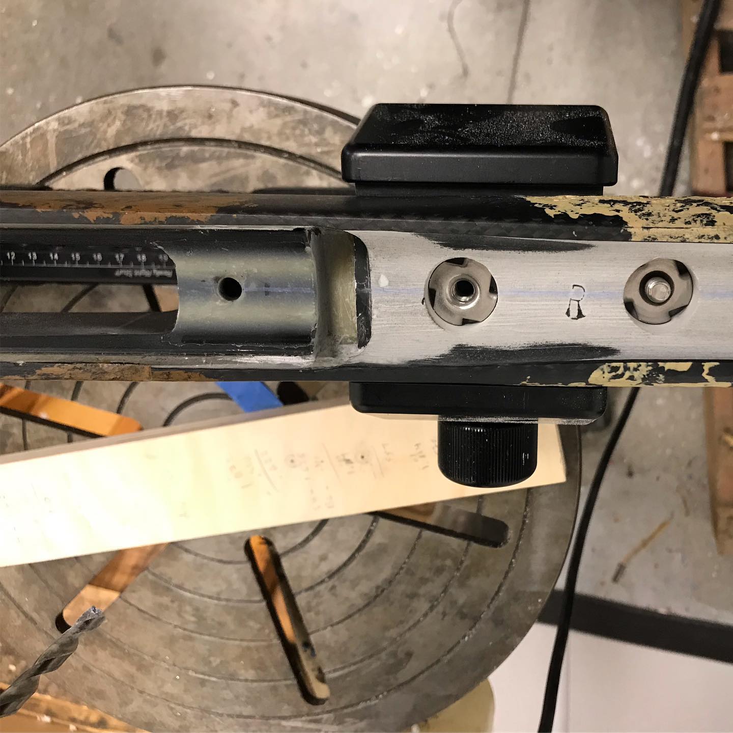

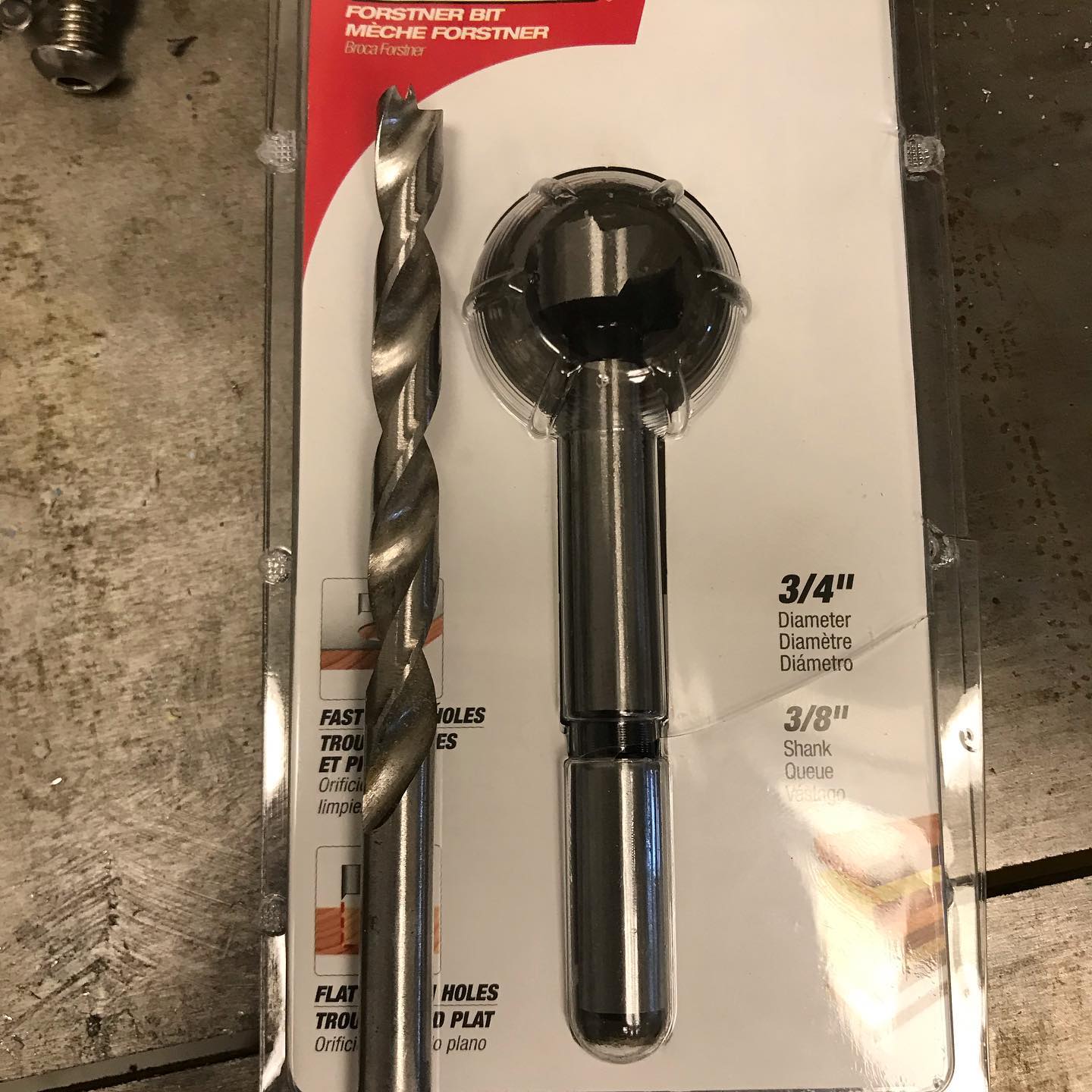

We accomplished our first inhouse rifle plate install for a hunting setup.
So many customers call and ask how to do an install at home. We typically give them the answer told to us by a competent gunsmiths, which was too send it to a competent gunsmith, since most charge barely anything for the process and its fast compared to other gunsmithing processes.
But we really wanted to do it our selves so I could have more of an appreciation for what these home builders are going through.
I will say we are definitely not gunsmiths.

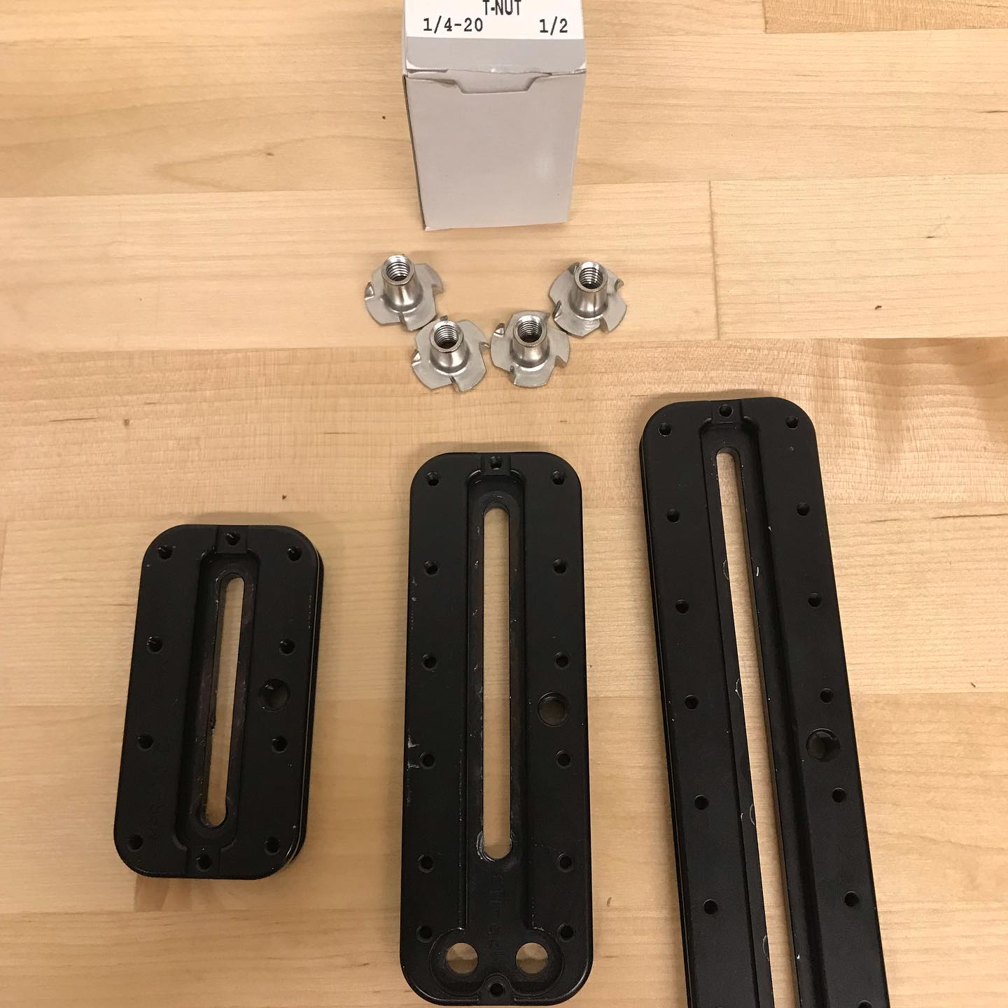

Pick your desired stock.
Decide the rail you would want, Left-Right in picture: MPR-73/113/1.
Purchase 1/4”-20 x 3/4(1”) button head screws, and the corresponding threaded T-Nuts.
Research what competent smiths do.
Measure and decide your placement of T-Nuts.
Check for fit and cool factor.
We used a Forstner 3/4” bit for the large diameter T-Nut and finished it with a 5/16” Brad Point for the thru hole.
Built a jig to level the mating surface of our stock to the drill press.
Drill large hole, then small hole.
Tighten the T-Nuts to sink teeth into composite, if using epoxy be careful not to get it on the threads.
Mount it up and admire your work.
We would do a few things differently next time. Will probably do a post again tomorrow on our 300 PRC on what we did to make it faster and ensure straightness.

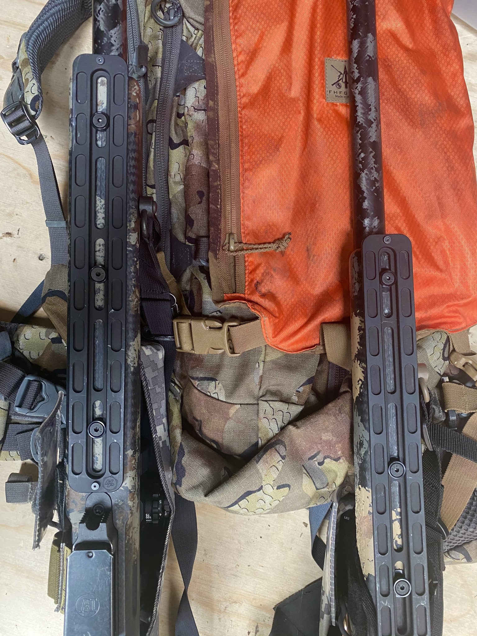

Copied from my other post:
Zback - think twice about using the tiny rail section. Yes, it works, but it could work better.
In the field sometimes you'll have to set up where the vegetation or angles dictate the tripod legs go. Especially when shooting up or down the ability to slide in the clamp for the final adjustment is really nice. It is also really nice if you have a prone shot and want to use your tripod to be able to slide it to the front.
Other than that, as mentioned it is faster to insert, especially when you're looking at the animal, shoots great off a backpack (more stable than the bare stock and doesn't get hung up under recoil like a bunch of small plates), and easier if you're setting up in the dark for a NV hunt.

I did what Mile High suggested.
When I put on my next plate, I am going to bed the plate to my stock for added stability. Will put the epoxy on the rail and release agent on the stock. I think there is a tiny bit of play there under recoil.
Imagine shooting this off a pack it doesn’t slide smoothly.
Note that on a couple of my hunting guns below the bottom is smooth- this makes for a wide stable platform when using a pack or a hasty branch, fence etc. the tripod can also slide forward and act as a bipod.
yes I agree I don’t usually carry a bipod hunting any more- especially because the tripod can be moved forward
I get the weight issue. The smallest RRS plate I have is 2-3/4” long and comes in just about 2oz (longer much heavier) + the front pic mount for about 3.5oz. That’s about the same weight as my full length ultra-light Henderson rail. It’s actually lighter than the picture Mike posted.

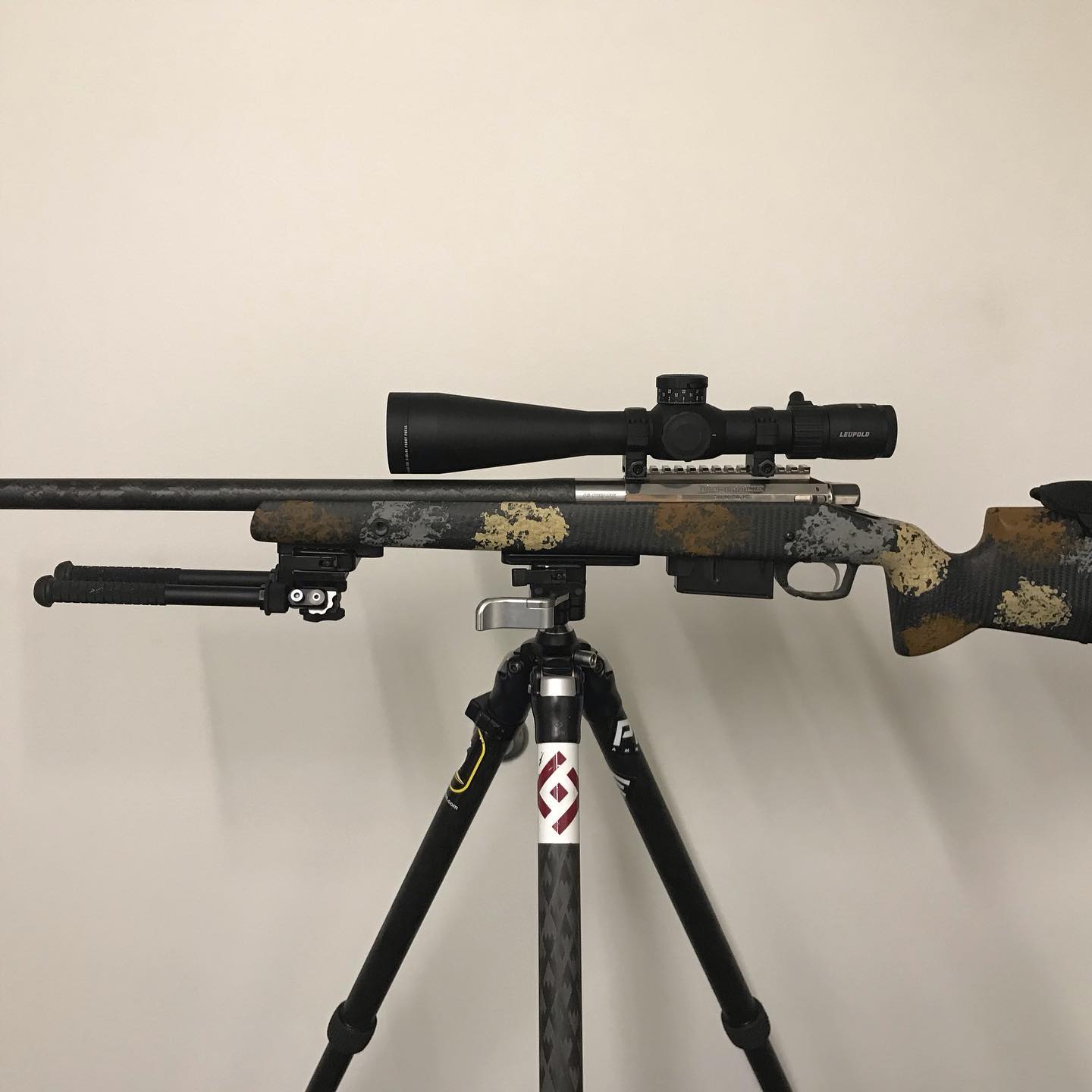

Excellent points, it comes down to preference and other ways shooter will build positions. The extra weight isn't that much, but I am with Mike, save weight wherever I can. My match gun has full ARCA rail and it does everything you say. I practice more in the field hunting positions, and have yet to create a shot opportunity that couldn't be solved quickly with a tripod.
I run a small bag with Git-Lite, so hasty positions off branches and fences are covered. It also serves multiple other purposes off a tripod, so I carry it.
I haven't noticed my rifle hanging up on my pack in prone, but I don't use it much. I just have never been in a hunting situation in the four years hunting that I could be prone. I have been on a tripod for all my long range shots. Tripod is usually already out for spotting when it comes time to shoot. With a buddy, I set up the tripod, got dope, dialed his turrets, and he was shooting in a minute.
I have practiced tripod deployment, and like Frank says, distance gives time and opportunity.
Its all about the tripod, 100%.
The minimum plate length I think is 4 inches and anything between that and full length will be shooter's choice.

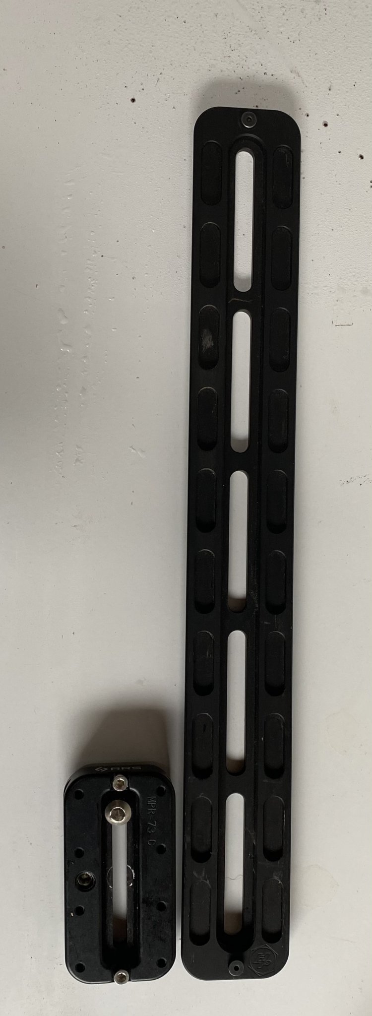

Well again, just in case I wasn't clear the RRS rails are really nice and very robust. Their 6" rail weighs in just about where my 10 &12" rails do, and with either the 4 or 6; plus the pic section the system is heavier. Truly it's splitting hairs either way.
I have only run into a couple of situations shooting up/down steep slopes, or low when a rear racing leg is necessary, where sliding the gun back can make a poor leg set suddenly work great. I have found that *if* you get the chance, a high prone with the tripod up-front with the backpack as rear support, is simply amazingly stable. That said the 6" RRS would probably be enough rail to help in all but the high prone. the 2.9 is way too short but looks cute on the rifle. All that said I always try to set up as close to the mag well as possible.
The 2.9 is what I usually see on guys worried about keeping their rifle light. (But again, my 2.9" RRS plus my front pic plate was the same weight as my full rail). I also don't use a sling on my rifle so losing the front sling stud (although I have flush cups) isn't an issue. I tried various methods of carrying and find the very best for me is the Kifaru Gunbearer. It holds the rifle secure, the muzzle low (so it isn't getting caught in the low hanging branches), and deploys lightning fast.
I would not go change what works for you (it is all too close), but if I was a new shooter asking about mounting for hunting I would really consider the ultra-light full rail may be in the 10" size.
