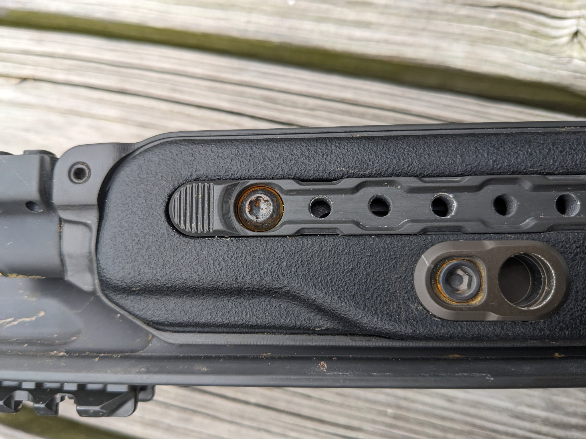

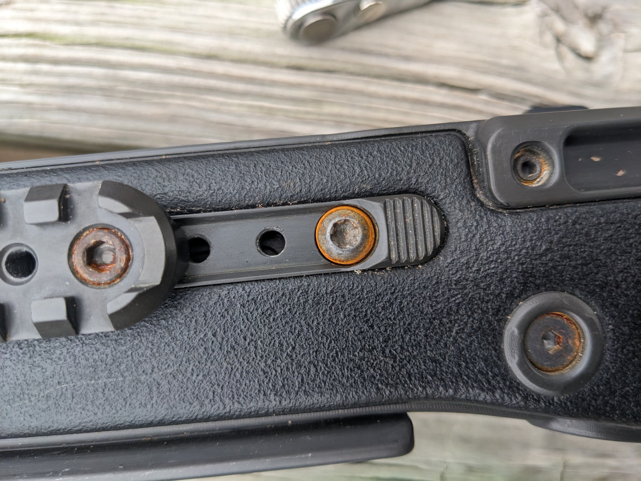

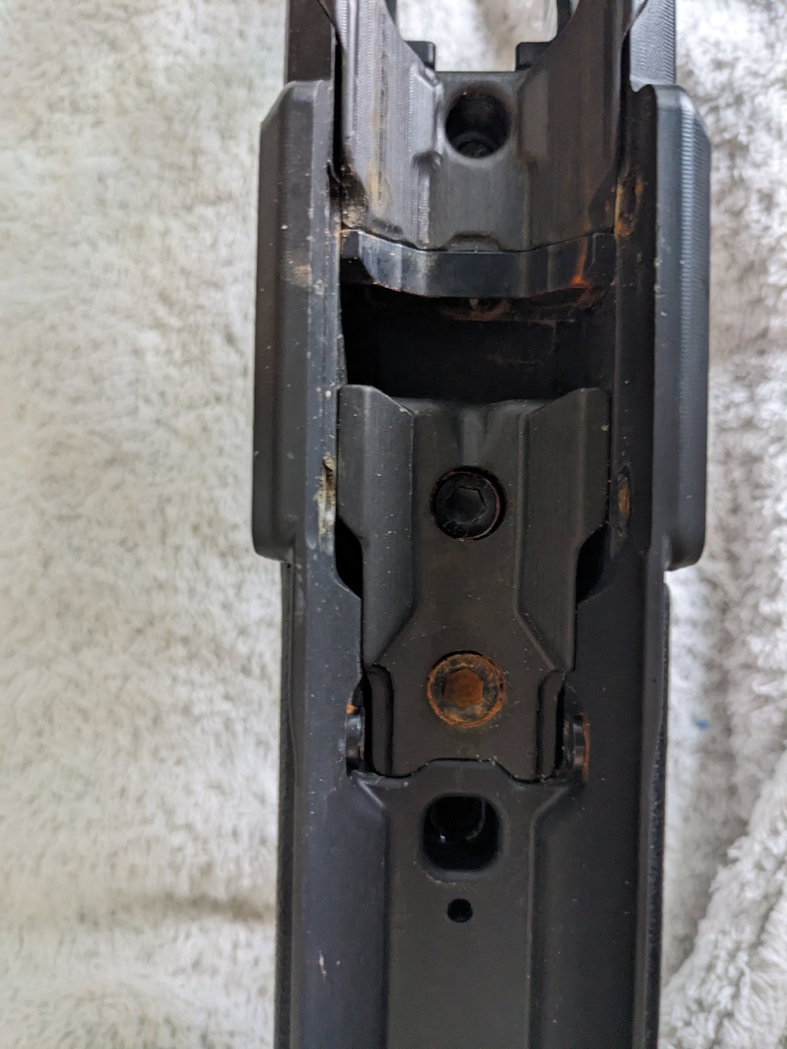

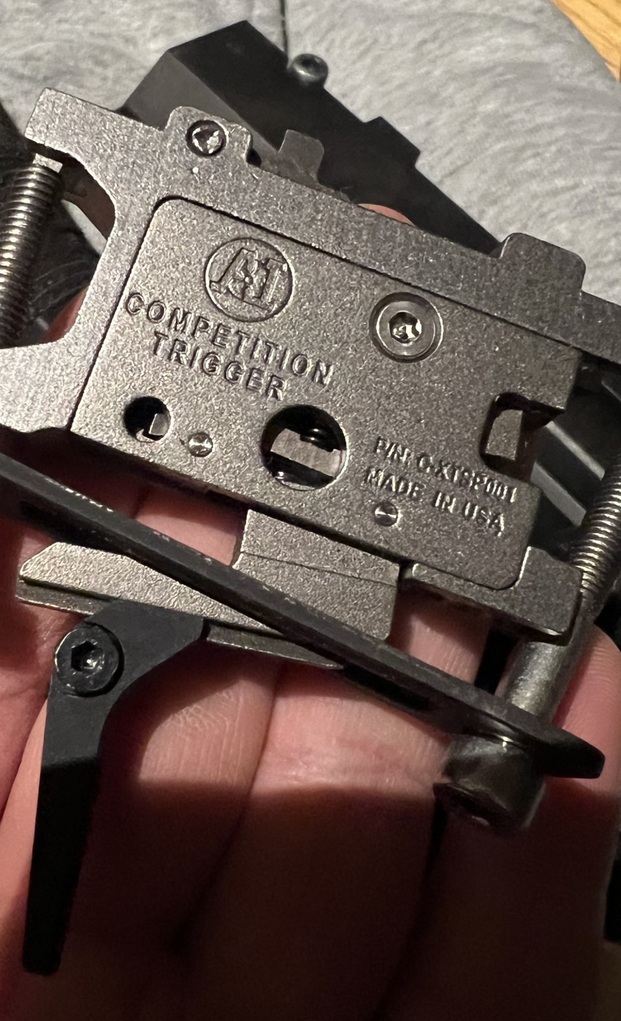

Just went through this myself, shot the Leupold Steel Challenge and it rained all weekend.
Moisture gets trapped EVERYWHERE. A lot of bolts on my chassis developed varying levels of rust. And my chassis has a lot of bolts. I removed most of my chassis bolts and soaked overnight in WD-40, which only got me so far. A quick soak in CLR started to immediately strip off the coating of the bolts, so that's a no-go. I'm at the point that I'm just going to replace a lot of bolts.
Take your chassis apart and remove any bolts - even if you don't see any rust on the bolt head, there may be moisture trapped on the threads. Oil them and use a nylon brush if necessary. Remove your action from stock/chassis' and deal with any surface rust that could be hiding out of sight. Check the set screws on your scope, etc.
I could've done a better job making sure I got rid of any trap moisture after each day. I honestly didn't anticipate these issues to this degree, which is has been a learning moment for me. In the future if I shoot another match that's this wet, I'm going to do a vetter job getting ahead of these potential issues.

Exactly where I was at...luckily i dont have that many bolts!
Reactions: kthomas
That match was WET! And all the humidity when it wasn't raining didn't help at all with equipment drying out.
Glad you don't have as much bolts as I do :ROFLMAO: I've spent hours tearing things apart trying to get them cleaned up and mud off of them.
Don't forget about the bore of your rifle either. Give it a cleaning as soon as you can. I'm still on a Texas trip, so I gave my bore I quick CLR soak and patched that out and ran a few patches of M-Pro 7 cleaner through it. Conveniently forgot my oil which I thought I packed, as it would be good to put a patch of oil through their to protect the bore.

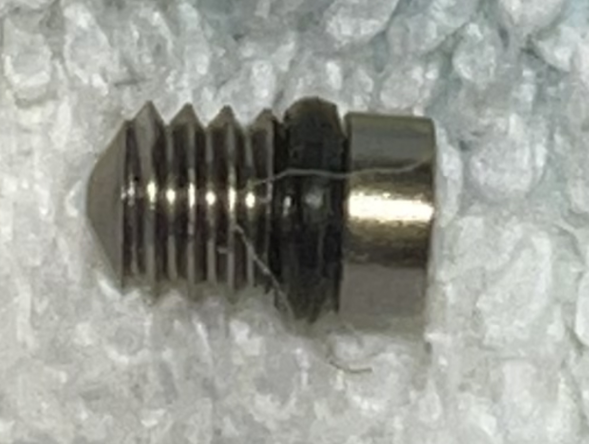

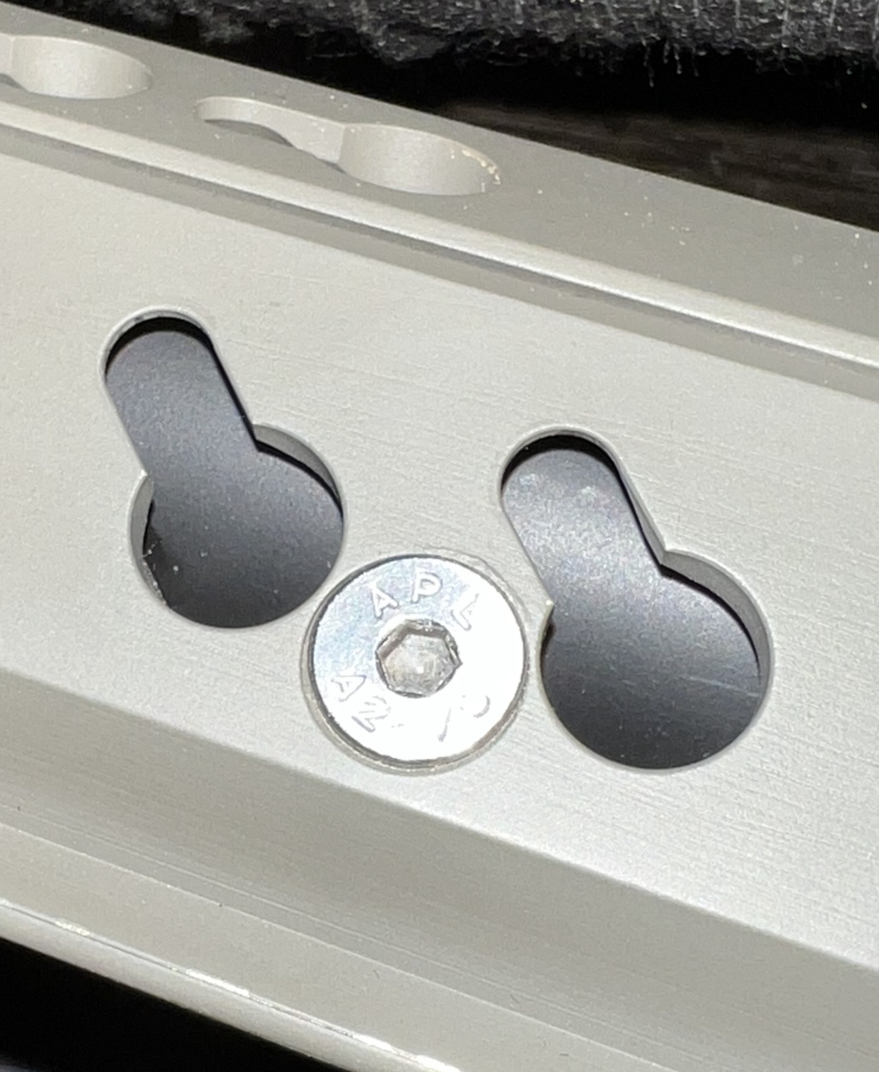

I took mine apart 3 days after the match. AI, NIghtforce, Spuhr = no rust at all 😝. There was still a load of moisture under the action.
That shit finish / coating on the hardware. Your chassis manufacturer cheaped out.

I got drenched at three matches last year, I even managed to get water on the inside of my T1x bolt.
Basically fully strip everything and be very liberal with WD40/CRC/CLP.
If you can’t clean the gun straight away they squirt everything with oil to displace the water and try to pour the water out of any holes/ areas that’ll collect water.
I went shooting in the rain a few days ago and water had collected in the hollow areas of my KRG Bravo.
