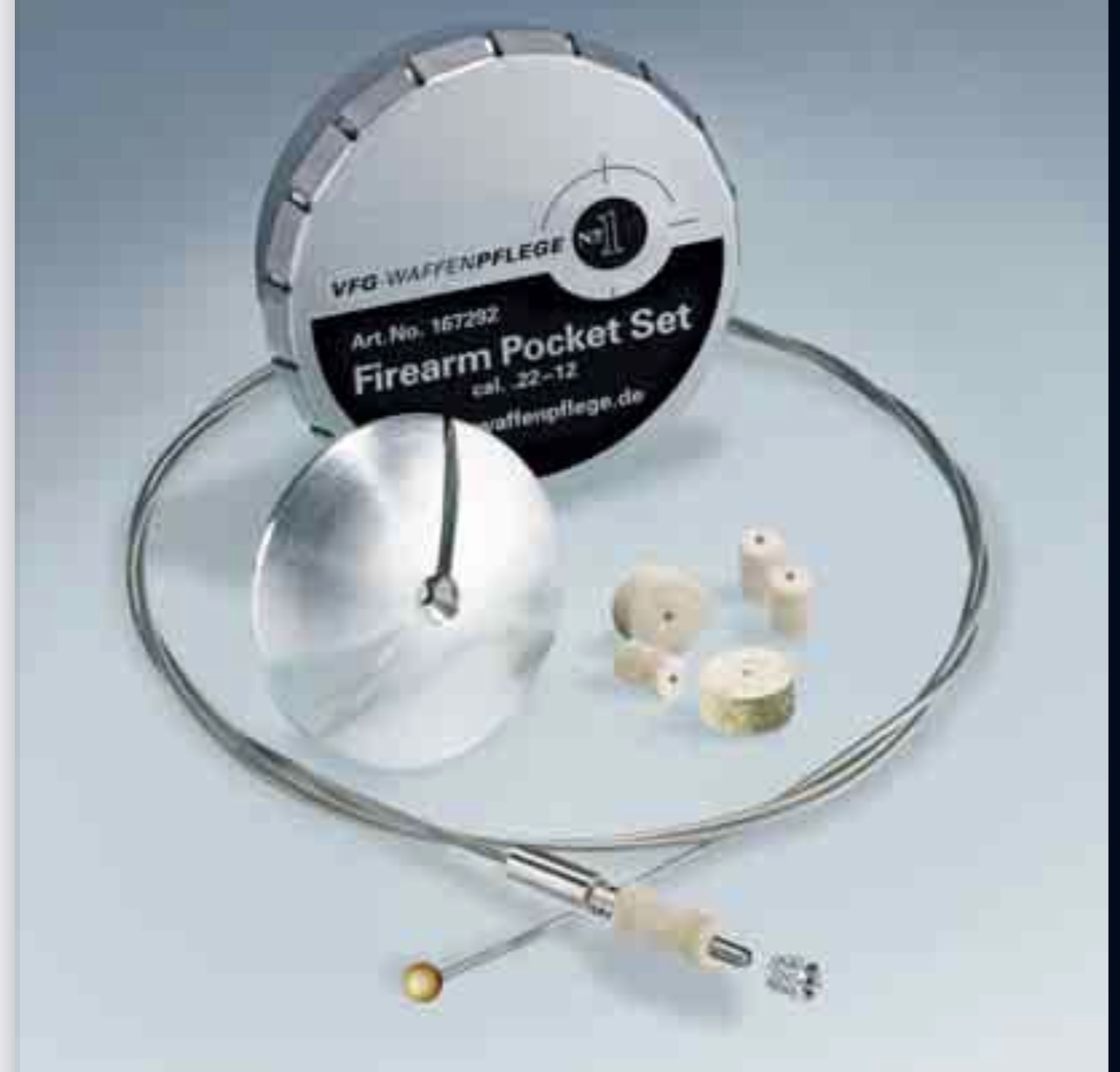

I agree, pellets make some work easier.
Pro shot makes a nicer version of the VFG pellet jag than that weird factory VFG one. If you do use the VFG jag, I believe the instructions say to don’t use the little nut unless using it on a shotgun.

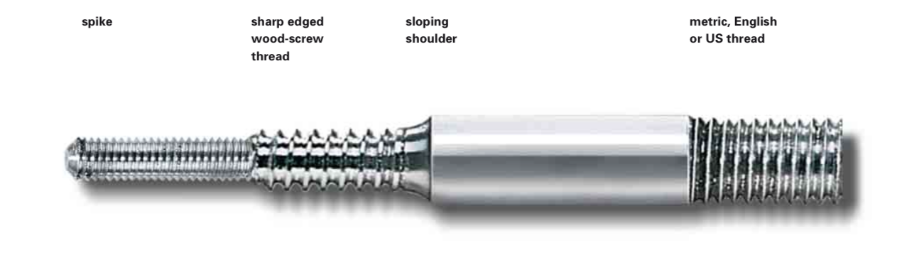

Here’s a trick I just discovered with pellets to get rid of a stubborn carbon ring.
I used either Rem 40x or blue JB paste and a regular felt VFG pellet (not the brass-infused intensive pellets, although that’s an option) as I was starting with the least abrasive method. It works so well I didn’t have to step it up to the intensive pellets.
Anyway, here’s what you do. Use a pellet two sizes larger than your bore. For a 20cal I use a 6mm regular felt pellet by VFG (Tipton ones are UTTER TRASH btw). You’ll have to experiment…maybe just one size larger will work.
Get the pellet on a non-rotating rod (ideally, but I just directly grab my cleaning rod so it doesn’t spin). Apply the abrasive and make sure you don’t bounce it around the action’s inside (unless you like to clean) as you put it in the chamber.
Feel free to go back and forth in the throat if you want, but the real trick is to TWIRL the rod while you spin it clockwise. I don’t use a bore guide for this method as it allows me more angle for twirling.
This allows you to get more pressure and surface area of the felt/abrasive upon the carbon ring.
I was futzing around pumping the felt-abrasive in and out without much headway against the carbon ring. Then I tried twirl-spinning it with minimal pumping and holy shit, the difference is night and day if you get the pellet in the right spot!

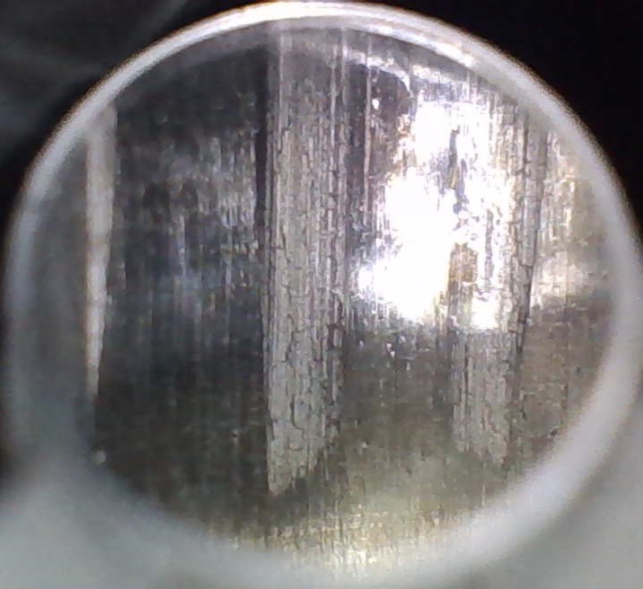

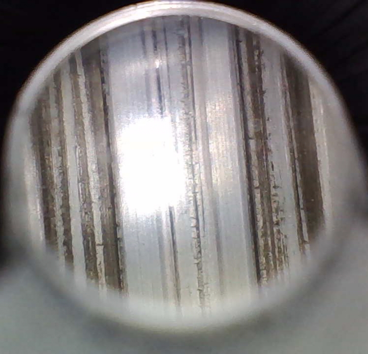

This is my Seekins PH2 6.5 PRC before clean and after what I felt was a deep clean. This barrel has 355 rounds through it.
These rifles seem to open the groups up for 10-20 rnds after a deep cleaning.
There is something about these barrels that seems to react to the copper or something, making them look really dirty. This is basically how it looked when it arrived after just a few shots at the factory. Cleans up nicely but I don’t get to bare metal.
ETA: Used Boretech with losso nylon brush and standard VFG pellets.
Pro shot makes a nicer VFG pellet jag than that weird VFG one. If you do use the VFG jag, I believe the instructions say to don’t use the little nut.

By chance, if you (or anyone) needs tips for pellets for 17cal, this is what I do:
  • Rod: Proshot 17 SS
  • Jag: Proshot 17cal brass spear
  • Pellets: VFG 17cal (has no factory through-hole; just one side has a starter hole that can be pushed through)
Just pop the he pellet on the spear and push through. You can’t do a reverse stroke, of course, but this is better than using Tipton’s shitty pellet jags (they also make shitty pellets).
For some damn reason VFG doesn’t make 20cal pellets.
If VFG’s jag doesn’t work out, I think I might have already mentioned that I use Proshot‘s VFG brass jag, which comes in .223/6mm and .270+ versions plus a shotgun version as well.
@Nik H I ran across the instructions for the VFG pellets. I think this is where I got the idea that the nut is really only for when cleaning shotguns.
Step 4 doesn’t reference using the nut for rifles. In the shotgun instructions (not pictured) they specifically mention using the nut.
Anyway, thought I’d pass that along.
After all the buzz about cleaning back to barracks steel and borescoping to verify, I started using Thorro-clean and scoping every 300ish rounds. I didn’t notice any issues with dispersion or POI but my velocity would take 10-20 rounds to come back and somewhat stabilize. I documented velocity continuing to creep during each session following cleanings and noticed that post cleaning I would be around 40-50 fps slower than “stabilized velocity” and I would almost always see some velocity increase between sessions (gun was shooting 2810 at end of last range session, when I came back out it would be at 2820). What’s odd is that on multiple occasions I would check velocity before a match, then put the gun away for a few days, and when I arrived to zero and check data, my velocity would jump up about 20-30 fps. After speaking with a pro shooter about this, he asked if I was using abrasives. I said I was, and he said he’s noticed similar velocity inconsistencies with them. I went back to cleaning with Boretech and bronze brush and my velocities have been much more consistent. It usually takes 1-2 shots to get back to stable velocity after cleaning and no more “jumps” in velocity. I end up shooting at the same velocity that I would eventually get to with abrasives, but doesn’t fall off and no spontaneous increases. Much more consistent, I’m only ~5 fps different after 100 rounds. Not sure the best answer, but I’ll only use thorro-clean sparingly now. Abrasives are nice because it’s much quicker, but I won’t do multiple iterations of brushing with abrasives to get back to clean steel.
Thanks! Other than the nut not being used, this is what I read and mentioned previously. The front felt falls off on the reverse stroke.
