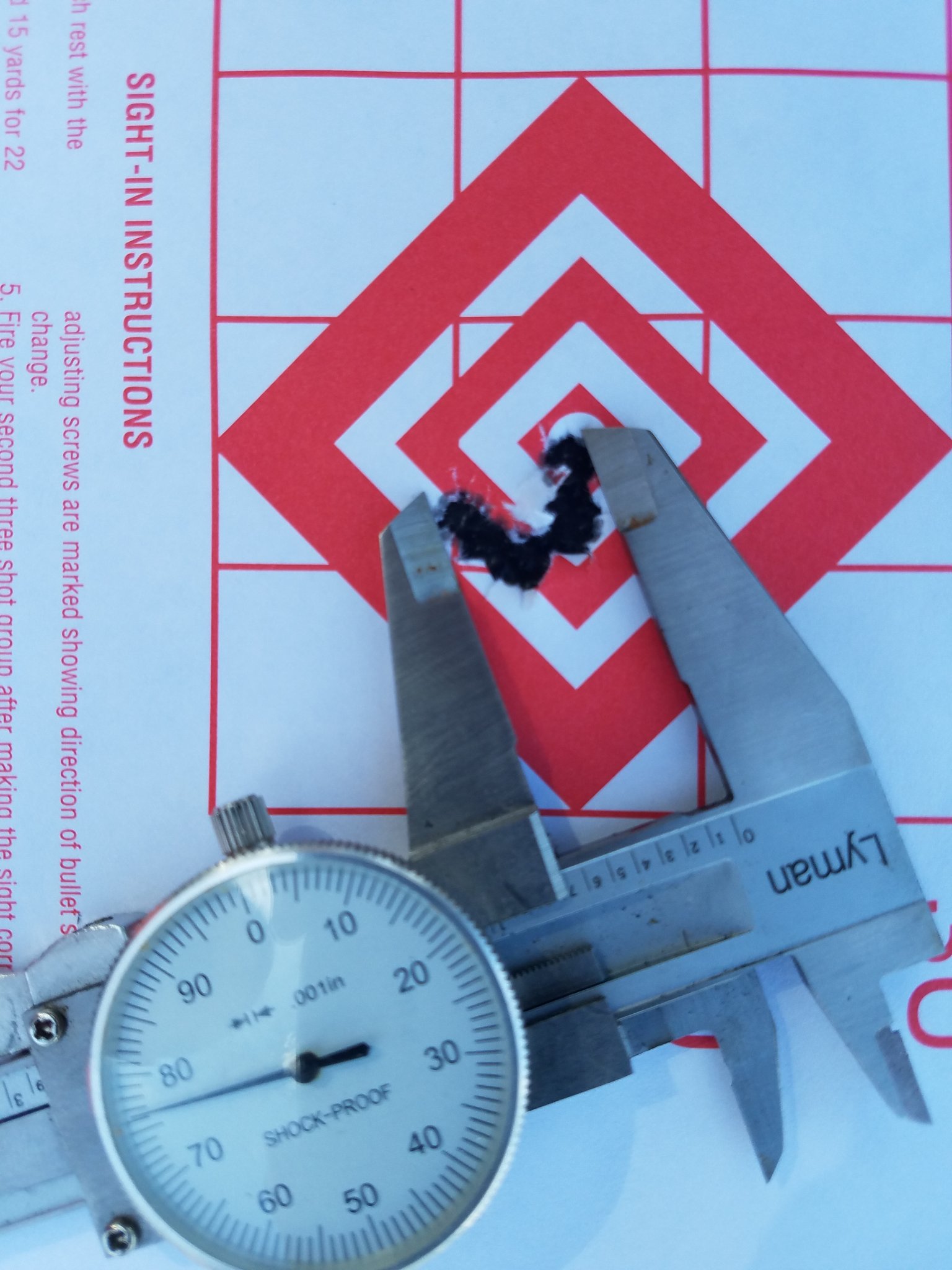

Attached is a picture of a rifle I tested today that has a brand new barrel. That's the first 5 shot group I fired through it after I got it on paper. So rounds 3-8 on the barrel. No break in procedure either.
My other rifle that I cleaned yesterday shot a 10 shot group that was .536 center to center.

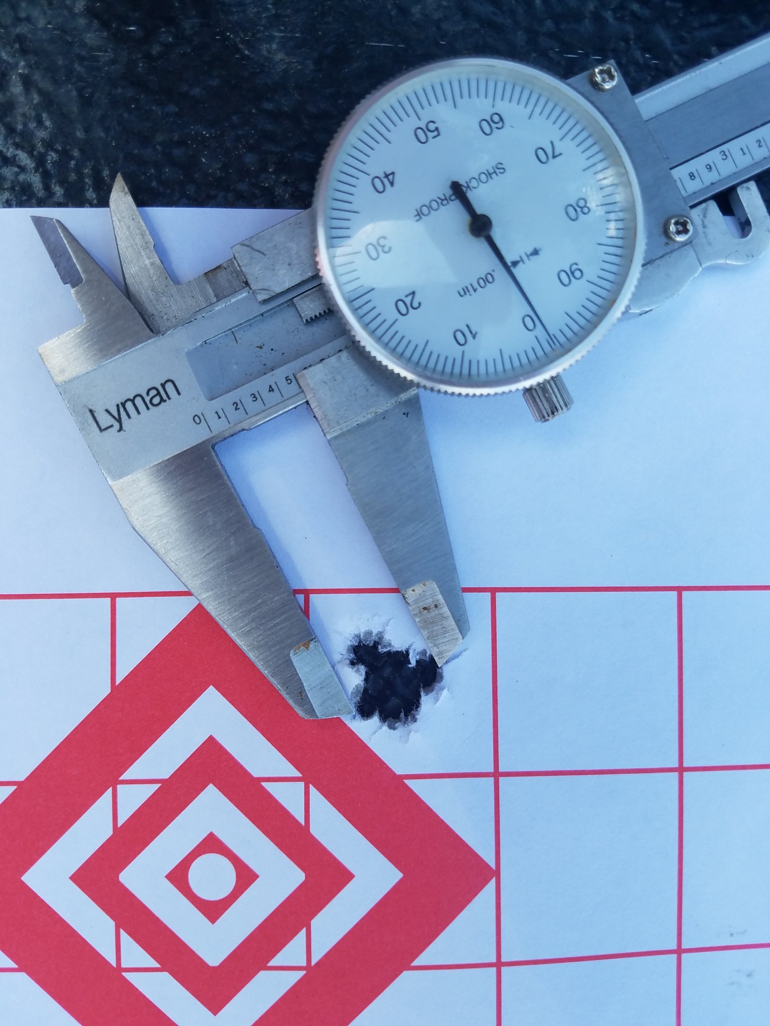

Just to add more to the pile; attached are 2 pictures of groups I shot today after cleaning. I decided to also torque my barrel on a lot tighter because my first range trip today revealed that it was finger tight.
I think the idea of shooting until it stops shooting is not very smart. I built my data around the rifle having 0 to 500 rounds of copper and powder fouling on the bore. Could it go more? Sure...maybe? But I already have proven performance in the 0 to 500 range, and that's enough to realistically take me through 2 2-day matches.
Guess what? Cleaning more frequently is going to make my "resets" if you want to call them that a lot less drastic than if I wait until 1000 rounds to clean.
I don't want to let carbon build up the the point that I start popping primers or having sticky bolt lift. I also don't want to see my data gradually change as I add fouling on layers of fouling to the point that my data is kind of junk by the time I decide to clean.
I think I did my 500 round cleaning job in 12 or 15 patches and called it good enough.

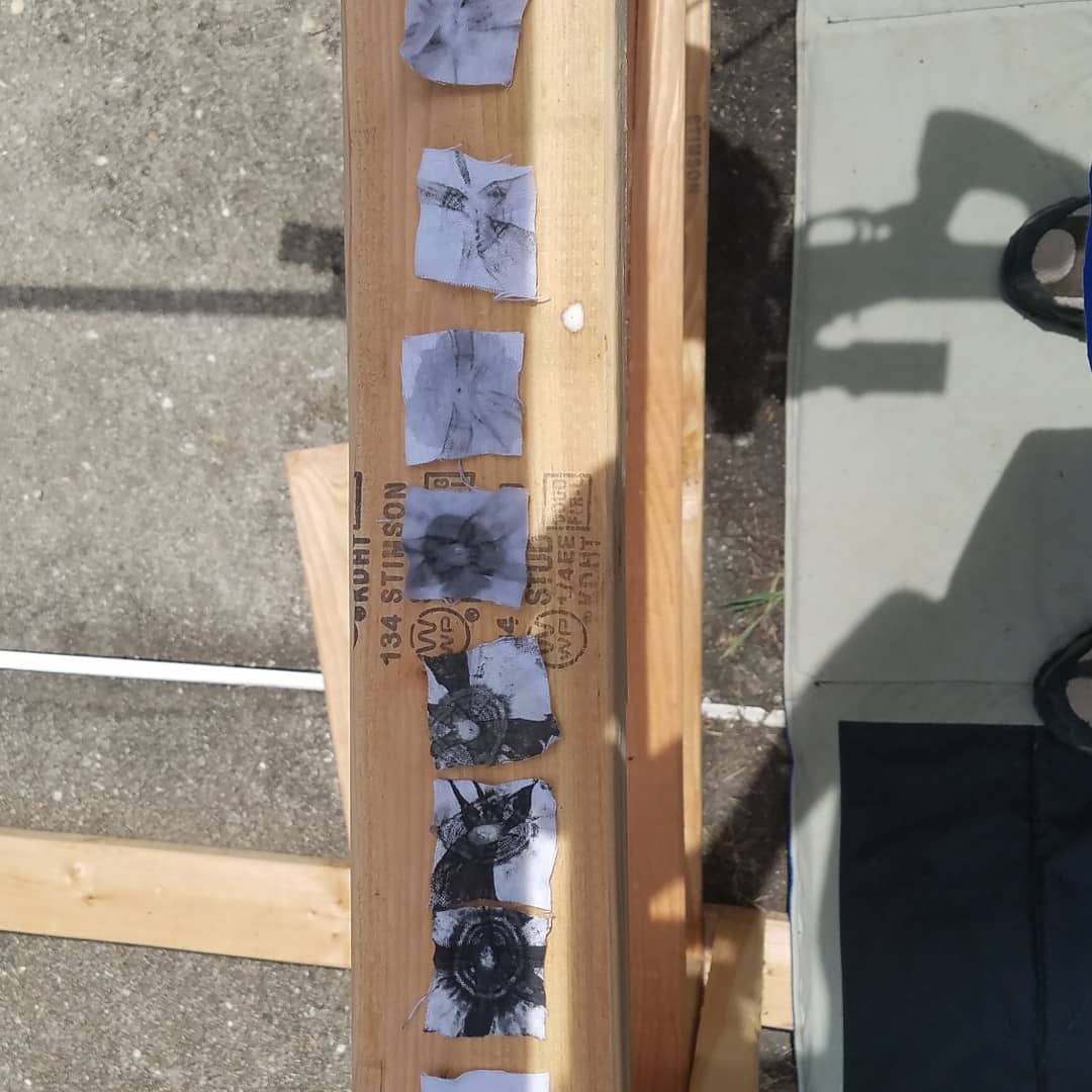

I pull a bore snake through when the day is over to get the loose shit out, and then again before shooting if it's been more than a week or so to get the crustyness out. I've found that depending on what powder you use (H4350 especially) it will harden up and cause some deviation in the first few rounds while it pushes it out. Bore snake seems to prevent this.
Other than that I wet patch a new barrel, do a very light cleaning after 50 or so rounds, and then clean every 300 rounds or so after that. I also believe in the Tubbs voodoo and run a 1-2 throat maintenance bullets through the gun prior to each cleaning.
