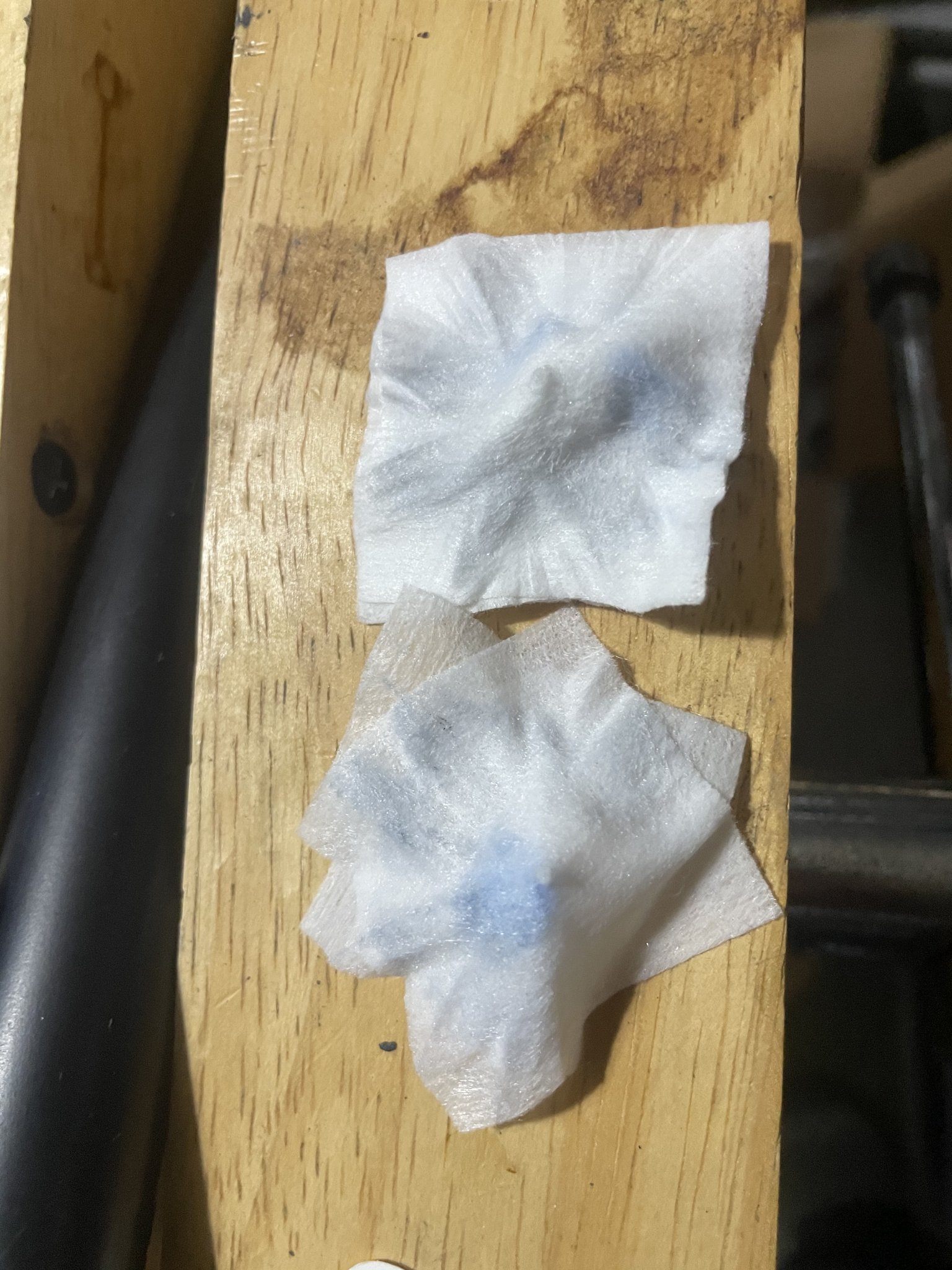

    How clean do you clean your barrels

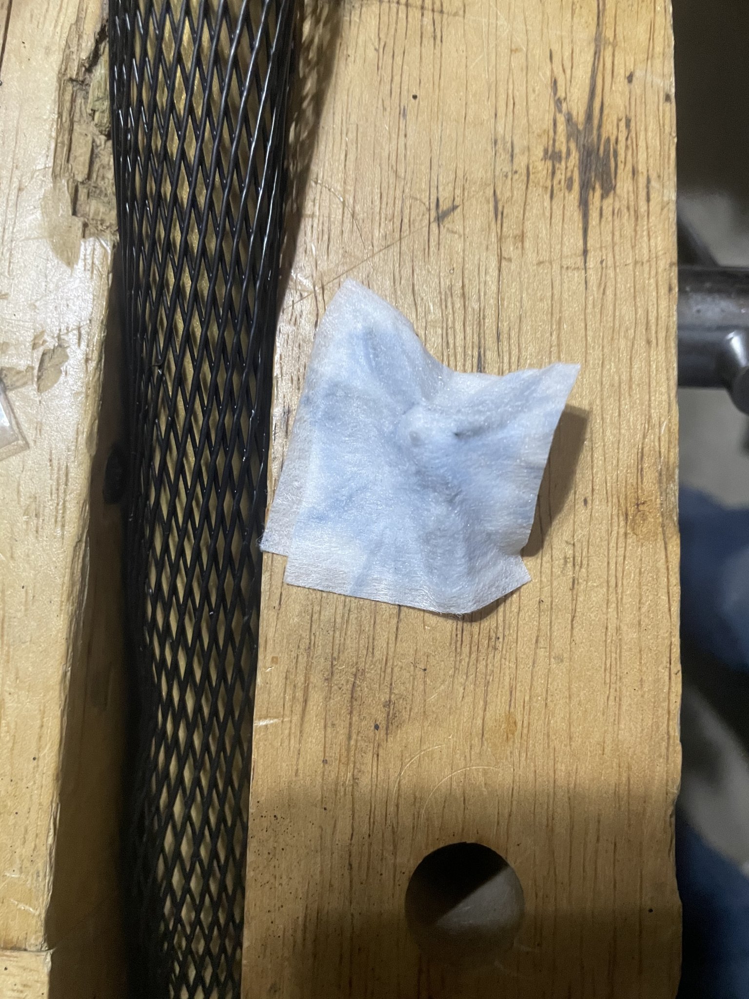

    These 2 have set for (3) 24 hour periods soaked with wipe out. With 6 patches wet with patch out at the end of each 24 hour period.
    Still getting a slight bit of blue but maybe it’s from suppressor brake mount ?
    After the first patch the rest are clean
    I love wipe out Burt... Borescope it and see if any copper is left. I usually pull my brakes off to avoid false positives.... that is, when I actually clean my barrels

    I never had much luck getting barrels clean relying on the patch and what it looked like. The borescope is a lot better. Once I say how not cleaned they were I began the quest to get then clean without wrecking them. I will use clr but I don't leave it in the barrel and I make sure I get it all out and I make sure I don't get it anywhere else. I use these little droppers I got on Amazon.
    The clr is a good start but then I use Casey foaming gel borescrubber with a nylon brush if I really want it clean. I'm not going to use a bronze brush ever nor do I need to. That foaming gel works really well with about 10-20 strokes. Then hop#9 to clean everything out of the bore
