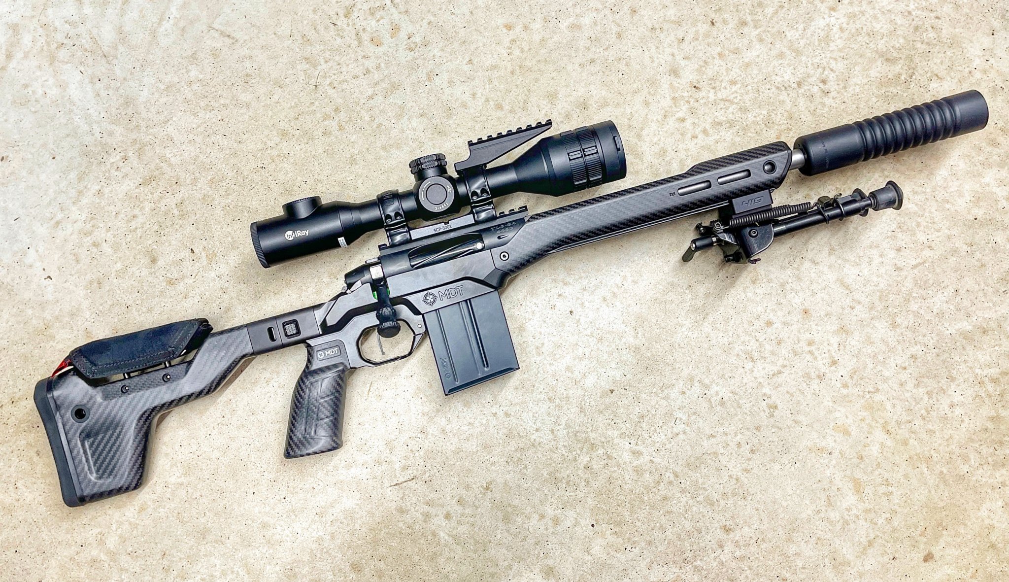

I know the HNT26 isn’t the ideal chassis for a clip on but it’s what I got. This is an all around shortish light hunting rifle for day or night use that’s why I want to use a clip on and not a dedicated night scope. Night use will probably be a secondary for me to use when I have a friend or my wife with me and I put them on my AR that has a dedicated thermal scope.
Absolute longest shot would probably be around 600 yards but most being 200 or less, specs are a 22 creedmoor 20” proof 8 twist NX8 2.5-20 MIL-XT F1. I have no experience with clip ons but most here seem to hate bell mounted setups and it looks like that’s what I’m limited to. Are there repeatably issues using scope mounted clip ons? I’m probably looking at the pulsar krypton 2 FXG50 or super yoter C. Any other similar options to look at?
I’ll probably pair it with a vortex impact 4000 mounted to the left side of the handguard since my action is a nanook with integrated split rail sections, unless someone can point me to a 1 piece scope mount that’ll bridge the gap between the rail sections and offer a bridge to mount the LRF.
Im open to suggestions on setting up this rifle but I think options are pretty limited due to the HNT26.

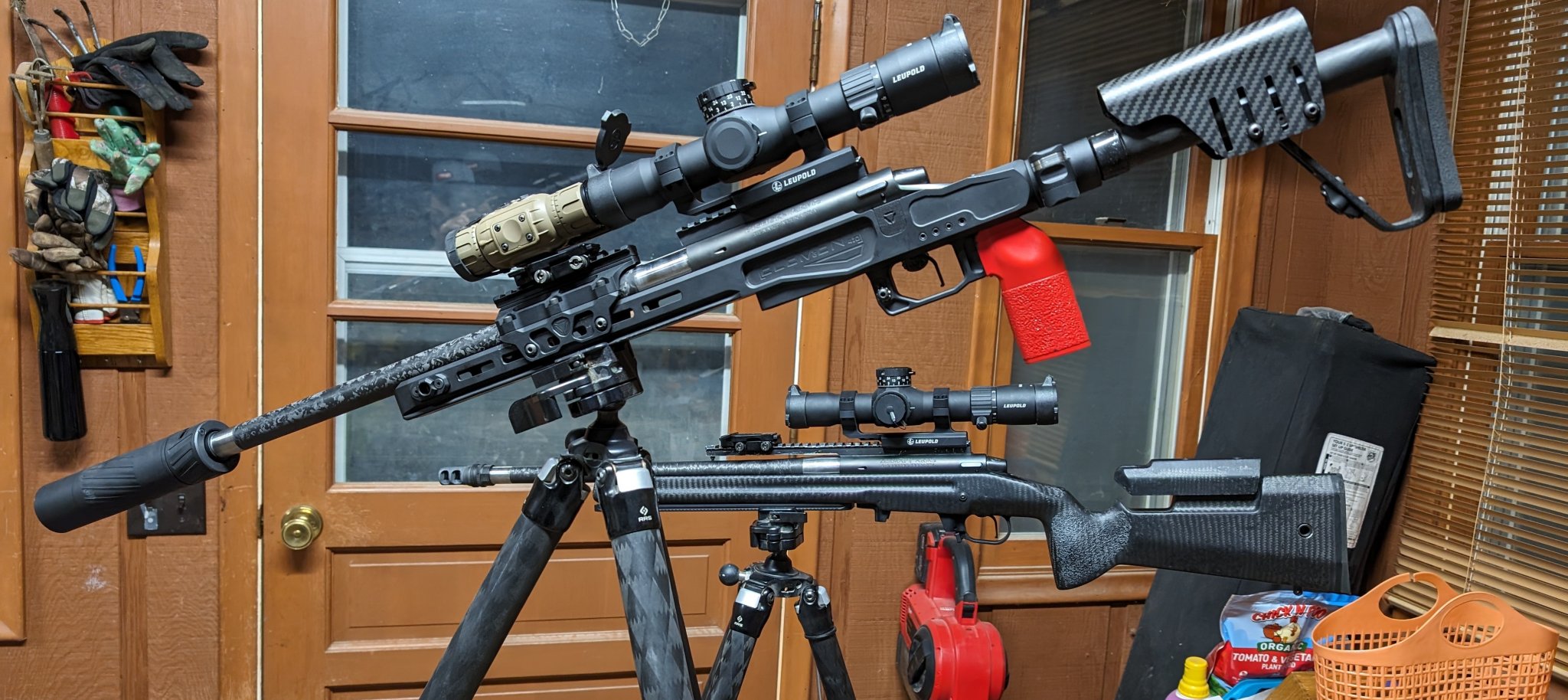

It's action specific, but I run 2 setups with special rails for this chassis. An extended rail will also get you around the height issues with the clipons as no one really has made the nv attachment lower to have things on the same plane. I've done it but with a lot of work
Here is one of my setups, I have my Nox35 on it since I have more rigs than I do clipons and this is my loaner rifle.
Yes, there is a gap between the barrel and the rail, Zermatt made it with a set screw for support so it can be used on different barrel types.

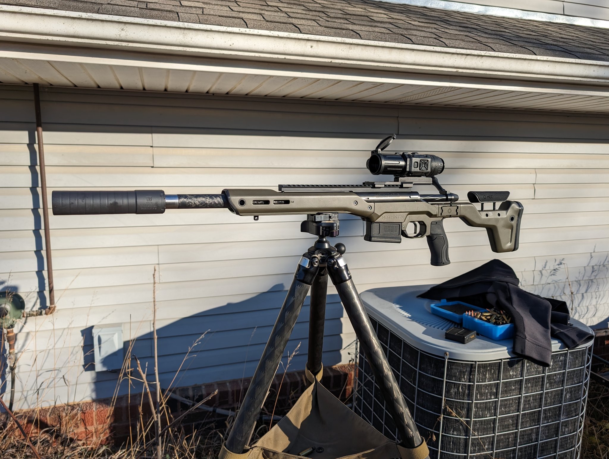

Here is what I did with the XLR and this is literally about as good as I think one can get without getting too crazy. And no, this won't be possible or advisable with the HNT 26. That's why I shifted to the XLR Magnesium 4.0 (I have 2 HNT 26s) This is rock solid with this configuration.
