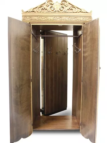

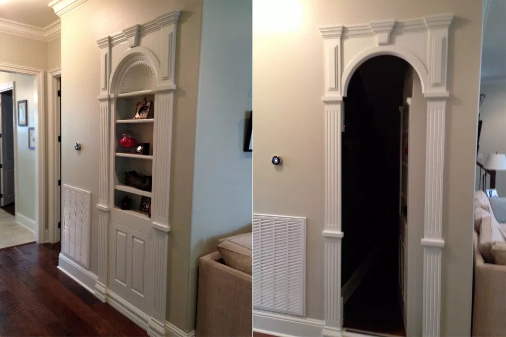

I had done something similar in a previous house. I used a hidden door (bookshelf) . I made a steel frame on pillow block bearings to support the bookshelf. I also used rock wool in the wall cavity for some fire protection.
That's an interesting idea. Hard for someone to break into a space that they can't tell exists in the first place.

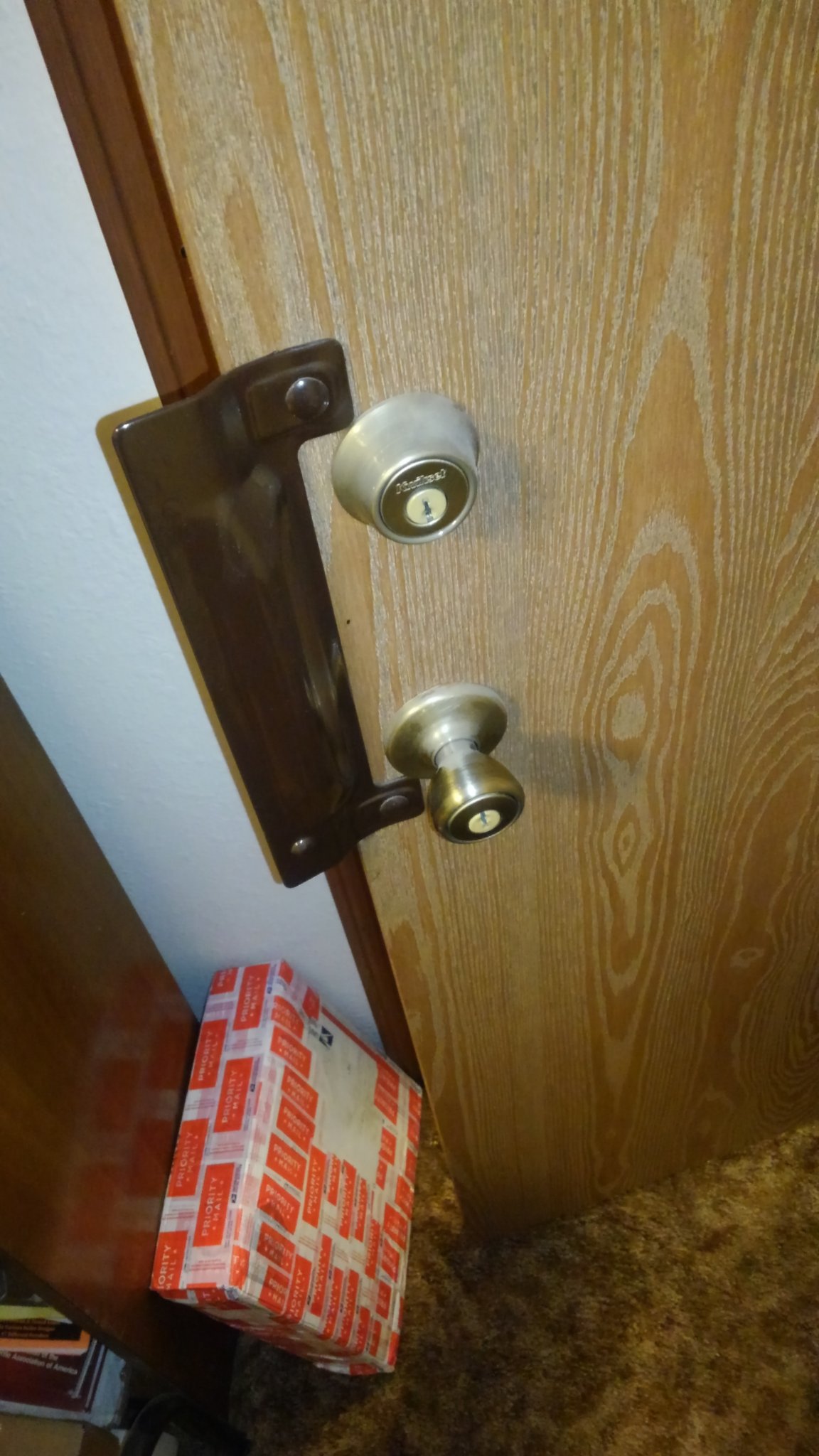

Reinforced door and locks with plywood on the other side and tamper proof hinges. But the rifles inside are in safes. Burglar alarm is most important. A burglar with enough time can destroy this but most don't have time. In fact, just locks on it will deter an addict, which chances are is going to be the type. They have only a short time to get In and out of the house.

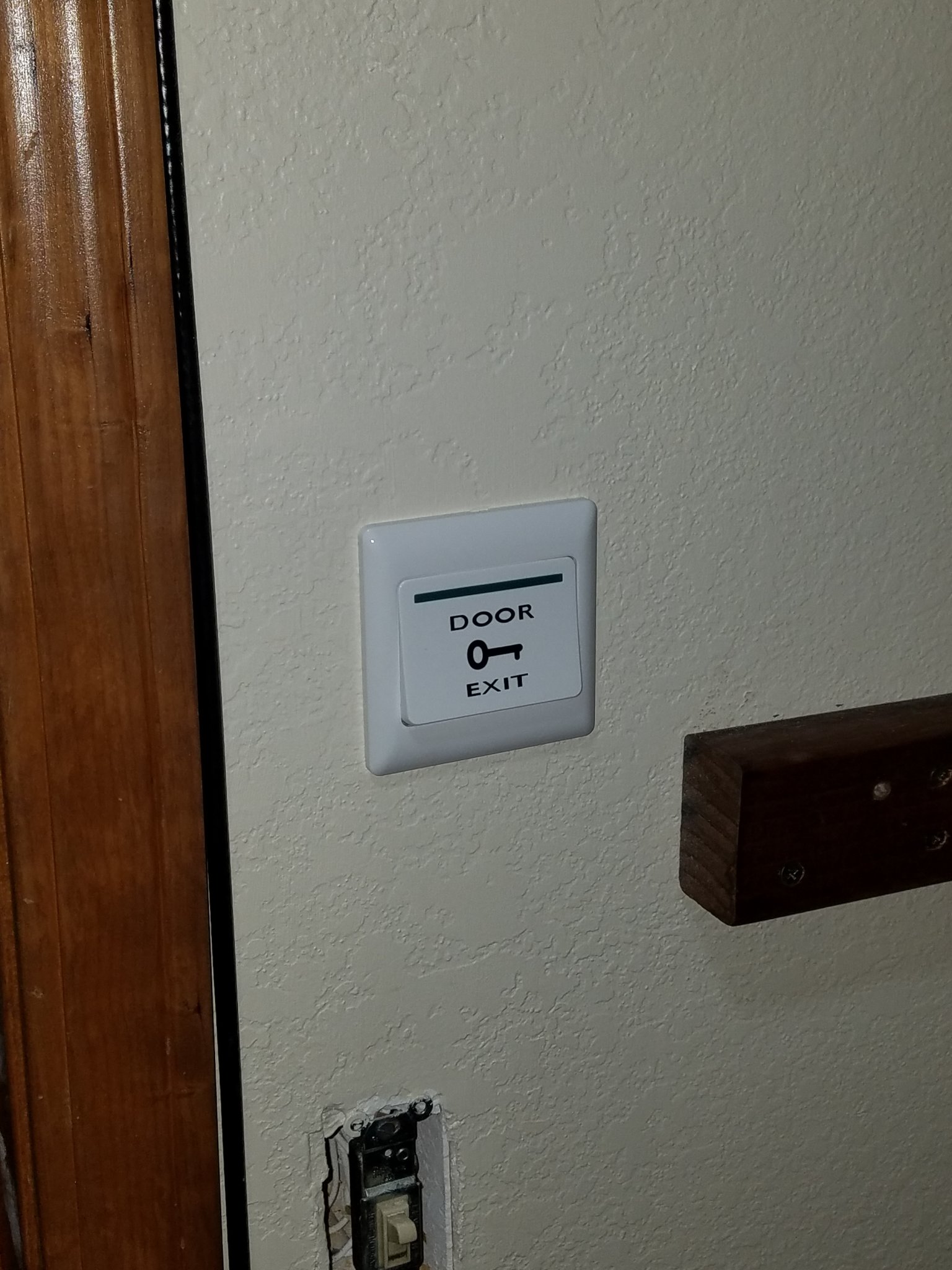

It's also tied into my security system via a wireless sensor. Only problem I've run into is that if power is lost, my UPS only has enough to run the security system, the magnetic locks, and the cameras for 2 hours. Without power, I only have the standard lock on the closet door for now
So, when power drops, does it fail locked or unlocked? Cause, if it's a movie: totally fails unlocked ;)
The usual solution is just to provide a power point somewhere. Then you can plug in a battery to run the locking mechanisms. Just keep a battery or three charged (just a few SLAs, with appropriate leads, charge every 6 months or so...) and plug in when it's time to unlock. Unplug when re-locked, to avoid drawing the backups down, of course.
Other option (or likely, alongside that one) is you have the system shut off by default when on UPS (many have USB or other data out for this), to avoid draining the UPS battery so fast. Then set the keypad or something so you can manually turn it on before you need access.
I have a lot of switch covers in the basement if you need me to mail you one. :LOL:
Reactions: FishDr and Tx_Aggie
Unfortunately it fails movie style and defaults unlocked the locking mechanism uses a pair of 600lb electromagnets. I've been thinking of adding a second UPS so it has its own dedicated power supply.
There is a switch plate on it now! :LOL:
