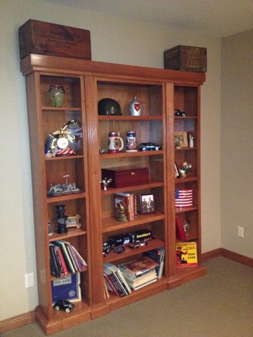

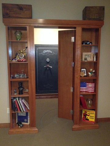

Hide the closet
And a solid core door that opens out is more difficult to kick - same with steel core
the goal is that they don't find the closet
I would also add an Armoires or Wardrobe into the room so It looks like a den that has an Armoires for clothing storage...

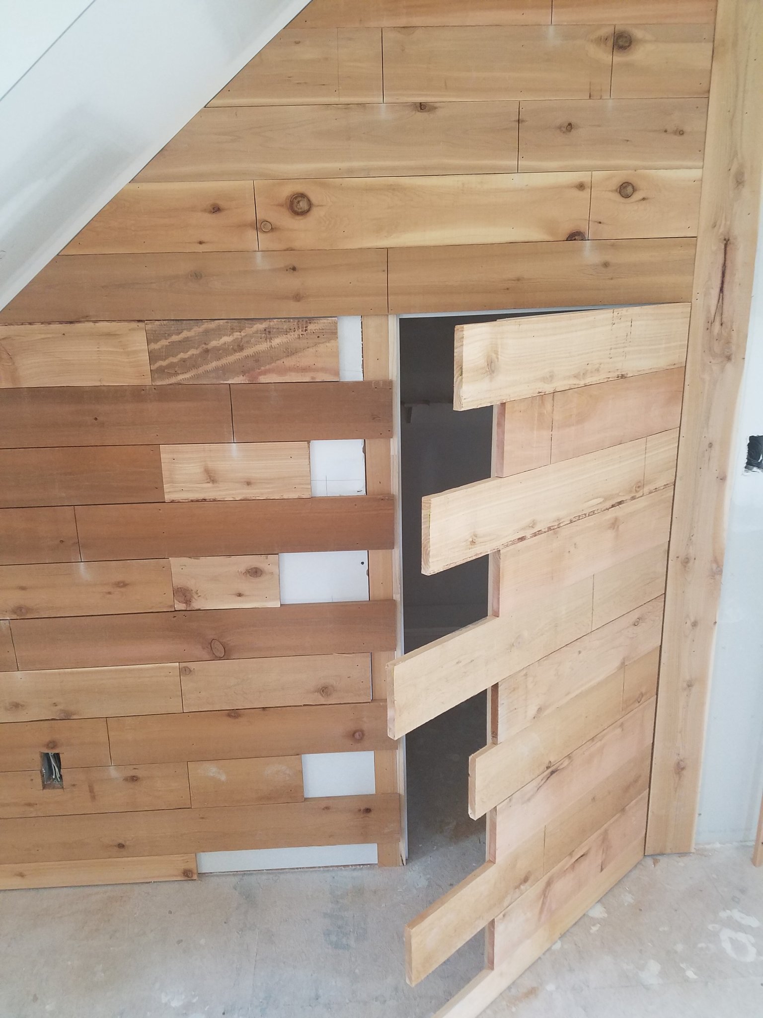

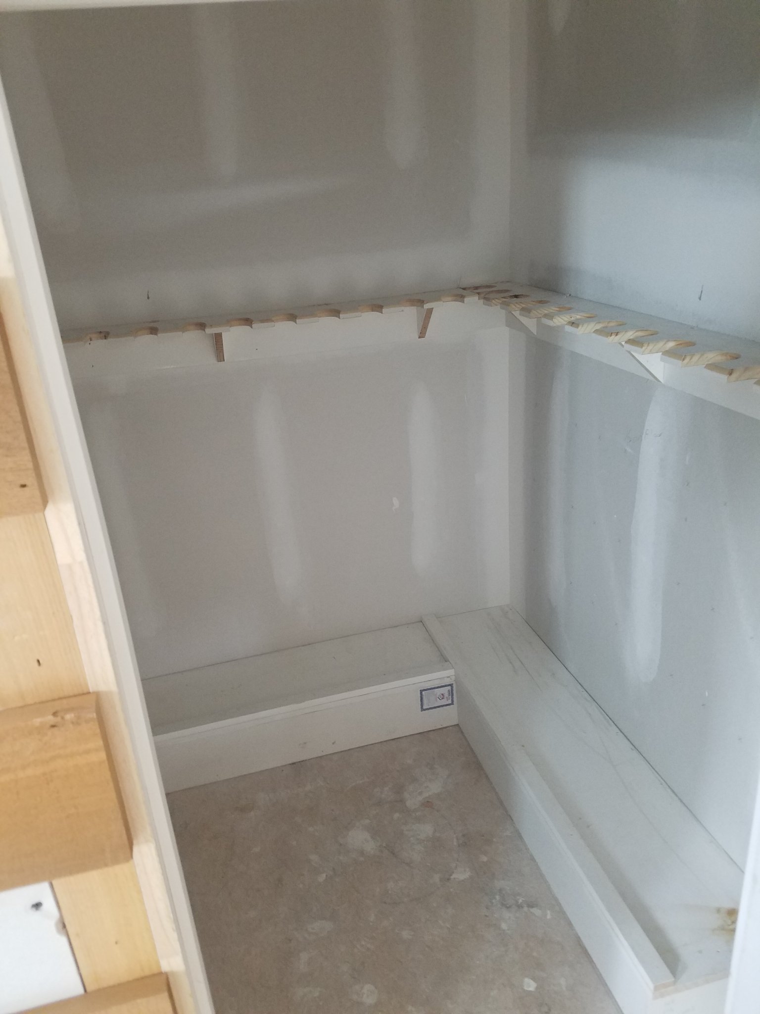

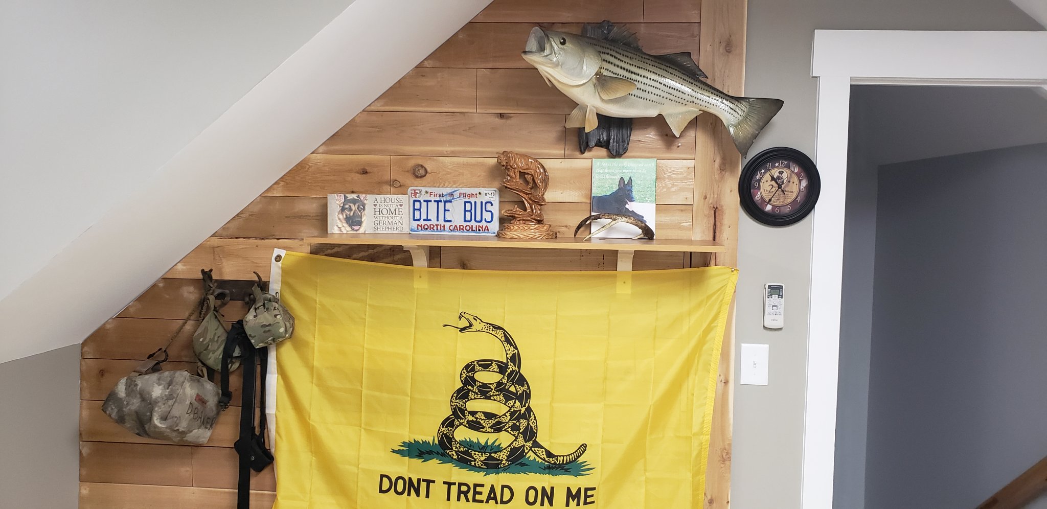

I built the under side of the stairs into a vault, inside the framing it's 2 layers of 5/8" fire x sheetrock, then 1/4" steel on the inside, with full perimeter angle steel base. There is additional reinforcement every two foot going up. Cabinet with 1/4" plate back and reinforced hiding the door which is a sliding pin steel and concrete door. Like someone else said above it's all about layers. To get to where this room is you have to get into the shop, then into another room, know it's there and then really get to work. Between cameras, security system, and the other layers is a Target.
