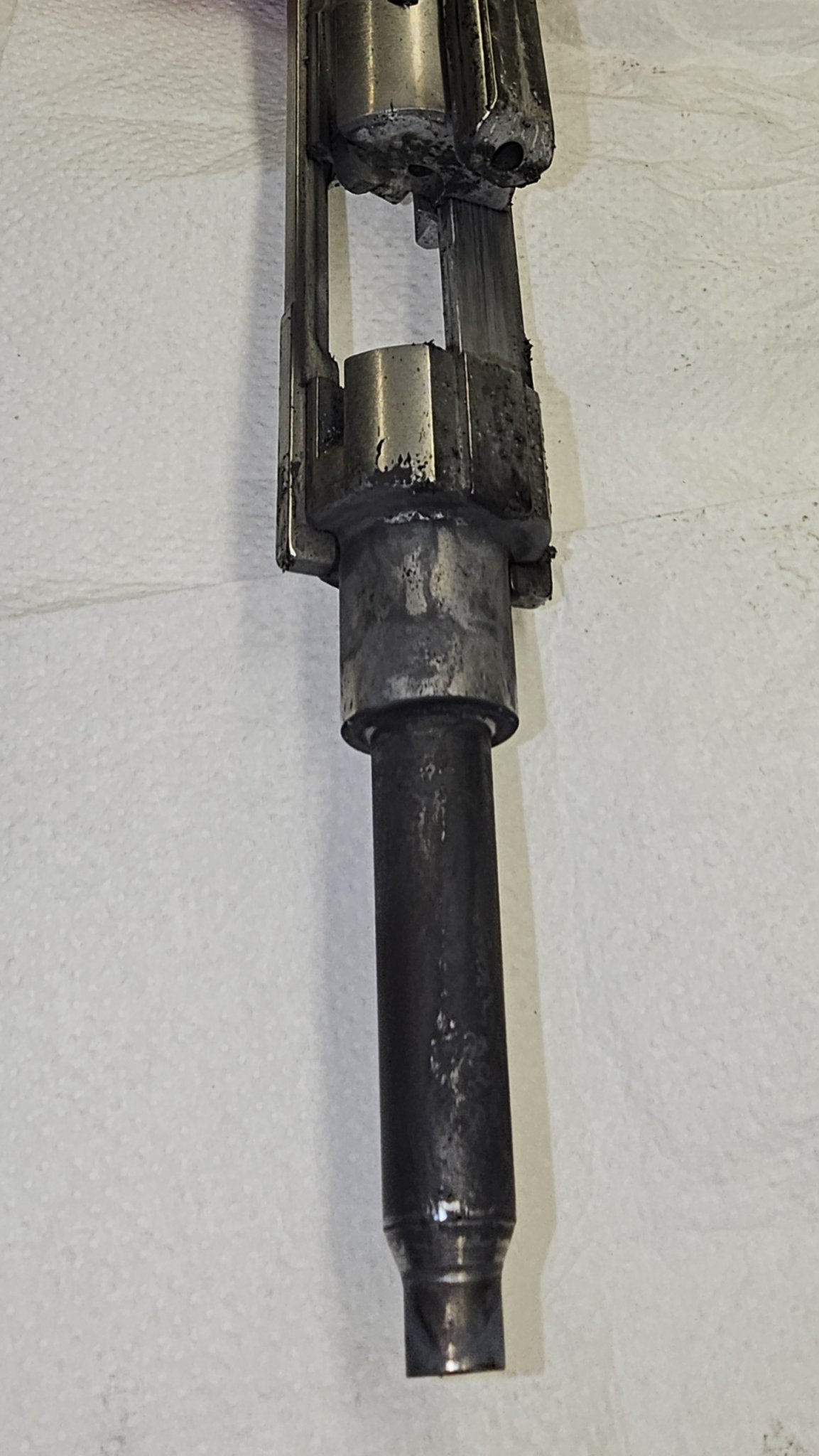

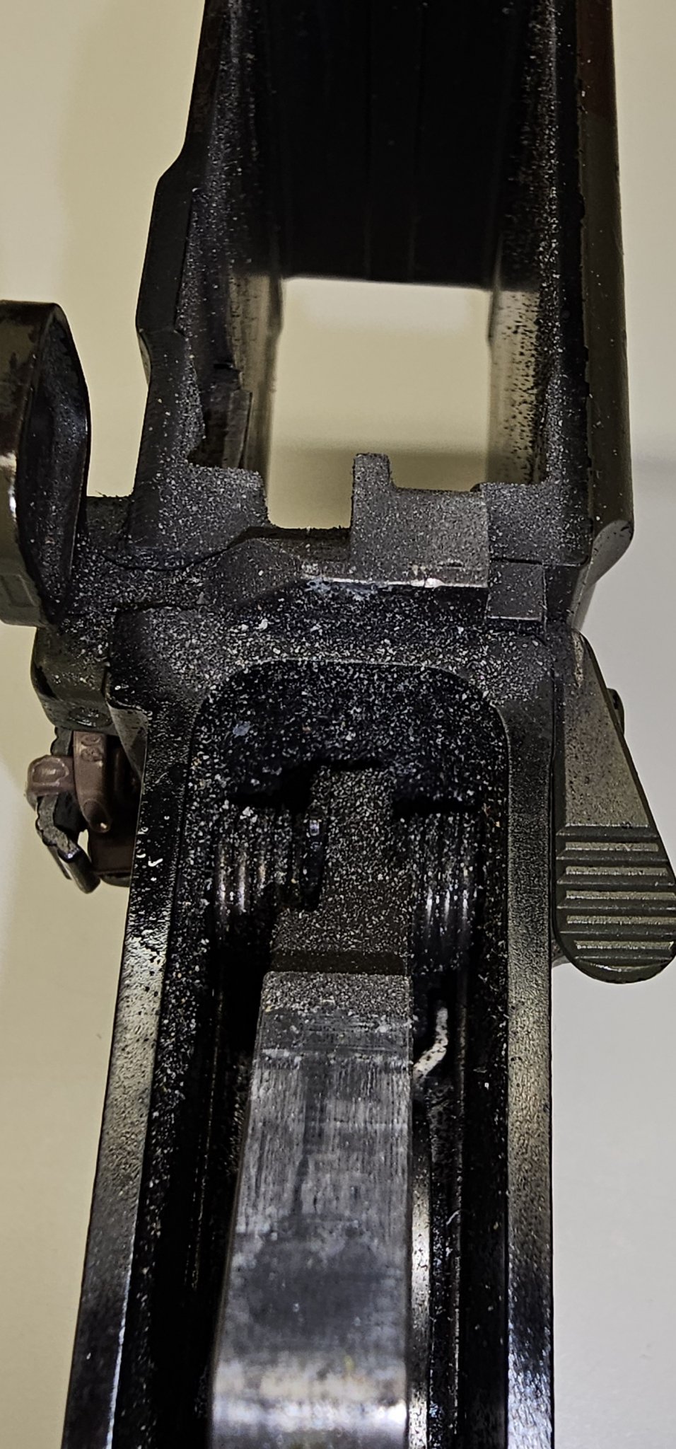

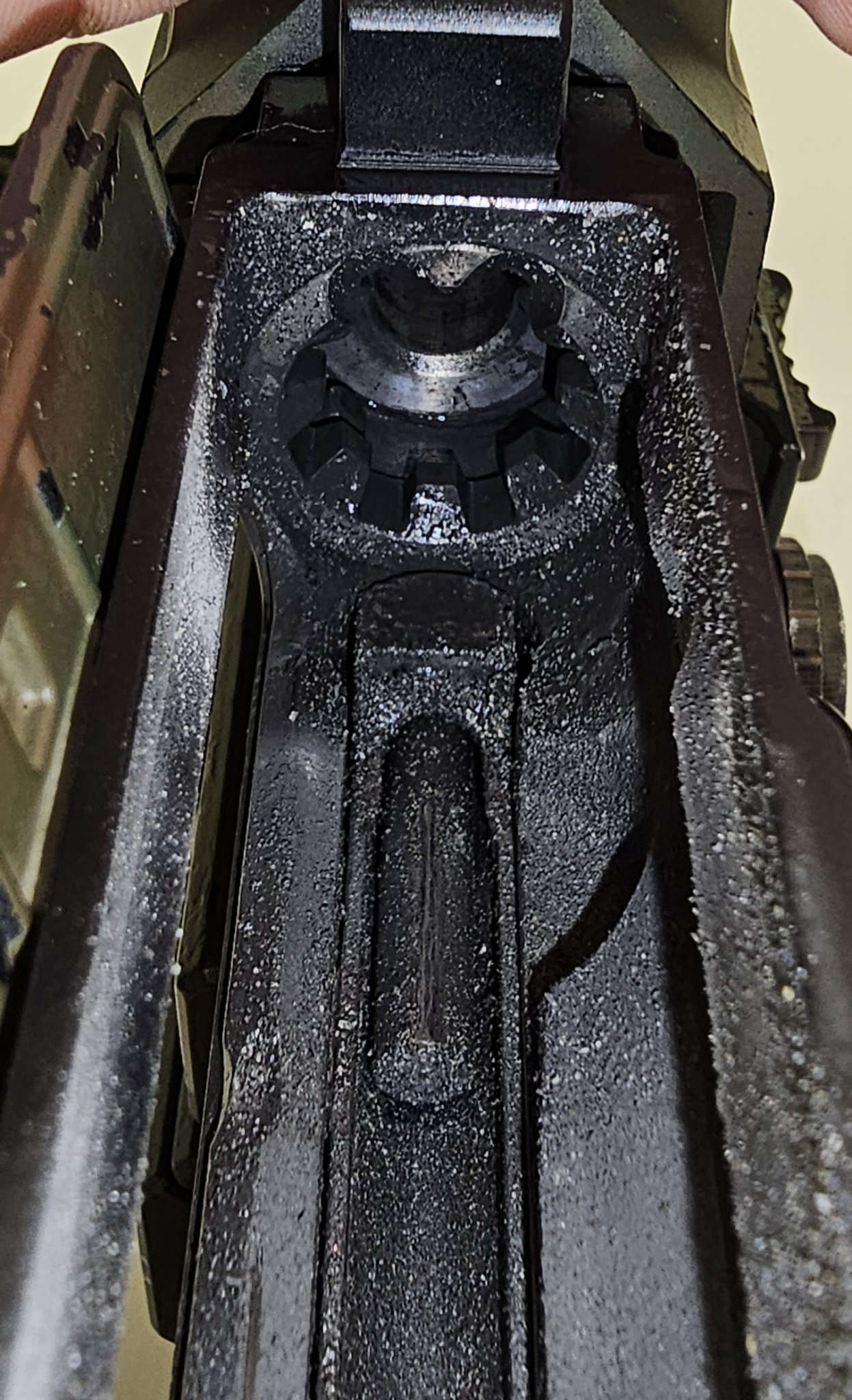

    Here are photos of the gun and the kit itself after shooting around 150 rounds. I did use a suppressor but I doubt it had much to do with this, maybe some. Most likely the adapters loose fitting was mostly at fault.
    It strongly looks like the kits 223 adapter only touched partially my chamber from the shoulders and was loose enough for a lot of debris to escape to my chamber and the adapter itself.
    After this inspection I wiped the upper and lower a bit. I also cleaned the chamber clean.

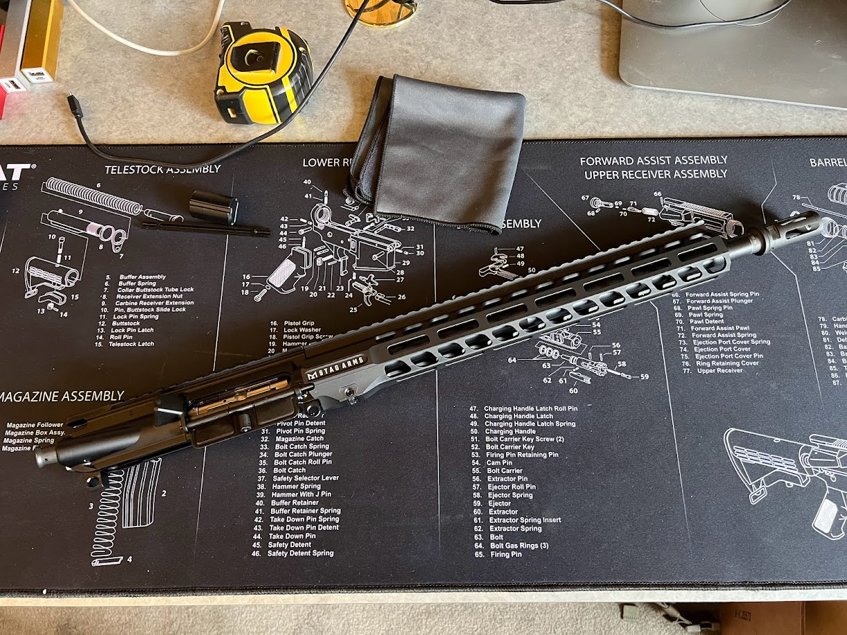

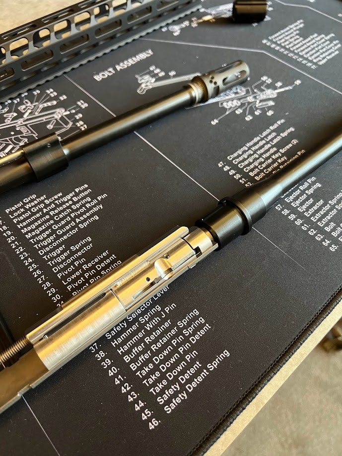

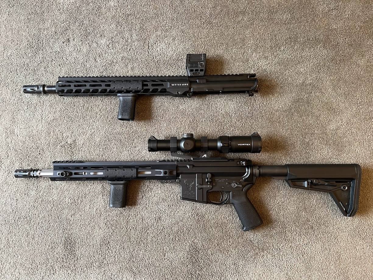

    Personally I just decided to build a dedicated upper and converted the CMMG bolt using the collar. It runs a lot better and cleaner, but now I don't have to worry about my main receiver getting as dirty. A lot of that is because there is no gas port letting the gas blow back into the receiver. In terms of accuracy, the CMMG barrel I picked up was decent, but not great. The barrel was only $136, so I shouldn't have expected much, but 2 MOA is about as good as it'll do at 50 yards. I have not done a lot of testing for accuracy as I mainly build it for CQB training since rifle rounds aren't allowed on most of our action ranges (also way cheaper).

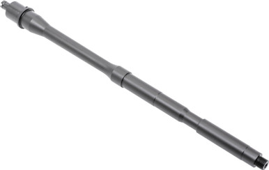

    CMMG #22D7C0A
    Barrel Sub-Assm, 16.1" M4 4140CM SBN, 22LR

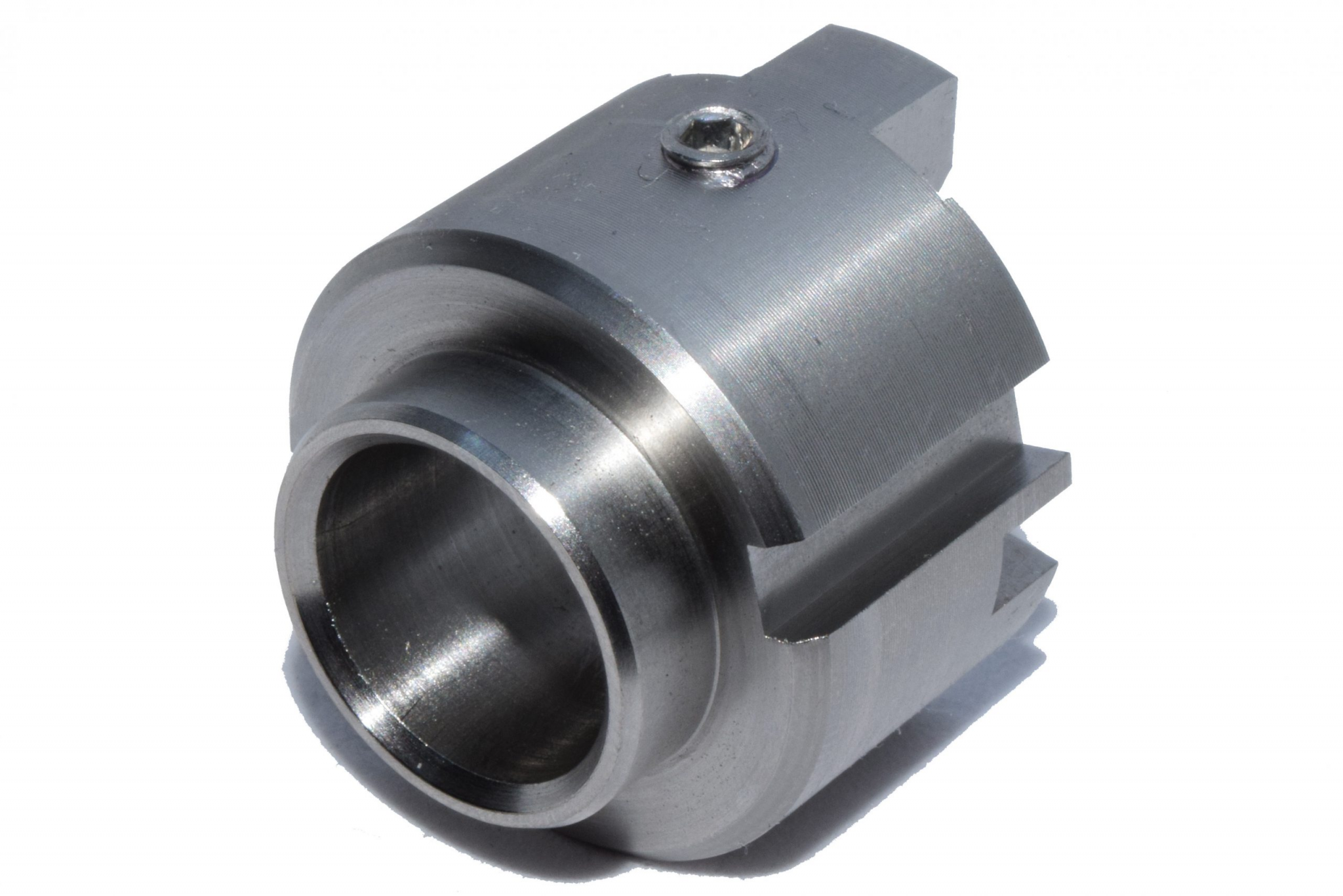

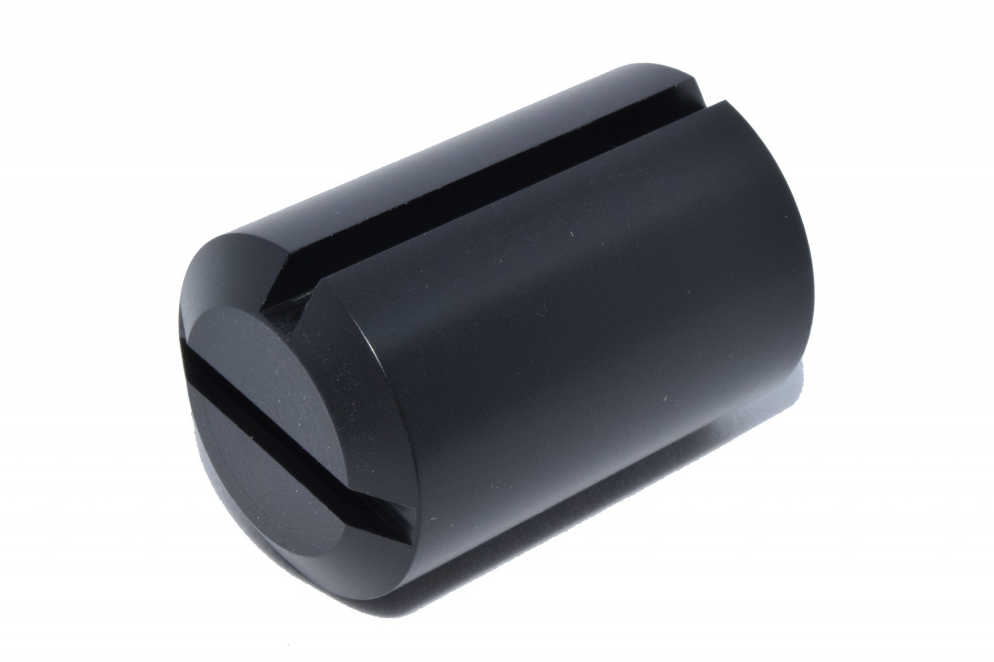

    Barrel Collar - Just pops in place to replace the insert that goes into your normal AR barrel.
    I would like to eventually try a different barrel. I went with this one because of price and similar weight to my normal 14.5" 223 Wylde. I'm using my spare handguard and such on my dedicated upper, but will eventually make it identical to my main AR.

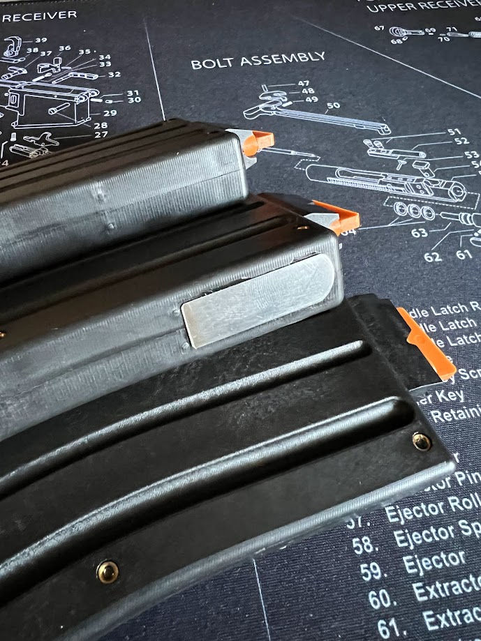

    I think reliability wise you'll be hard pressed to beat a dedicated upper for it. I'd definitely recommend the BoreBuddy reliability parts. Also check your magazines. The Bravo Mags can be a bit finicky with feedback because of how they seat in the lower. I added very small shim to the front of my mags which helps they stay stable and snug in the lower and helps a lot with feeding.
    Basically what my current setup looks like:

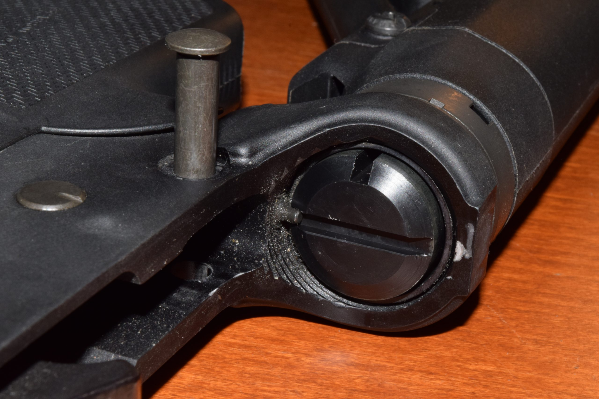

    I'm sorry, didn't realize you were in Finland so some parts might not be as easy to get. If you don't want to go with a full upper there one thing you can try. The bore buddy Buffer Pressure Plug is one of them. The slop of the drop in conversion bolt is a source of problems for many. The plug that just pops over your buffer spring helps keep it from moving backwards.
    I don't know what else you could do about the chamber issue, but this would be worth a try.
