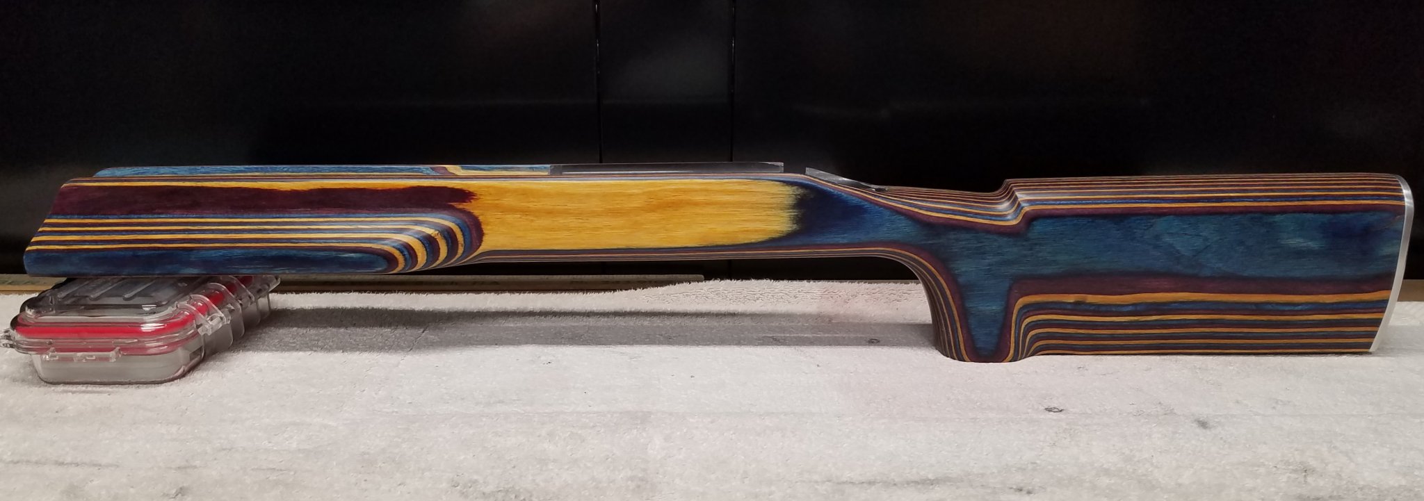

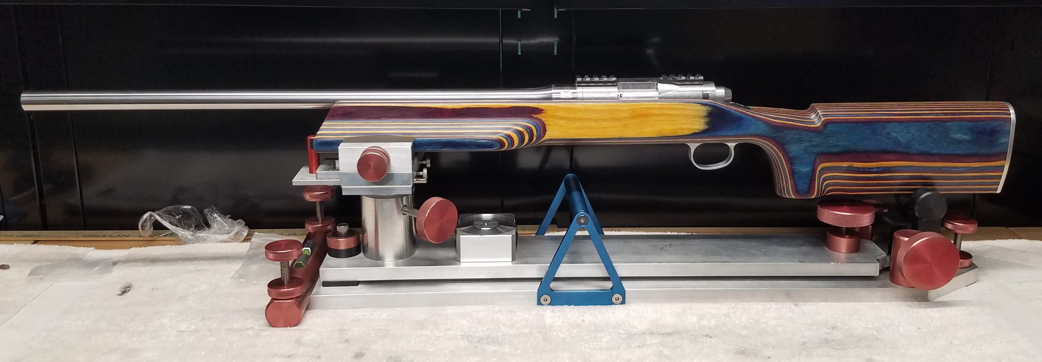

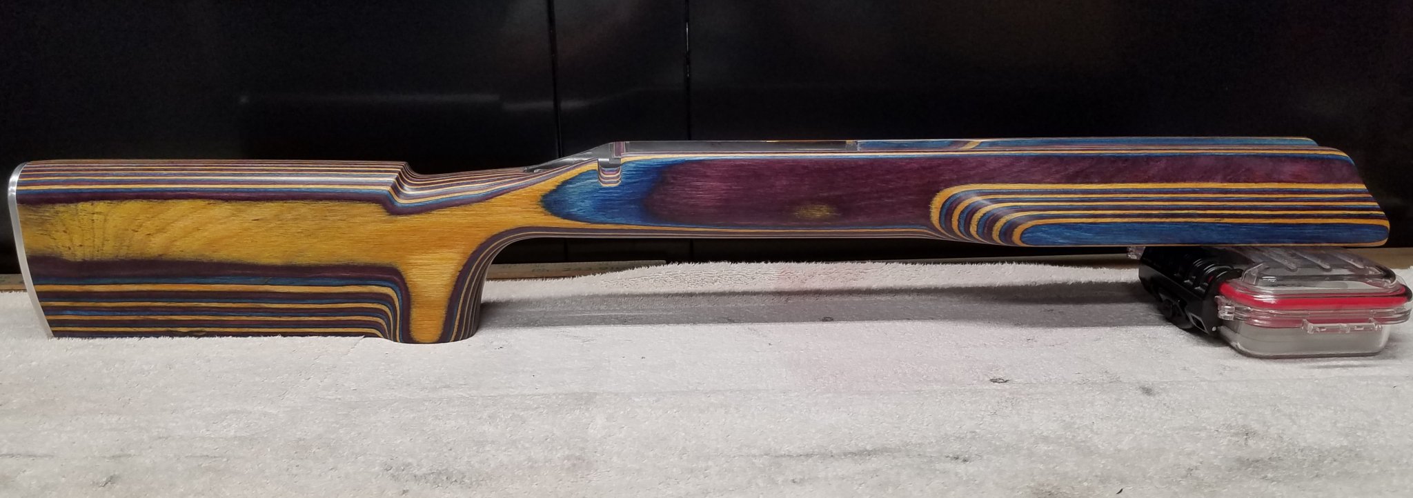

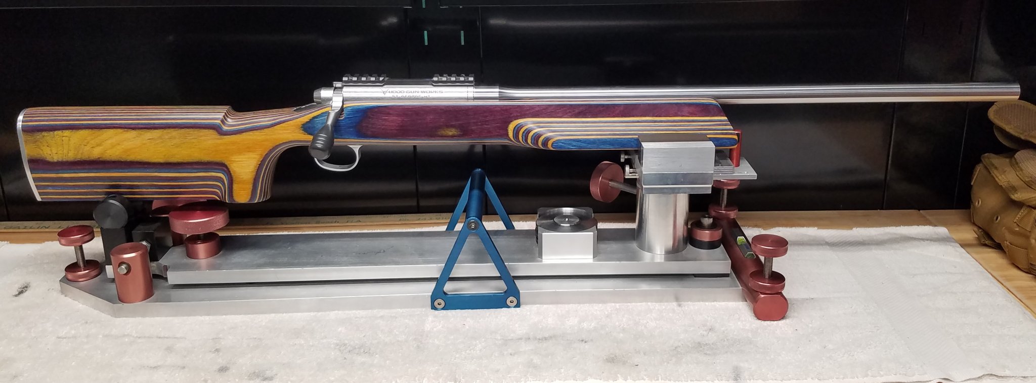

I just received my stock from Randy Owens. This thing fits like a glove........definitely worth the wait!!
Randy's work and attention to detail is excellent. I was also blown away how tight and perfect my action fit the bedding. Like a glove.
Yep....his pillar and bedding job is spot on!!
