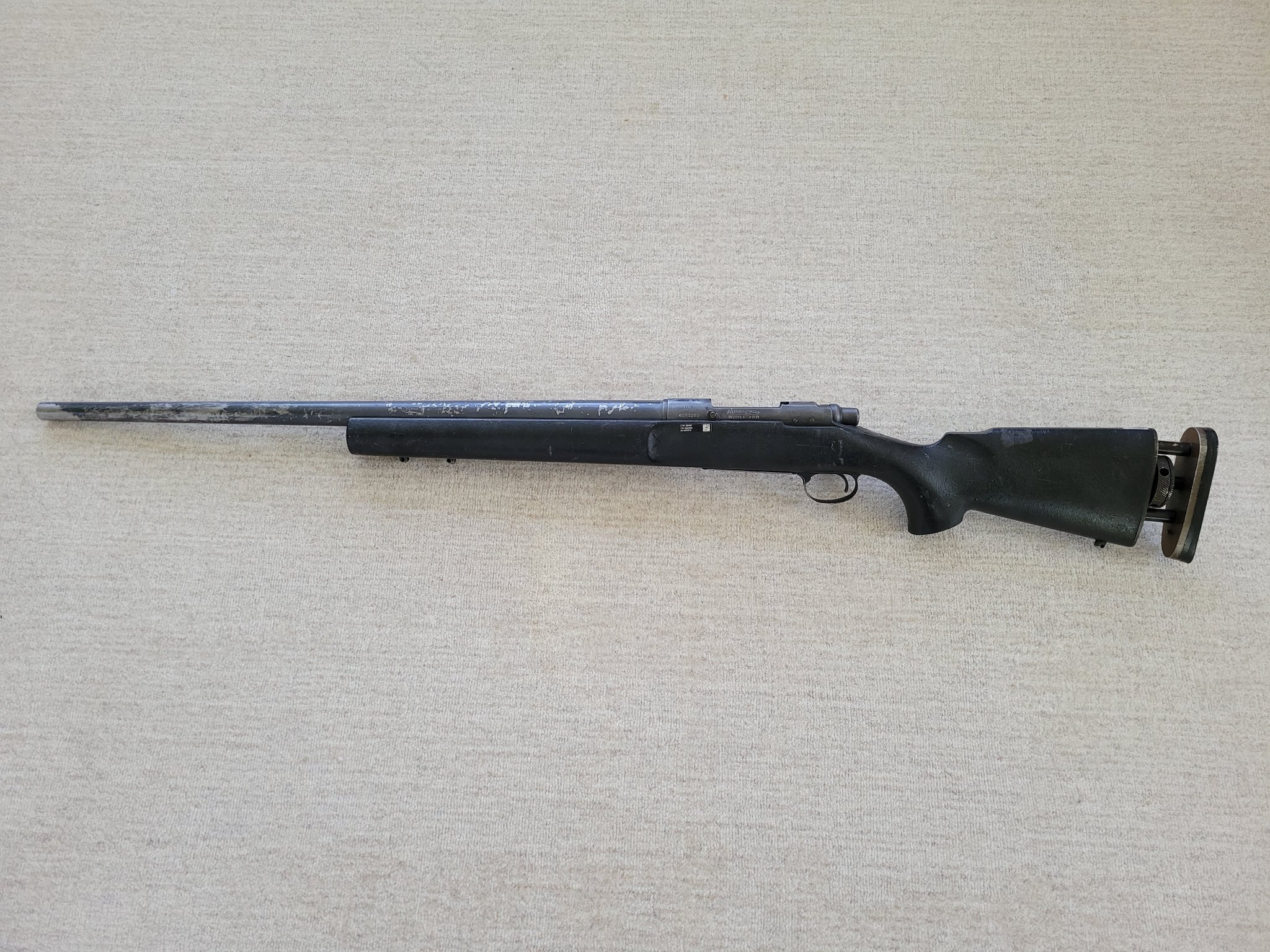

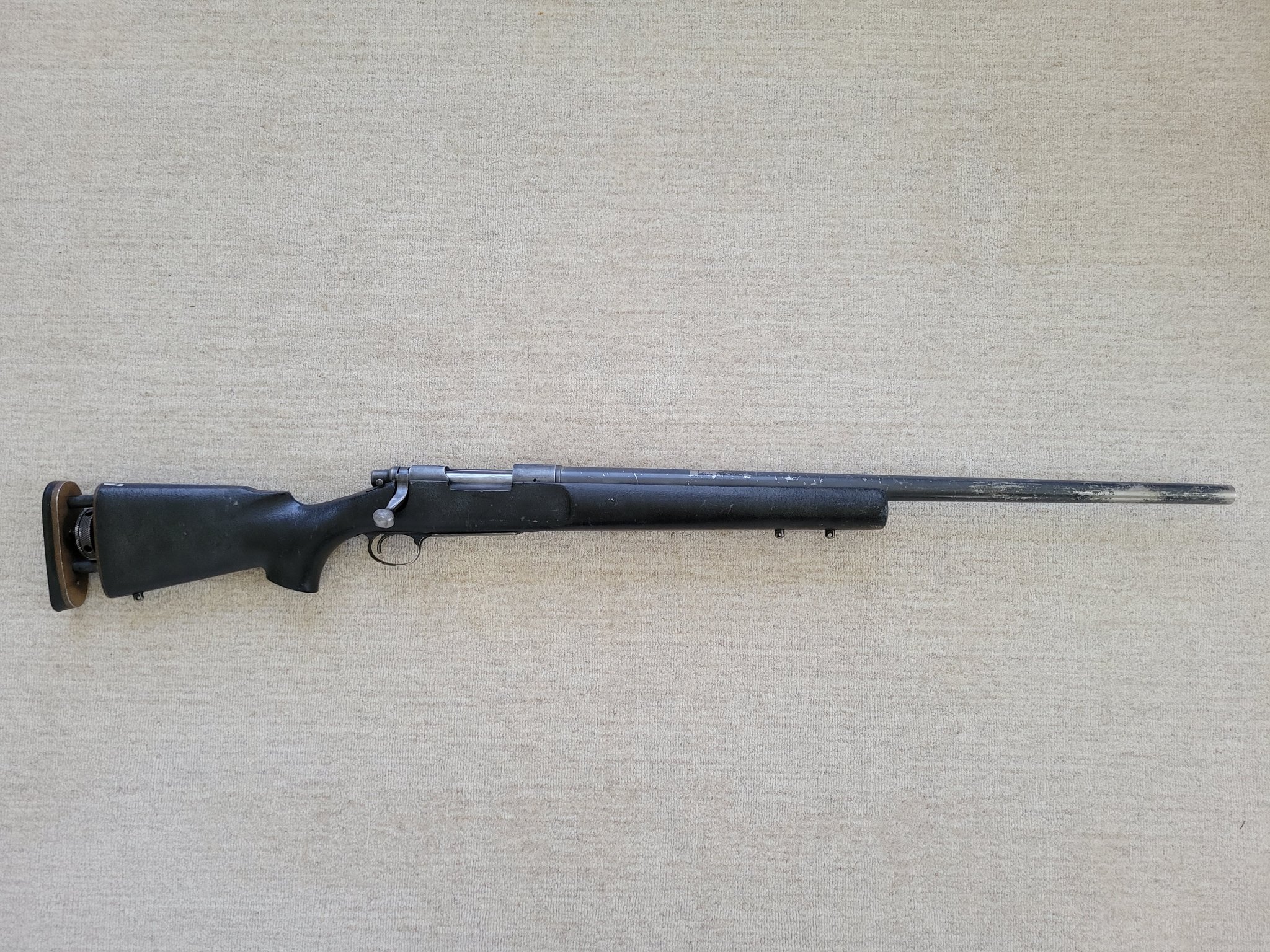

CMP has a complete Remington M700 rifle up for auction. My guess is an M40 ordered in either 1968 or 1969 (6.2M serial block), possibly ordered by the Air Force or Navy. Appears to have a 1972 dated barrel which I suspect was a replacement barrel. Has the post-1968 “7.62 NATO” marking on the barrel. Rifle is beyond my pay grade, just an fyi post.
That's not a 1972 dated barrel, the people at the CMP either messed up and got confused on the barrel codes, or they flat out have no idea how to read the barrel codes. The barrel is original, bot a replacement, and it's dated UDS, which is September 1969.
The M40 is 100% original, so it's a great example for anyone who needs a factory original late 7 digit M40 for their collection. However, this one has the most boring history that you could possibly imagine. It's an Army rifle (just like many of the CMP M40's that have been listed), and it mainly just sat around in storage at an armory for most if it's life before being transferred to the CMP in 2010's (that's when a lot of the M40's were shipped to the CMP, just like the USMC XM3's).
As with past CMP 7 digit M40's, this one was probably at an Air Force base at some point, but that doesn't necessarily mean that it was owned by the Air Force. Roberts Air Force Base could have just been a hub for distribution and short term storage. Roberts AFB, Albany and Anniston constantly trade stuff back and forth, so being at an Air Force base doesn't necessarily mean that it was owned by the Air Force. We can prove that with some 1911 pistols that were issued to various units in the Army, but the guns were still sent through Roberts AFB at some point. They're still Army 1911's, not Air Force pistols.
Also, this could have possibly been a rifle that was ordered through the Marine Corps. Again, that doesn't mean that the Corps used the rifle or even wanted it, they just had the contract with Remington for the rifles. I wouldn't doubt it if this M40 was purchased and sent to the Corps, then sent to the Air Force, then transferred to the Army for use. It sounds ridiculous, but this kind of stuff actually happened, and it happened quite a bit! This is probably going to be the history for many of the Remington factory original condition 7 digit M40 that you see pop up at the CMP, including this rifle. For the M40's that have been messed with, those will obviously have much different history than an original rifle like this.
Since it's an untouched Remington factory original M40 rifle (unlike a lot of the other M40's that the CMP has sold), this one should go for some good money. I'd say that $15k and less would be a good price for it, but I personally don't think that it's worth more than that (even though it could potentially sell for over $15k due to it's condition). It's a great example of a later 7 digit M40, and that's about it. The CMP probably has a bunch more M40's, so this could just be the beginning of it. We'll just have to wait and see what else gets listed in the near future, but the CMP has been pretty consistent with getting M40's listed recently.

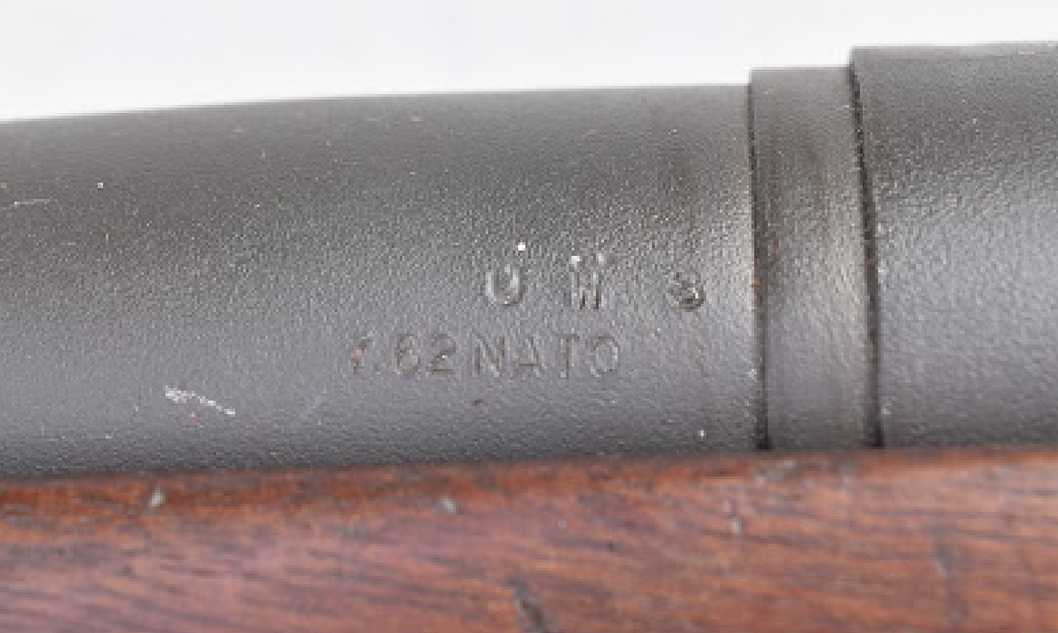

As for the CMP M40, my eyes might be deceiving me, but is that barrel marked “U W S?”? If “S” is the date code it’s 1969, but if “W” is the date code, then it’s 1972...I guess it depends on what character is month vs year vs inspector mark?
Below info might be where CMP is getting their info re barrel markings.

Here's the barrel markings on the CMP M40 that's currently at auction on their website. The U is the final inspector, the W is the month and the S is the year, so this barrel was produced (and/or proof marked/assembled) in August 1969. Notice how this barrel doesn't have an assembly number and it's stamped with 7.62 instead. What's interesting is the 1969 barrel date, since we normally see 1968 barrel dates on these 6257xxx M40's. If a collector wants an M40 from each year of production, this is a great opportunity to acquire a 1969 dated rifle!
The "WS" part of the markings is the date code, the "U" in front of the date is just a final inspector stamp which has nothing to do with the date code.. The CMP has their information mixed up, and I need to contact them and tell them how to read the date codes. Also, just look at the serial number itself! If all the other 6257xxx serial number rifles are in the 1968/69 date range, it just wouldn't make any sense for this rifle to be a 1972 production. Yes, Remington held back the 1966 manufactured 221xxx receiver on my original USMC M40 and built it in 1968, but that's a completely different situation and it's the only M40 know to have had this happen (which I've thoroughly explained in other threads/posts on this forum, so it's no secret).

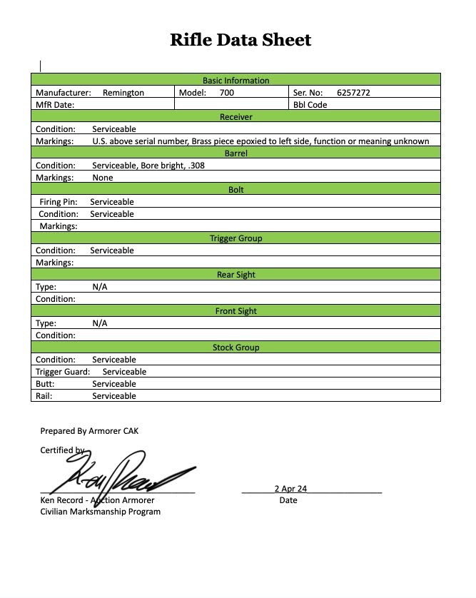

I purchased this rifle from the CMP about a week or so ago and it arrived today! This is a very important M40, and I doubt that anyone could ever guess it's actual history and the units that it was used with! Now I need to figure out what the correct scope, base, and rings are!
https://cmpauction.thecmp.org/detail.asp?id=8509&n=Remington-Model-700-Serial-Number-6257272

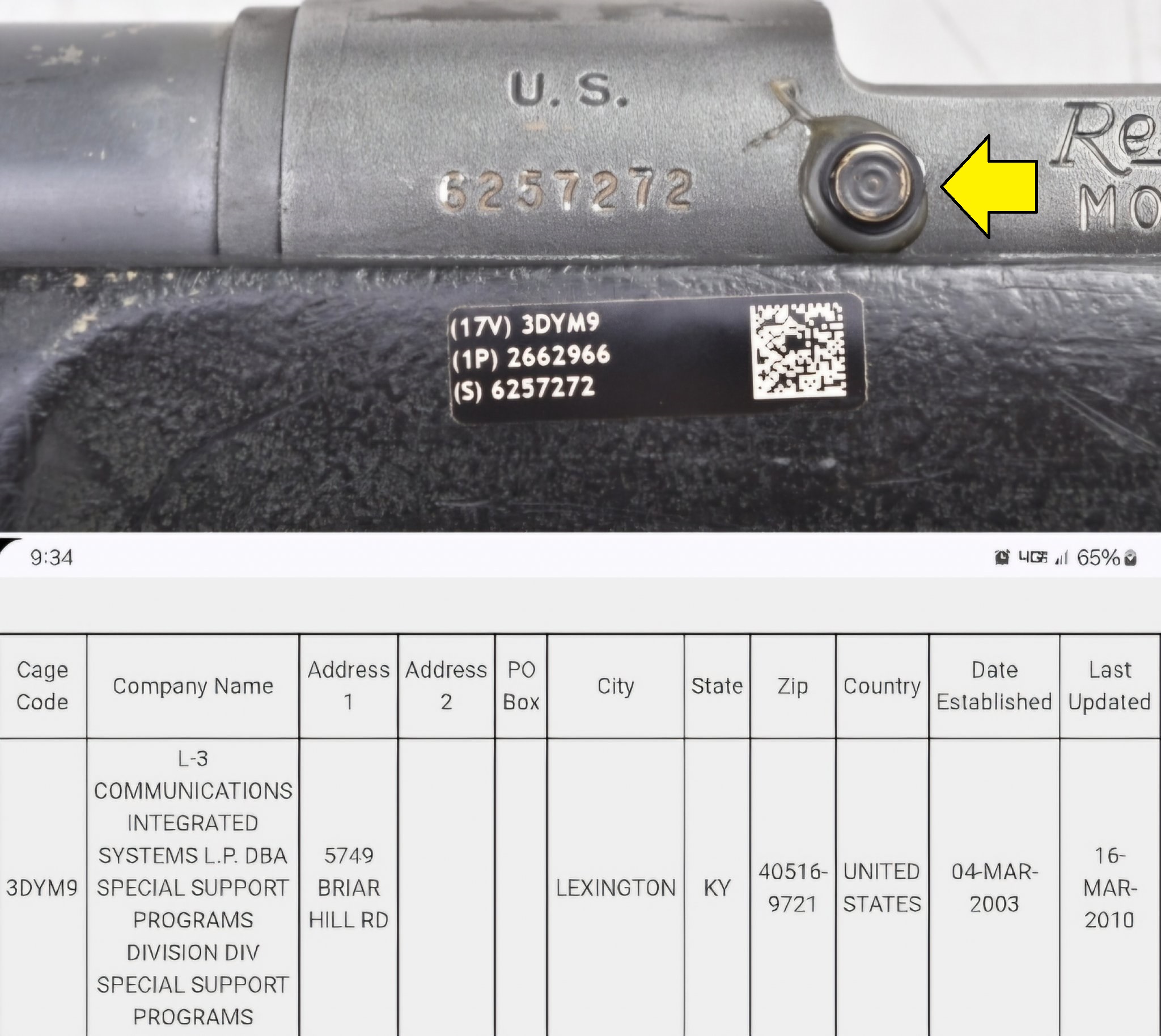

Also, look at the cage code (top line) on this UID tag (photo below)! The middle line is the part number for the M40, and the bottom line is the serial number for the M40. The top line is the cage code, and I was expecting it to say Remington, but I was quite surprised to see this instead! A military contractor, L3 Communications (now they're L3 Harris), was in possession of this M40 for a while and probably supplied it to the Army.
Did they acquire it from the Air Force? Acting as an intermediary between service branches? Did they acquire the rifle from Remington on the original USMC M40 contract to supply to other branches? Did they request DRMO rifles and modify them to suit the specialized needs of other military branches or specific military units? Were they modifying rifles and producing custom sniper rifles for the military like the DARPA XM3 rifles?
There's lots of questions, but unfortunately there's not many answers. The CMP also said on the data sheet (photo above) that there's a brass piece on the side of the receiver and that it's function is unknown, but this piece has been identified. This is a pretty simple one, it's a Contact Memory Button (CMB) that was used for armory management. That's all, nothing more. I'm kinda surprised that the CMP couldn't figure that one out.
Edit: I originally had information that this button was some type of RFID tag, but this information is incorrect. This is actually a Contact Memory Button, which functions differently than an RFID tag, but can provide the same information and serve the same function once it's encoded.
I don't buy much from the CMP auction site these days, but this M40 stood out from the rest and I had to bid on it. It wasn't cheap, but that's what these things go for! I'm extremely happy to have won this rifle, it's history is extremely unique and has given us insight into new M40 information/research that we never knew existed!
The UID tags came into the system at the end of 2005, so this rifle was most likely active then. A FOIA request to AMC at Redstone may yield interesting info. The CMP 1911a1 forum has the "how to" initiate the request, lots of 1911a1 buyers get quick results, as well as those buying M24 receivers from the Remington bankruptcy......Also Marty at Badger used to be able to access the data bases, which are behind the DOD firewall. Congrats on this unique rifle.....
I purchased this rifle from the CMP about a week or so ago and it areived today! This is a very important M40, and I doubt that anyone could ever guess it's actual history and the units that it was used with! Now I need to figure out what the correct scope, base, and rings are!
Did they acquire it from the Air Force? Acting as an intermediary between service branches? Did they acquire the rifle from Remington on the original USMC M40 contract to supply to other branches? Did they request DRMO rifles and modify them to suit the specialized needs of other military branches or specific military units? Were they modifying rifles amd producing custom sniper rifles for the military like the DARPA XM3 rifles?
There's lots of questions, but unfortunately there's not many answers. The CMP also said on the data sheet (photo above) that there's a brass piece on the side of the receiver, but it's function is unknown. This is a pretty simple one, it's an RFID tag that was used for armory management. That's all, nothing more. I'm kinda surprised that the CMP couldn't figure that one out.
Interesting. I worked for L-3, which was really a holding company for their many subsidiary companies. We did lots of "stuff" from special mission support to flying and training (then) current gen mil aircraft. Makes me wonder why "we" needed an M40 and what we were really up. While it's listed as Lexington, I'd suggest that was a corporate address and the rifle was really with the 101st at Ft Campbell. ;)

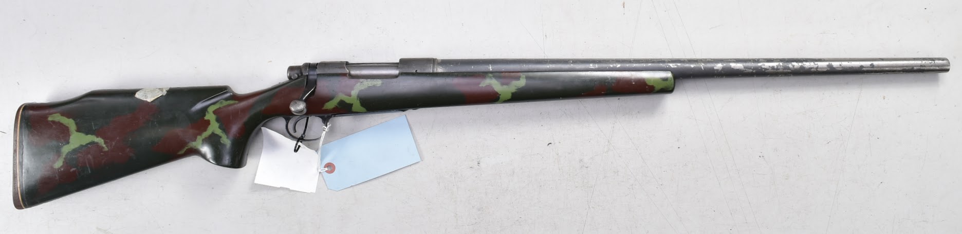

https://cmpauction.thecmp.org/detail.asp?id=8540&n=Remington-Model-700-Caliber-762-x-51-mm-6257199
Here's something I haven't seen on there before. The bottom metal is regular bdl, NOT m40a1. They describe it on the site as being painted camo. Finger painted by Kelly I guess, lol.

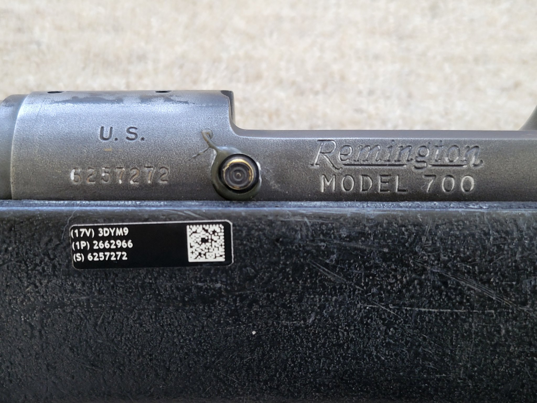

This is the brass piece, clearly epoxied, that they are talking about. I don't know what it is either.
Some say the epoxied brass piece near the s/n is an ID tag, prior version of the QR tag, discussed on the CMP auction forums a few weeks back. QR tag was required after 12/31/05.
I should have changed my post to reflect what these "brass tags" actually are. In my post I stated that they're RFID tags, but this is incorrect. These are actually Contact Memory Buttons (CMB), and the military has been using them for about 2+ decades. You just hold a specific handheld device to the CMB, then it will read whatever information is stored on that specific CMB and display it on the device's screen. If it had access to one of these portable devices, I'd actually be able to see what information is contained on the CMB on my M40.
