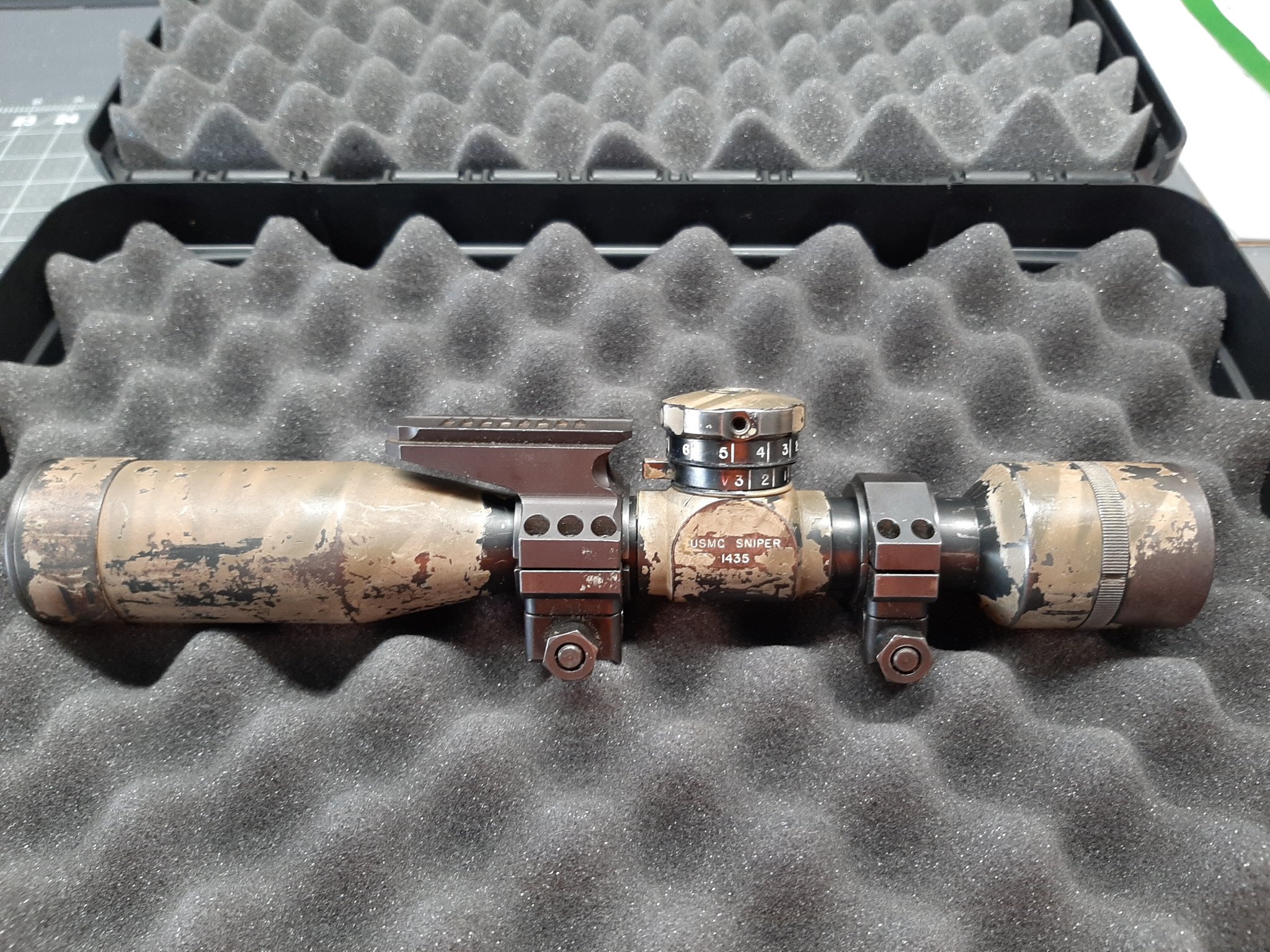

Idk if you are looking for more info but I have 1435. I'm not the original purchaser.
Came with the A3 badger mounts and no USO mod.

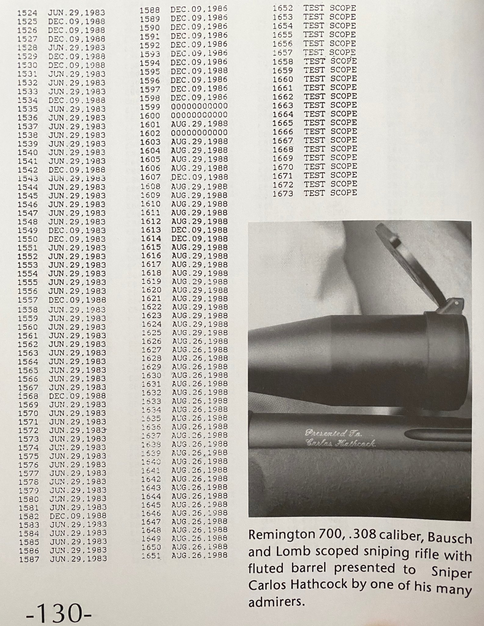

Chandler, Death from Afar, Volume 1 list the serial numbers and dates of purchase for scopes from 1006 up through 1651. It also lists 1652 through 1673 as "test scopes". In the higher serial numbers shown, the dates of purchase bounce around between 1983 and 1988.
Based on the higher serial numbers observed in the CMP scopes, there were apparently purchases and deliveries made subsequent to the list in Vol. 1.
Reactions: lockedandloaded
Yes, DFA covers the delivery’s for the first batch circa 1980 until August 1988 (ending w/ serial number 1673). However, in 1992 the USMC ordered 100 new M700 receivers from Remington (C-prefix) and my guess is they possibly ordered more Unertl scopes as well (these would have serial number above the upper 16XXs). Unfortunately records have not shown up regarding orders in the 1990s, but it seems that about 200 plus Unertl scopes for the M40A1s were ordered at some point after 1988.

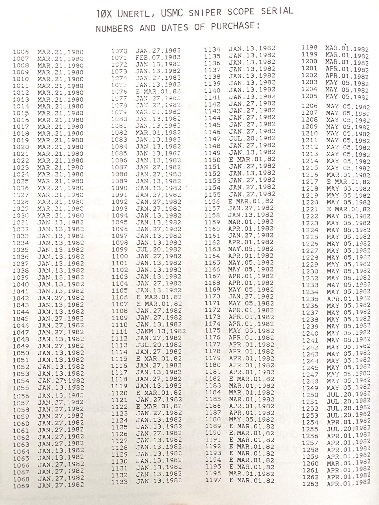

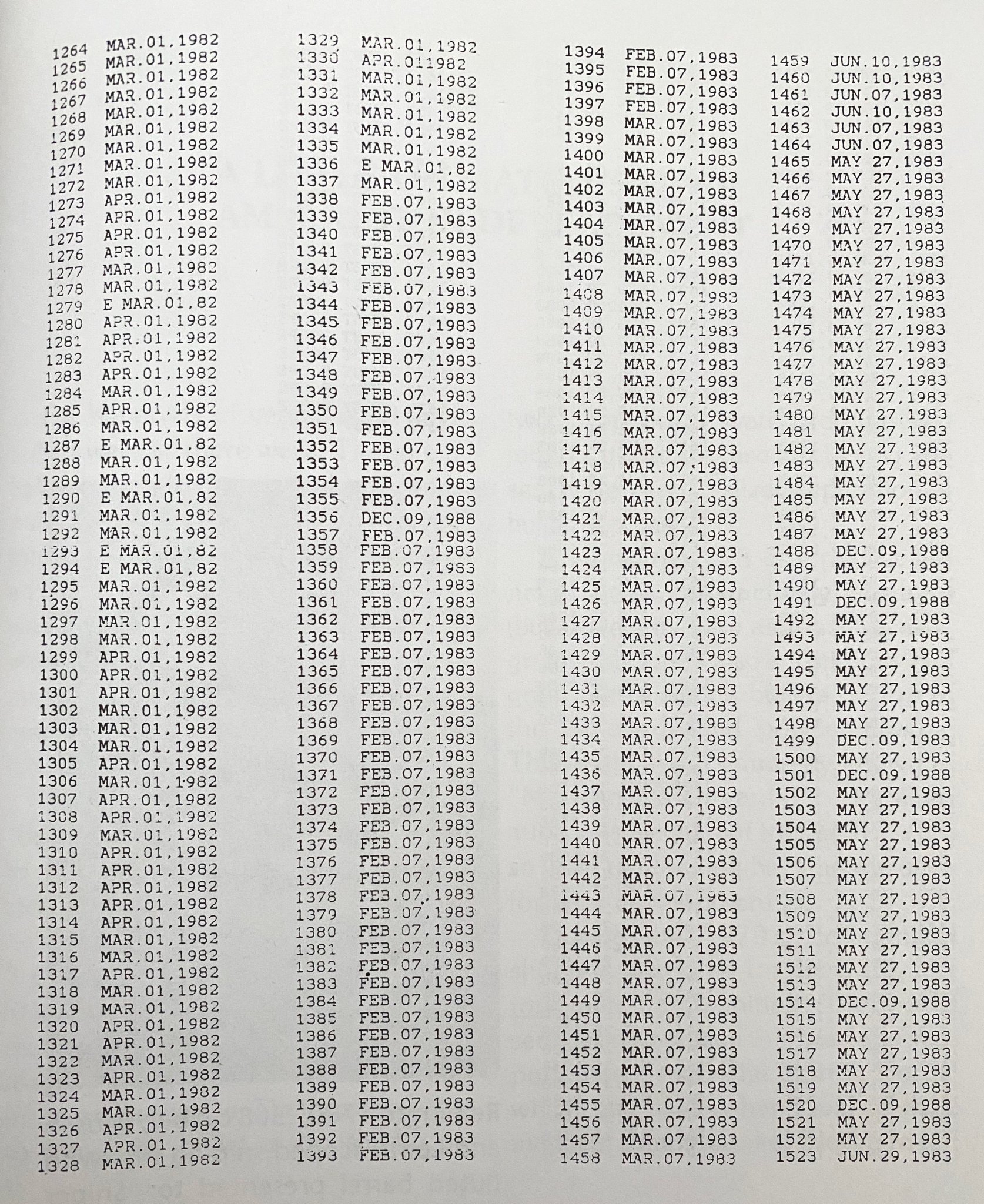

Serial numbers and dates of sale pulled from Death From Afar Volume 1, pages 128, 129, and 130. I’ll let someone else scan the data in to a more digitally accessible structure format, lol.
View attachment 8410080View attachment 8410081View attachment 8410082
Damn. Good info and thanks. So it appears that the USMC ordered at least 240 additional scopes which would cover #s 1674 trough 1913...if they are, in fact sequential. Be awesome to confirm 1913 was the last Unertl issued...that would mean 913 Unertl 10x sniper scopes were issued to the Marine Corps...
