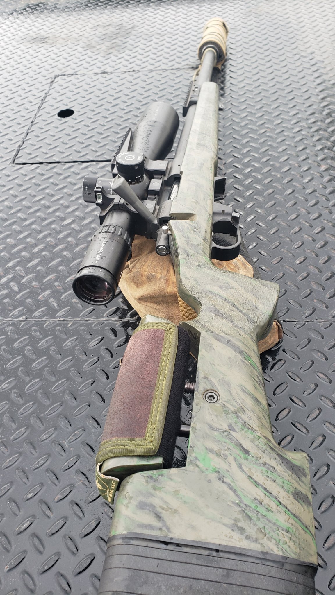

I have a surgeon that has been dlc coated, at least the bolts have been. It’s on numerous barrels on both the standard bolt face and the 223 bolt.
