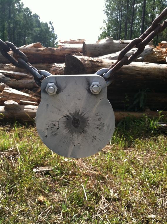

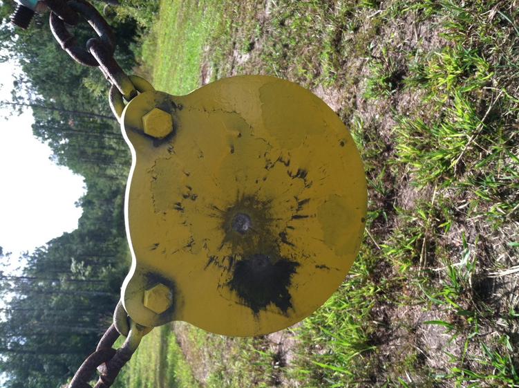

So took out my 6.5 creedmoor today for the second time. After breaking it in and everything the first time i brought it back home and cleaned it. knowing that i figured my first shot today on a clean bore prob wasnt going to be in the middle of my groupe (which it wasnt). It was 4 in high and 4 in left but after the bore got fouled my group tighten back up. I then let the barrel cool, on the first shot again 4 in left and 4 in high. I thought that this was a clean bore issue but I guess it is a cold bore issue. What do I do to remedy this problem?
The day did finish well this orange target is my first trip out to 300 with this rifle and really with any rifle on a range and not just deer hunting.
The other picture (white target) is from when I decided to make sure my scope was tracking backed it down from 300 to 200 and was very happy with the results. photo 1.jpgphoto 2.jpg
The other picture (white target) is from when I decided to make sure my scope was tracking backed it down from 300 to 200 and was very happy with the results.View attachment 16935View attachment 16936
