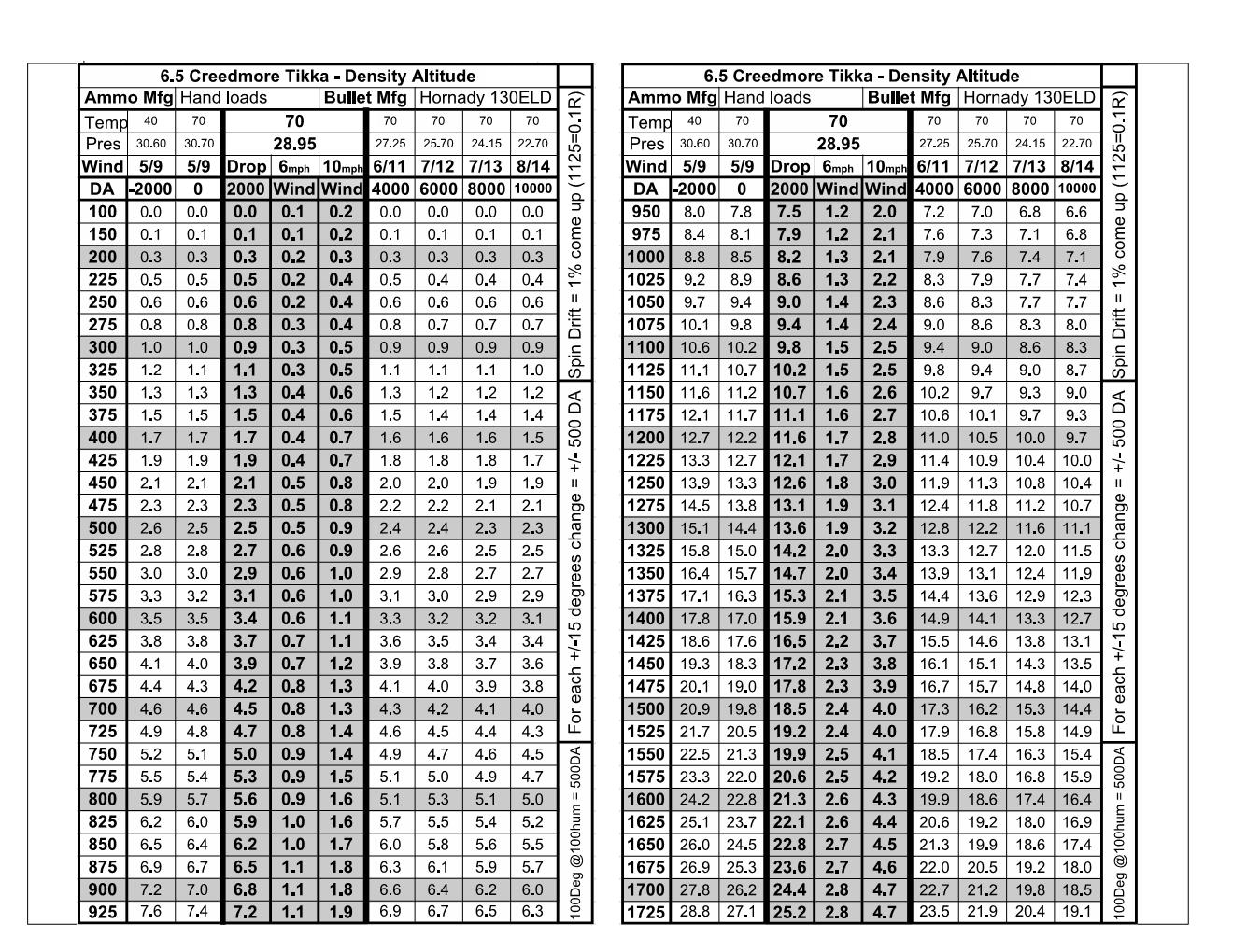

@Jack Master posted these which show what you are seeing, da based but show the temp changing effects.

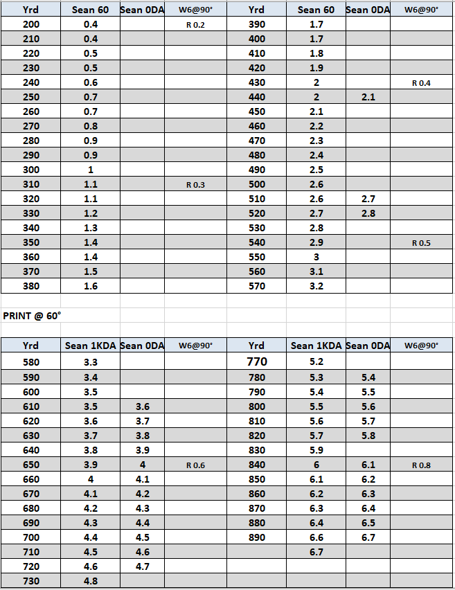

You create this from your dope on your gun.
You need to go and shoot your gun at know distance and capture all the relevant data on paper. Gun settings, ammo specs, environment, zero range, etc. Then you can go back and true this up with various ballistic programs or apps (most free). Once you have this it is very easy to make DA or temperature charts for your gun and ammo combination.
They are all different.
This is my gun, shot known distances with a solid zero, 3 shot groups on freshly painted steel with waterline. Captured all data on paper, then when home trued MV @ 598y distance(YELLOW), and trued BC @890y (BLUE if needed) on several apps and Kestrel.
Then printed paper for my wrist coach for our club match this past weekend, I knew the morning would be roughly ZERO DA, and in the afternoon up to 1000 DA so I captured only where the DOPE would change to make it easier to see quickly. You could do the same for 20 degree changes in temp at a fixed altitude.
