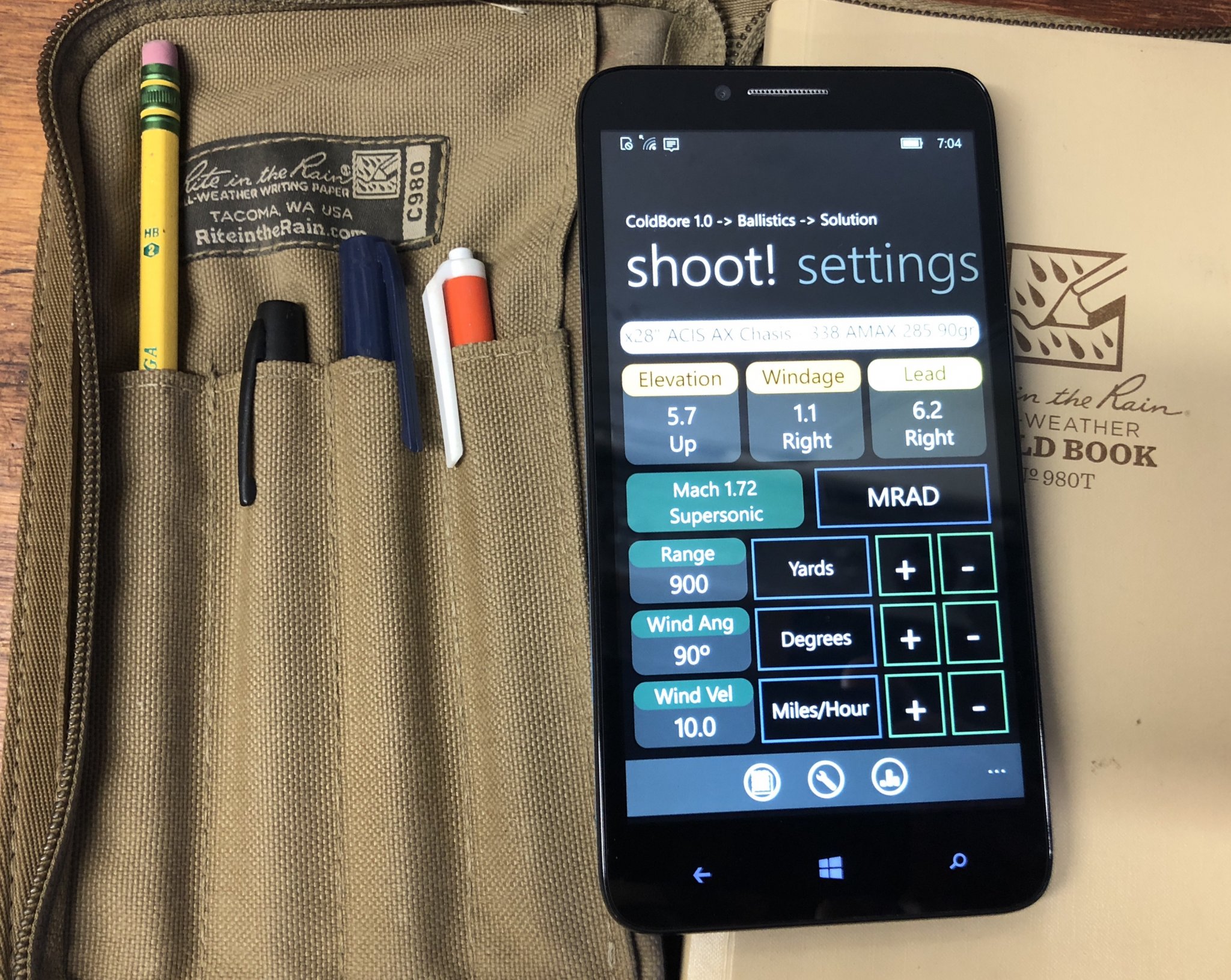

Thought we could start a thread on all things Coldbore (hardware, software, questions, advice etc). I am by no means a expert, I have some experience with the desktop and app on a windows phone, there are however some very knowledgeable folk on the hide whom I hope will join in and help out.

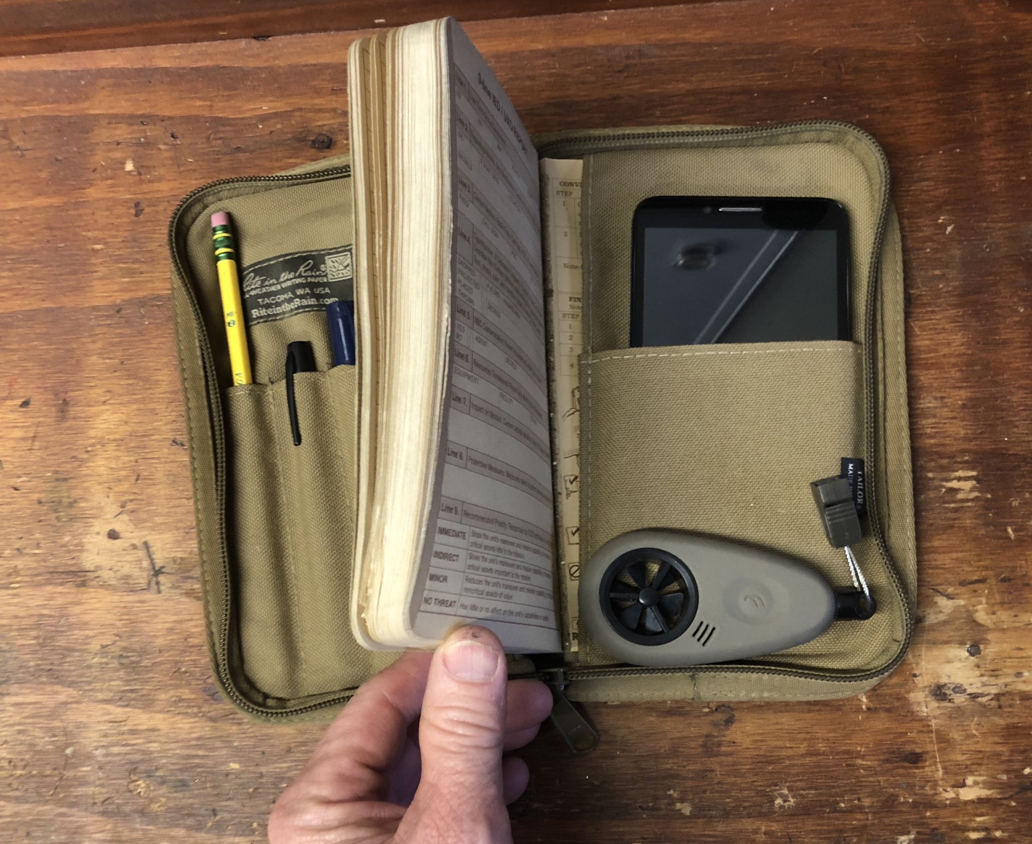

For those interested I run Coldbore 1.0 on a Nokia 550. I don’t have a SIM card in it as I use a kestrel to obtain environmental data and input that into the application, and upload and download tracks via wifi. I run seperate battery bank/charger and can readily get a couple of days use out of the phone at a competition. I have not tried it for an expended hunt in inclement weather - plan to put it in a small pelican type case and print/ laminate Density altitude cards for hunting.
I have gathered real world dope for my 260 rem (a Tikka T3x in an AICS stock) and my 300WM (TRG42) out to 1008m so far and and both are spot on.
I trust that this will get the questions and discussions flowing.

As stated above I run the Nokia Lumia 550. From the Patagonia website it suggests the following hardware and software to run its mobile edition:
Hardware specs ( minimum )
-ARM-based processor (if different, please contact us).
-Display resolutions : QVGA (240 x 320), WQVGA (240 x 400), VGA (480 x 640), WVGA (480 x 800).
-Touch Screen device.
-624Mhz processor.
-128Mb of total device memory is highly recommended.
-55Mb of free program memory (during execution).
-35Mb of free storage memory (for program, databases and associated files).
Software specs ( minimum )
-Microsoft® Windows Mobile® 2003 Second Edition
-Microsoft® Windows Mobile® 5.X
-Microsoft® Windows Mobile® 6.X
Looking at a comparison between my 559 and the 635 they appear to have comparable hardware

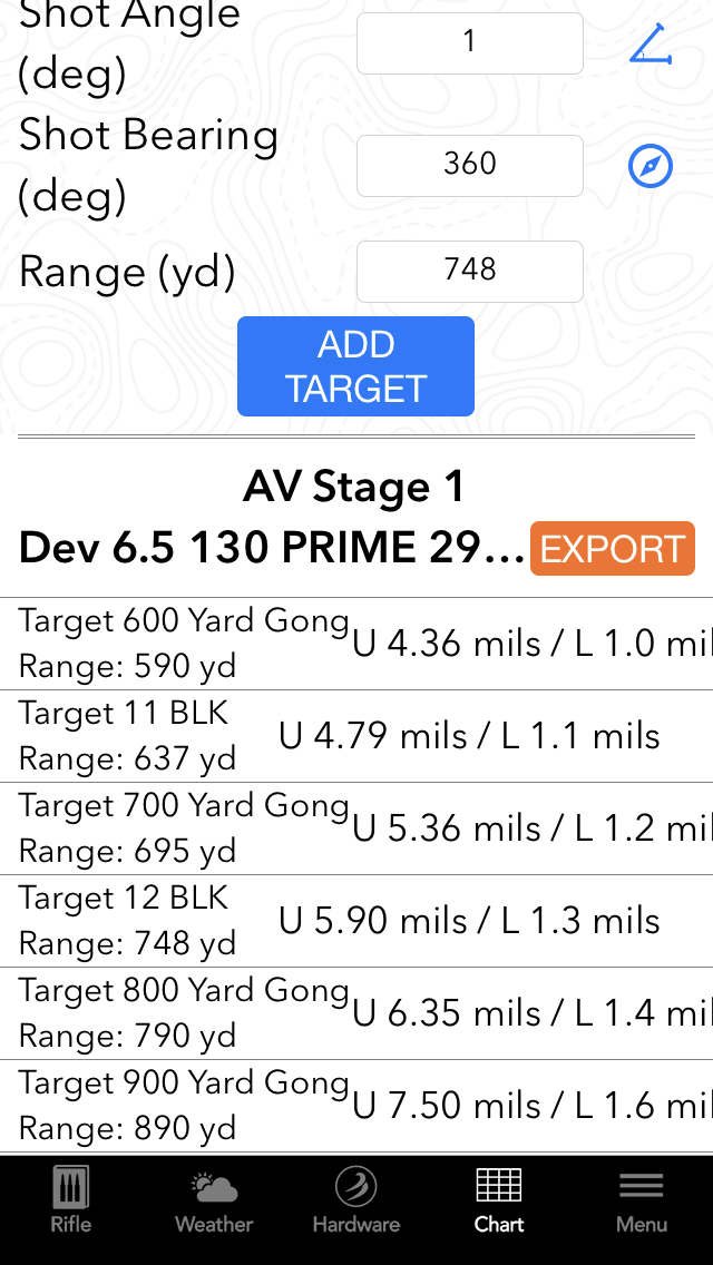

What CB does is a list of targets sorted by distance, which is different to what GeoBallistics does because it also includes the fire solution. I'm sure that arrangement works well for those interested in PRS or something akin to.

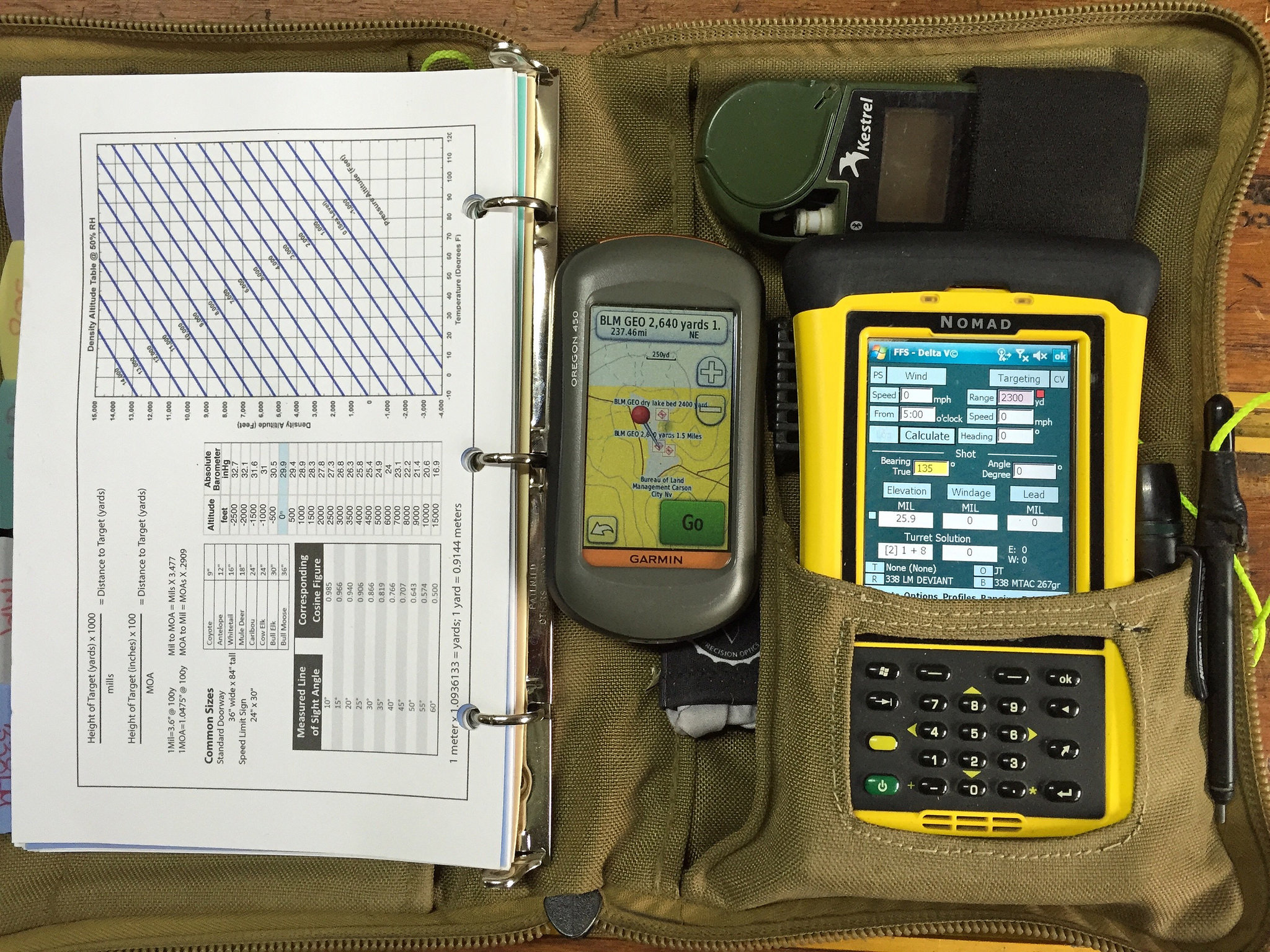

Before I moved to the Phone, I ran both FFS and CB on a NOMAD and later on a JUNO3B. Honestly I cannot bear those old horses any more, and a man should do something about so, I got rid of both (sold both time ago for a good price) and never looked back.

In agreement. Would like to add a bit of context to the FFS/CB/GeoBalistics range card.
FFS’s utility come from milgrade RF tethered. Range set done, multiple targets near meter accurate. It also includes GPS and mapping features that are slow and cumbersome... fine for planning but not the best on site tool.
CB and BallisticARC use similar GPS and Sat images to determine FFP to targets. But like FFS this method is NOT the same as tethered.
When it comes to manual entry, lazed beats GPS/Topo for time and precision. Manual known range is way faster than using a GPS tool.
Are you showing up at a match and have 20 minutes to make your game with know distance stages? Go BallisticArc. Do you need meter accuracy? Go tethered. Want the best desktop program? Go Cold Bore Etc.
These are all things for your consideration.
