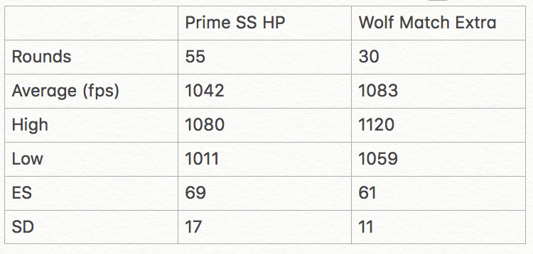

Here is a velocity comparison, The Prime ammo is SLOW. Note that the velocity printed on the Prime box is 1034 fps. Also, the WME is more consistent. If I deleted a single "hot" round from the 30-round test, the WME SD drops to 9.

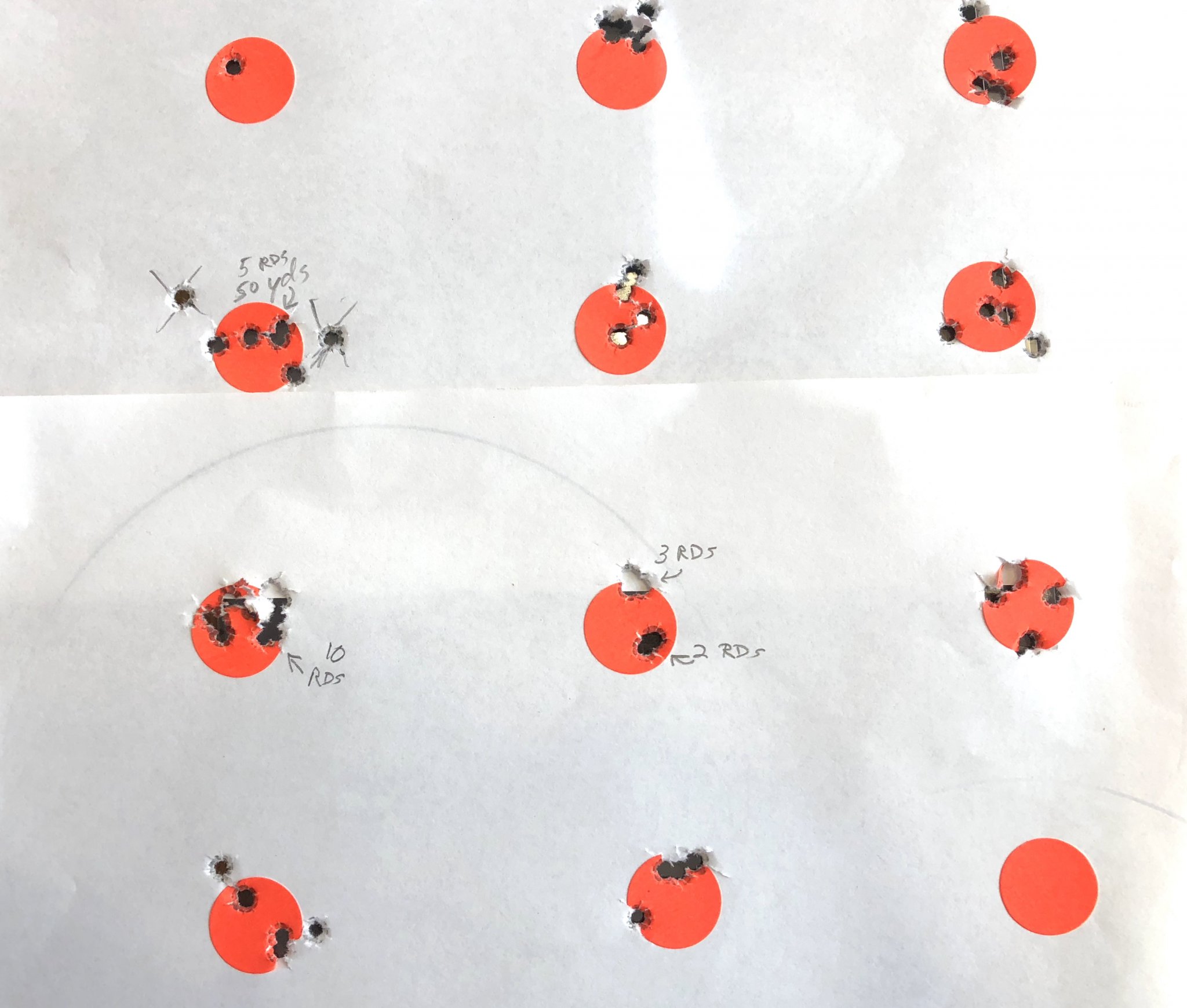

Accuracy of the Prime in my rifle is comparable to Wolf Match Extra (WME) but not quite as good. Average 5-shot groups were 0.6-0.75" at 50 yards. WME seems to do 0.1-0.25" better. I forgot my Gamechanger bag when I shot the Prime. I used a folded towel as a rear support on the bench for this test; towel was ok but subjectively not as stable as the bag.
Here is a representative sample of Prime 50-yard groups. I do not have an image of Wolf groups to compare; suffice to say the Wolf groups are a bit better. Orange dots are 0.75." Again, these may tighten up with a good rear support bag. (Ignore the top left dot with a single round on it.)
Hope this helps folks decide whether to take advantage of the Prime sale. For me, I am very very pleased to get this level of performance at 6 cents a rounds.
UPDATE 08/18/2018: Back to the range today with Gamechanger bag for stable rear support. Similar results in terms of group size, although wind was a bit more noticeable today. As shown in the image above, I could place 3-5 rounds in a single ragged hole and then have two or three rounds hit half or three-quarters of an inch away. Happened with both the CZ and Ruger RPRim I've been working on. Are flyers a fault of ammo? Or rifles? Or both? Ahhh, the world of .22. Life was easier with 600 tiny lead pellets going after a single clay target 21 yards away.
