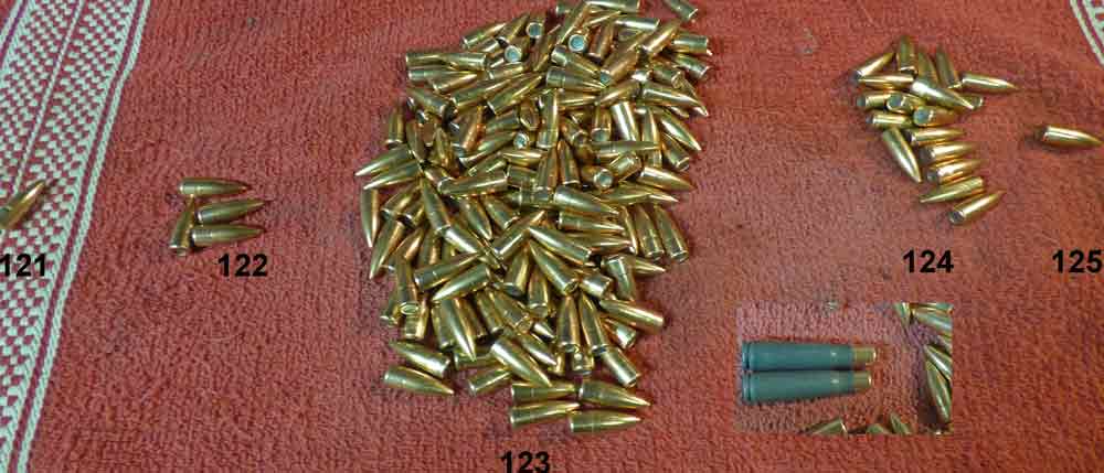

With junk steel case/bimetal jacket 7.62x39 I pulled down hundreds of rounds to sort and put back together.
The cases had a range of about 4 to 5 grains, the bullets about 2 grains (exluding the few outlyers) and the powder was surprisingly consistent @ +/- 0.2 grains.
The as new ammo had a range of about 6 grains. Obviously the lightest few (of a case) had light case and light bullets, and the heaviest few had both heavy components. Since the bullet and cases are selected independently and assembled, statistically, anything in the middle had a pretty equal chance of having light/heavy or heavy/light components. I "think" I was able to determine that the lightest 30% and the heaviest 30% grouped better.
But, this was cheap steel case ammo.
The cases had a range of about 4 to 5 grains, the bullets about 2 grains and the powder was surprisingly consistent @ +/- 0.2 grains.
interesting the 30% lightest and the 30% heaviest grouped better.
The lighter 30% grouped better and the heavier 30% grouped better, separately, than unsorted.
The extreme light and heavy few were culled and pulled down.
Had friends that claimed to have found very light charges. I NEVER have.
Heavy charges would be unlikely with 95% + fill.

I had to sort 100 22 Nosler reloads once. Dropped 50 loaded with IMR4350 and 50 loaded with CFE223. Same bullets and could find each powder by total weight. Cases were presorted to a grain though.
Here is a silly sorting video that shows distribution of X39 rounds.
