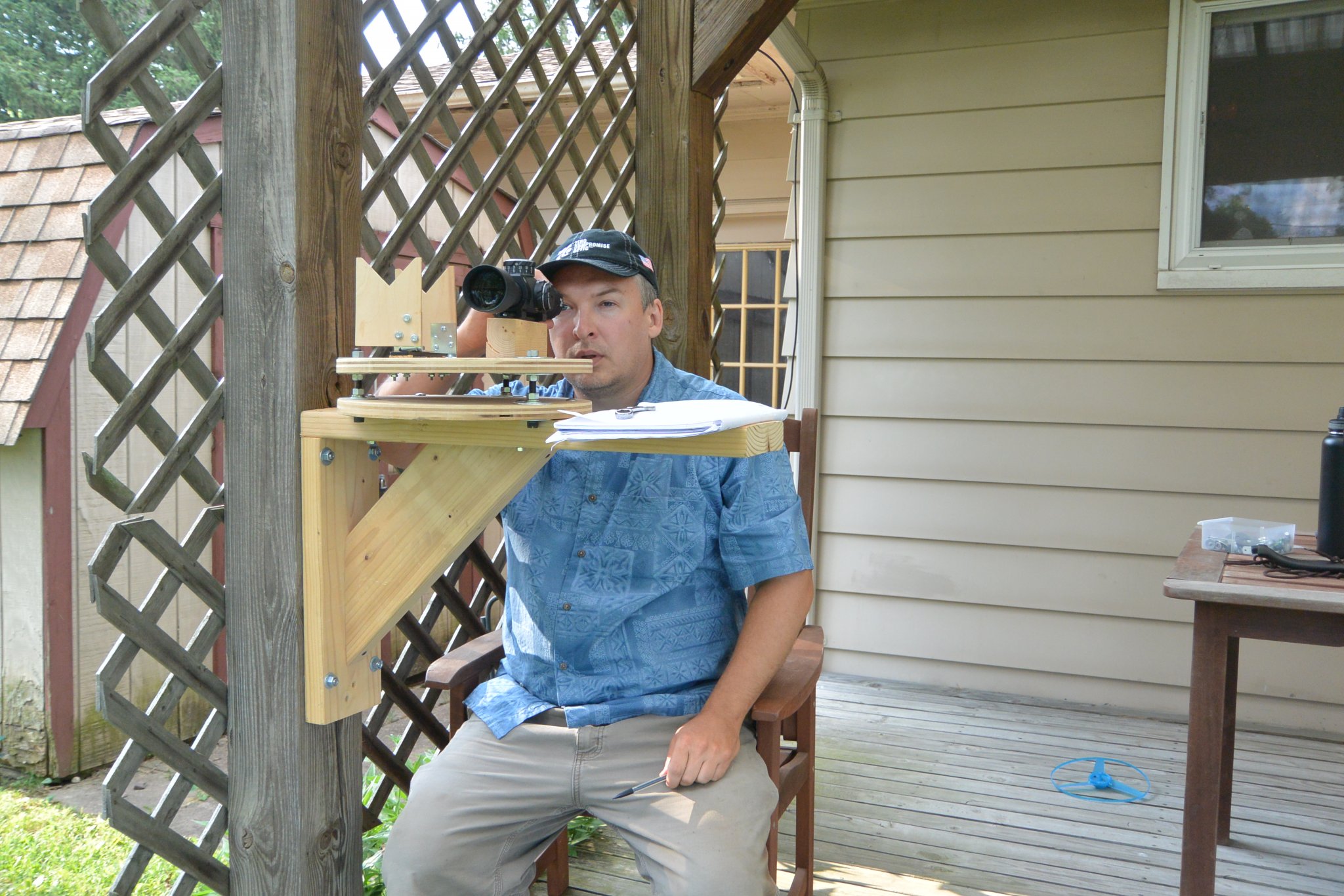

Tracking testing is best done without firing rounds as you are adding a good deal of variance by including the gun, shooter, and ammo in the equation. It is best done with the scope mounted on a solid fixture and viewing a properly calibrated target at a carefully measured distance. FIxtures exist and can be purchased. Here is the one Frank and Mark designed a few years back. You can also make your own fixture from steel if you are a welder or from wood if you have that skillset. Mine is of wood and is quite robust and effective.
I couple years ago I posted a scope testing methodology article that has some information on exactly how to run mechanical tests on a scope as well as some information on the fixture I built. Minnesota already linked you probably the best current target for doing testing. The larger Horus CATS target I use is no longer made since Horus was acquired by Nightforce. You could just tape a couple of the smaller targets together to get the same effect though or run them at half the distance from the scope. I would recommend a good deal more vertical test range than 3 mils. Frankly, you should be able to test from optical center all the way to max elevation as not all problems show up in the center of the scope. Often errors are not linear. It is also good to have a few mills each side of center to do a bit of a box pattern with as sometimes being off center horizontally can effect vertical tracking as well. Lastly, even if you have already tested a scope unfired be sure to test it occasionally after use as they sometimes eventually "settle in" to being less on point than they were out of the box.
