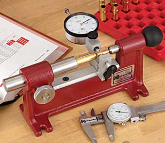

Bought one of these a while back:
Hornady Manufacturing Company :: Reloading :: Metallic Reloading :: Tools & Gauges :: Lock-N-Load® Ammunition Concentricity Tool :: Ammunition Concentricity Tool
By checking, and then using the "adjustment feature", I am able to catch and fix any problems quickly & easily.
