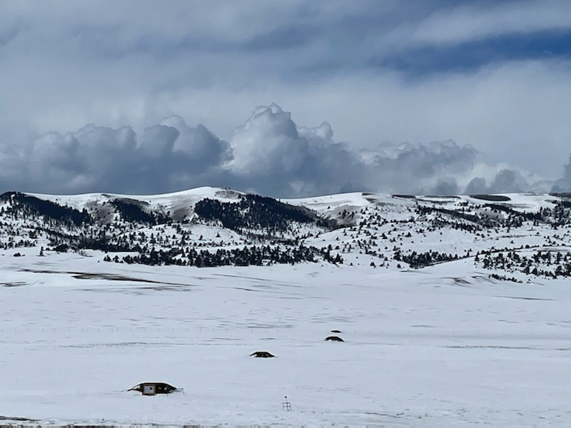

Spent the last few years looking for land where I could stretch out my rifles and finally found what I was looking for end of last year.
My requirements were Good Natural Berm, backing to Open Space/BLM and No HOA.
Did not want to settle or compromise. Glad I waited as I finally found a 60 acre lot which backs to 20K acres BLM with mountain backstop.
What part of the country is this?
Im actually looking for something like above. bordering properties being the biggest factor. Best would be BLM because you can use that. or Nat park type Gov properties not being used for recreation. Next bordering large lots of inacessable rugged unusable property. lastly bordering large commercial or farm land. Far away from any homes or roads and Out of any city limits.
Park County Colorado
