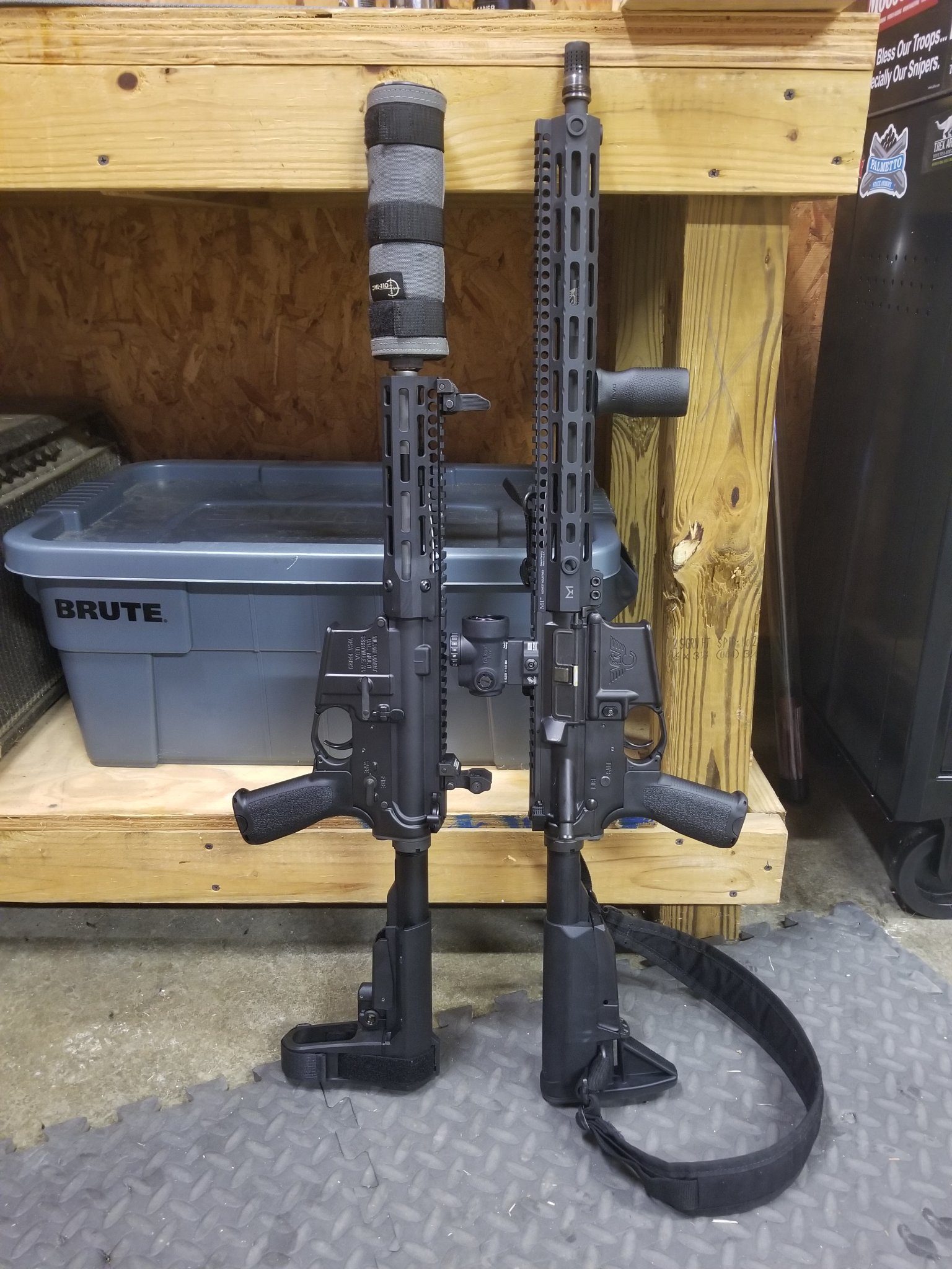

I just built one. It's definitely not a long range round. The big selling point to me is the efficiency out of short barrels. 8.5" barrel with Q thunder chicken is shorter than 16" barrel and muzzle device. Even with that short of a barrel you still have good enough ballistics and more close range energy.

16" bolt and 10.5 AR. The AR doesn't see much use these days. With 6.5 gr of VV N32C and 150 FMJ, it's stupid quiet and fairly accurate
out to 275 yds. ( .8" @ 100 yd). I can also replicate the trajectory of my 6BR at 4:1 ( 250 yds= 1000 yds) with a 75 yd zero.
