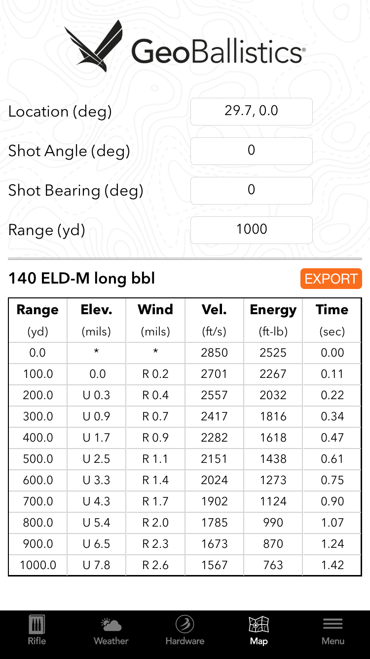

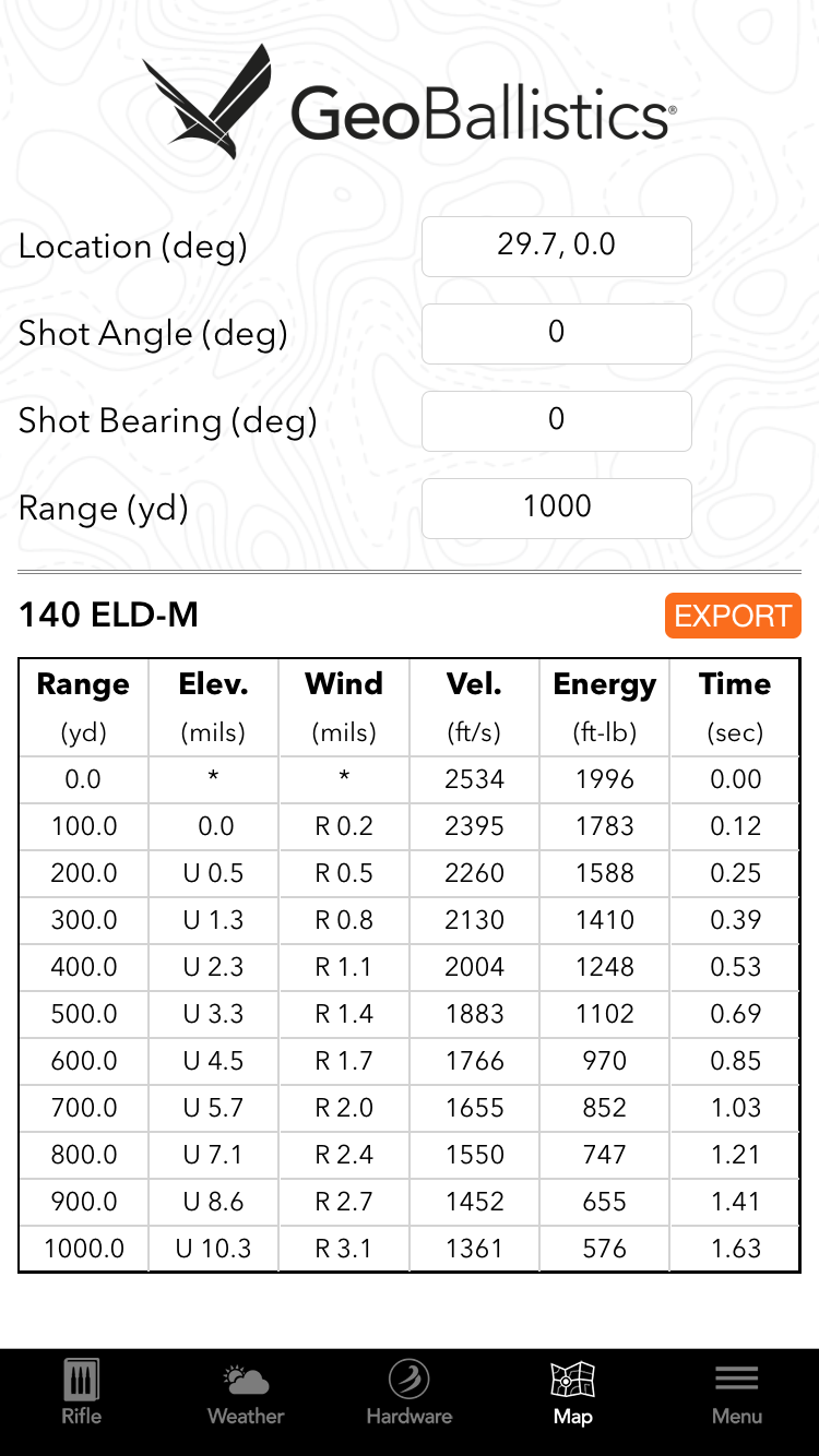

    So... I took my current load and a 10mph full value wind and plugged it in for my current 2,530mv and compared it to an assumed 2,850mv from a new 26” barrel:
    At 600-800 yards, the improvements in the wind are less than .5 mils. Obviously that improvement grows as you get farther out and the wind gets faster, but at my current ranges/representative conditions the improvement seems like
    A small payoff for dealing with a long ass barrel.

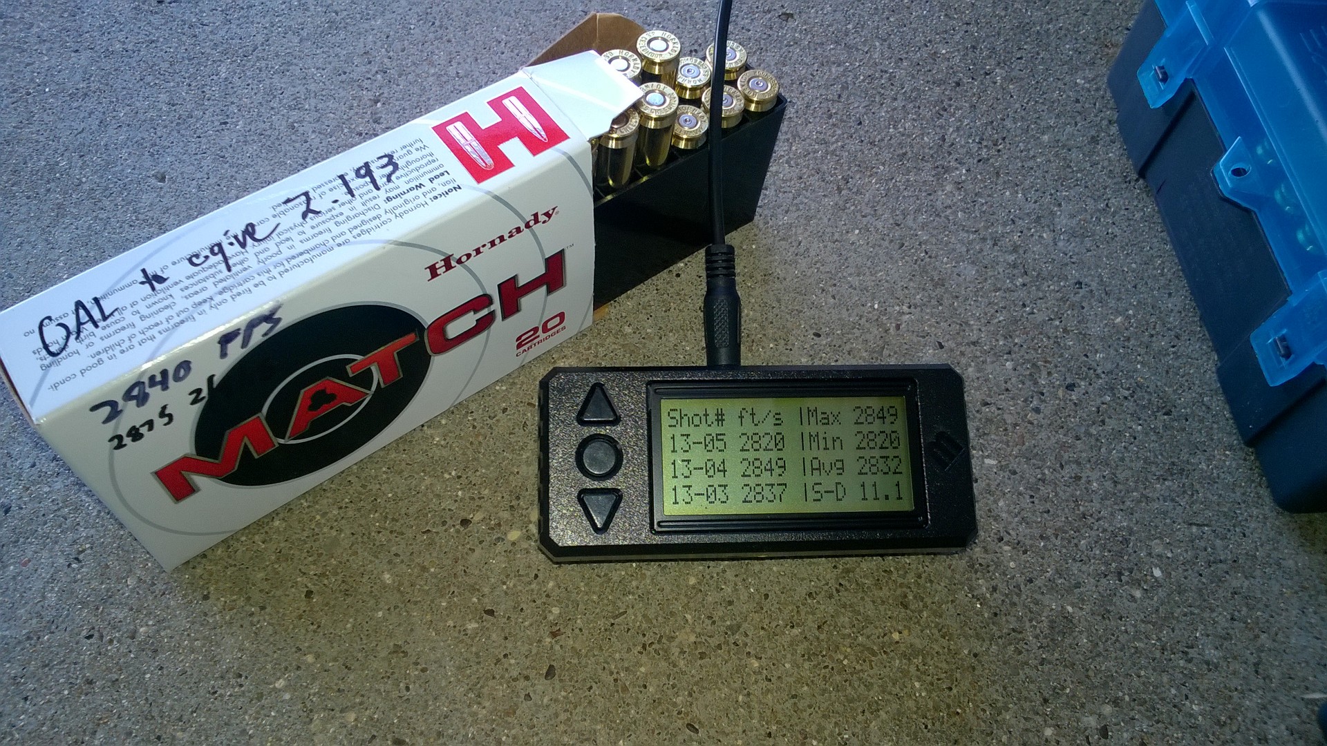

    Depends on the barrel. My 26" Benchmark shoots the factory 140 ELDM between 2840 and 2860.
    With my handloads, I push the 139 Scenar to 2910 without a problem.

    The handloads i have shor through mine are my buddies 147 eldm loads. He is shooting them at 2750 i think. He was @ 2825 ish last winter but when the temps came up during the summer he started having blown primers so he backed off to a lower node to be safe in all conditions.

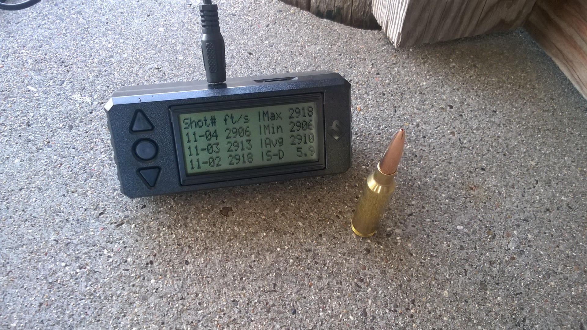

    Nope, I get it. There's variability between barrels, and mine is probably on the fast side. Also, environmental conditions make a difference.
    As for "trueing", I haven't done a lot of it, but based off of that MV, I'm making first round hits out to 1270 yards on 1moa-sized targets, so I figure it must be close enough.
    Here's my 139 Scenar hand load:

    i had to reread to see what it was about. Factory ammo is slow handloaded can be much faster. Seems right.
    I actually have had several more 6.5 barrels since this thread started. Same results on my end. I can’t seem to get much over 2700 out of factory Hornady stuff in long barrels whether bthp or eldm ammunition. Prime 130s are much much faster and have seen the speeds some guys say they get with factory Hornady.
    Some people may see speeds that are 150fps over what the hornady box states. I just haven‘t personally seen it. Not even close.
