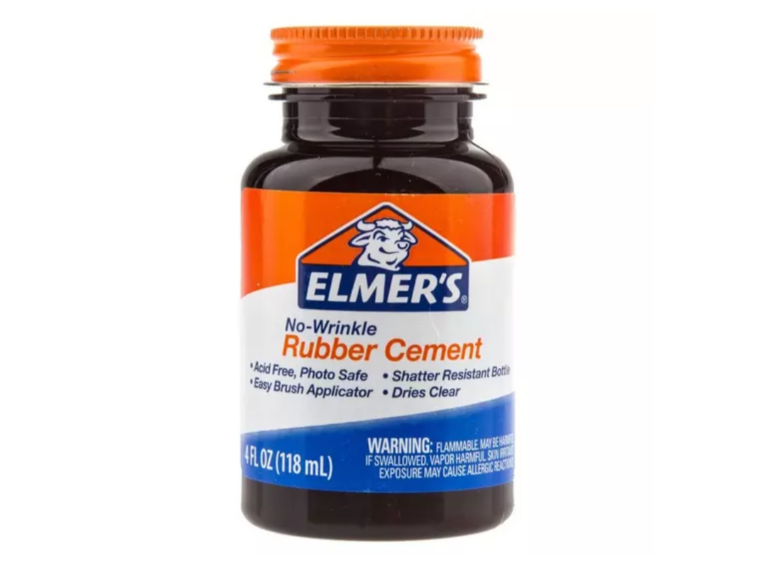

try some rubber cement in the rings. clean both the scope tube and rings with rubbing alcohol. Apply the rubber cement to the rings. Torque the scope in them and clean up the excess. This worked for me on a 416 Taylor I couldn't get the scope to stay put on until I did this. The rubber cement is also very easy to clean off of the scope and Rings once it is dry if they are ever removed

For $3 I'm going to give the rubber cement a try - pretty familiar with that stuff as I used it a lot as a kid in school. I know it cleans up quite well and I can't imagine it having any kind of electrolytic or other chemical reaction over time between the scope and rings that would damage either one.
@Aftermath - Just want to confirm, for the clear lacquer - you were using it functionally like glue in the middle of the scope ring? And you mentioned long ago - Do you still do this today and how did you remove the scope / rings (i.e. would "just pull hard" deform the scope body at all)?
That was the tip Ross Seyfried wrote about some years ago to prevent scope slippage on his big magnum rifles.
