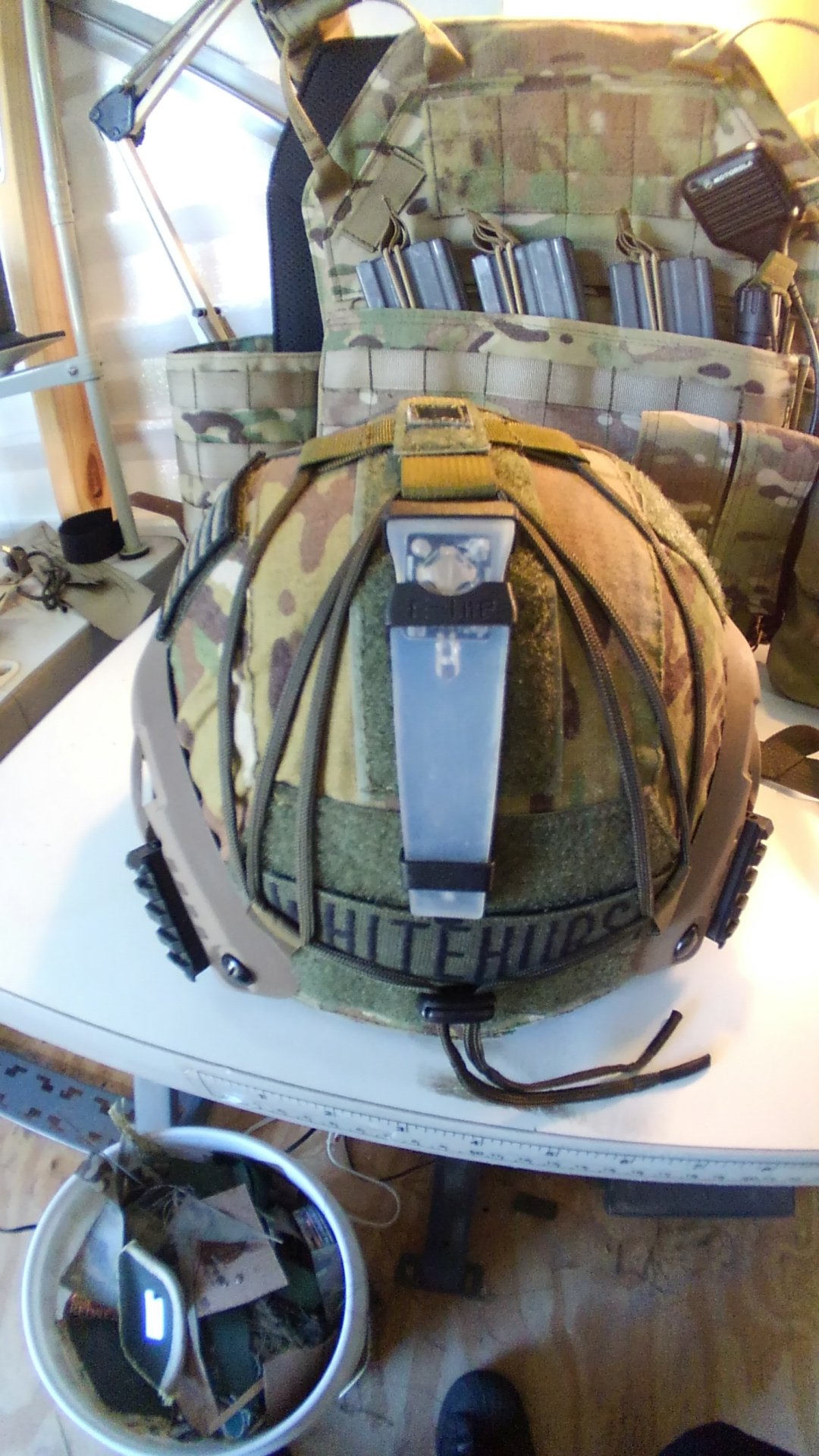

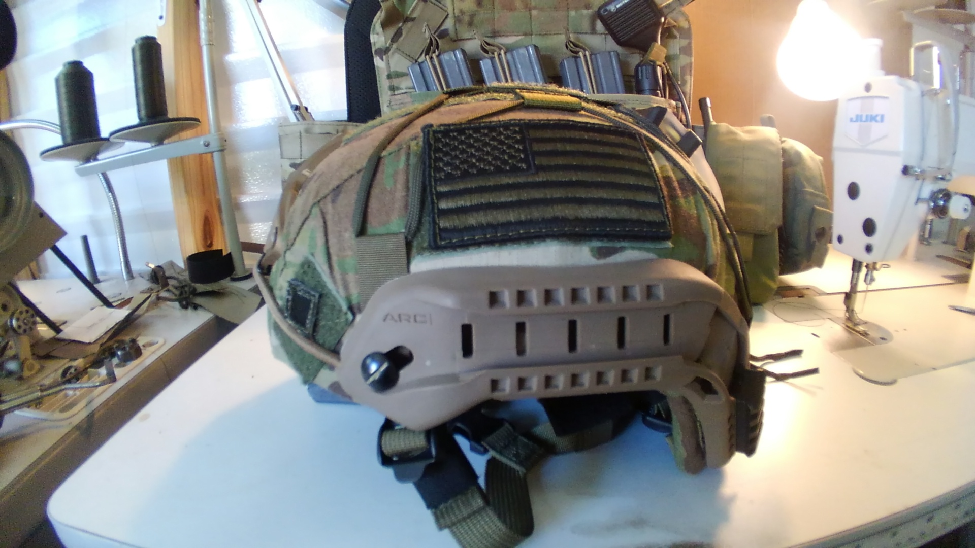

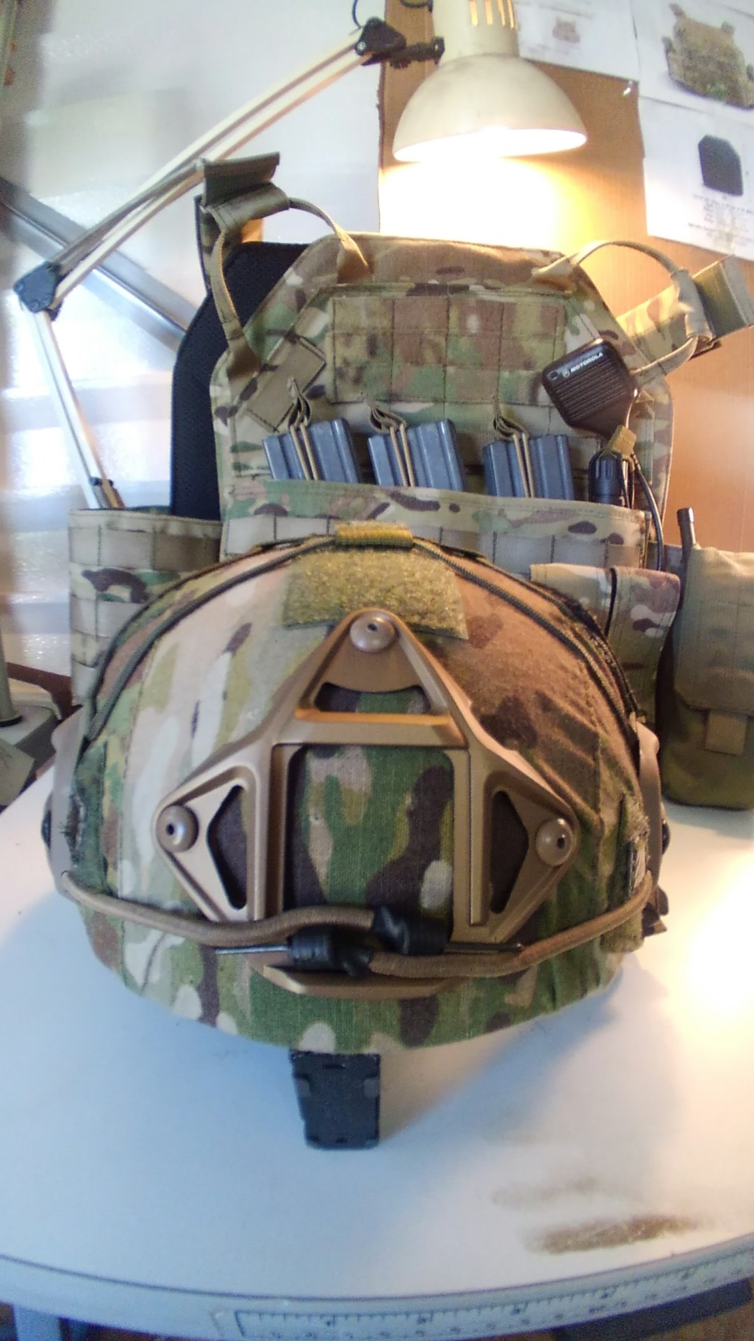

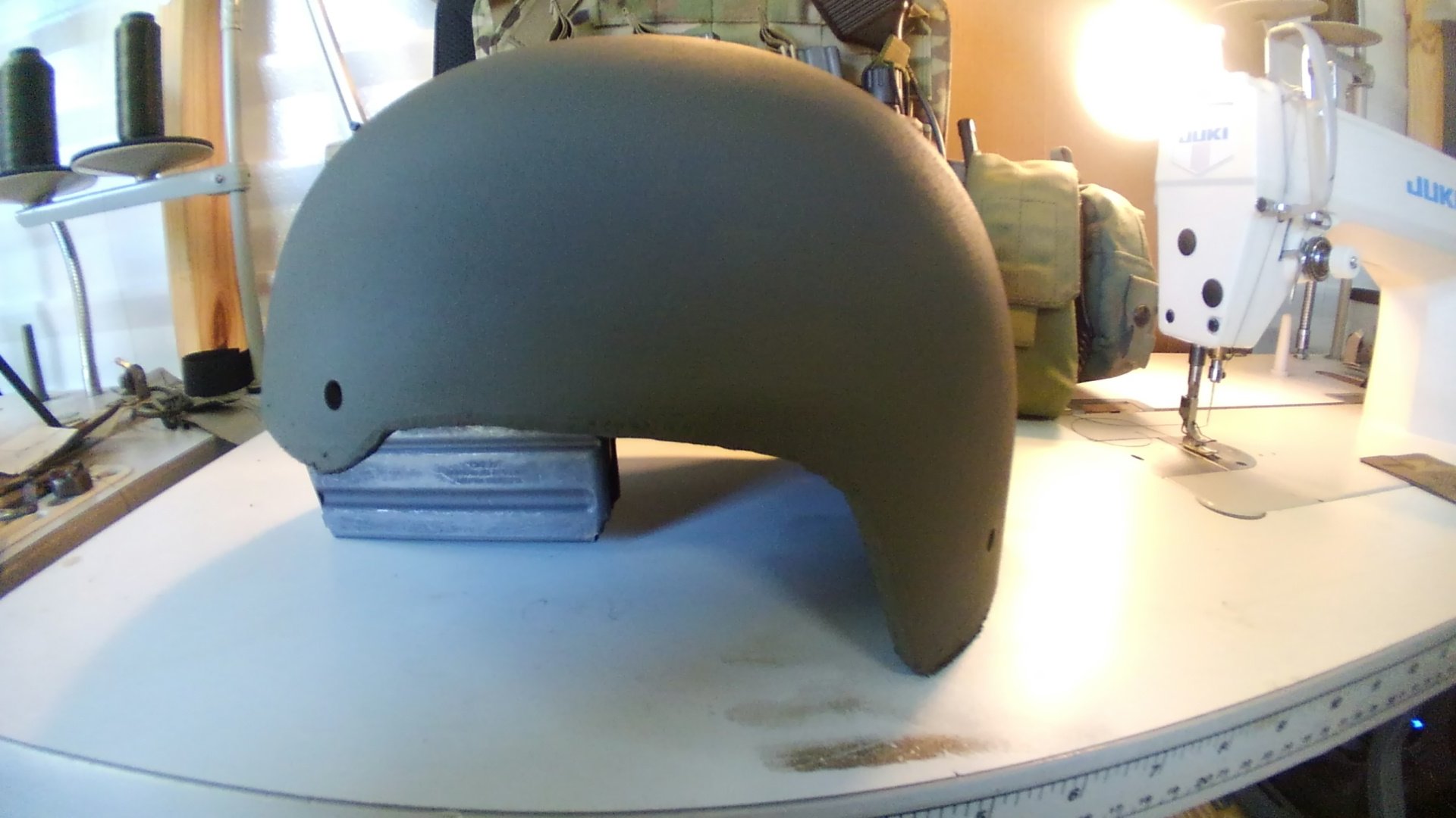

It is possible but a slight pain in the ass, I came across some ACH's at a very reasonable price and decided to cut them down to a high-cut ballistic. It's time consuming properly cutting the helmet then cleaning the edges and epoxy sealing, also ran across some Oregon pads and suspension systems cheap. I made the helmet cover and installed rails, yeah I can go buy one but that's no fun I'm a cheap bastard and prefer DIY projects.
I used a fine jigsaw blade to cut and a grinder to round off the edges. Then a 2 part epoxy to seal it, I did remove the rubber trim and replaced it with the same type trim that's used on Bell motorcycle helmets. The rail is a MSA I believe, as much heat treatment and glue is used on the Kevlar there's no compromise to the Integrity of the helmet that I can tell by cutting it. Stories that I've heard from some of the manufacturers they were cutting ACH's to meet the demand of Special Operations before they started making molds of the high-cut ballistics.
Did you eyeball the dimensions or did you have a template to base the cuts off of? I recently picked up a ACH and would like to go to the high cut design
I considered asking for a more detailed how to when I found this because I have one just sitting around and then saw he’s been gone for awhile. A shame too because that could have been a good write up.
