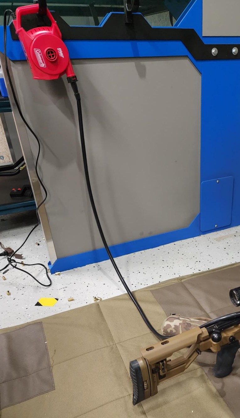

I've been using this Coleman pump for just over a year to cool my rifles and do groupings. Well it finally wore out on me. Anyone on here have a good cooling system they could share that'll last and maybe cool a bit better? I don't need it to be portable as I have plugs right above my stalls. I'm thinking of investing in a mini ac and funneling the air through a tube. I'm going through 300rds of .338 Lapua within 2 hours for context.
Reactions: 308pirate
I picked up a chamber chiller about 4 years ago and it continues to perform.
Reactions: spife7980
You shoot a round a 338 lapua every 12 second for two hours straight? Thats insanity. Why?

I don't know the volume of air your current Coleman "cooler" produces... but I'd bet it is much more then my Chamber Chillers.
I wonder if you could somehow draw colder air from a buck of ice ?... or filled with those bagged ice packs. ( Limit moisture blowing down the barrel. )
I have never tried this... but "maybe" your could coil some of the tube in the "ice bucket" for added chill.
I would be concerned about condensation in the coiled tube though.
EDIT... see next post.
Or this might have more volume of air ( than your Coleman ) and could be adapted... it does have a trigger lock for continuous "blowing" and 3 speeds, "100CFM" .
BTW, it is also a handy blower for us ocd folks, with reasonable air force.
Random internet example...
https://www.homedepot.com/p/DEWALT-...V0DmtBh2LWQAbEAQYASABEgK-IfD_BwE&gclsrc=aw.ds
Even if it didn't work out, you'd still have a handy small blower.
Reactions: Schutzhund99
Oops... and I have to ask, do you have an idea what max temp. are you reaching after a typical session ?
And how much does / did your current setup cool it down ?
And for the biggest 100$ question... how rapidly can someone cool down a barrel with out FUBAR'ing internally it ?
Given your rate of fire... I would think more volume of air would be a good start.

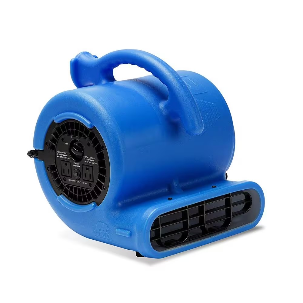

Your original post didn't go into any detail of the use case. It read much more like someone doing 15-30 rounds per hour on a hunting rifle than destructive testing.
On that note, the big carpet fans are the way to go. Since you're not testing the rifle side for heat, you could keep the fan going while firing as well.
