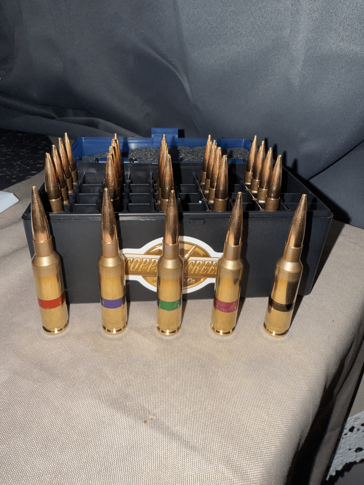

I recently purchased and shot a load pack from Copper Creek and wanted to post my results for others to come across when researching them.
Intro
  • Ammo
    • Load pack 1 which compares the same bullet at the same seating depth, but with incremental charge increases (unknown %)
    • $119 shipped for 25 rounds that come in a hard 50 round ammo box
    • 140 Berger Elite Hunter in LRP Lapua brass
  • I went this route since I am out of state and away from my reloading gear, and just got the rifle together

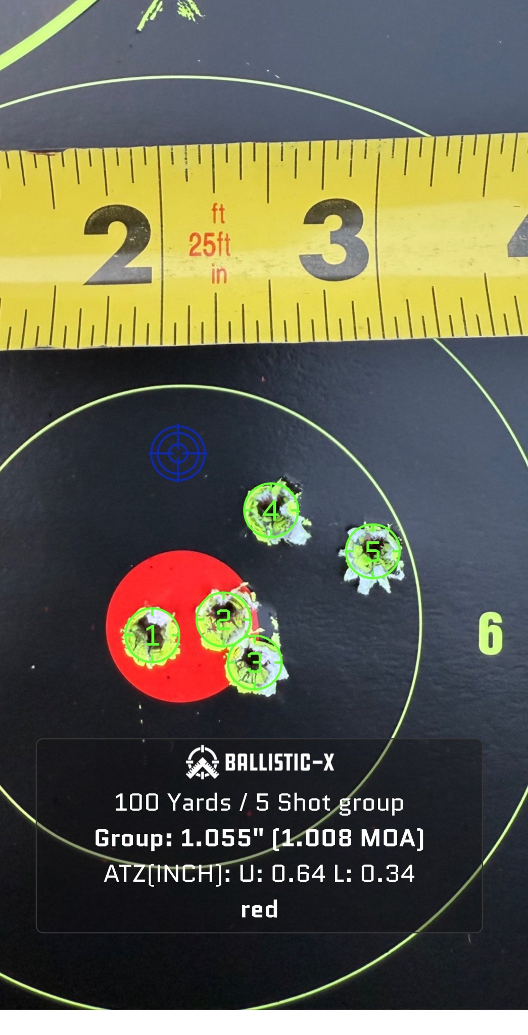

Red51.0085.916.82499.8

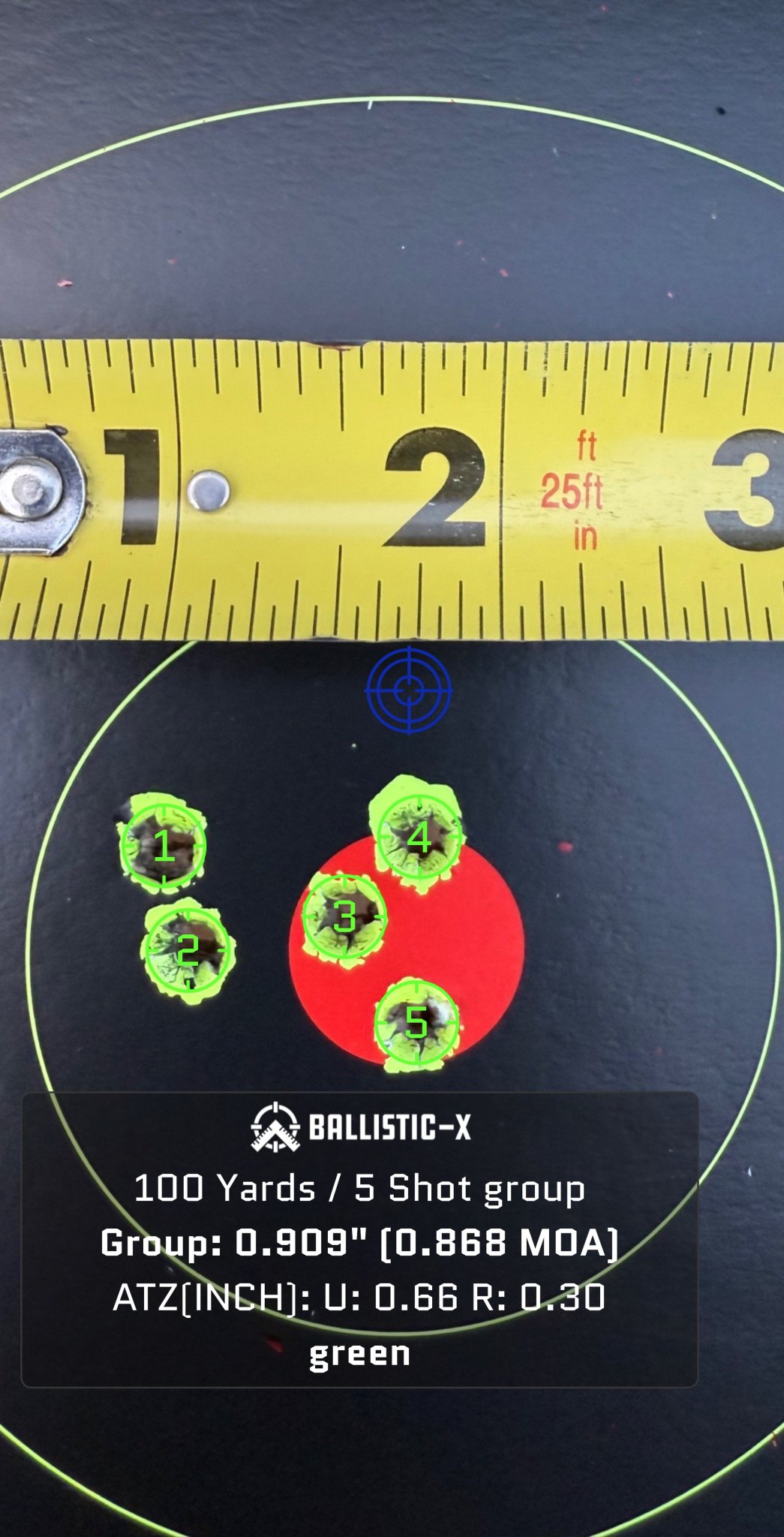

Green50.86818.543.32564.4

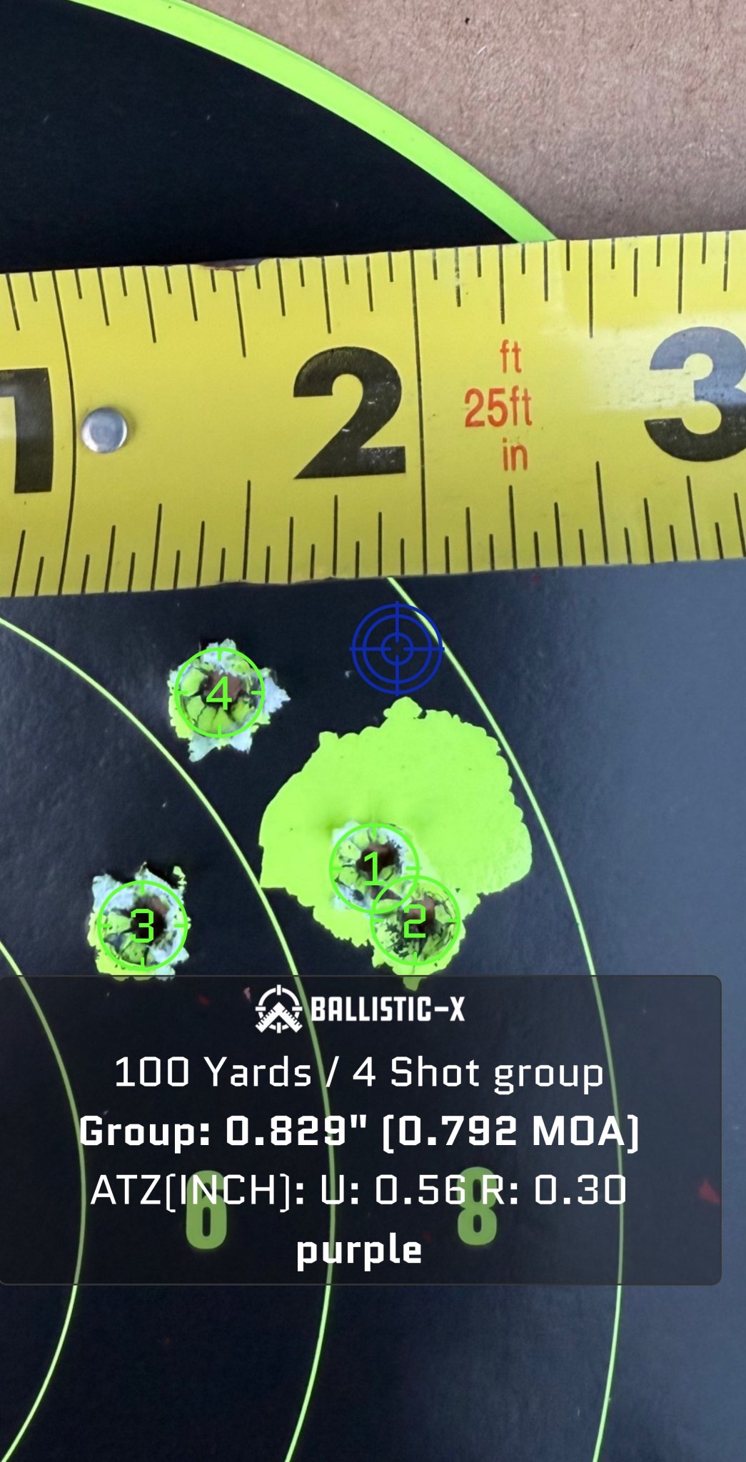

Purple40.7925.814.92597.4

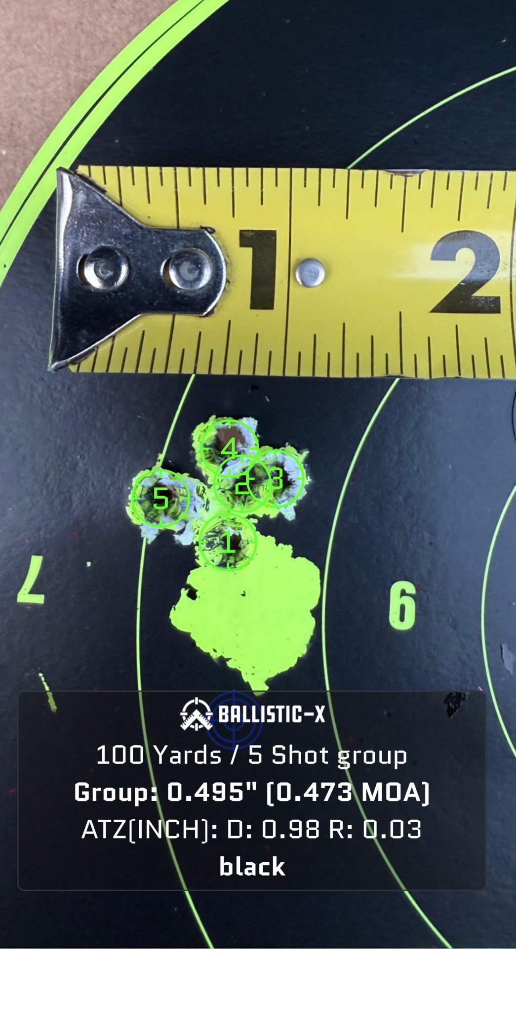

Black50.47313.240.92631.5
The first thing to call out is that I had one of the purple rounds not go off. The primer strike looks fine but no dice. The rest of the results were okay, but the point of getting a load pack like this is to test each color and see what your rifle likes. Based on the results, black is by far the best for my rifle both with group and speed. Brass and primers did not show signs of pressure except 1-2 rounds in the blue group had a noticeably heavier bolt lift, but nothing crazy.

I will add in pictures of the groups that have the color in the overlay and what the rounds look like.
