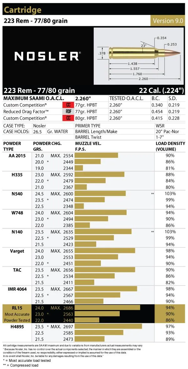

    Nosler's manual is arguably worth reading for this reaoson alone. In Nosler, the * indicates accuracy load. If you believe Nosler data, Accuracy is (within the safe range) quasi-independent of pressure. Note below, the most accurate load can vary from min to max, based on powder. In .223 REM, Varget is more accurate at slower speeds, H4895 likes to be pushed hard. RL-15 does best in the middle of its range, etc.

    Nosler's manual is arguably worth reading for this reaoson alone. In Nosler, the * indicates accuracy load. If you believe Nosler data, Accuracy is (within the safe range) quasi-independent of pressure. Note below, the most accurate load can vary from min to max, based on powder. Varget is more accurate at slower speeds, H4895 likes to be pushed hard. RL-15 does best in the middle of its range, etc.
