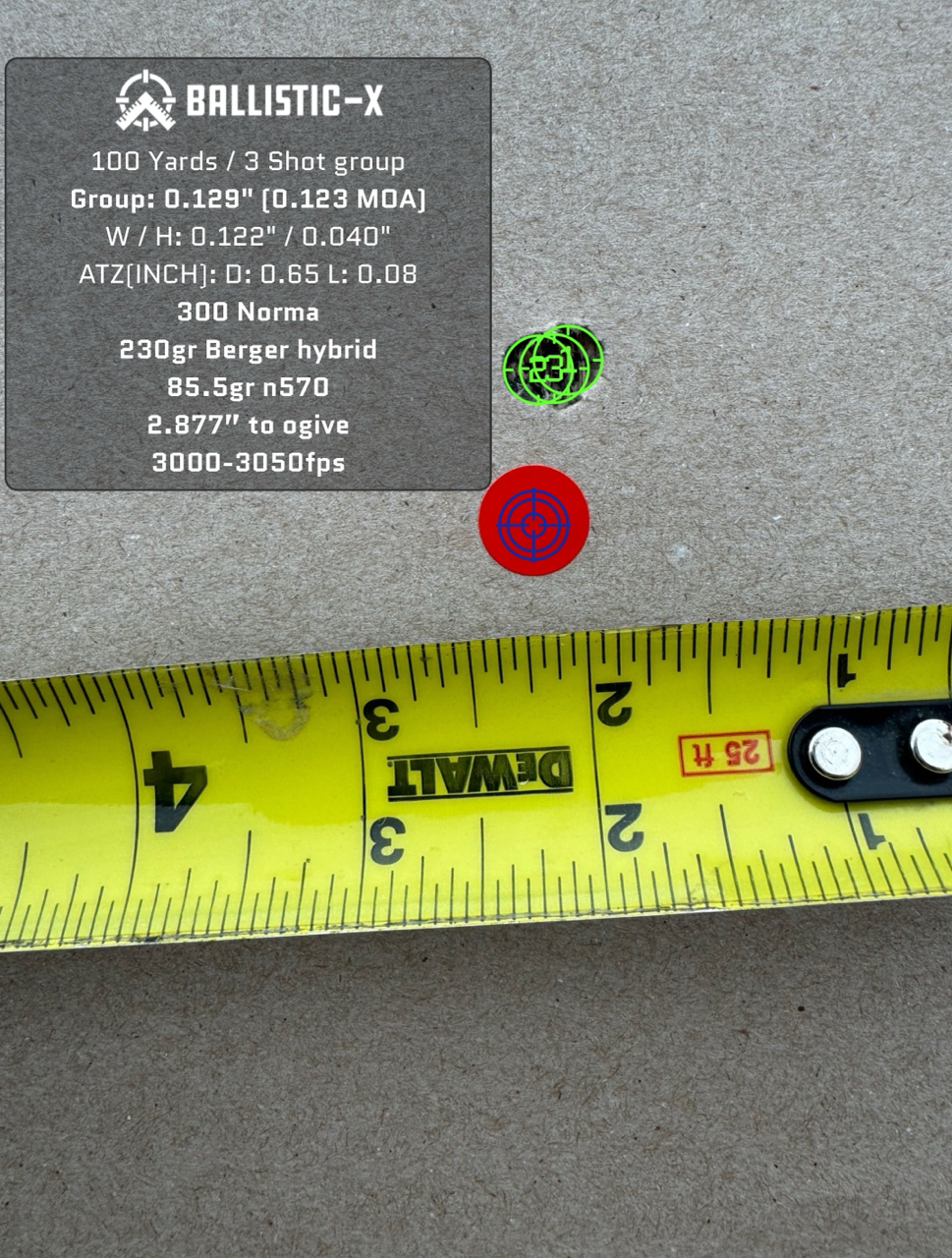

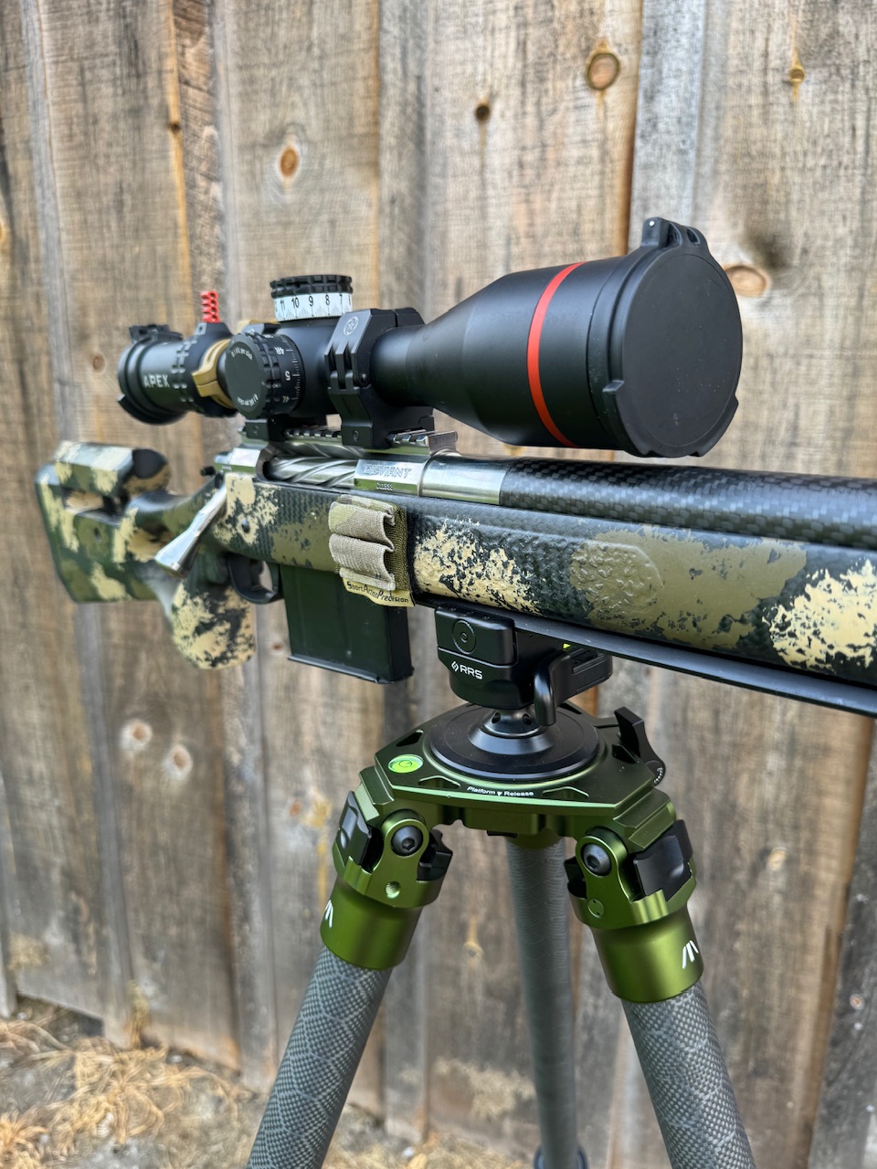

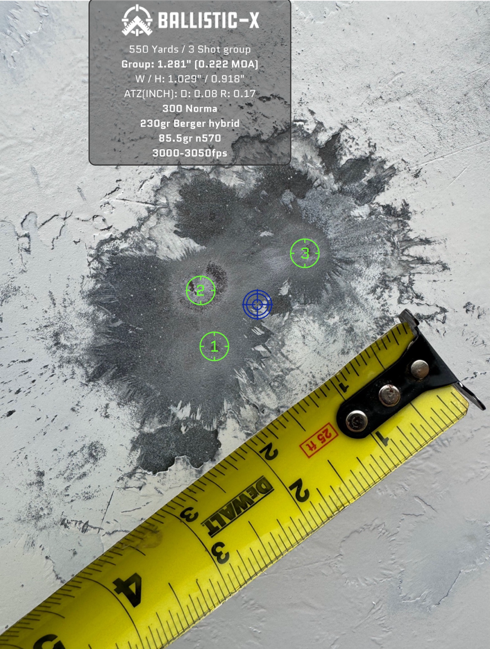

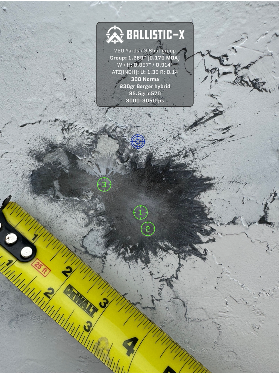

I’m running n570 with 230’s at 3000-3050fps. I have a little more room in the tank and had them just over 3100 with 570 and 3150 with rl33 but rl33 wasn’t as stable and 570 shot best here
Ballistic-X-Export-2024-09-22 16:54:55.008352.png
Ballistic-X-Export-2024-09-22 17:07:49.595608.png
Ballistic-X-Export-2024-09-22 16:55:55.131932.png
Reactions: RegionRat
@Matt_3479 Beautiful rig and very nice shooting!
That's roughly 3600 ft*lbs worth of energy in that load!
Those are very tight groups and it is rare to see any sort of rig that can do this. Well Done!
What does your rig weigh?
