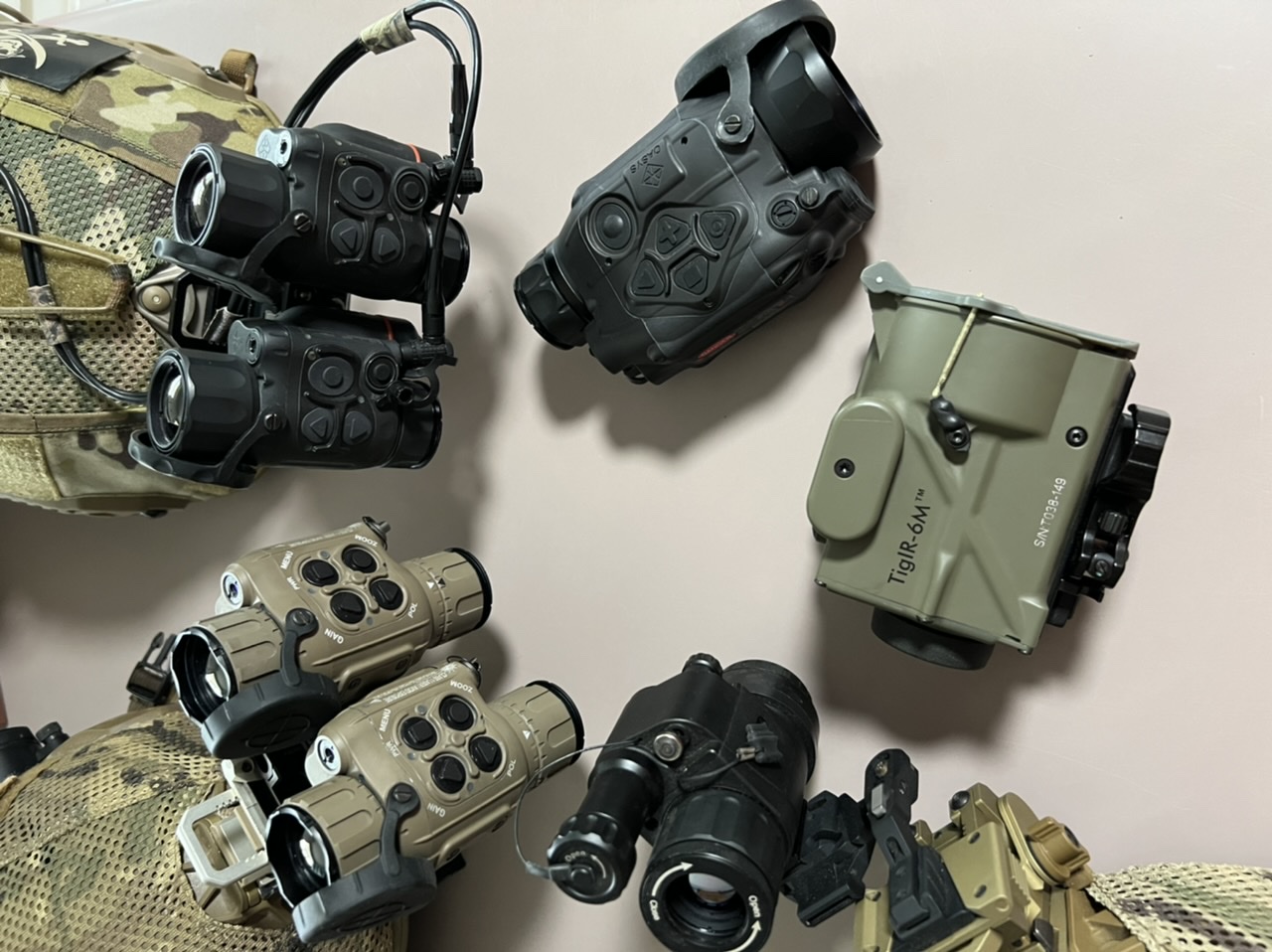

    So I initially got the pas-29 coti to run with NV binos, because I wanted some off gun always active thermal for scanning purposes while hunting.
    My binos i ordered ended up not materializing in the time frame i expected, so i ended up getting a set of photonis quads instead... kind of a long story there.
    I didn't want to hunt with the quads, so I ended up switching to dual band pvs 14 and a nox, since those actually fuse fairly well for me. I had toyed with the idea of keeping a coti on the 14 for when I roll up the nox to go to gun mounted thermal so I can still keep an eye on things during the transition, but it's a heavy combo, which kept me from using it.
    So adding it as a secondary thermal on that hunting rig is one option.
    The other use case, though, is that I might try using my photonis quads and the jerry c for hunting. I like the dual band combo, though, so it might be hard to make that change.
    I spend a lot more time just goofing around at night and hiking, though, so the quads are a lot of fun for that. I do that more than hunt, but a rather large margin. Having the thermal in outline mode just for purposes of seeing if there is anything else out there with me is likely the largest use case.
    I tried the pas-29 coti with the quads, but it was quite heavy, and the fov felt really narrow with the wider fov of the panos... my brain just didn't like the sensation, for some reason. Didn't really bother me with just the pvs 14
    So yeah...I think the larger fov and lighter weight of the jerry c might be fun in a number of scenarios...
