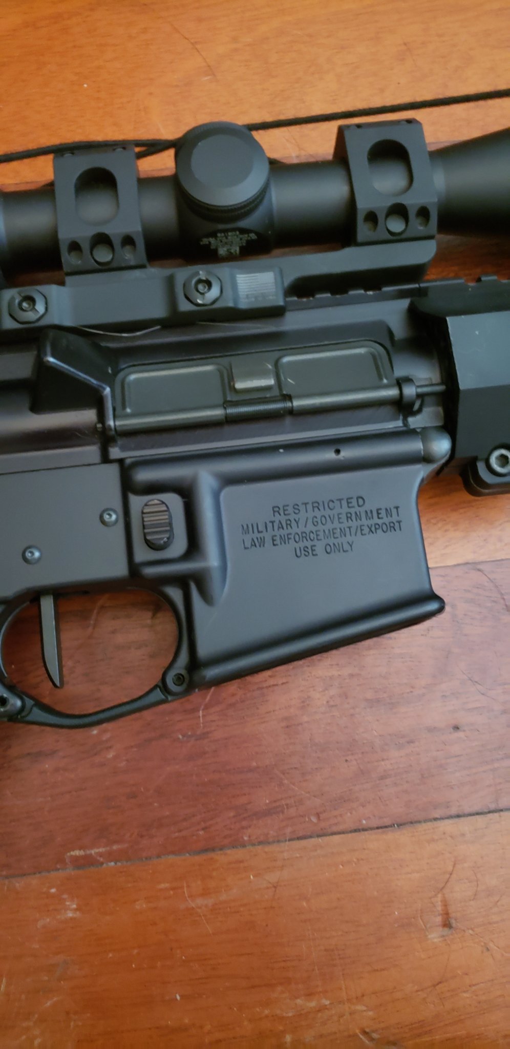

Could I make this into a cool “clone”?
thedude824
Oct 7, 2020
436
320
Tampa FL
This is my old patrol rifle. COLT LE6920 with 16” barrel and carbine gas. I’ve planned on selling it, but I just don’t like selling rifles. It has the LE/MIL restricted markings. I’m definitely not interested in an MK18 clone. I’d hope for something at least 13.7” I’m opening to cutting down the barrel or swapping it.. or even converting to piston. Barrel probably has less than 1k rounds through it. I’m really just looking for a cool clone look perhaps with one of the DD RIS rails. It’s just so boring. I’ve got a 14.5” piston that is awesome. Also open to maybe using a different caliber? It’s purely the look I’d be interested in.

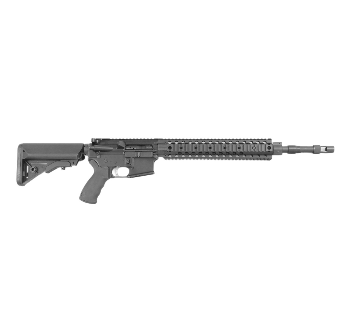

Crap… I hadn’t seen these.. if I were to put the Daniel Defense RIS III on this I’d be pretty close (I know they used RIS II, but no way am I going back to a quad rail on a rifle I’d actually use). My Colt upper has the keyhole markings if I remember correctly.
If I did that I’d either need a longer barrel to work with the 13.5” Geissele MK4 or another shorter rail. I though the Geissele MK4 was pricey until I saw that the Daniel Defense RIS III is $440.

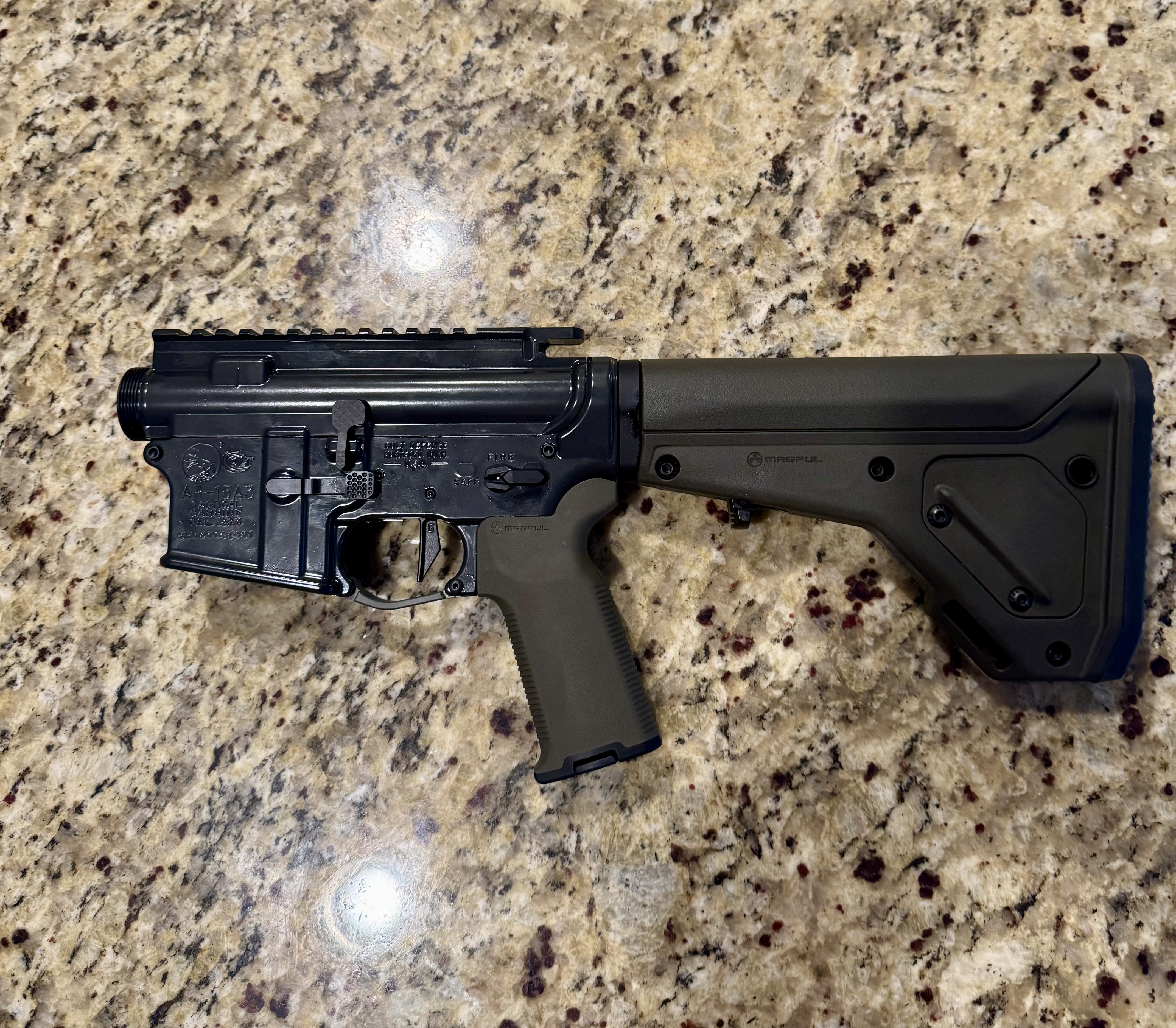

So I made some progress. More than I should have. This far the build is
Colt “restricted” upper and lower
Daniel Defense 12.5” RIS III rail
*these will be cerakoted with E140*
Magpul UBR in OD green
Magpul K2+ in OD green
Radian Raptor/Talon
FCD ambi mag release
Geissele SDE trigger
Superlative Arms piston system MLGS
POF roller cam pin
Seekins bolt catch
Craddock RTR 13.9” 6.5 Grendel
HUXWRX 762 flash hider
The idea that this sort of kind of will be sort of like a Block II but a different caliber :)

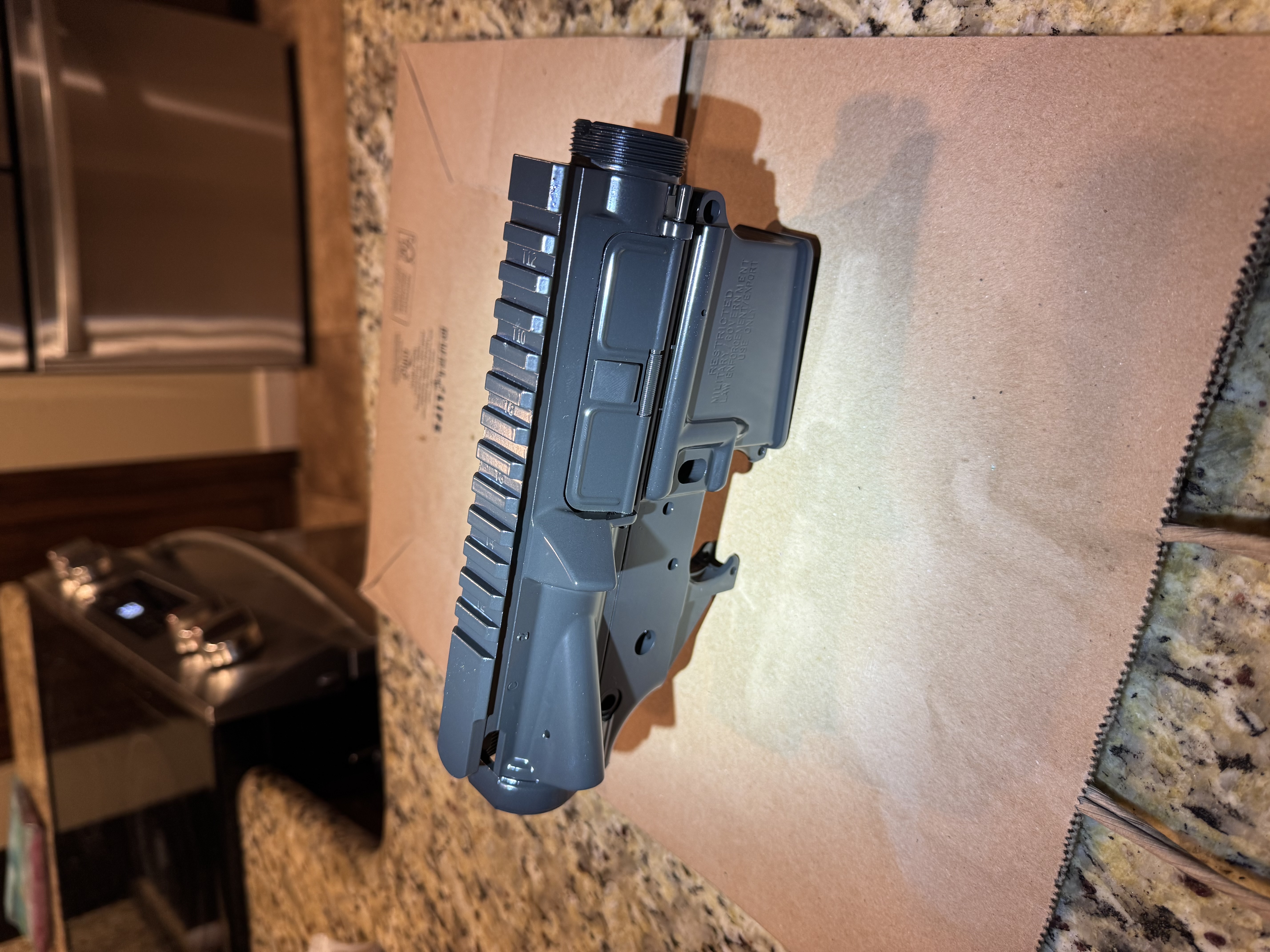

So… I wanted something darker than the Elite Jungle so I added some Elite Blackout. I’ll spare you the details, but the color didn’t come out as I’d hoped. I’ll get some pics in the light when I get it assembled. It’s like a grey/blue/green and crazy glossy. It feels like glass. The coverage was perfect thankfully. The Craddock 13.9” 6.5 Grendel barrel is on the way along with the last few “gun parts”. Optics will have to wait a while.

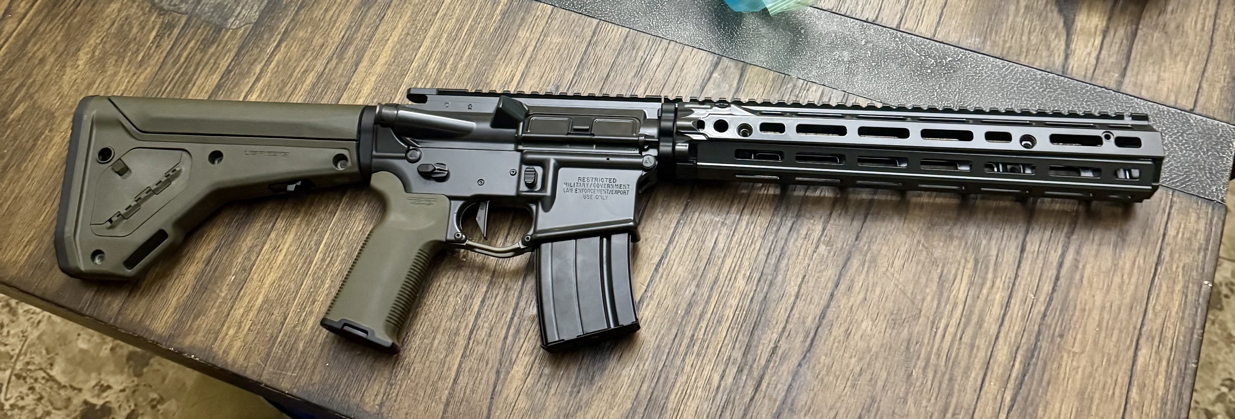

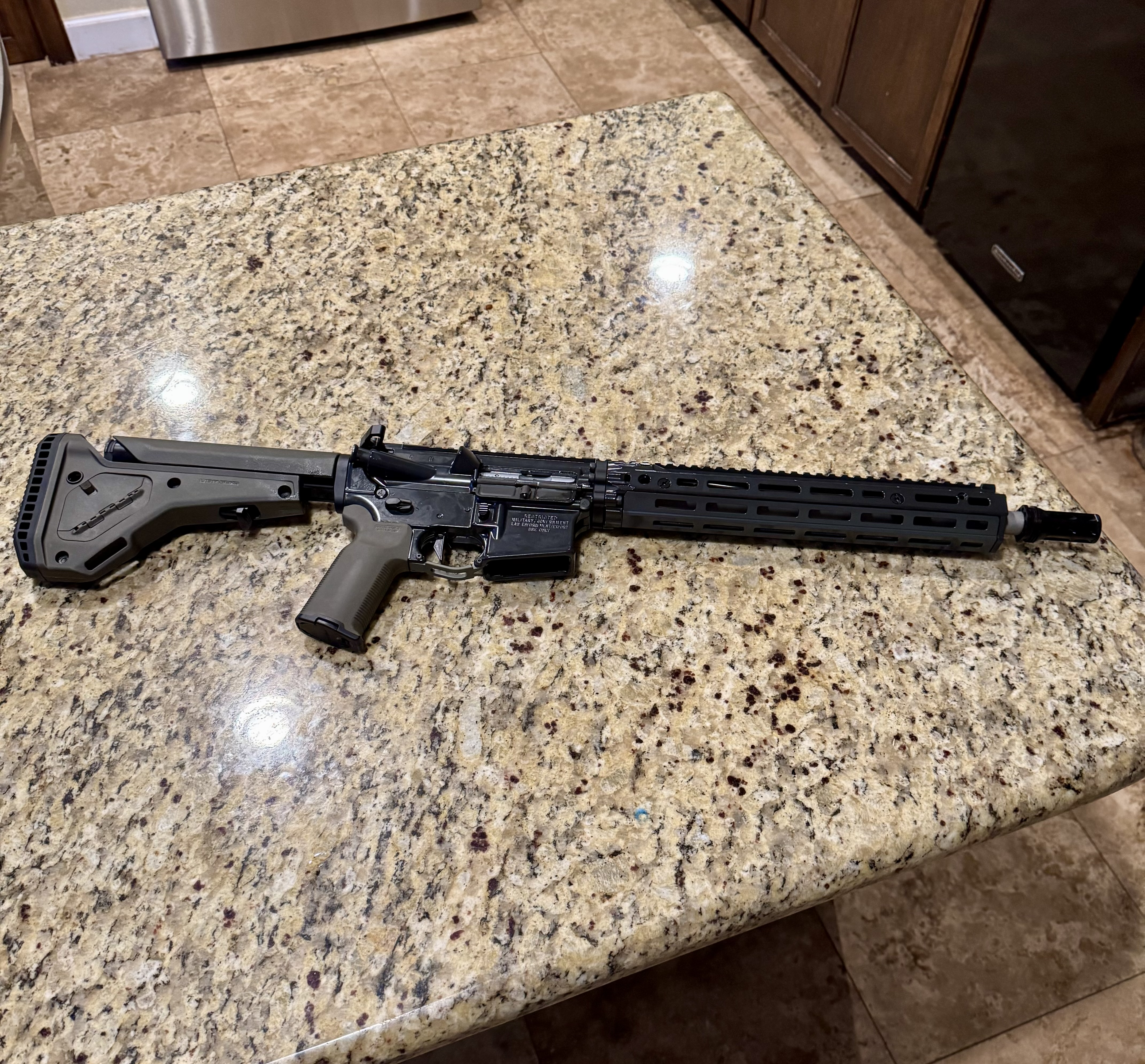

Barrel isn’t here yet, but everything else is installed. The rail obviously isn’t installed, but I wanted to get a feel for how it would look. It’s a 12.5” Daniel Defense RIS III and I’ve got the 13.9” barrel on the way.
I was concerned that the FCD mag release wouldn’t drop the mag 100% of the time since it doesn’t seem to have much movement, but it’s 100% even with an empty mag. Forgive the smudges. It’s a very high gloss finish.

I think I read a thread where you mentioned that.. which resulted in me covering up the inner portions of the upper and lower and areas where clearance may be tight... so thank you for that. The E series also appears to go on much thinner

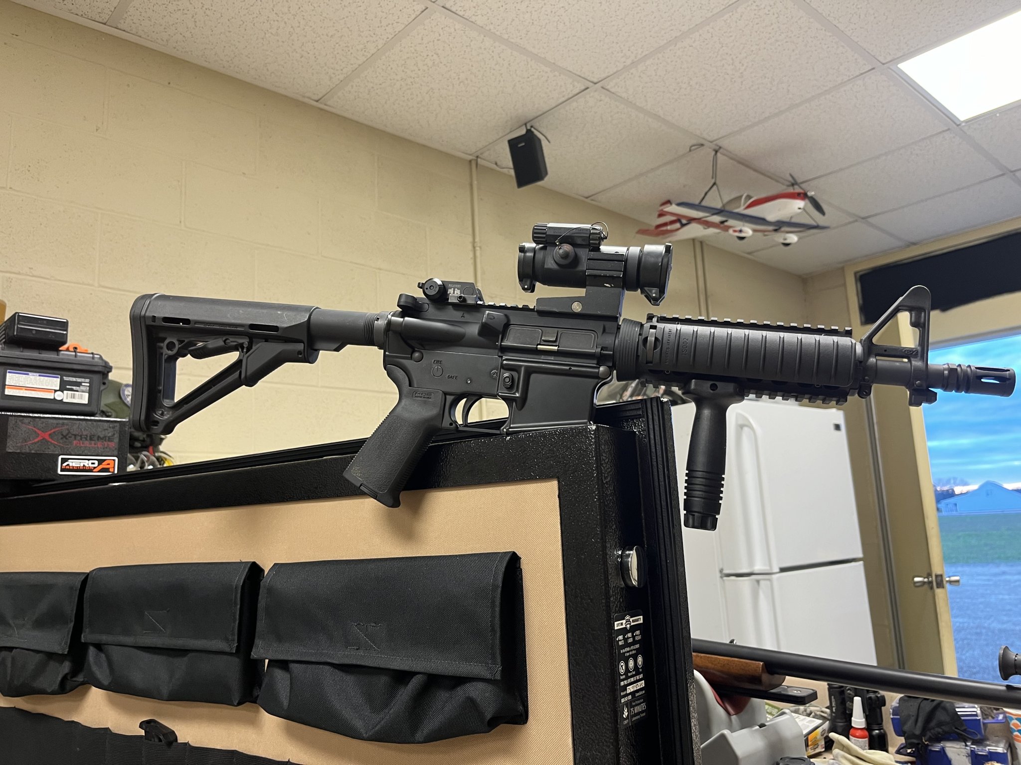

What’s wrong with a CQBR upper/MK18 clone?View attachment 8637931
I finally replaced the Noveske 10.5 with a Colt 10.3 on my Block II CQBR. And it doesn't run. Short strokes. I bought the barrel at the EE thinking it was a factory 10.3, but now I'm wondering whether it was chopped down from a 14.5 or 16. My Noveske barrel ran nearly everything I threw at it, so I was pretty disappointed.

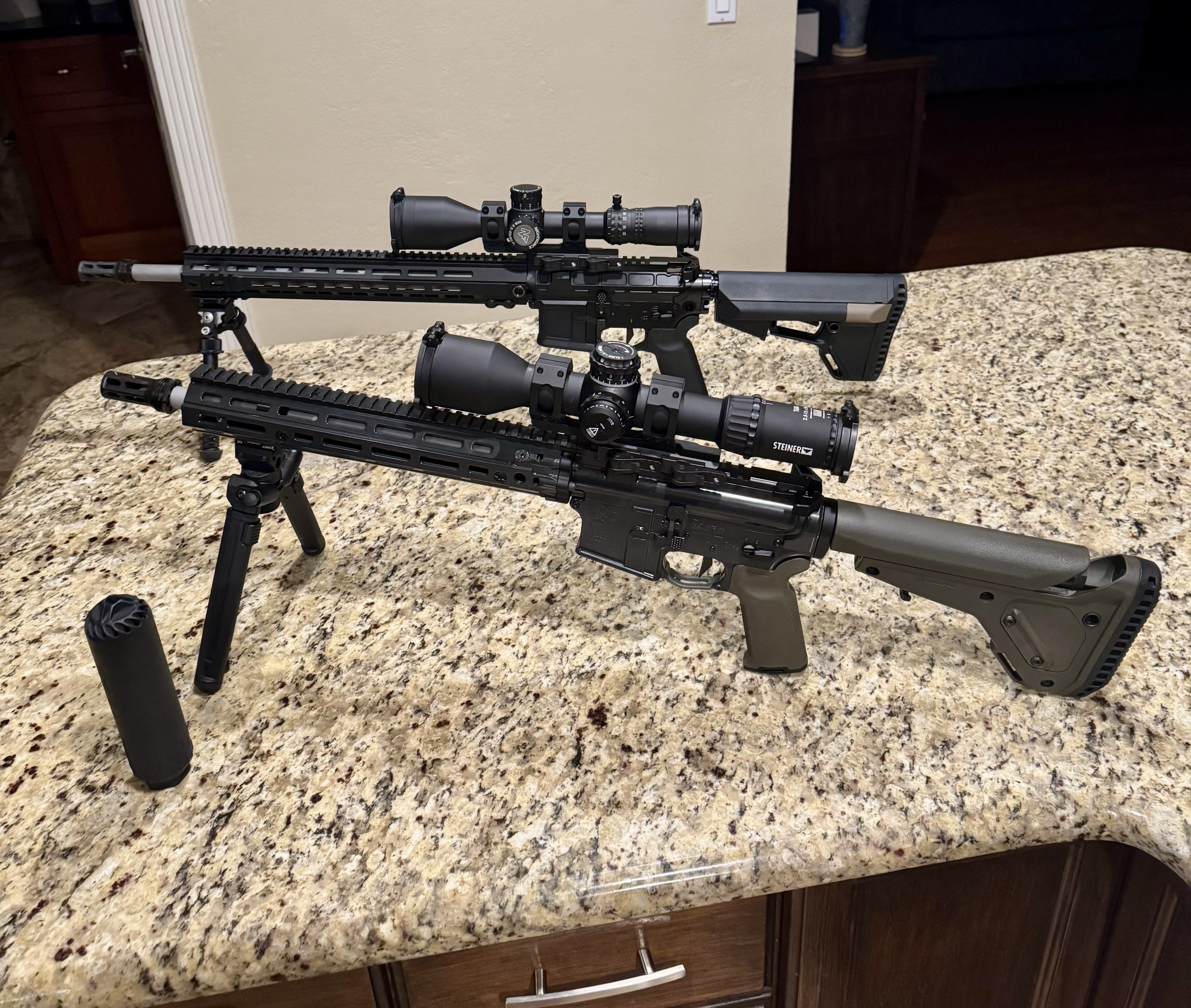

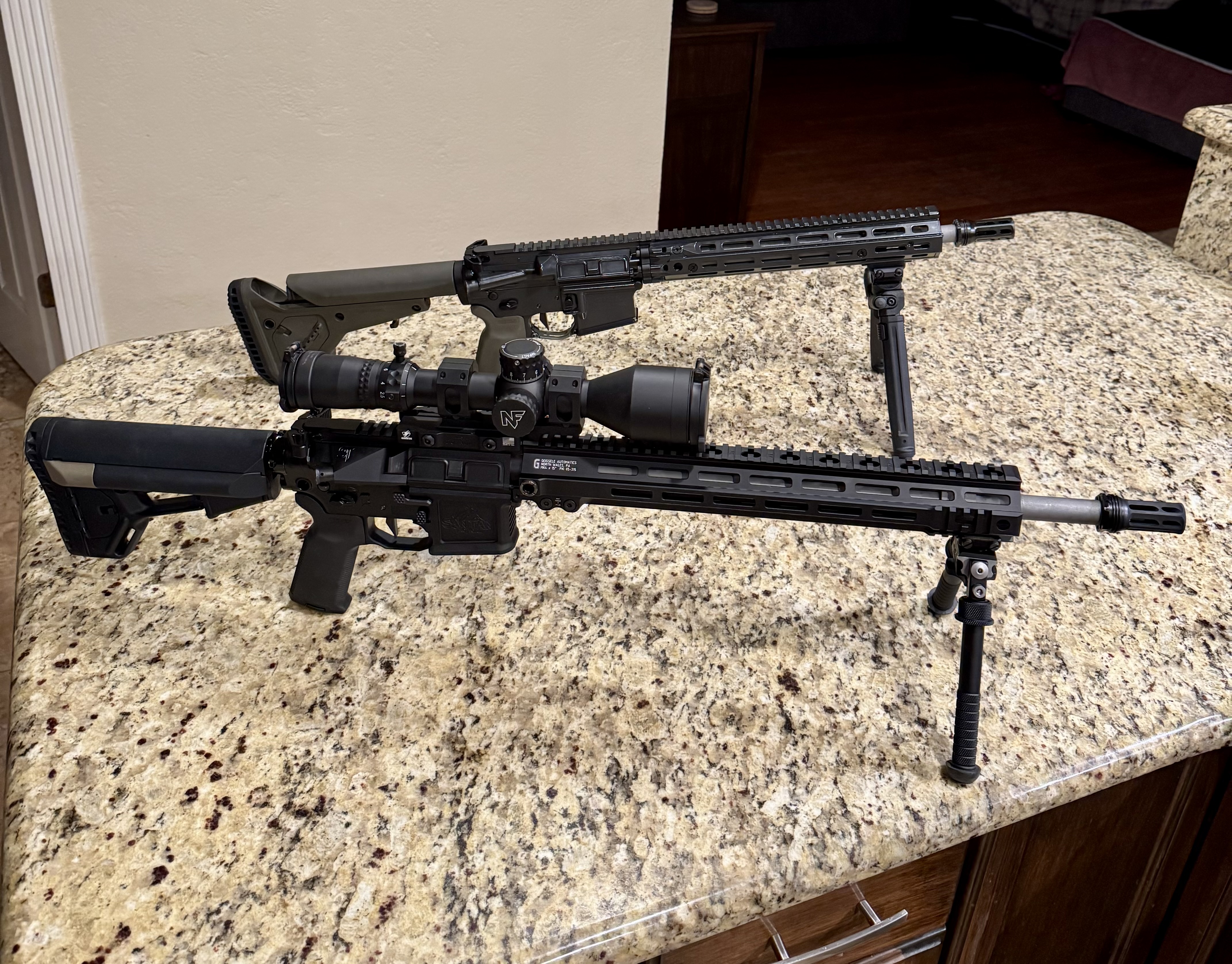

It’s really hard to get a good pic of the rifle. It’s got a high gloss finish and shows fingerprints like nothing I’ve ever seen. Here you can better see the green compared to the black on the 18” Grendel. I got a Magpul bipod mounted to the KDG QD MLOK as a spare bipod for the 14.5” AR, 13” SCAR, and 13.9” Grendel to share since I don’t want a bipod on any of them full time. The guns with full time bipods get Atlas V8’s. Gas rings came today. I’ll probably mount one of my other scopes to it and take it to the range to tune and function check this weekend.

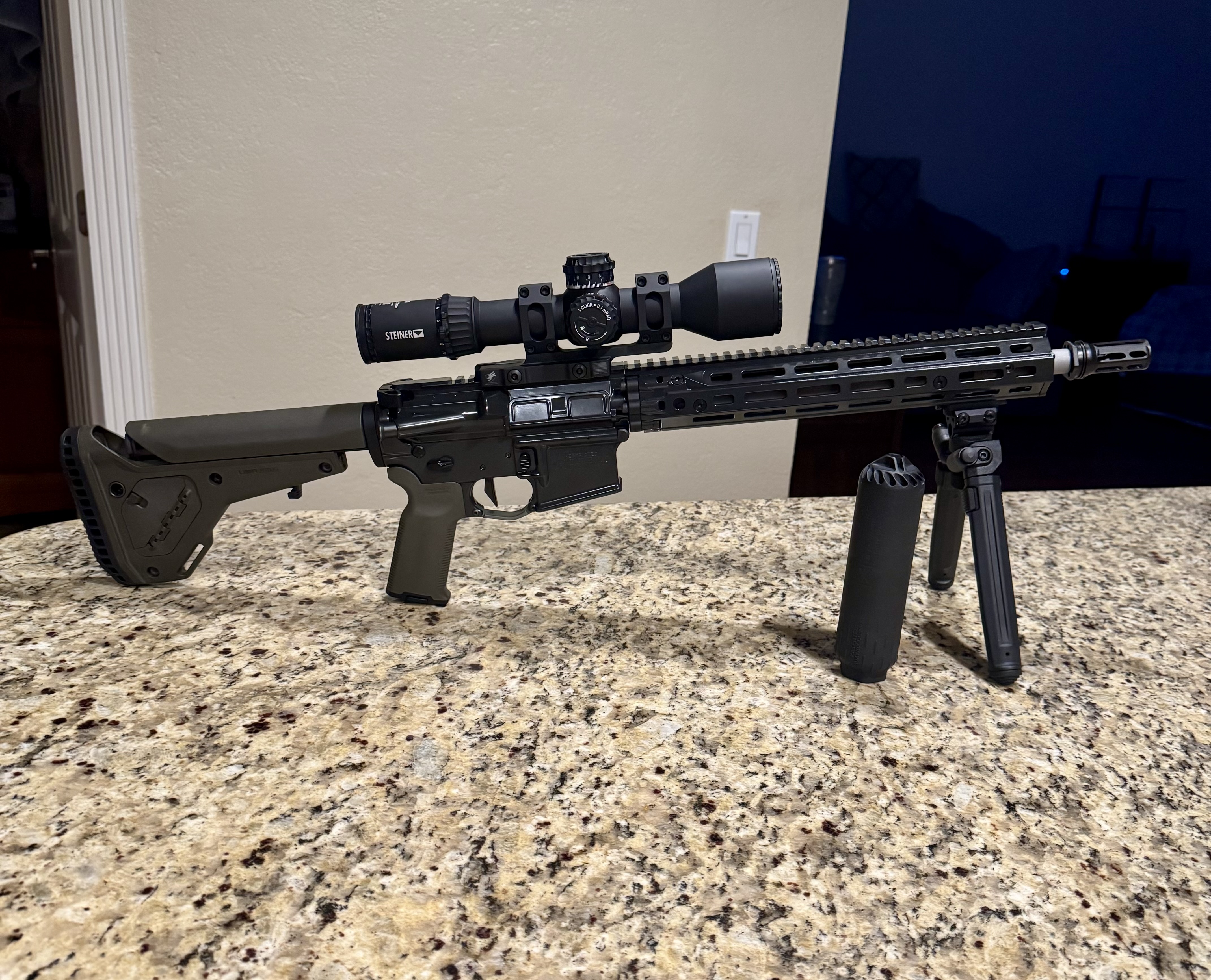

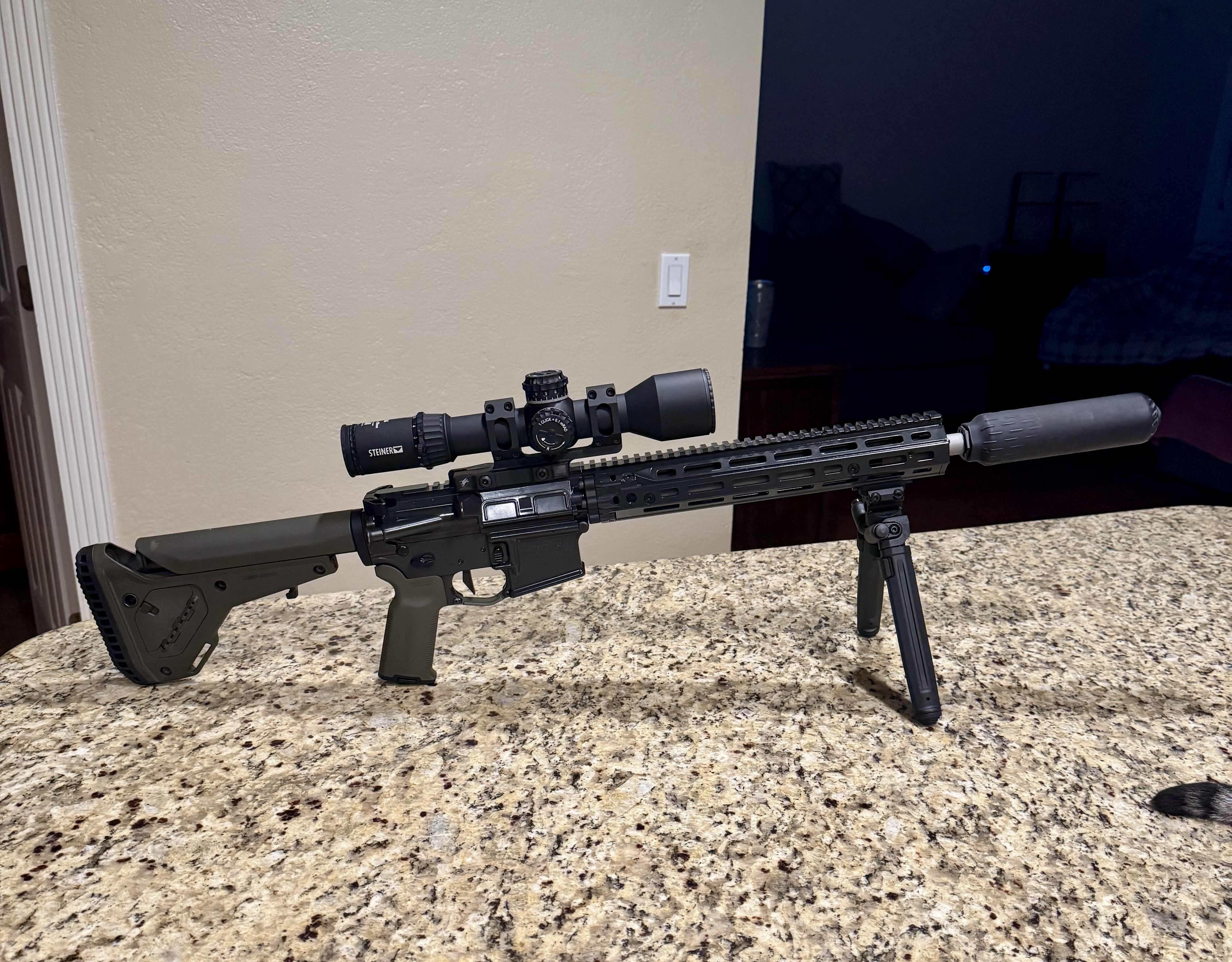

All done. Steiner T6XI 2.15-15x arrived yesterday and was mounted last night. I’m hoping to take this one to the range to get some brass and zero the scope. I’m also hoping to load some 110 grain Lehigh solid match rounds into some Starline brass previously fired in the 18” tonight. I’d like to do 5 rounds at a couple grain weights to evaluate groups and velocity in the 18”. I’ll do the same for the 13.9” another time.
