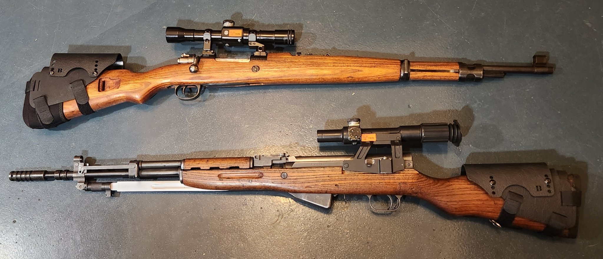

BUT I just can’t shoot irons anymore. Pretty much all I shoot has to have glass on it. I have many thousands of rounds of corrosive 8mm and only one bolt gun, a Yugo M48 wi ZRAK ONM76B, basically I turned it into a clone of a Yugo Civil War, field-expedient sniper. Shoots GREAT.

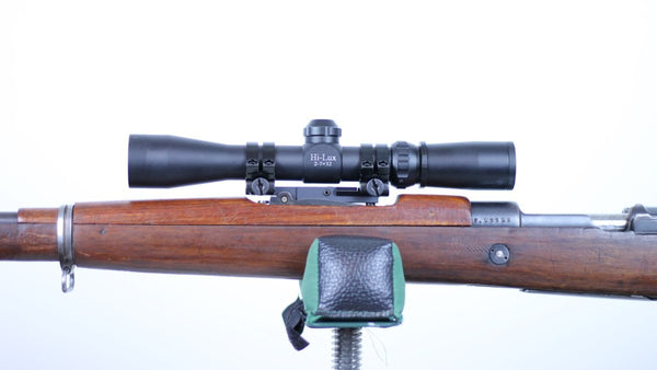

However, when it comes to scout scopes, I’m hoping BDC reticle with FFP. About the only thing I have turned up is the Hi-Lux LER 2X-7X with 308BDC reticle .
https://hi-luxoptics.com/products/hi-lux-optics-long-eye-relief-2x-7x-riflescope?variant=36901033485
Should be, but I’m not a ballistics guy. How will the 308 BDC reticle serve with to use with 8mm? (out to 400yds) Are there any other LER, FFP, BDC scout scopes that could be appropriate for a 29” long, 8mm barrel such as the Persian 98/29 ?

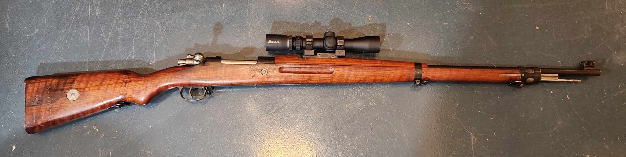

I've got two longer barrel Mausers which were D&T'd when I got them...a Persian 98/29 and a 1909 Argentine. Both shoot pretty well.
The Persian is particularly good, shooting just under 1MOA, usually.
I'm not aware of any sniper versions of the 98/29. If you want to cook up something that kind of looks like a period sniper, you might try some repro turret scope mounts from Accumount for that 98/29.
This is what the Mausers looked like when I won them at auction. I would have a hard time D&T'ing a surplus rifle in good shape myself. Plus, the d&T'ing had driven the price down to an amount that probably approximated the cost of the sporterization.
I think those are wonderful looking rifles. Exactly what I was seeking to do. And I wouldn't describe them as sporterized by any means. They're simply D&T'd.

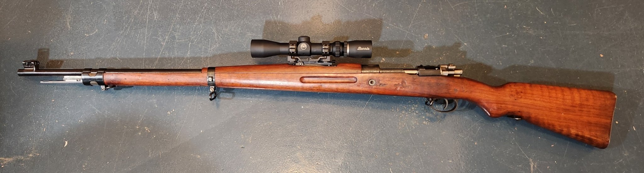

Look what I got for Christmas. A BadAce mount and a LER 4x Burris wi FFP, BDC reticle. How could my wife have known !!! It was a very peculiar experience for me to shoot via an LER scope for the 1st time. Will take getting used to. Initially I really do not care for it at all. I always thought these set ups look goofy. Even more so in person.
BUT I was able to target out to 300yds. No-go on the 1950’s Yugo M49. Will need a high-power spring in the bolt. I was able to get 2-3” groups with 1990’s Yugo M75 as well as that WWII Nazi 178gr MG ammo that’s been around lately. Actually, I have been VERY pleased with that German stuff. Was getting at and under 2” with my Yugo M48. This last trip was pretty cold and I was irritated by the LER scope so I’m sure when I have some patience it’ll do much better. Plus I forgot a gel pad and after a few boxes of ammo my shoulder was quickly DONE.

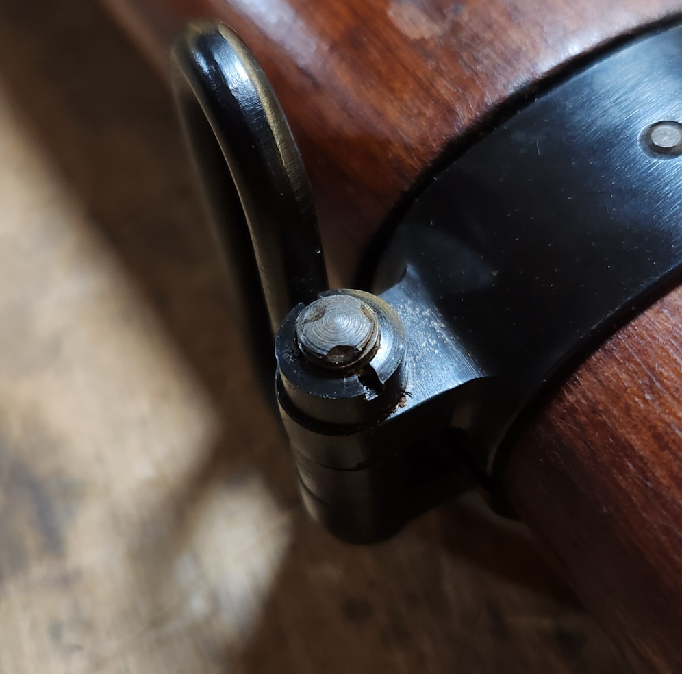

After 12-14 years I’ve literally never had this rifle out to the range. It was very difficult to feed the 1st couple rounds of each magazine fill. They’d almost feed angled up steep and over the breech. Never seen that before. A weak follower spring ? Back at the house I wanted to do a full field strip and ran into this little gem holding the rear barrel band on. Seriously? Were they trying to dissuade grunts from taking em apart? I’ve never come across this on any of my Mausers. A Czech thing? So where do I find the special driver and what’s it called?
Turns out several are correct. Removal of this spanner nut is not required. I did order a #14 spanner bit which was just a skootch small. A #16 would probably do BUT the blades of the bit are a bit thick.
The end of the screw is not staked, seems more milled out. No protrusions or apparent interference with threads.
Anyway, upon second trial I was able to carefully pry the band forward w/o marring anything after pulling the cross "pin screw". Wasn't budging on first attempt.

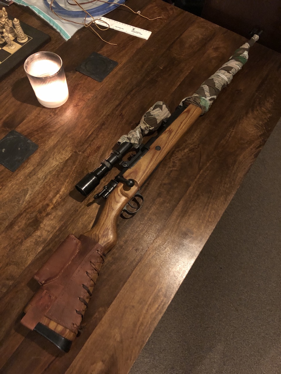

Back to the "Topic of blasphemy" (for some). I'm going to clone the 24/47 into a Balkan "Conflict" DMR via a set of ZRAK Swing Mounts + ONM76B scope. And I bought an M48, bent handle, bolt body off eBay and swapped internals wi the 24/47 bolt.
I transferred a BadAce + LER Burris from my 98/29 Persian last night just to see how she shoots today.
