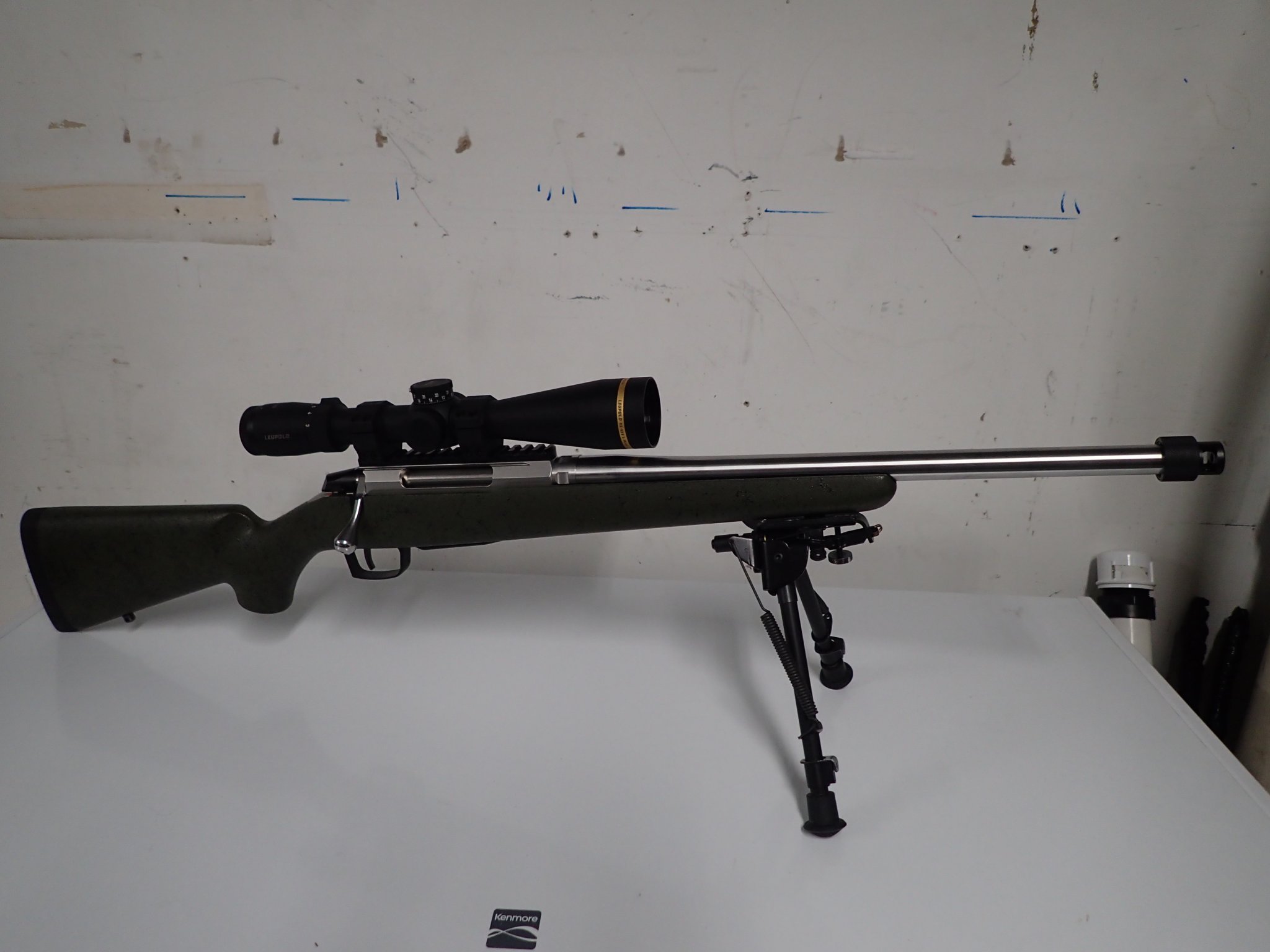

Delta, sounds like your going to build what I just put together. I used a tikka T3X action, spr bugnut barrel 18", 22-250 and mine is threaded for a can. I've had arm surgery so I haven't shot it yet, but have worked up a load for breakin and a ladder load using 50gr vmax and varget. Mine is a 300yd max type shooter as well. hopefully will get out next week!

Thanks! Yeah, I will definitely want mine threaded. What stock did you go with> Do you have any pics?

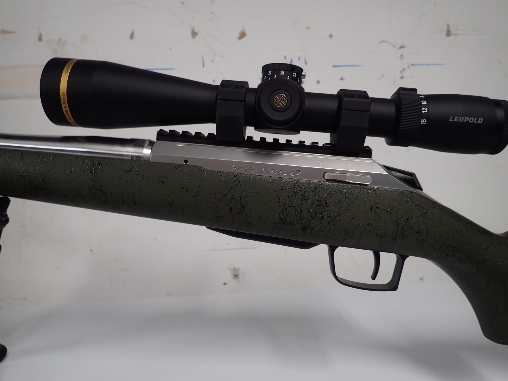

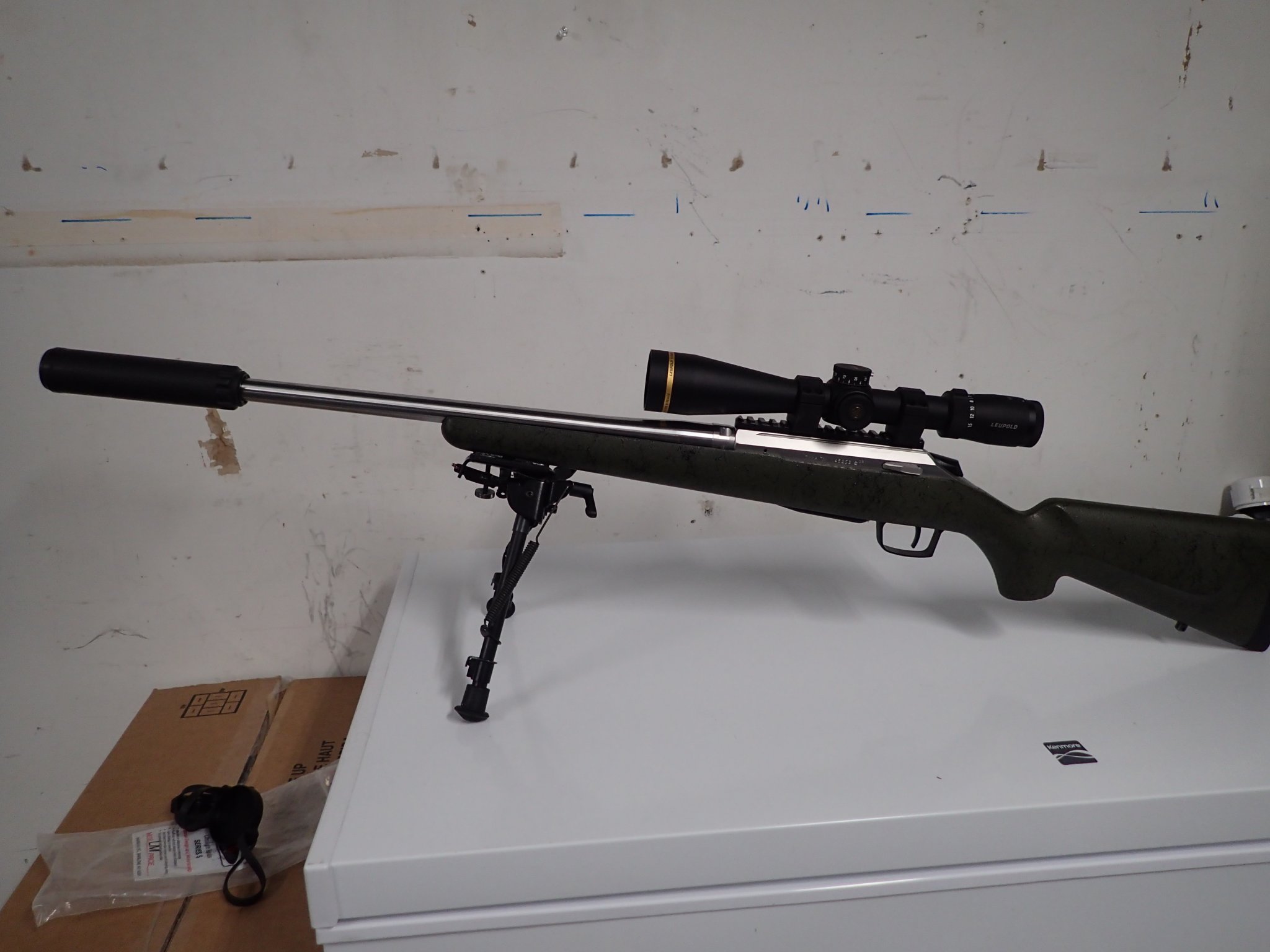

Quick pics from garage, Bell and carlson stock. Leupold VX-5HD, recce 5. PC300057.JPGPC300059.JPGPC300062.JPG
