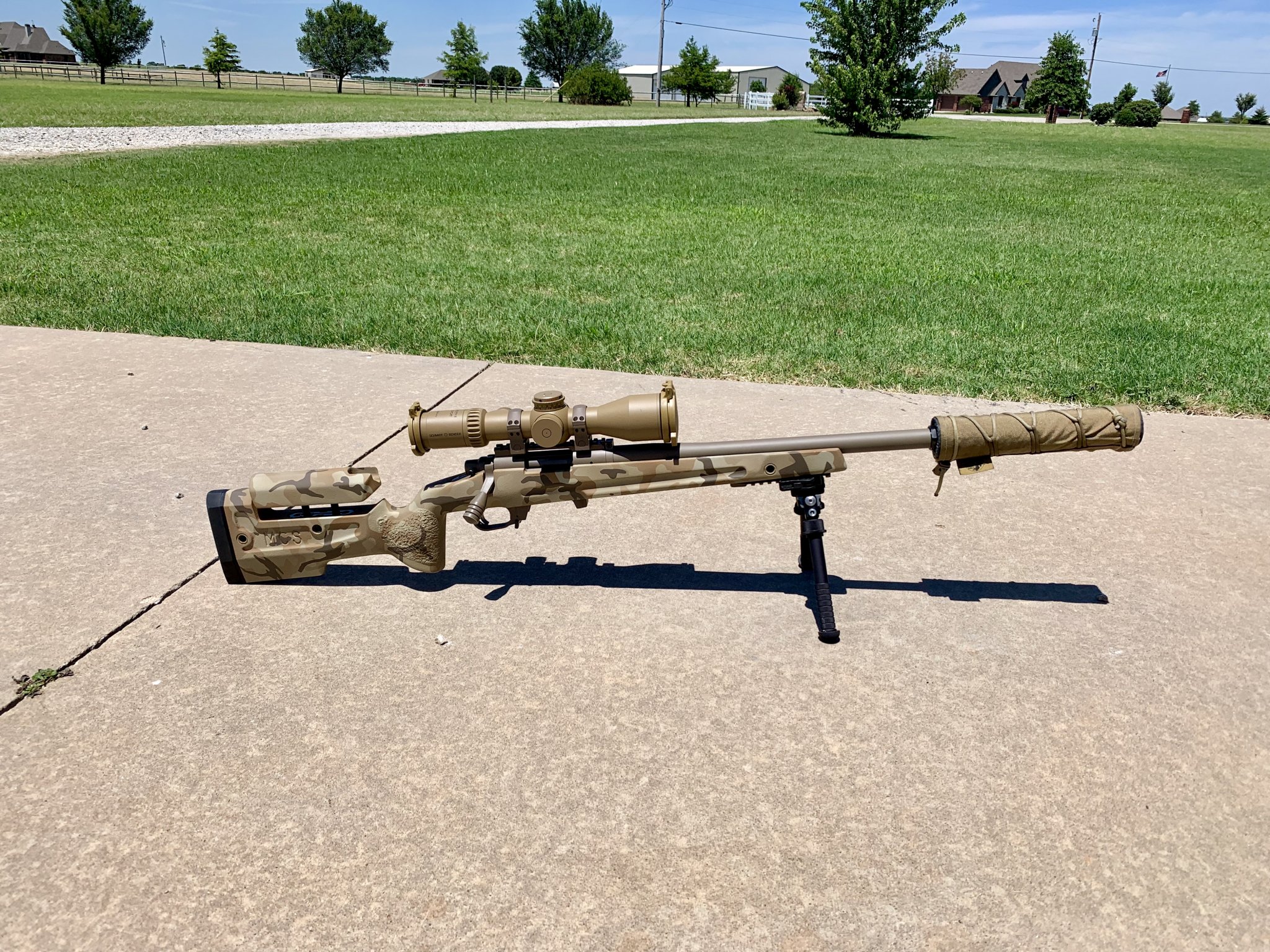

here is my latest
Impact Precision (AW cut) action, Bartlein CF barrel 6.7 twist @ 22", Manners EH1A stock, TT diamond, NF ATACR 4-16x42 F1, TBAC Ultra 7 and a Montana Slings on it!
