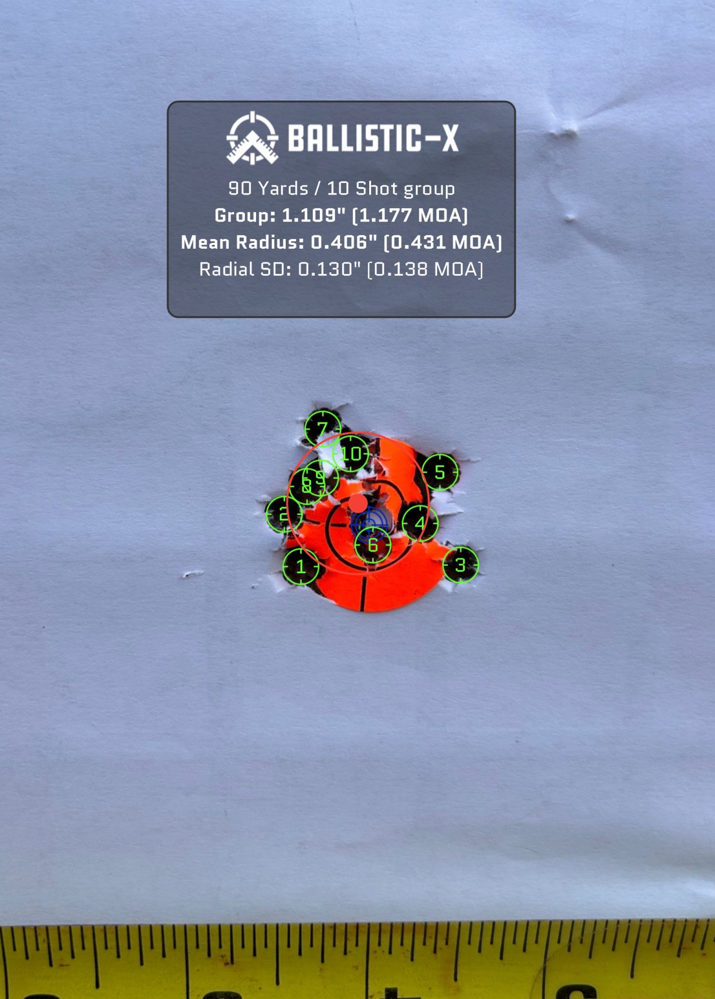

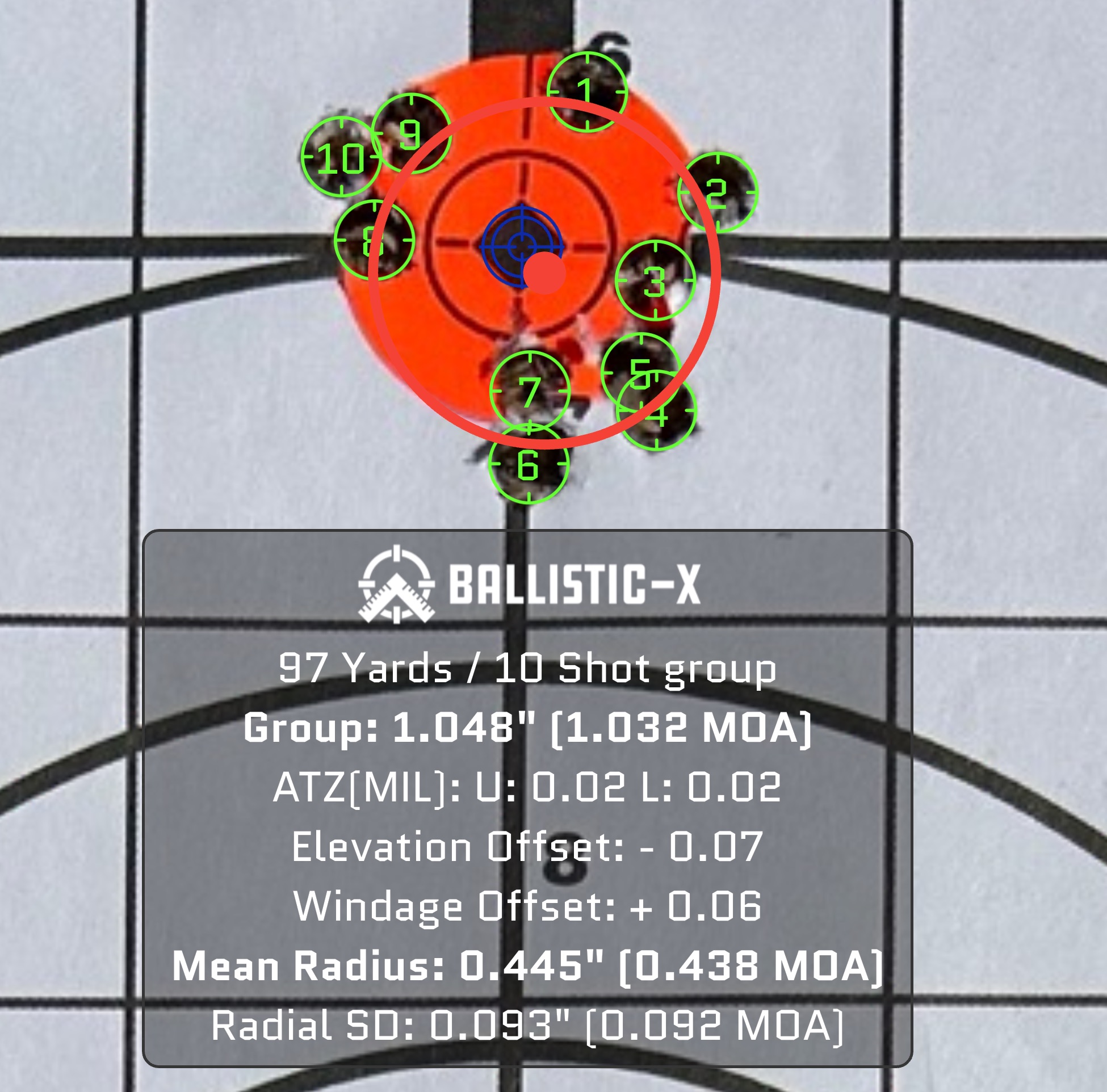

I’ve got a 16.25”, 1:7 gain twist, 223 wylde signature barrel. About 1.1 MOA 10-shot groups seems normal using factory Federal 73gr Bergers. I’m mostly a bolt gunner, so there’s probably a bit of my own shooter error in there too. I also haven’t tried out many other anmmo offerings.
Ballistic-X-Export-2023-10-15 20:09:01.293238.jpg
Ballistic-X-Export-2024-01-06 12:28:45.705651.jpg

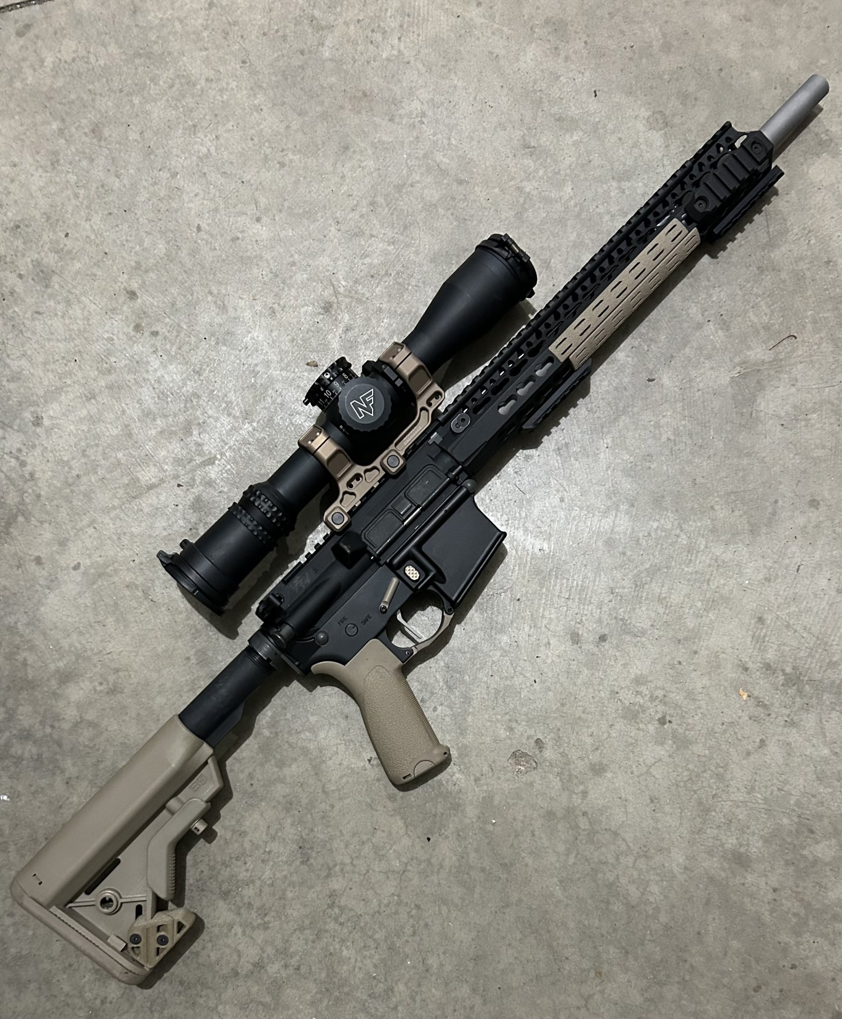

I need to decide if I’m putting a suppressor or muzzle device on it.
