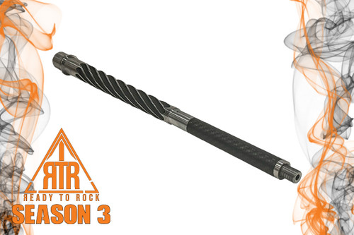

No thanks. The weight savings just aren't there when you only CF wrap the lightest half of the barrel. That and it looks silly in my opinion.Any thoughts on the new Hybrid spiral twist back half with Carbon Fiber front half ? Available in 16" 223 Wylde, and 18" 6.5CM
https://craddockprecision.com/rtr-223-wylde-16-hybrid/

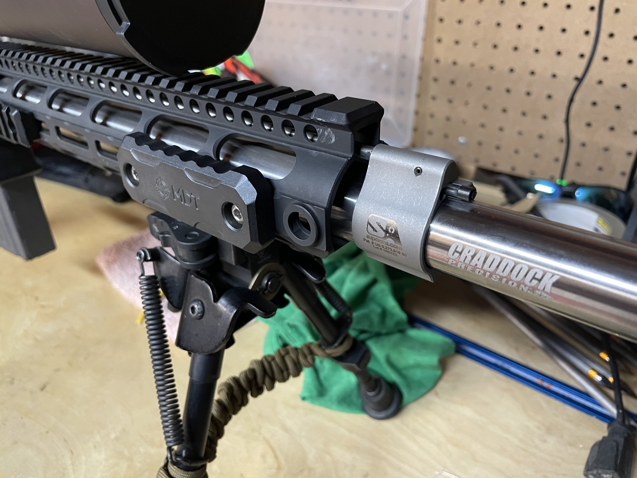

Well I’ve been holding off on posting my update, but since you mention Grendel.Any updates on these RTR barrels looking to try something different for my Grendel or to switch to 6 arc. I know the Proof barrels are good... I'd like similar performance but wondering if I can save a little... and not willing to jump to the 7-800 for a Bartlein. (also what bolt do you use with the proofs I used the JP foe my 6,5 creed AR10 just it too is $ compared to other options).

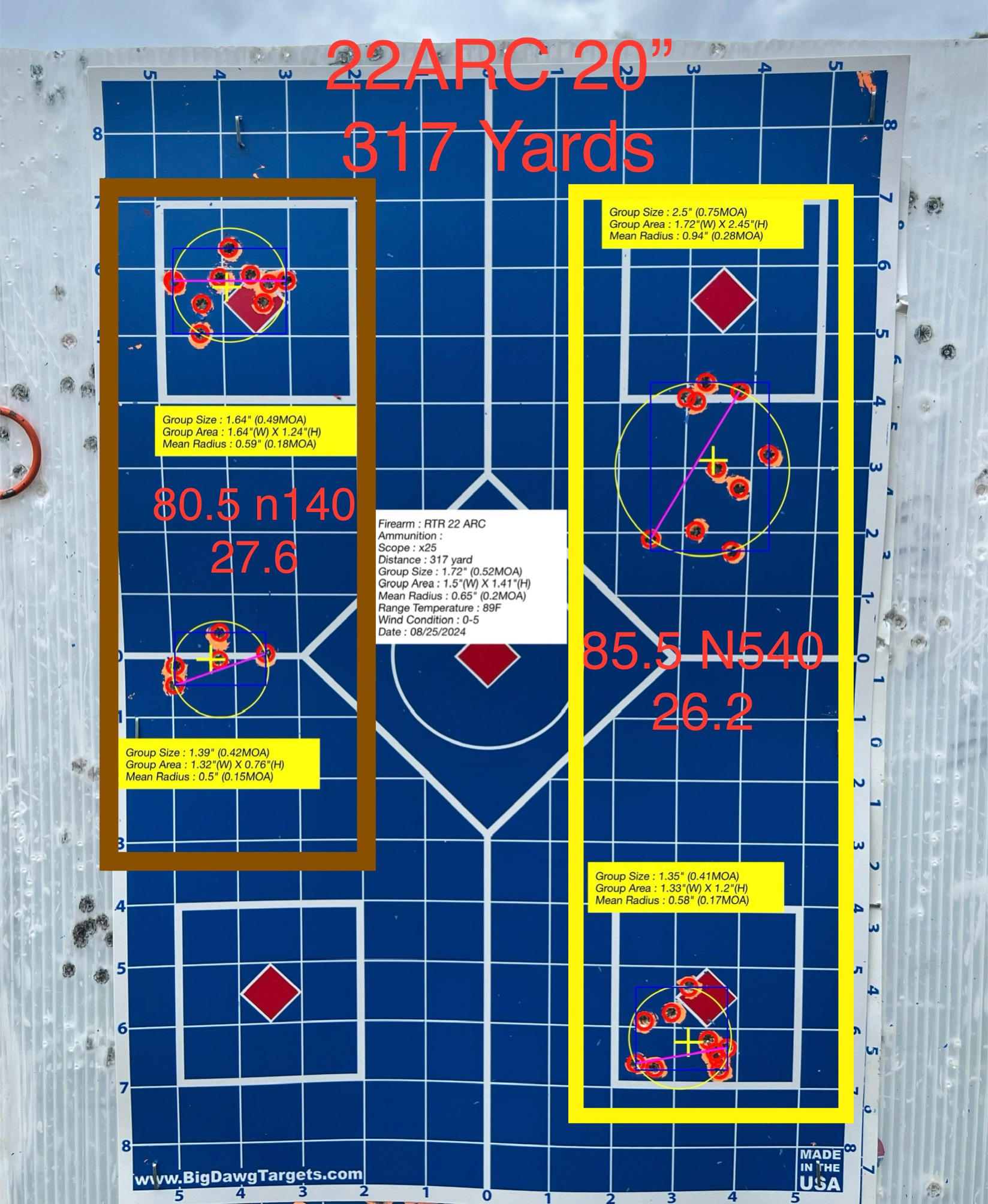

I can’t comment on Grendel, by my RTR 22 ARC hammers.Any updates on these RTR barrels looking to try something different for my Grendel or to switch to 6 arc. I know the Proof barrels are good... I'd like similar performance but wondering if I can save a little... and not willing to jump to the 7-800 for a Bartlein. (also what bolt do you use with the proofs I used the JP foe my 6,5 creed AR10 just it too is $ compared to other options).

Ordered one of their lighter Pangris 13.9’s. Could never get it to shoot much tighter than a basketball @ 100. Emailed them and they said the whole initial run was bad? Anyway they had my upper a few months and I only just got it back with a new barrel.
In the meantime I rolled the dice with another extra-lightweight 6.5 Grendel (their .625 Pangris). I had it out yesterday and I swear it was spitting 3” groups @ 25. If I didn’t have another homebuild right next to me that I assembled the same time, that’s shooting @ MOA I’d think maybe I just forgot how to assemble a rifle. I took it all apart and have it back together now, but something was seriously wrong with it and I’ve put together more than my share of sub-MOA ARs.
I’ve had others of their barrels before that shoot great, but at this point I’m a bit concerned from my small sample size of recent barrels.

Since you brought it up… The first ones were not bad blanks but sabatoged. They should have emailed you about replacing it. I returned mine and swapped it for an 18” then bought another since they were honest about the fuckup. I’ve shot both and they shoot the 123 eldm factory ammo +/-.75 moa depending on ammo lots. They’re gassed perfectly. With an h buffer they run perfect with or without my can using just a standard low profile gas block. If I sat down and worked up a hand load I’m sure they’d shoot better. Aesthetically they’re perfect.Well I’ve been holding off on posting my update, but since you mention Grendel.

Yeah I reached out to them, not the other way around, but that’s what they said. Something about the whole run of barrels being intentionally dicked up. I worry this came from that batch, given how it shoots.Since you brought it up… The first ones were not bad blanks but sabatoged. They should have emailed you about replacing it. I returned mine and swapped it for an 18” then bought another since they were honest about the fuckup. I’ve shot both and they shoot the 123 eldm factory ammo +/-.75 moa depending on ammo lots. They’re gassed perfectly. With an h buffer they run perfect with or without my can using just a standard low profile gas block. If I sat down and worked up a hand load I’m sure they’d shoot better. Aesthetically they’re perfect.
I’ll buy more barrels from them just because they made good on the product. I hadn’t even installed the barrel in an upper and they emailed me disclosing the issue and requested that I send it back for replacement. I didn’t need 2 but I know they got fucked and were on the hook for no telling how many barrels. In a world full of people and companies with less than stand up character, they did what was right.
